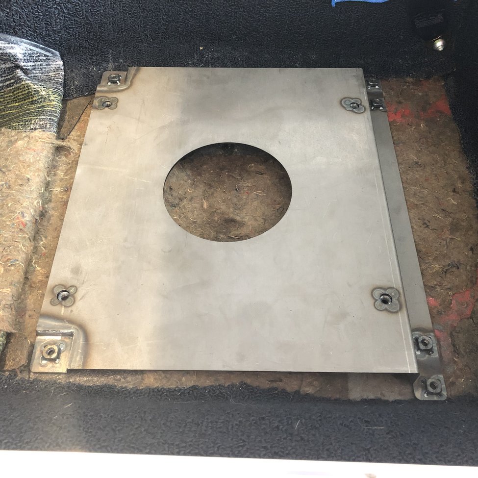

      I can't help with your BMW seats but I went with 5th gen Camaro seats which more or less have the same problem. We notched out the sides to make way for their widths, and instead of using that generic seat pan, removed it and reinforced the floor in the 4 seat-mounting locations.
      This takes into account their extra width and height, but is a fair bit of fabrication.
      Unfortunately in this picture you can't see the 2 inside holes.

      Slimjim, I saw your pictures in another thread including one that shows the back raised mounting perches and i wanted to clarify that you also moved the front mounting holes back from the original location? In this picture it looks like the front mounting hole is back of the added cross support? Was the added cross support necessary and how did you beef up the actual areas around your new mounting points? I'm in the process of deciding how to modify the mounting of my Recaro seats with the Wedge Engineering brackets as I need to move back 4-5 inches probably and I think it will still sit to high on the seat pan, so we're trying to figure out how to lower the seat. My body guy thinks he can lower an 1" by just cutting off the mounting tabs and extending flat, but if that is not enough then we would have to figure out whether to remove the seat pans and how to brace for mounting directly on the floor somehow. Appreciate any ideas/thoughts.

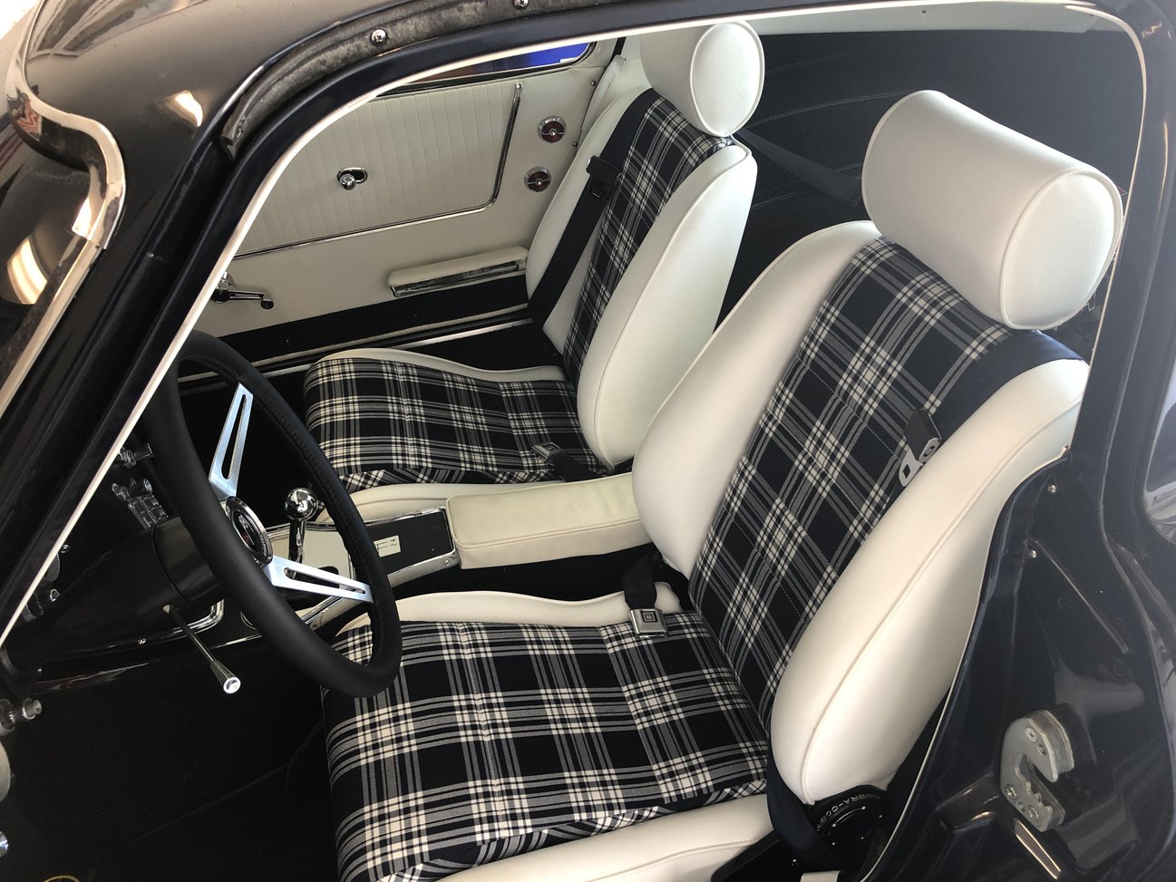

      Although not technically BMW E30 seats, you may be interested in these:
      I using a pair of Cobra "Stuttgart" seats in my 1964 Corvette. They look very similar to the E30 Seats. I ordered them in white vinyl, sourced the tartan fabric from a shop in Scotland, and had a local upholstery shop reupholster the centers.

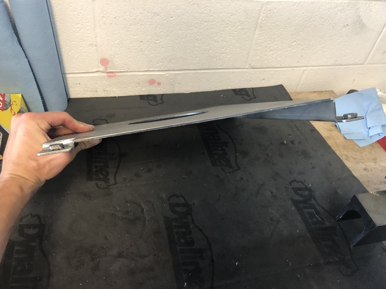

      Much like your Camaro, the floor pans in the Corvette are not flat. I took some careful measurements and had a local fabrication shop make these brackets for me. These mount the seats directly to the floor, as low and far back as possible. The bolts all come in from under the car for easy access. At 6'6/210, I dont need sliders, but if you were to want to run them, Corbeau makes a set of universal, low profile sliders that have the correct bolt pattern for these seats and add less than an inch to the overall height.
      With the seats bolted directly to the floor via the brackets, I gained a full inch of leg room and roughly the same amount of head room.

      Quote Originally Posted by Nativefx View Post
      Ok I found another photo showing how the insides were strengthened, you really don't want to skimp out here as it will take a lot of force in the event of a head-on crash or similar. We did move the mounting locations back, we just chose to not compare the new setup to the original mounting locations and just do what was necessary to have the seats fit and look right. Since I'm fitting a 5th gen interior entirely, there's a lot more involved in making the parts fit, the seats needed to go wider and further back since the entire interior is a few inches further back than original.
