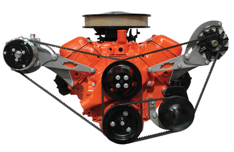

      I'm covering the holes with the DSE panel, just haven't decided yet whether to simply use four grommets or something else. I have the EZ Clip Hose option. Waiting on the VA Alternator bracket since I decided to put the compressor on the PS in my '69. The compressor bracket is here, think I'm going to either paint or powder coat, although I have a friend with a CNC plasma cutting table who has offered to dupe the steel VA brackets in billet for me, and if I want, he can cut in a bowtie on each side. I'll probably go with chrome or billet pulleys if I do that.
      The VA brackets look crazy wide in this shot, but I've seen a picture of them in a Camaro... doesn't look that bad. I just can't swing the money for a serpentine setup right now.

      Quote Originally Posted by OldTimer View Post
      I hope those brackets aren’t as flimsy as they look....

      Quote Originally Posted by dhutton View Post
      Don
      Here's what it looks like installed (by another VA bracket user) Don. They don't look much different (from a sturdiness point of view) than those used by Chevy IIRC. I suppose that if I have my buddy make dupes, I can also look at making the wall thickness 5/16" or maybe 3/8" and cut down the spacers. Just have to make sure the belts wind up in the same spot. Will probably go with billet pulleys to ensure trueness.
      They look better from that angle.

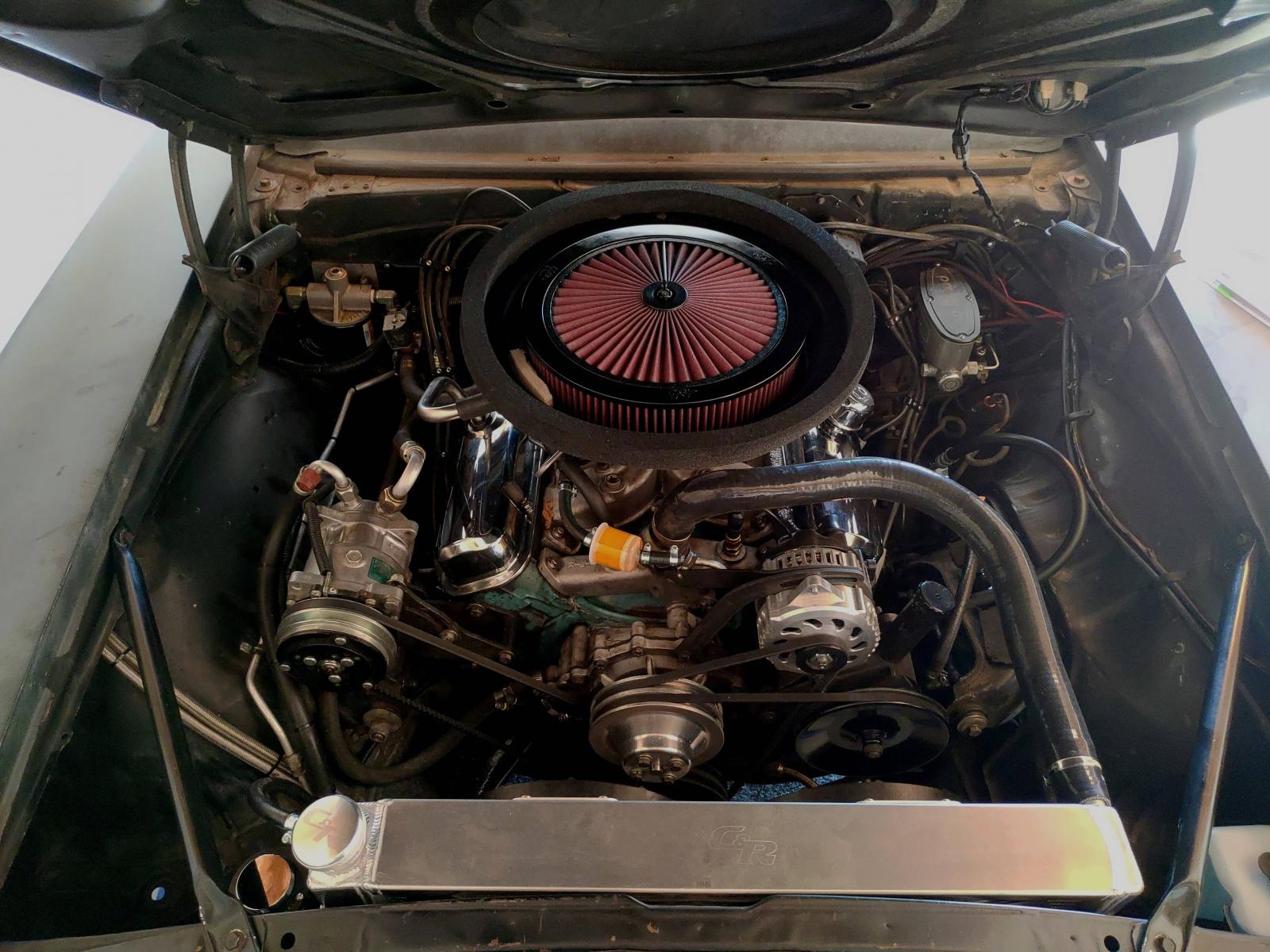

      I was able to do it, but not the cleanest install:
