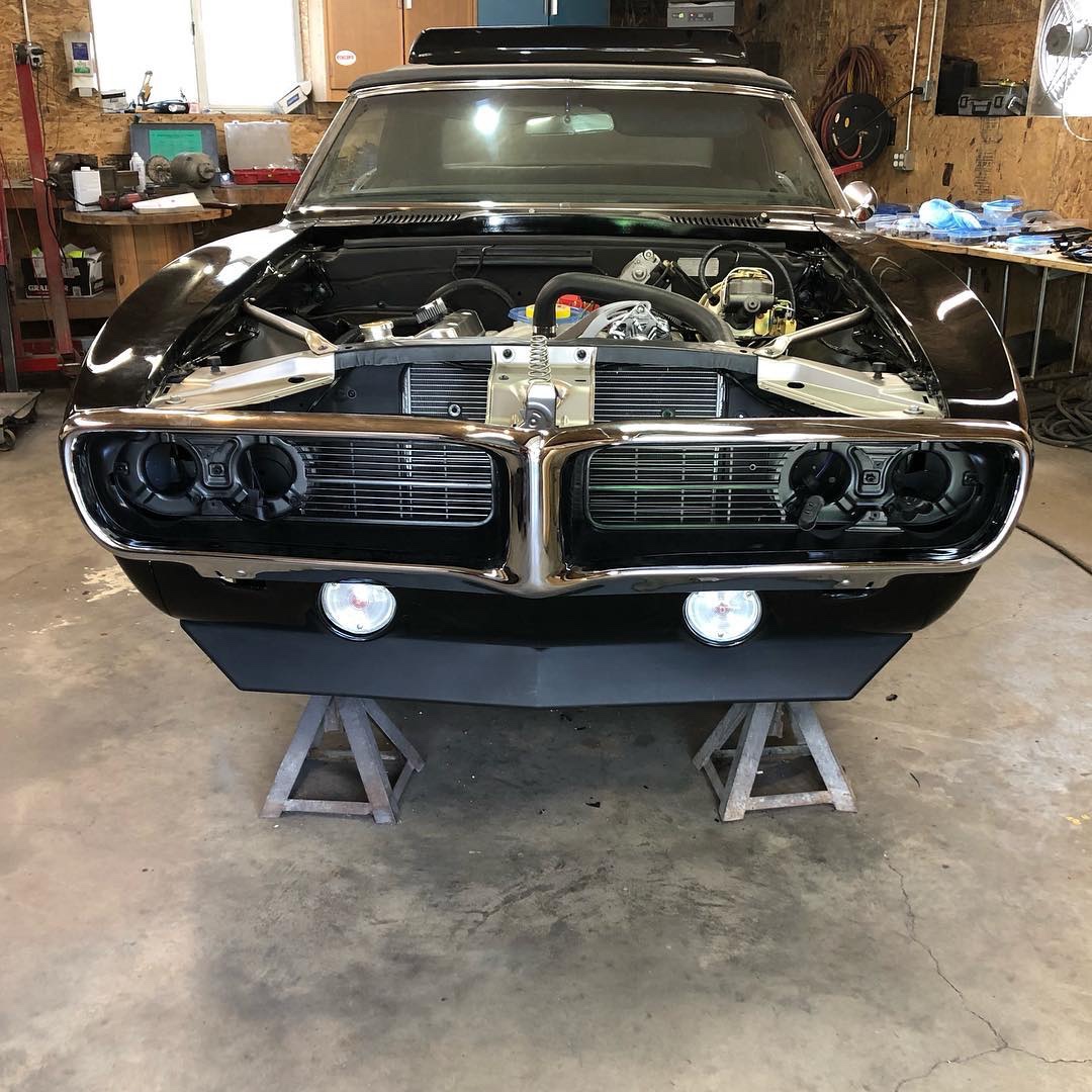

      Does anyone on here know how best to do this I have a 1967 Firebird and want to use 1969 Camaro lower valance with the spoiler what mods need to be done

      That looks pretty good. You will have to pick up a Camaro valance and compare it to the firebird part. I can see swapping the ends from the firebird part to the Camaro but have no clue what will need to be done to match it up to the lower grille area.
      Possibly cut the centers out of both panels and weld the Camaro into the Firebird part.
