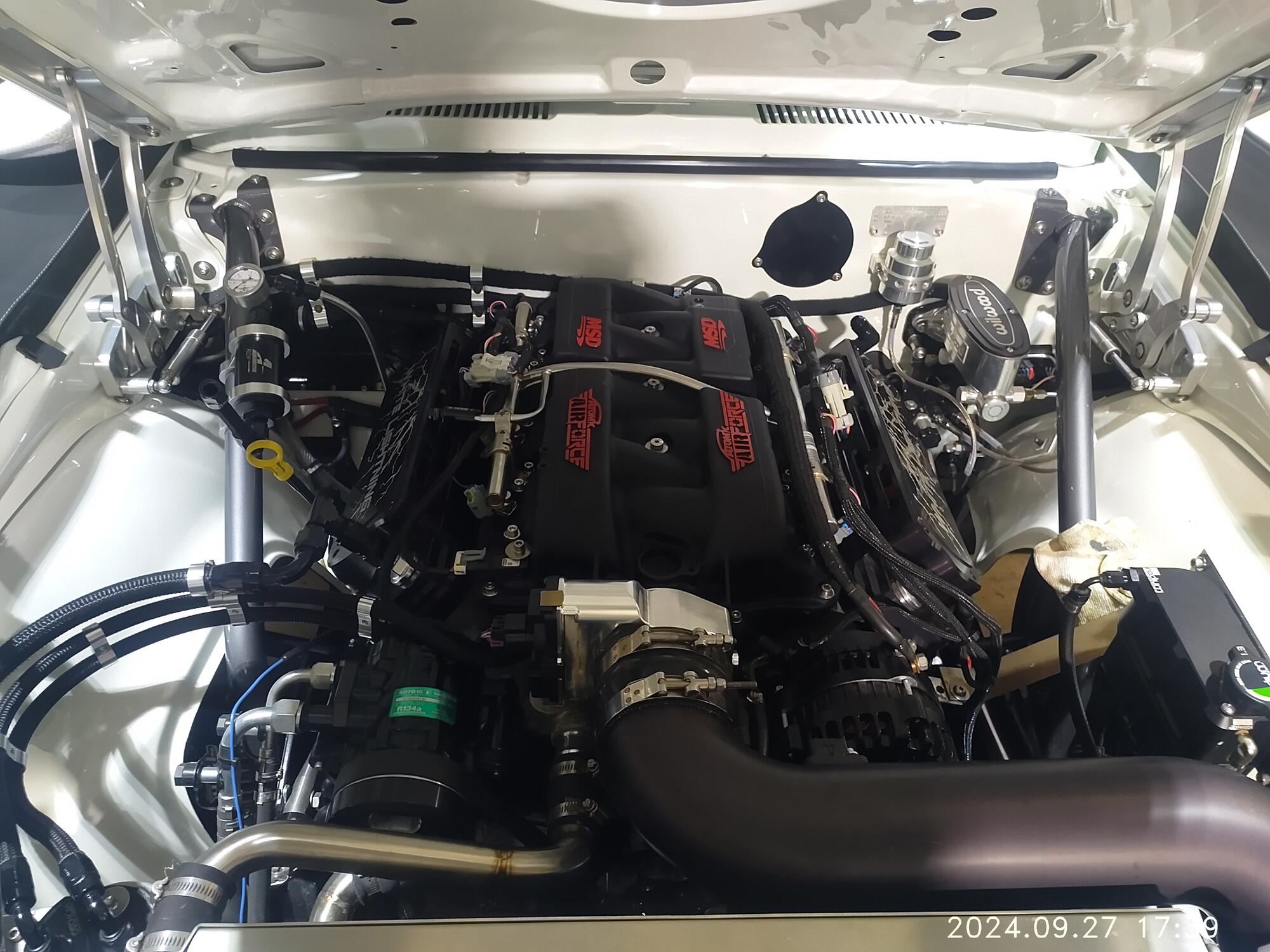

      So I've been out and won some car shows. Happy about that but time to work on white lightning again. Name:  IMG_20240926_194221.jpg
Size:  163.7 KBName:  IMG_20240927_173930.jpg
Size:  326.0 KBName:  IMG_20240927_193058.jpg
Size:  376.5 KBName:  IMG_20240927_173922.jpg
      Added a Mamo ported MSD, NW103 and 850 injectors.
      Now for a tune and I'm going to try GPI in Jacksonville Arkansas as I wasn't ever fully happy with my last tune.
      Also had clearance issues with the MSD and my Wegner accessories drive. So I purchased some Supercharger intercoolers .400 thick spacers. They sell them for insulated supercharger applications but was just what I need to clear the water pump and stuff. Included a pic of those on the heads.
