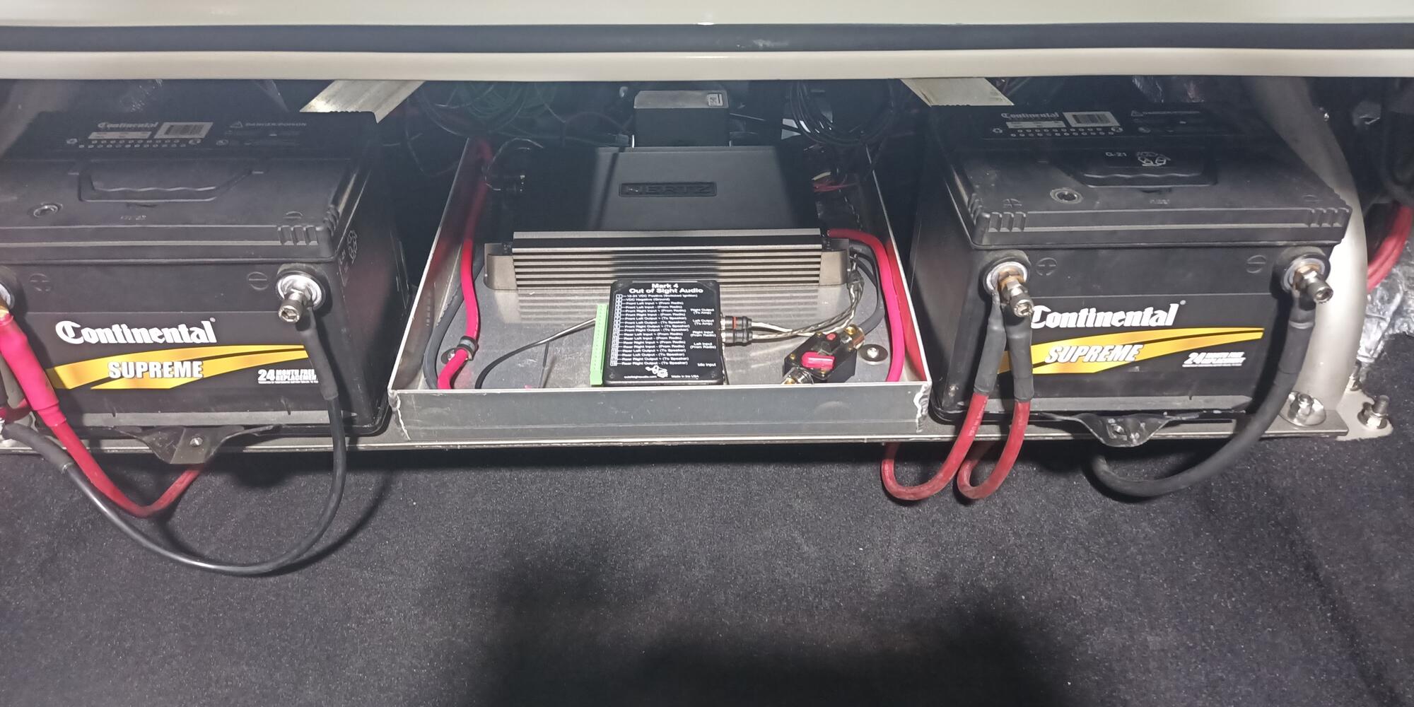

      Alright guys I'm building out my amp and stereo setup and my rear shoulder belts. setupName:  IMG_20220903_162509.jpg
Size:  214.1 KBName:  IMG_20220903_220122.jpg
Size:  229.1 KBName:  IMG_20220903_221009.jpg
      Now I ordered morris classic shoulder belt kit for the rear. I want to say outstanding kit and quality but it wouldn't work with my ridetech bolt in cage and my custom package tray. So rather than mount the shoulder ratchets on the outside of the car I mounted both in the center between the speakers and fabbed up appropriate bracing under the package tray out of 2X2x 1/4 aluminum angle tying the two ratchets to each other and then 1/4" X2" flat from that down to my battery trays which is made of 3X5 aluminum angle and bolted between the cage points in the trunk. I didn't get good pics of the mount or the ratchet part of the belts installed but will add those tomorrow.

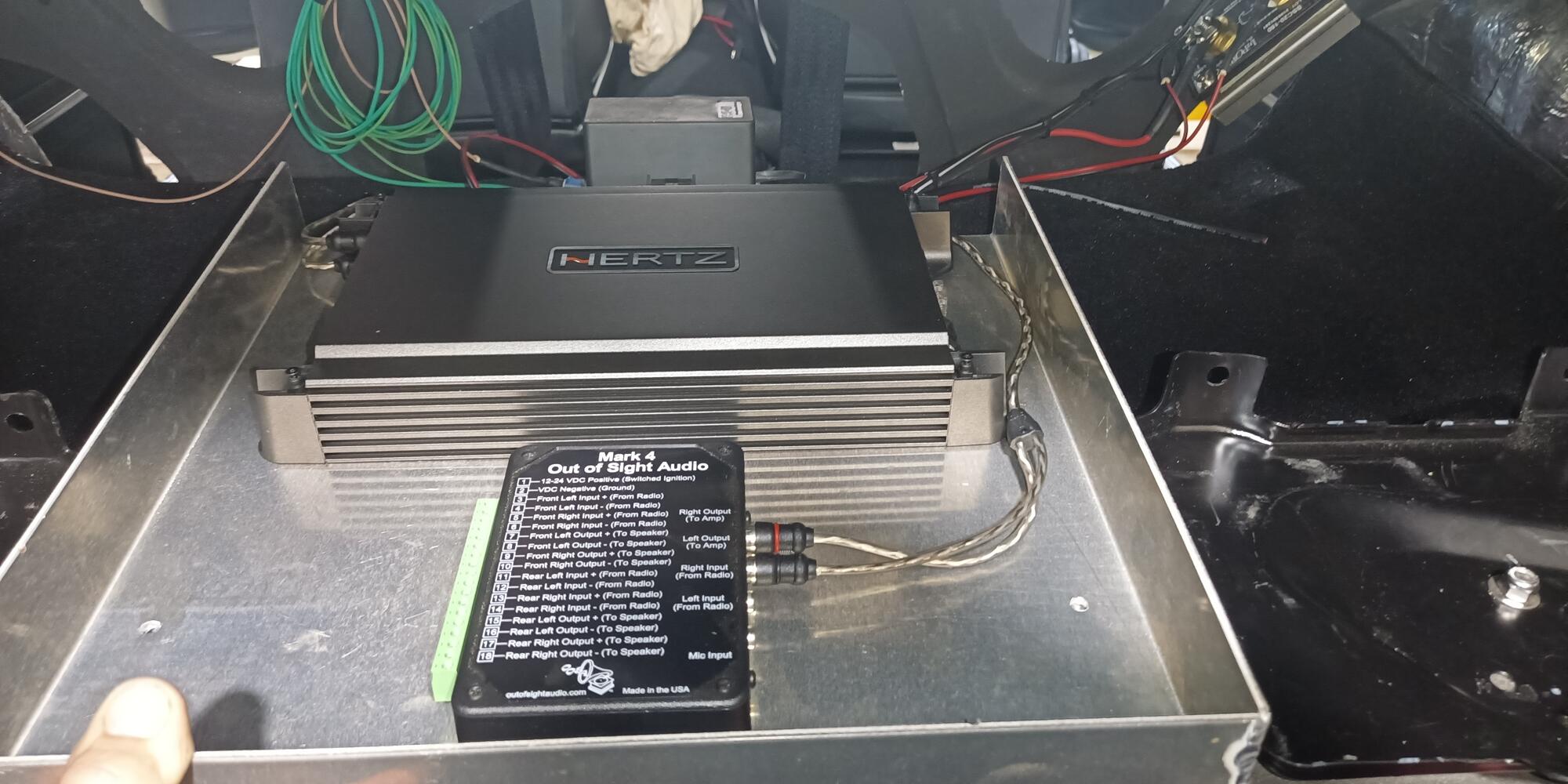

      For stereo I'm trying the Mark 4 out of sight audio and running a Hertzs HCP 5D amp. I've got Hertz Milles for the deck in 6X9s and Hertz Milles for the kick panels but I've yet to install those.
      As for the cars driveability I had issues with limp mode at 6 grand and no matter what we did tuning it wouldn't leave. Engine came with a gold blade TB when I got it. Ran the VIN and it called for the Silver Blade. Read forums online where other guys had the same issue trying to go to the gold. Depending on which E38 they had. So swapped to the silver blade, did a TB re learn and wallah it runs hard to 7500 now.
      Still got a slight lean issue on back one due to very tiny hairline cracks on the runners right behind the intake bolts. Will be swapping to probably an MSD.
      Or do you guys think Fast or MSD. I don't care about max effort at 7500 or 8 grand. It's a street car that will see auto x, drag and a little road racing. But predominantly street so I need torque and power 3 -7500.

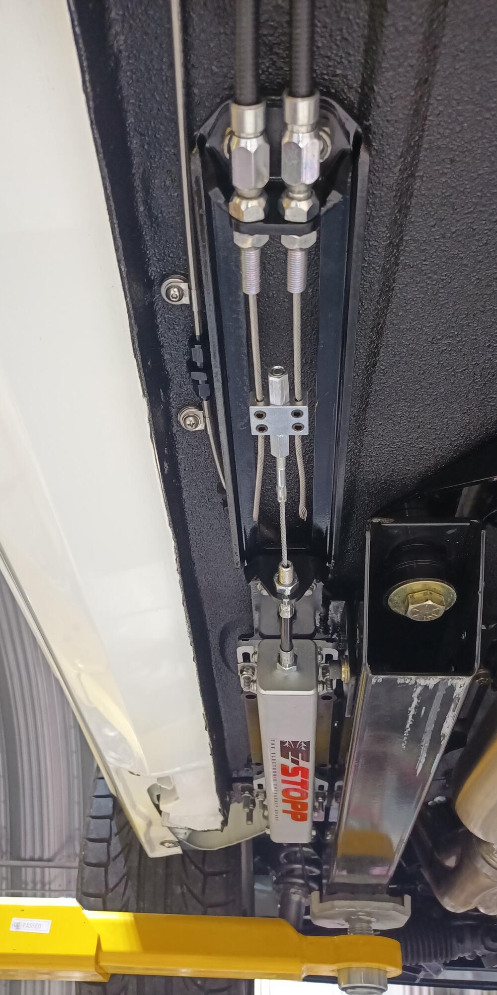

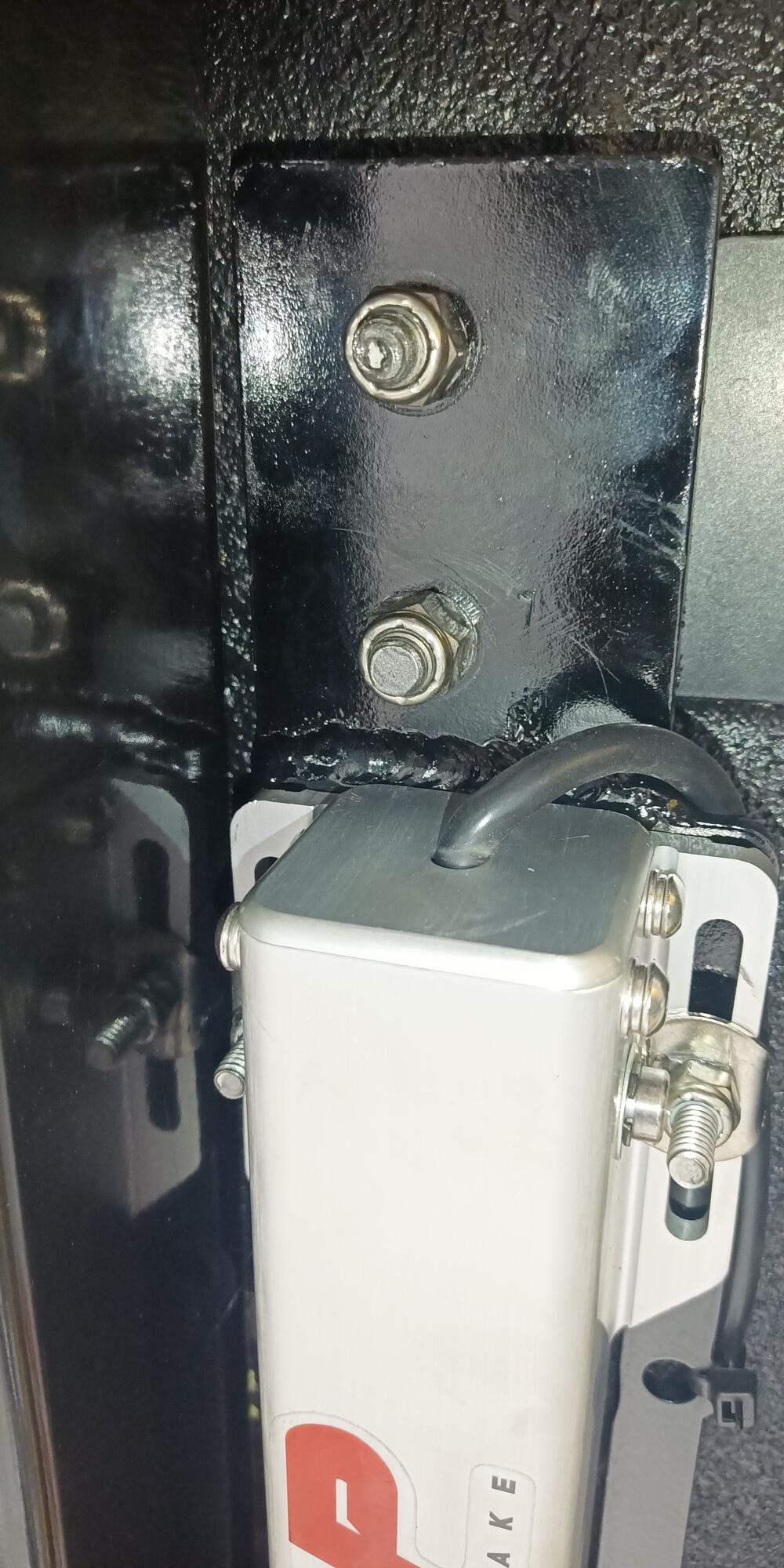

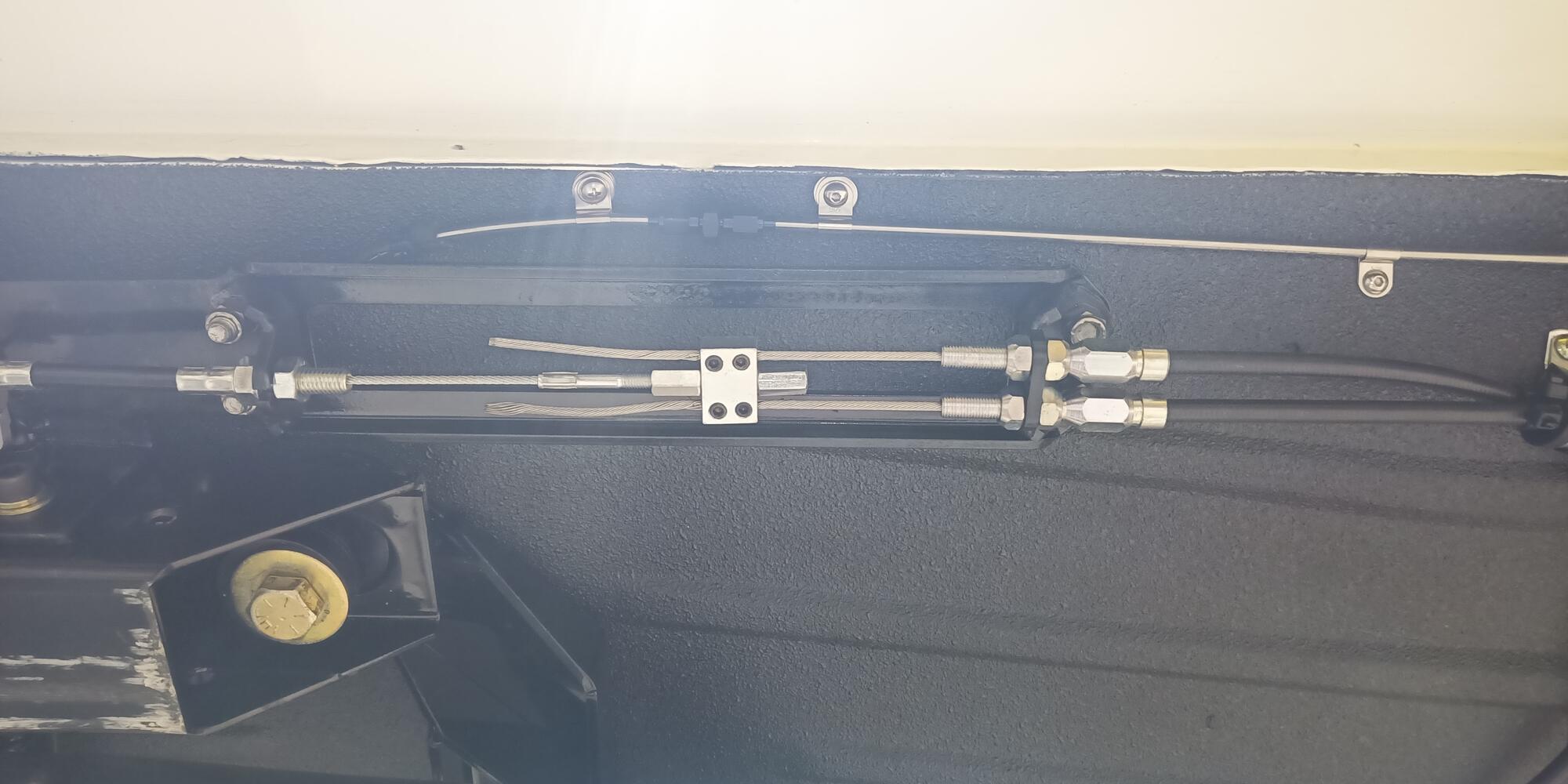

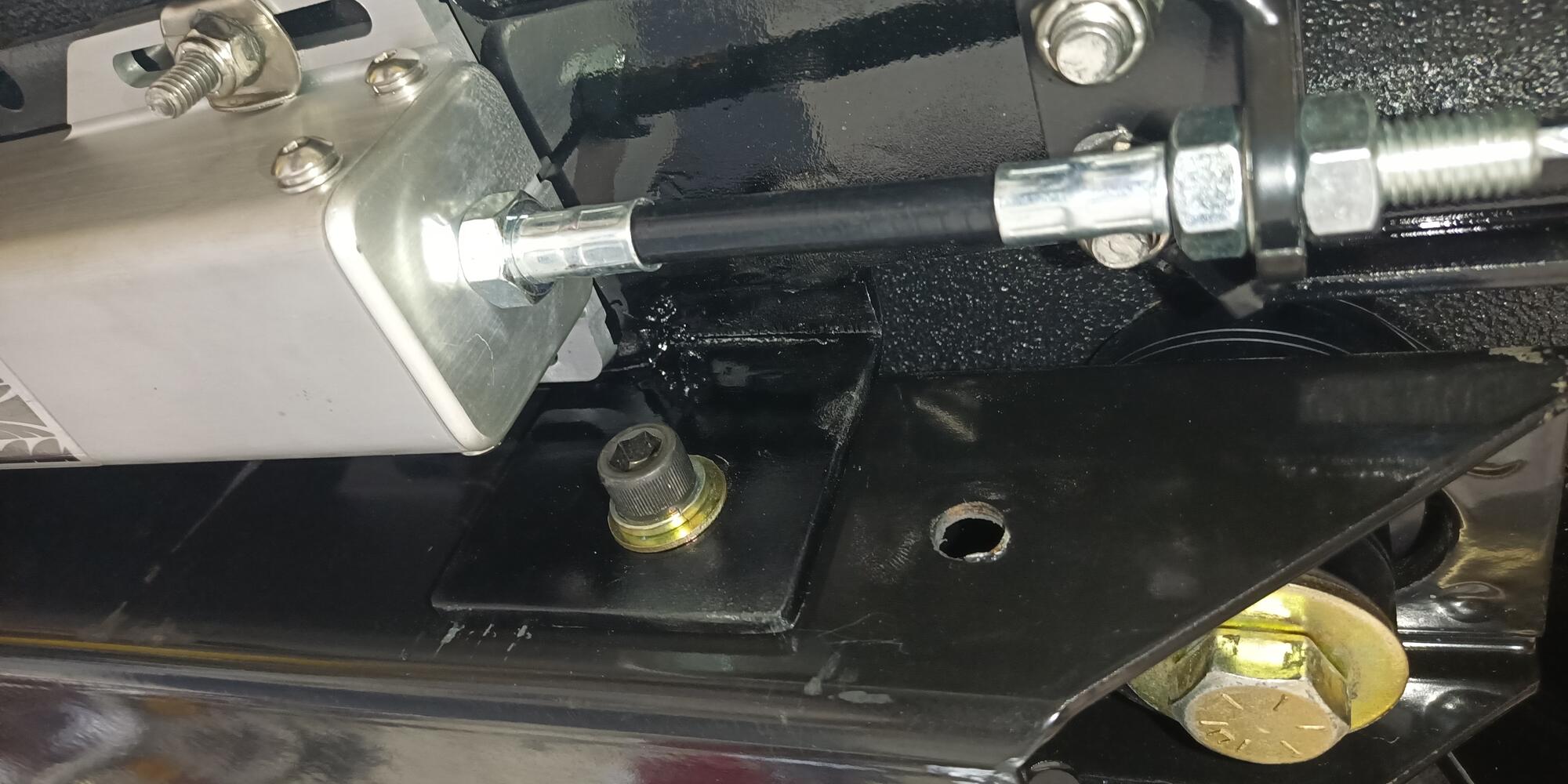

      Got my Estopp mounted. Put it on the driver's side frame rail of my Speedtech sub frame. Use studs I already had through the floor from my front door bar cage mount setup and used holes that came at the back of the subframe to mount the bracket. turned out pretty clean.Name:  IMG_20220906_213304.jpg

      Buy the CPP kit. It has that long skinny bracket in my pics. I jest welded small fabbed brackets up to mount to my sub. There universal cable kit was also great.
