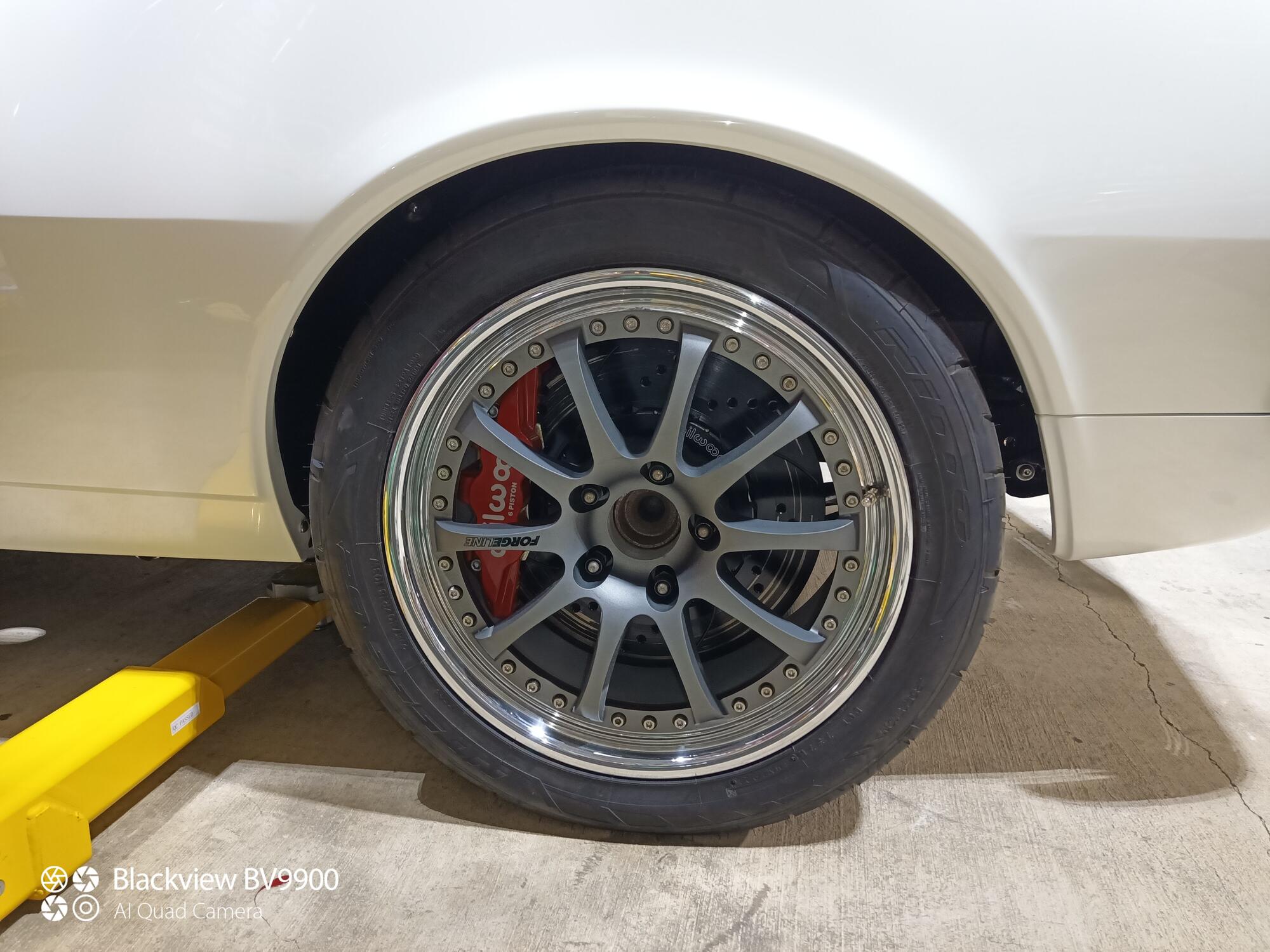

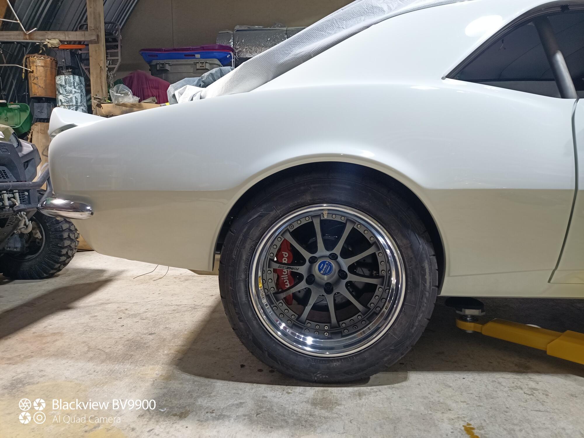

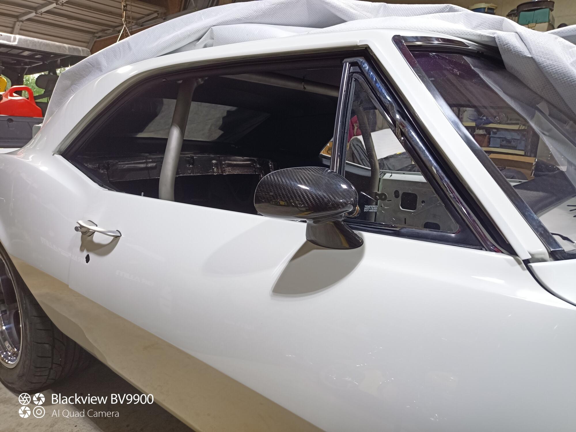

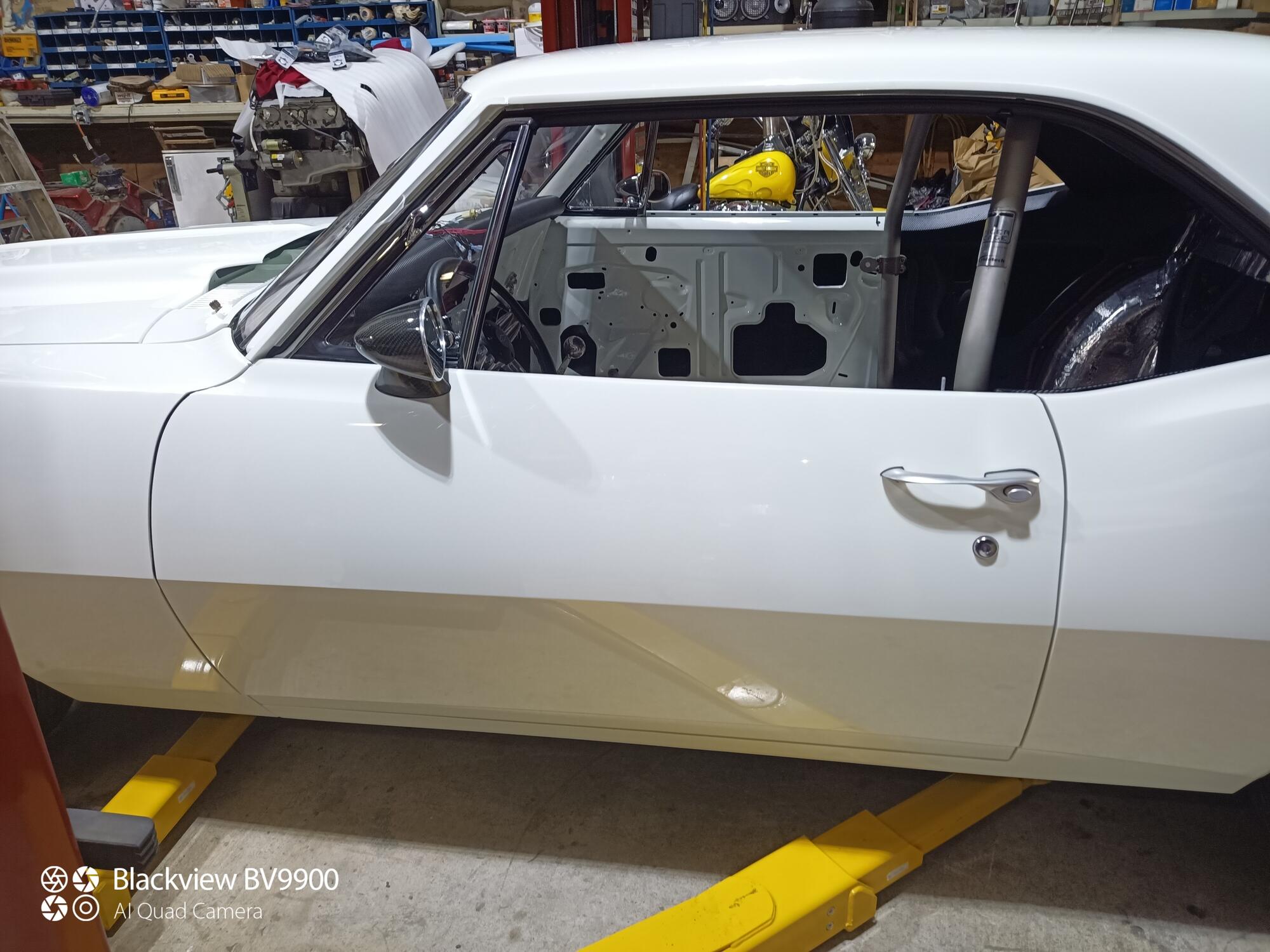

      Wing windows and carbon mirrors are on. Also my re barrelled wheels are back from forgeline.Name:  IMG_20220522_181254.jpg

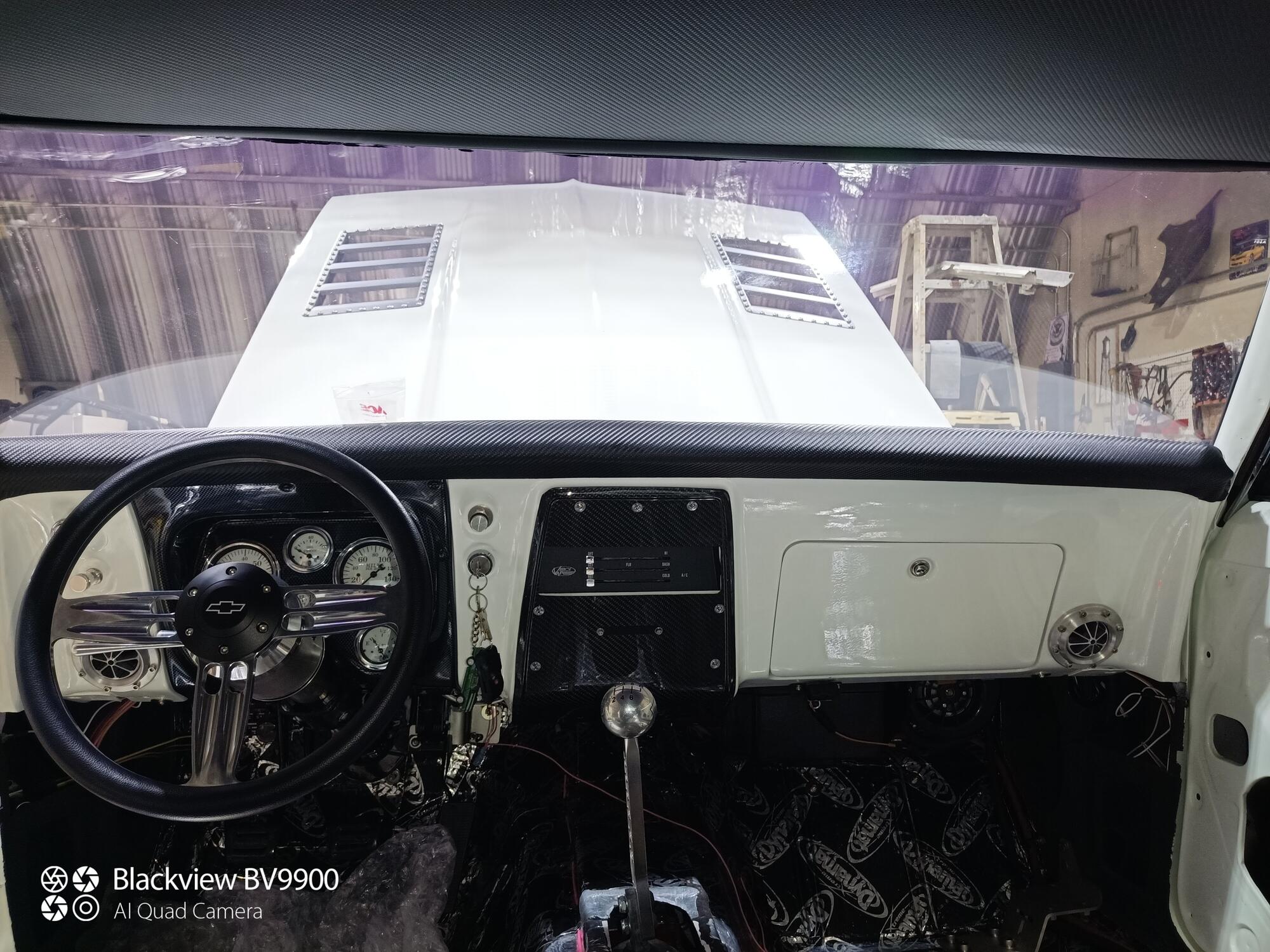

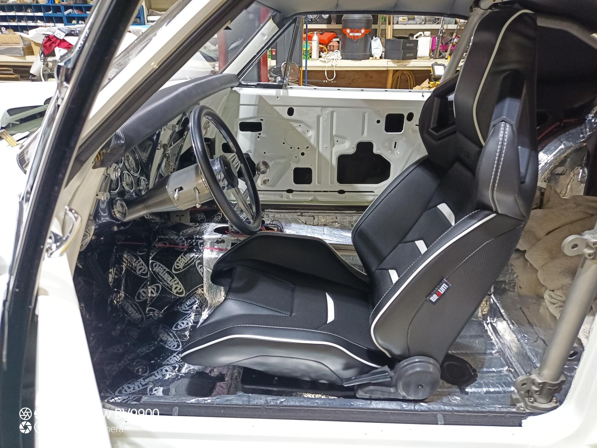

      Installed my driver seat. Seats are Braum Alpha X.
      Very nice for a vinyl I got no complaints. Will test drive tomorrow.

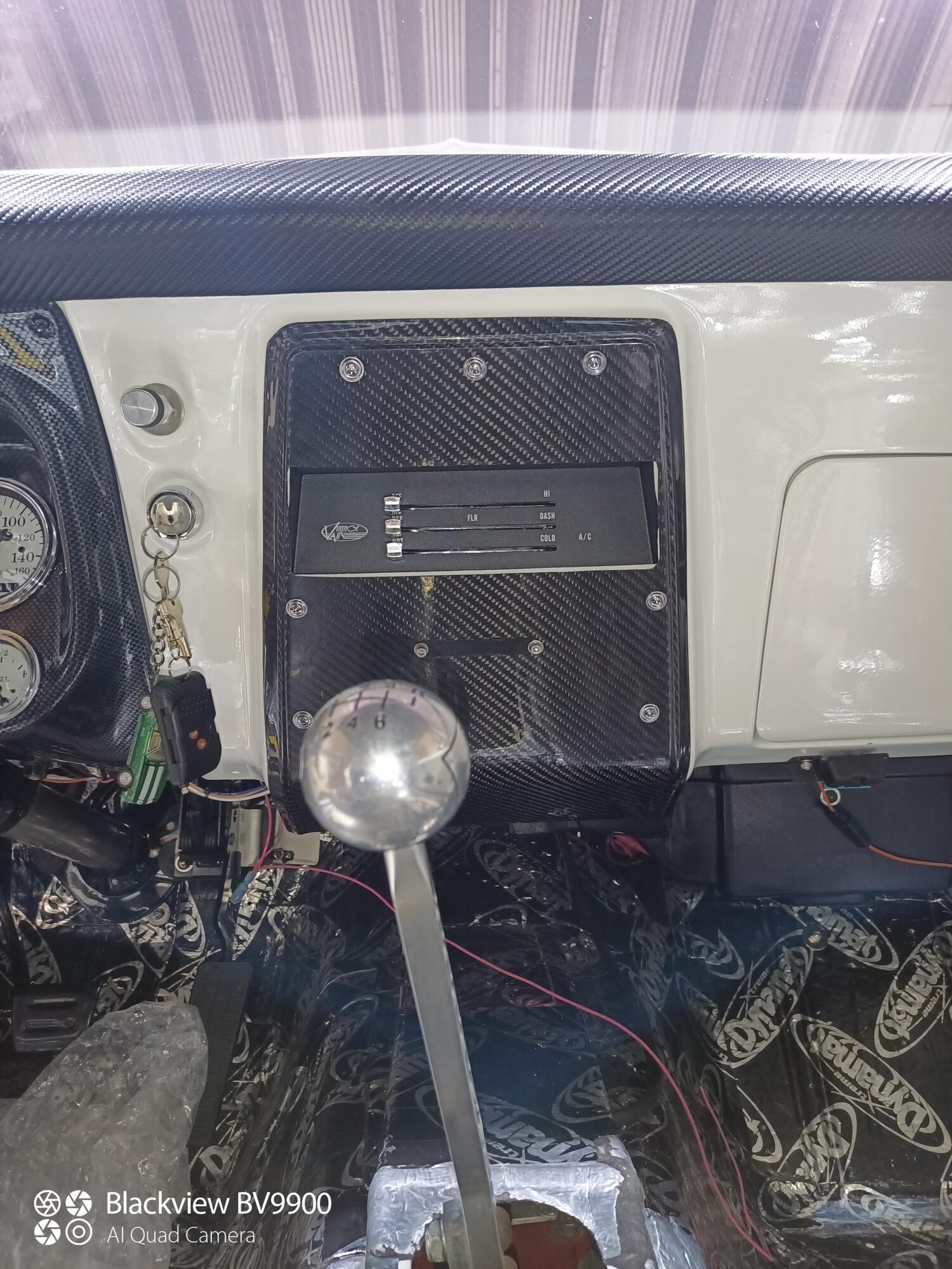

      Also got my center dash piece in it's Anvil Carbon.
      I have to say both the mirrors and center dash are anvil and I'm not that impressed with the qualities.
      Seriously the mirrors you got to glue the bracket in that holds it to the car and you glue the bezel in. Both with epoxy but for the price just not impressed. The center dash you don't get anything to attach it to the car. Undrilled holes because my entire build is stainless bolts everywhere so it's ok. But it still needs a rubber windlace around the outer perimeter.

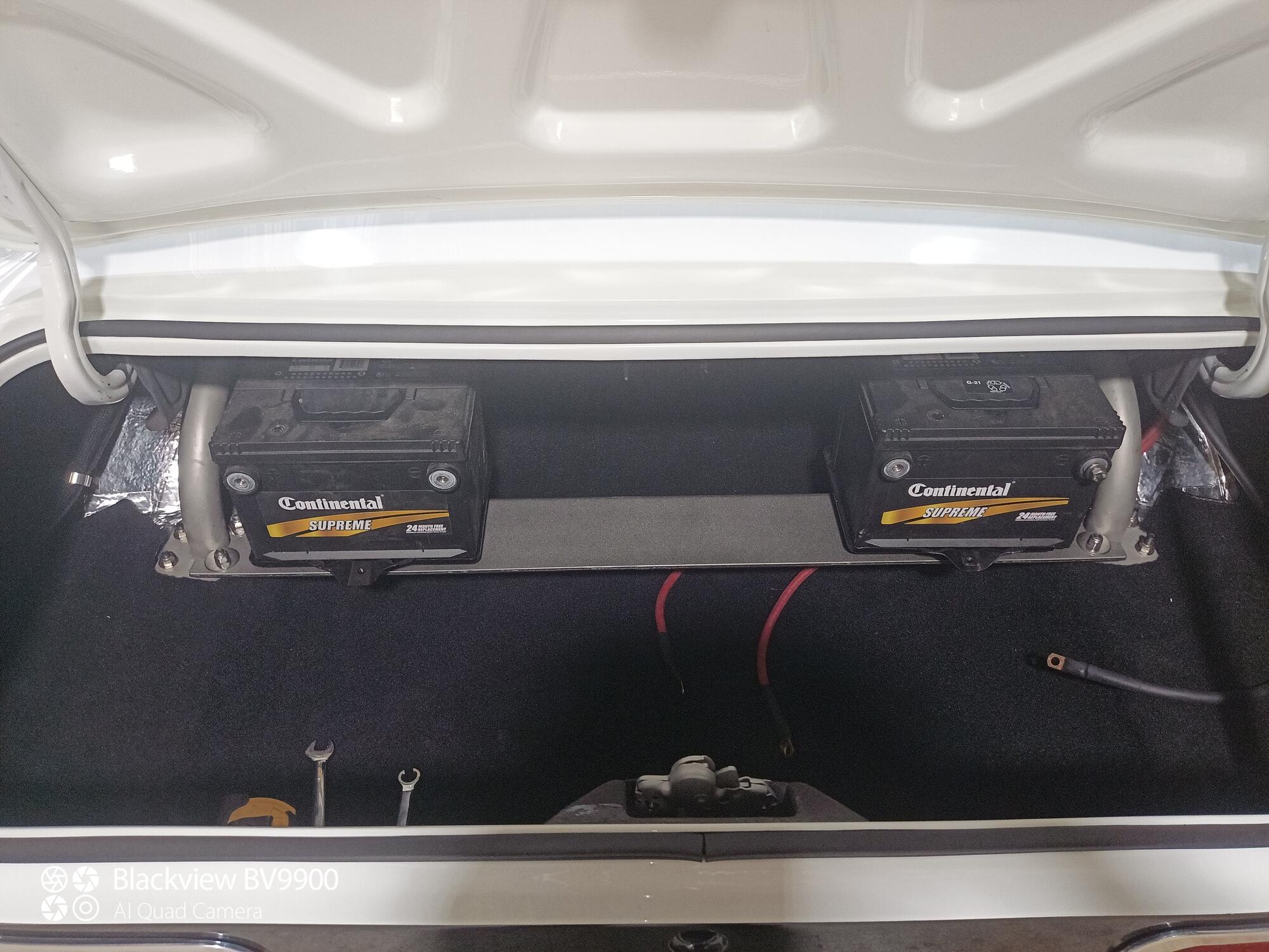

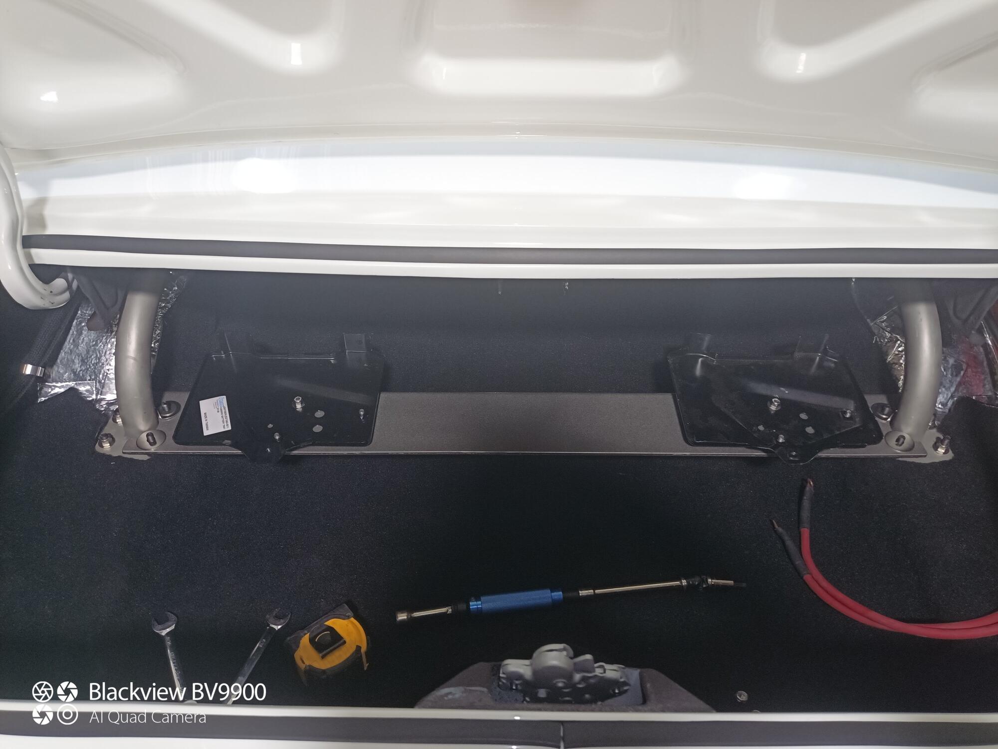

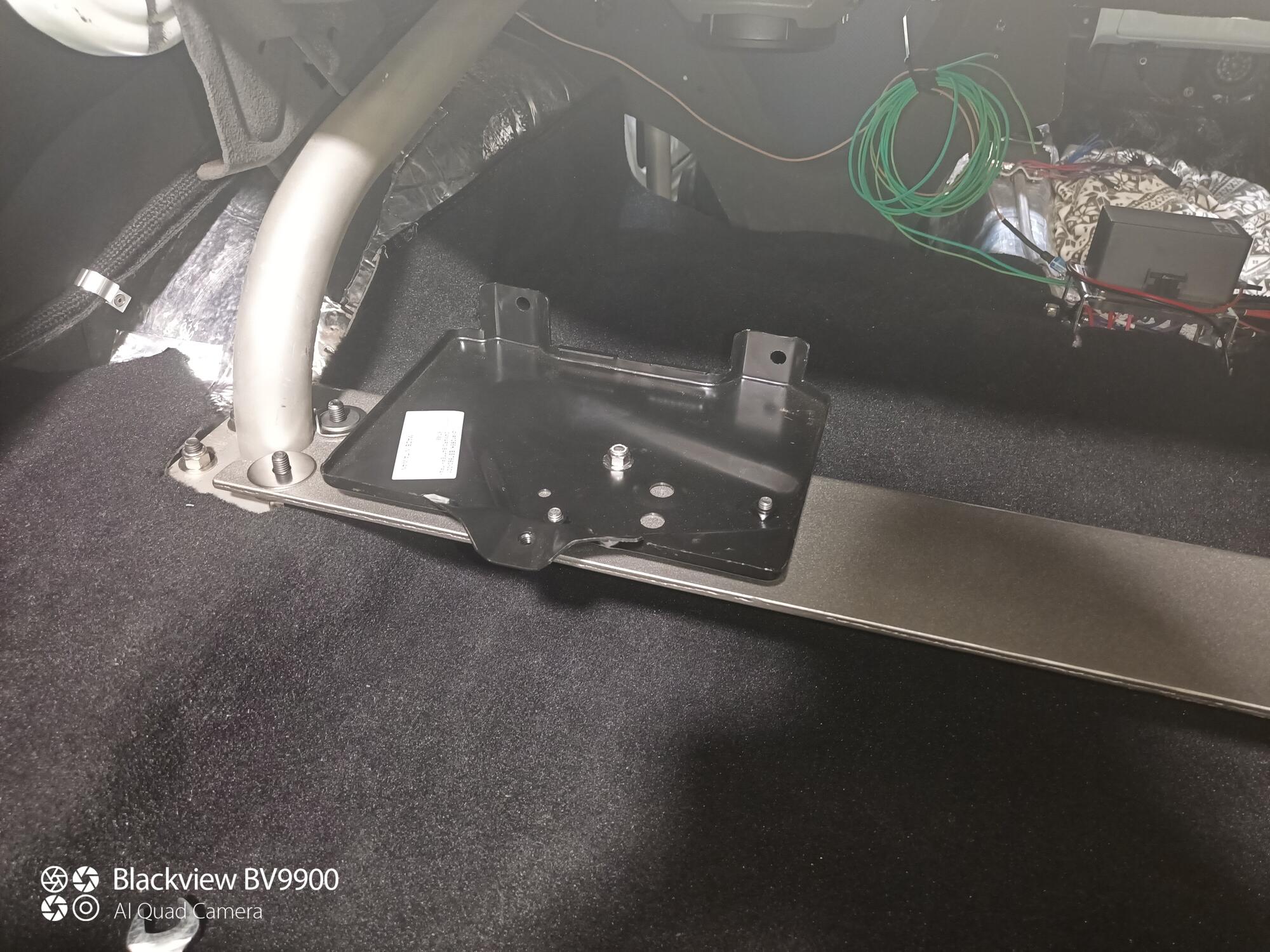

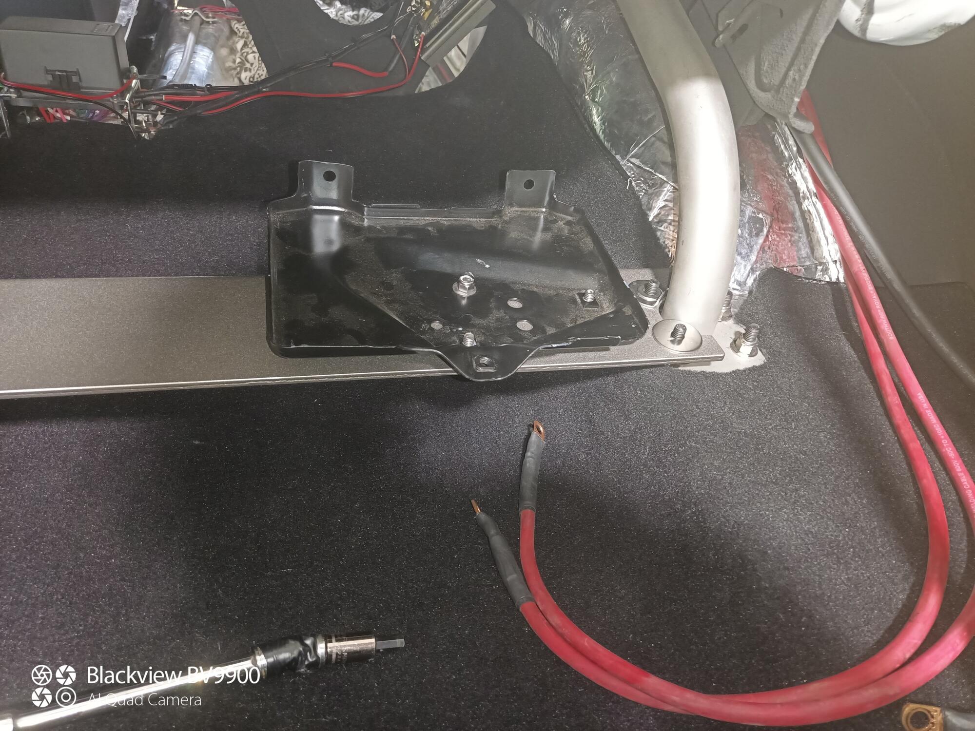

      Well after a commercial napa 930 CCA struggles to start my high compression LS7. Im wavered on a single North Star with 1130 CCA or just run 2 Continentals that I had already new. They are 680 each. So I used my original battery tray and a new dynacorn tray and fabbbed a bracket out of 3X5X1/4" thick angle I had and mounted it between my bolt in cage.
      And instead of a battery number from one to the other I just ran another #2 up to the firewall bulkhead. So each battery has its own hot to the firewall.

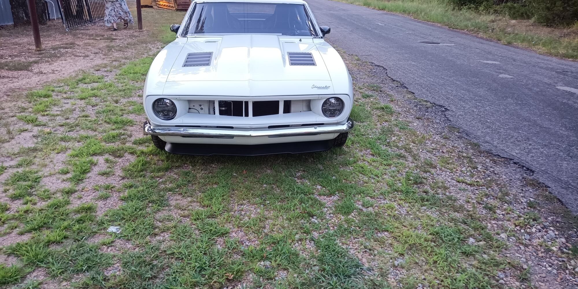

      Well I'm not great at pictures but here the Spoilers by Randy added today.
      I like if for a bought one. It still like to add a custom pro touring one later but for now this worksName:  IMG_20220715_200802.jpg

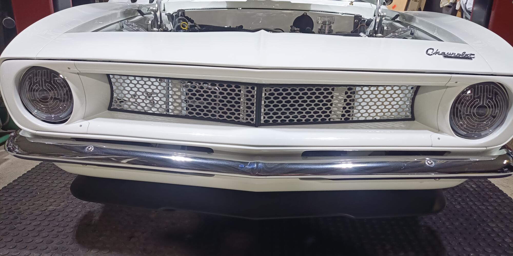

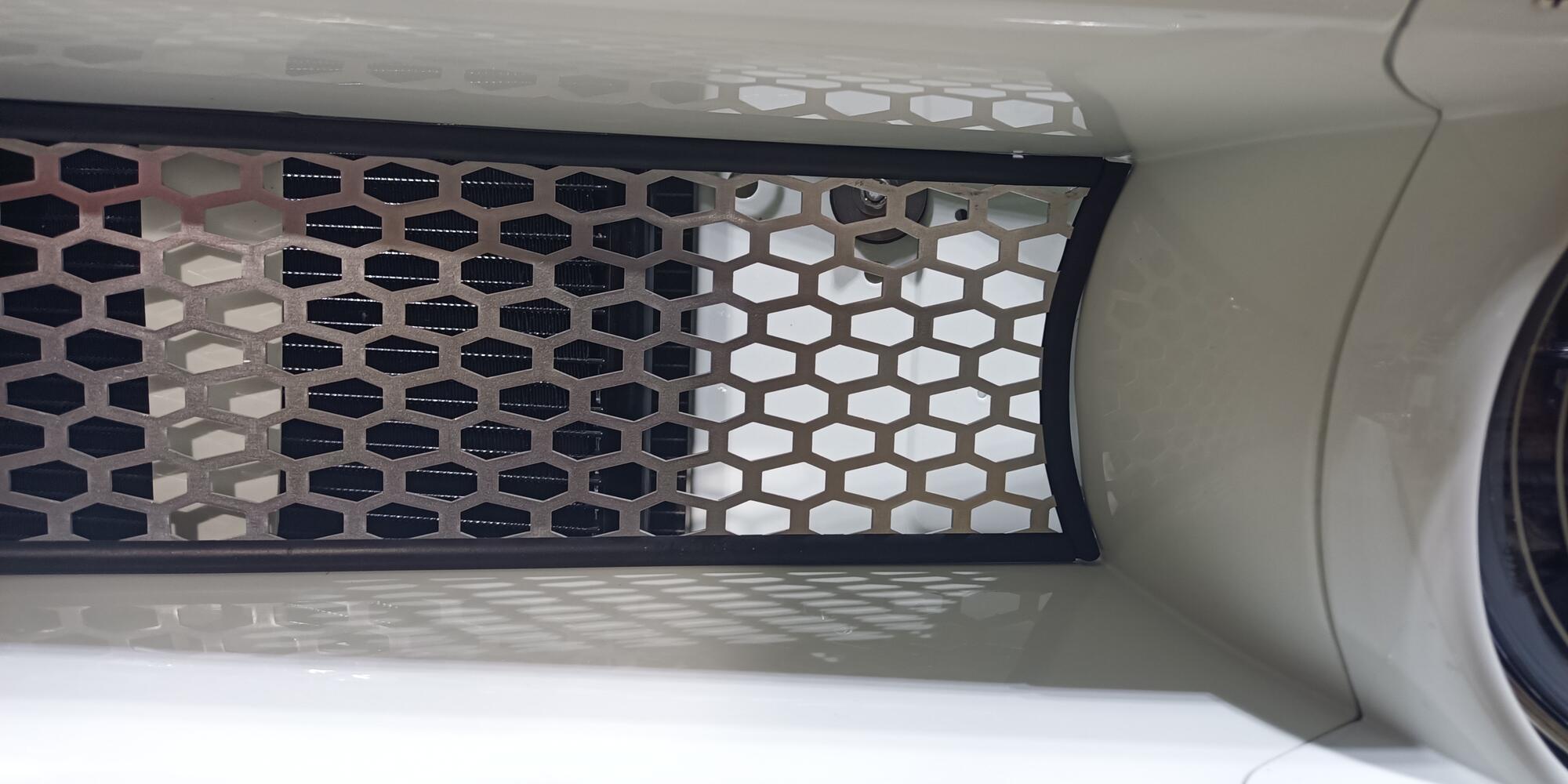

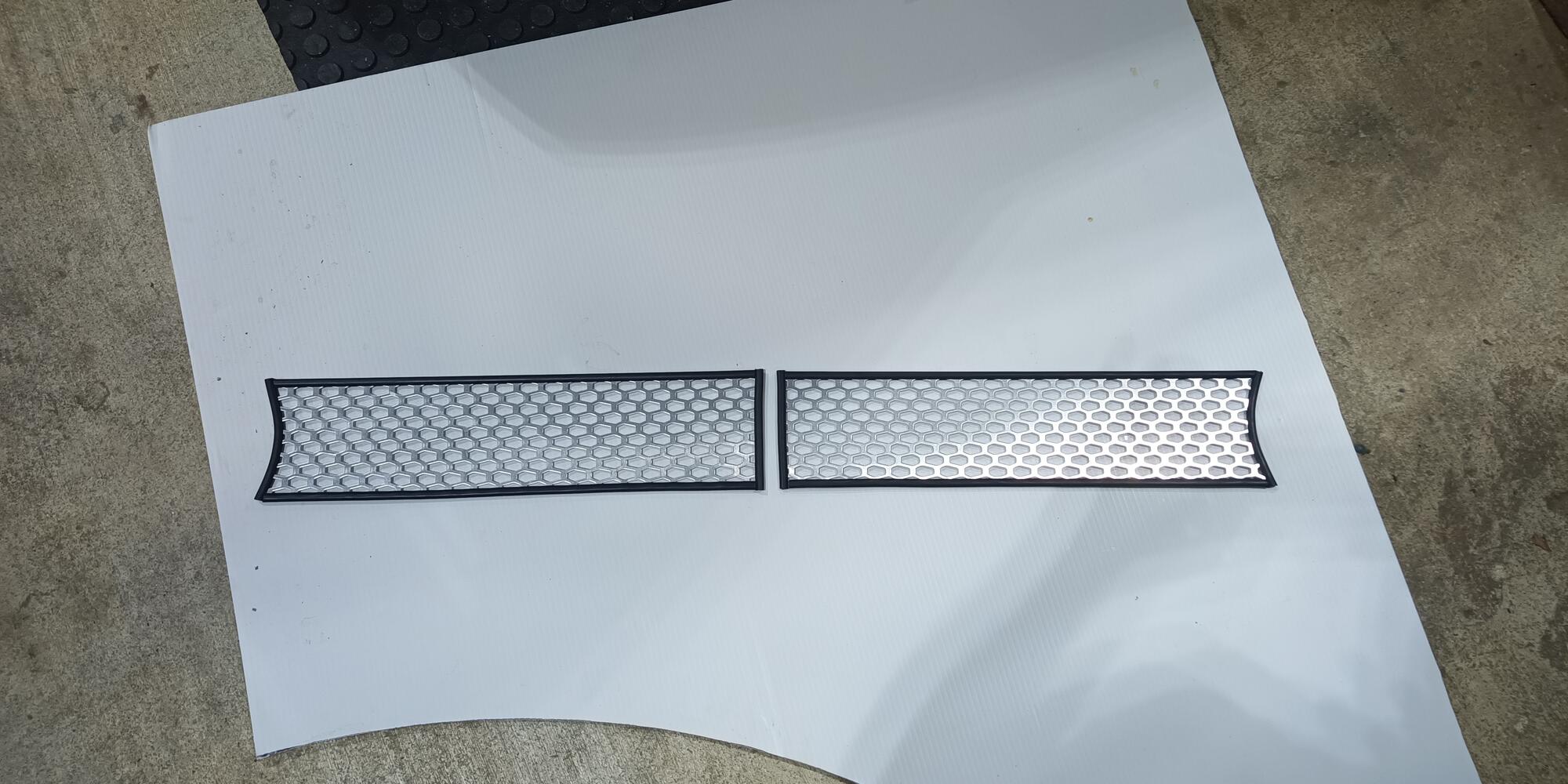

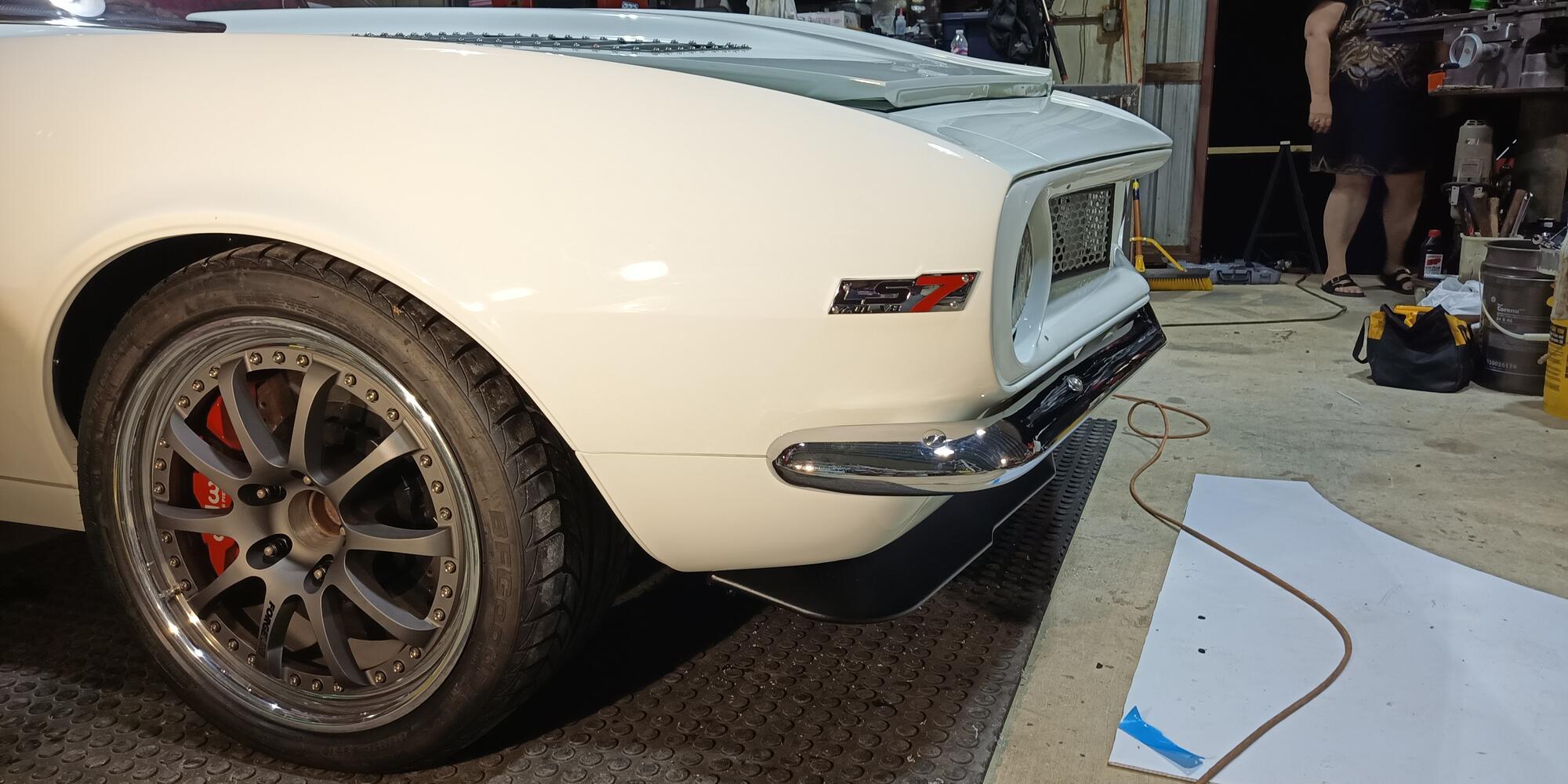

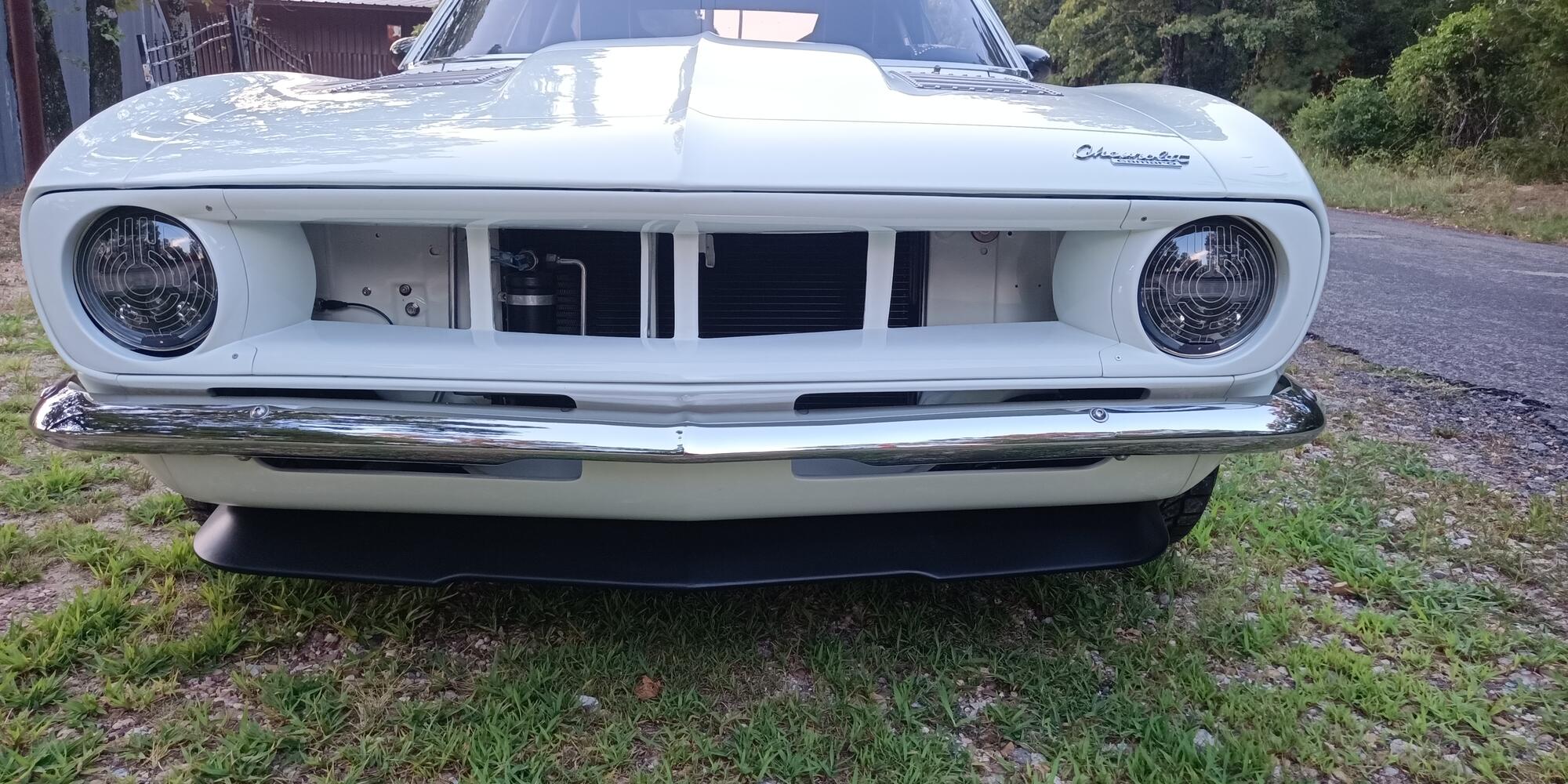

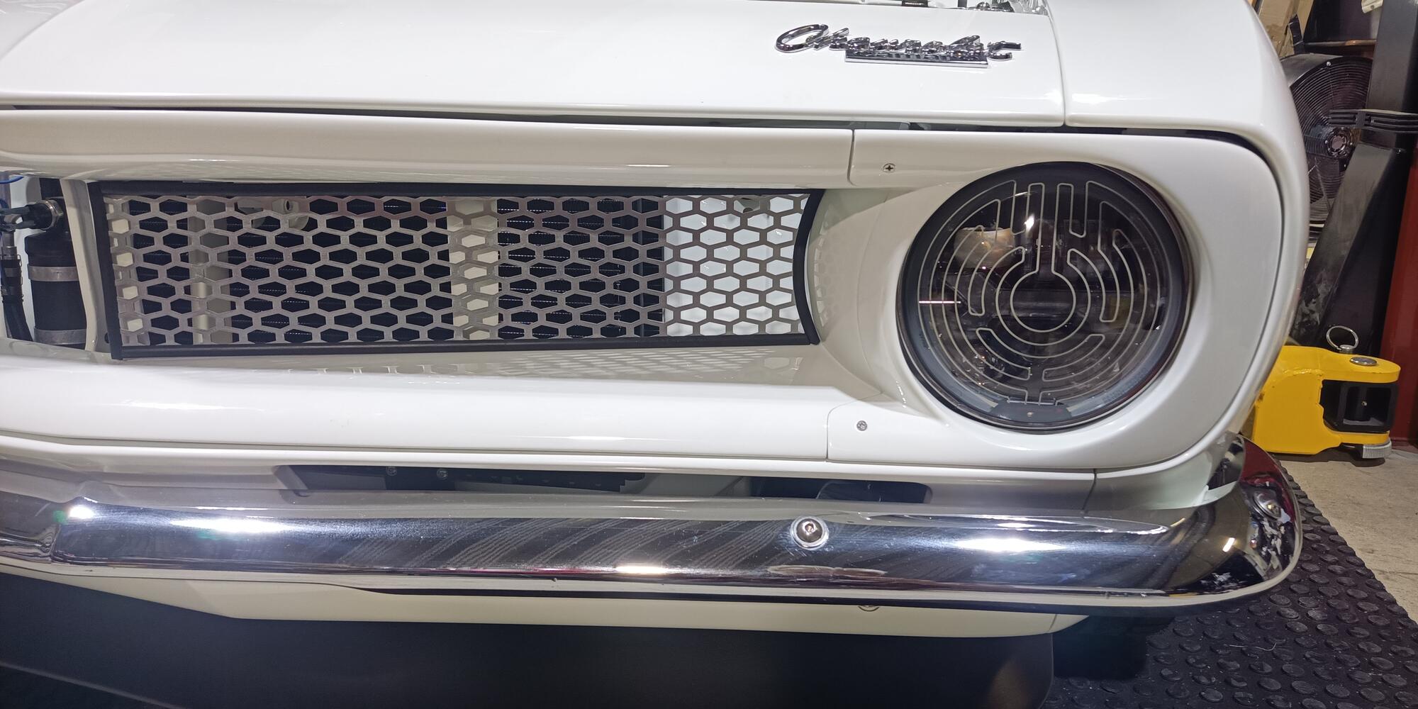

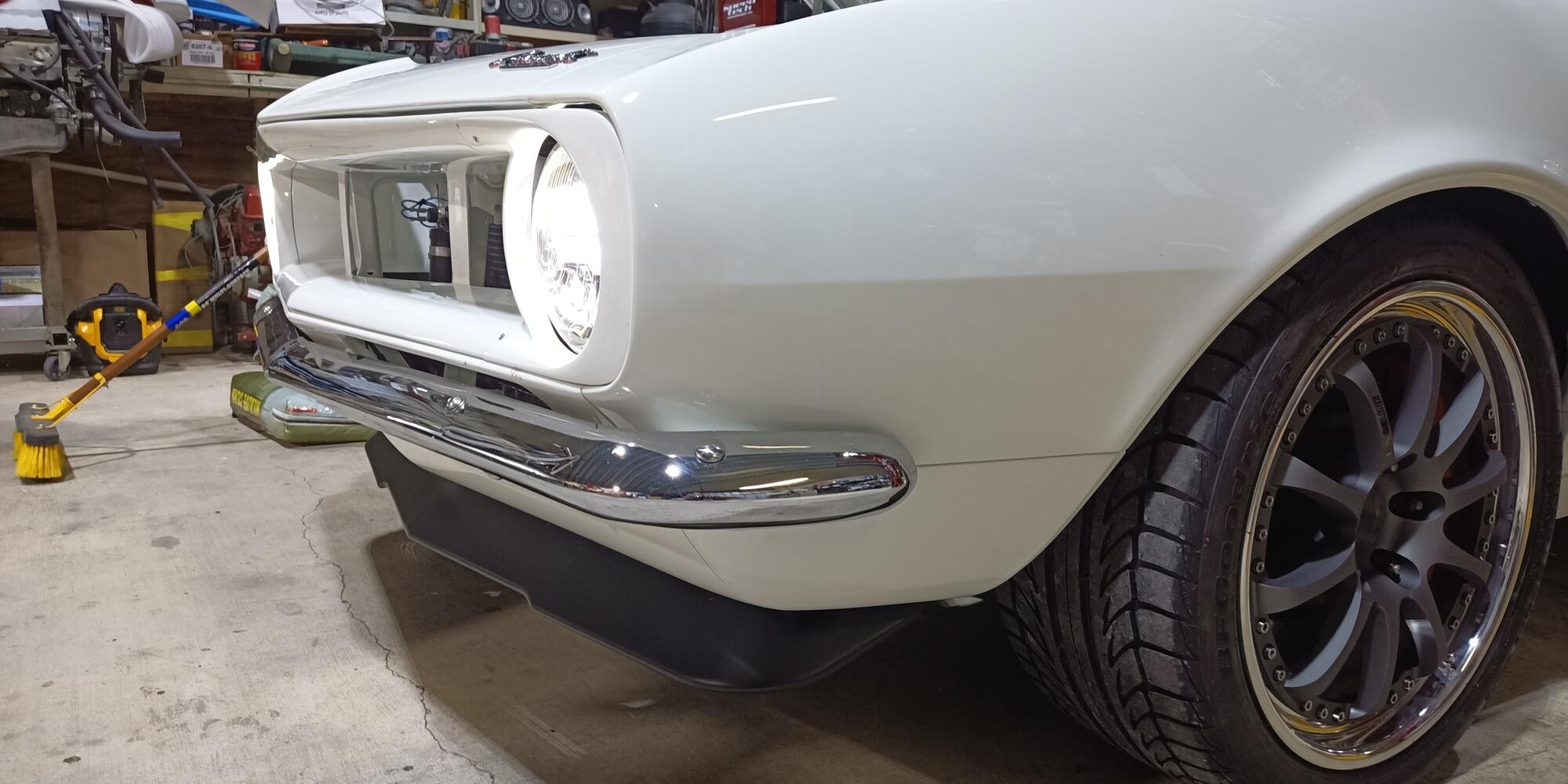

      Ok so I'm tinkering again. I installed my LS7 emblems and I think they look pretty good. I also cut a grille pit of some aluminum mesh. I lined the outer perimeter with se black rubber for the pop effect next to the aluminum grille and white grille surround.
      I'm happy with the end result.Name:  IMG_20220802_205113.jpg

      Grille looks good.

      Digging that front grille Jason. Looks great.
