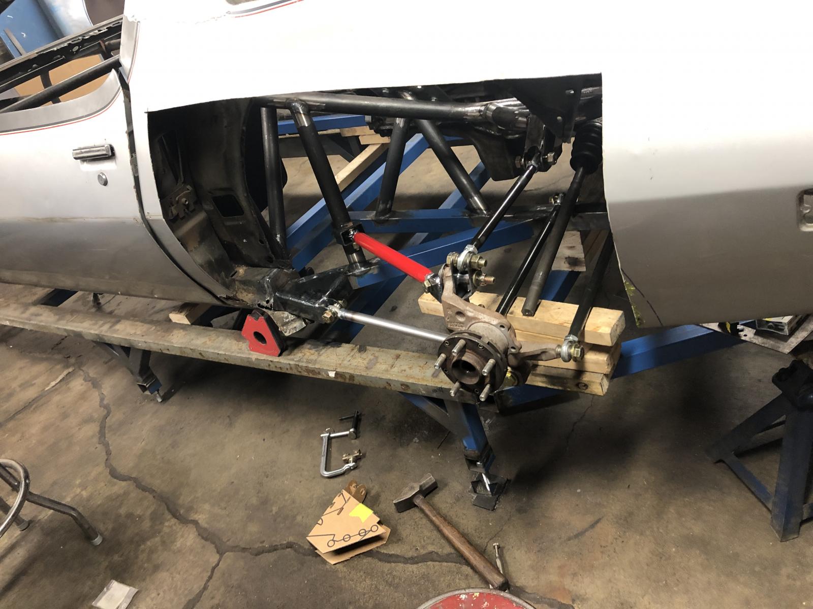

      Here is one side completed, Everything is tacked into place. I checked how it went through its motions and I was pretty happy with the result. I Had a pivot point in the wrong point causing the the wheel to lose all camber going up (+) when it should be negative. Now the other side should be cake since I have already designed and cut out all the parts needed.

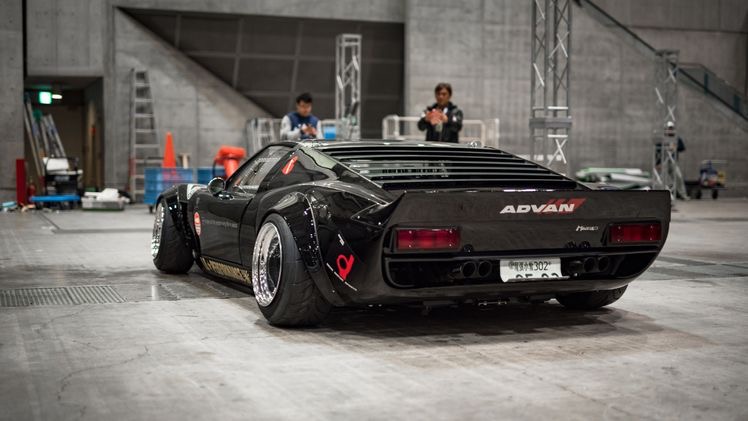

      look at post #26530 on p1327 of random transportation thread.
    13. #53
      Mar 2017
      Omaha, NE
      54
      Quote Originally Posted by jlcustomz View Post
      Wow, I just checked that out. I’d have to figure how to make something like that. But it would be perfect. Thanks for sharing.
    14. #54
      Jun 2012
      South Lyon, MI
      1,244
      Yup. That's cool.
    15. #55
      49,371
      at least I know people check out the Thread! lol
    16. #56
      Aug 2008
      jacksonville,fl
      972
Size:  133.5 KBName:  post-222-1545187394.jpg
      TC has some useful stuff in there. Sometimes random turns into hits the nail on the head. I think he checks out our stuff too.
      2nd pic would be a much easier to fabricate option.

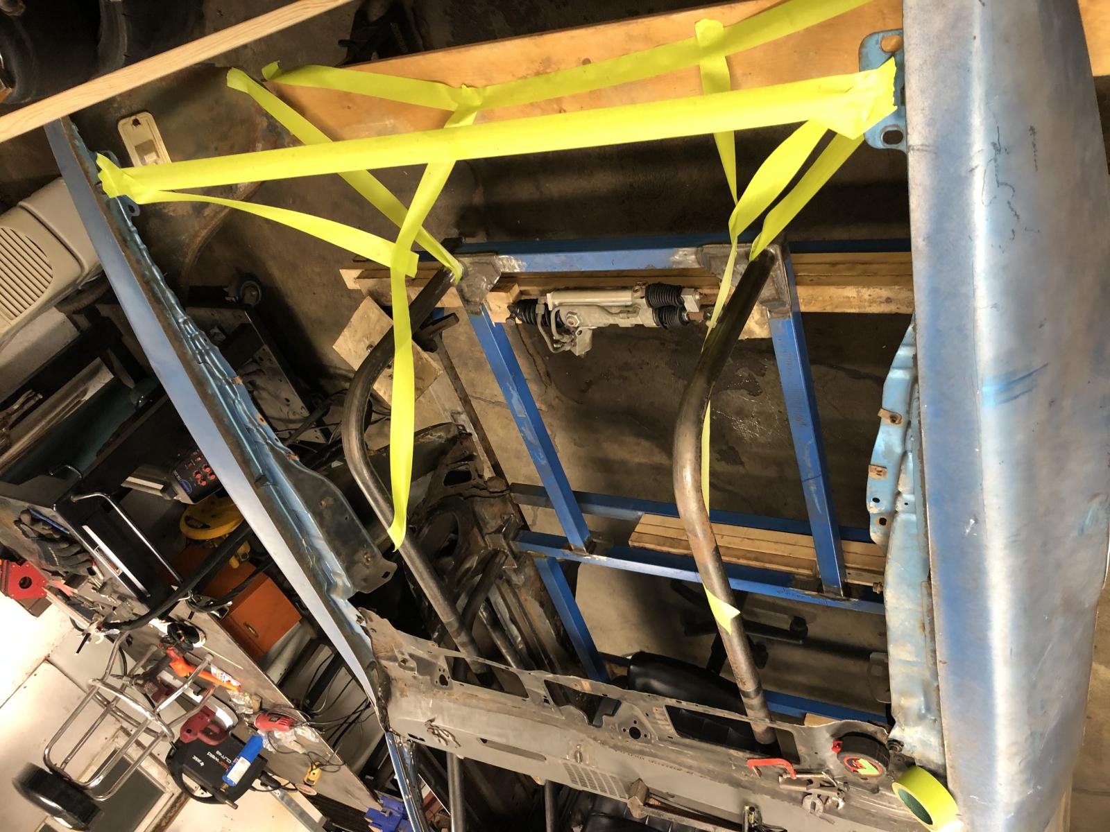

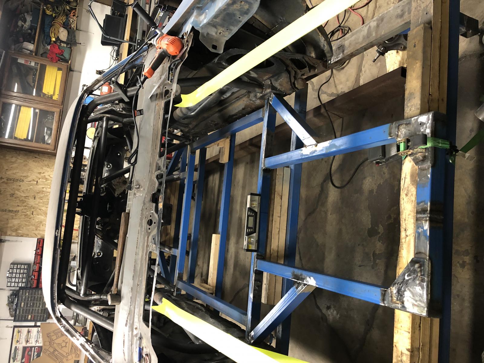

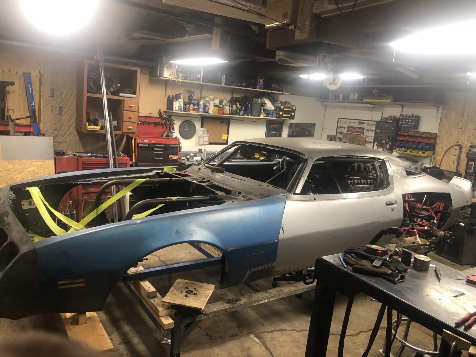

      I’ve been. Little busy the past few weeks so it has taken a while to get things done.
      I got all the driver side rear suspension pieces cut out and assembled i have everything tacked in place in case I need to move some things down the road.
      This last weekend I kind of got a game plan on what I want to front end to look like. The tape is the easiest way for me to visualize things. Name:  44681E30-282E-4AA5-AF36-EFAF99AE7829.jpg
Size:  196.1 KBName:  79AED349-8E19-4501-B048-B4650FEA981D.jpg
Size:  218.6 KBName:  E55CBE0B-0155-4456-9A40-C3CF4503EE3A.jpg
Size:  254.9 KBName:  43847103-5793-40E2-A542-614A6AF965D8.jpg
