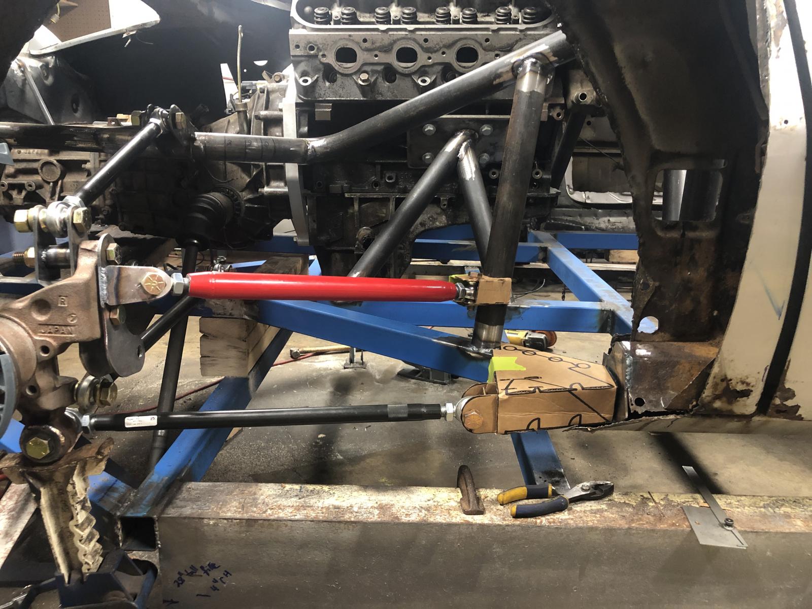

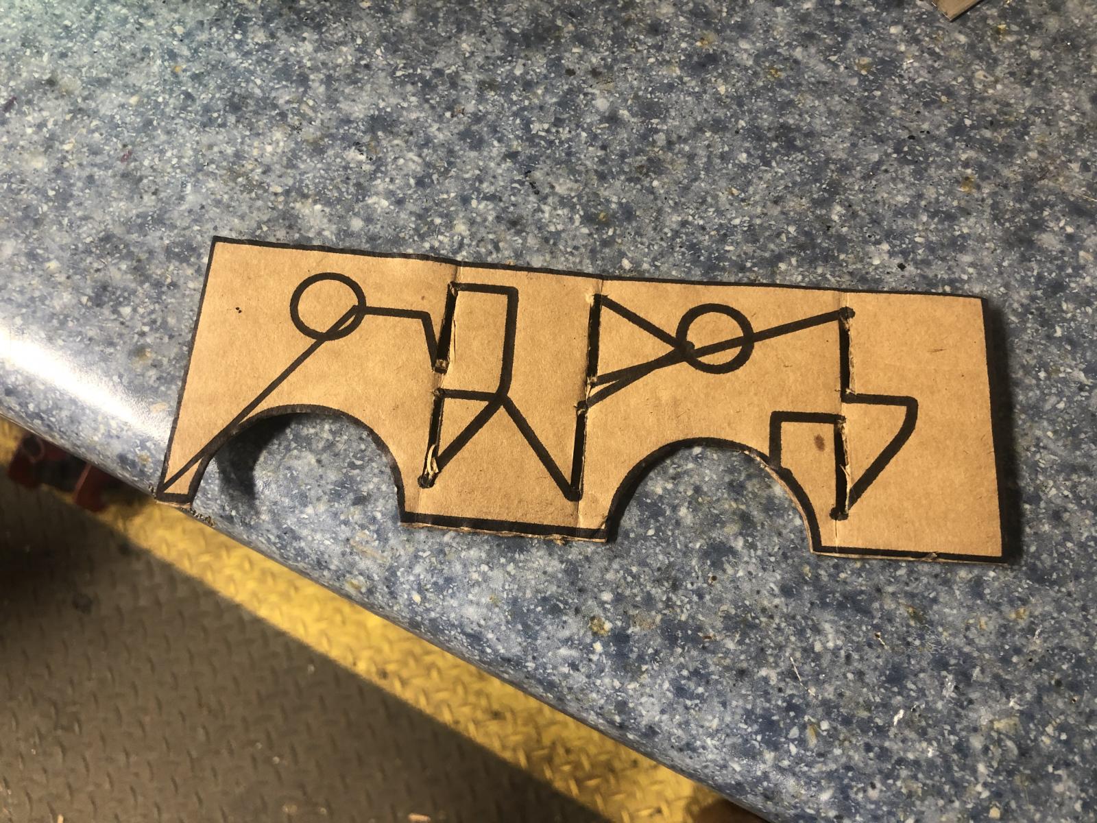

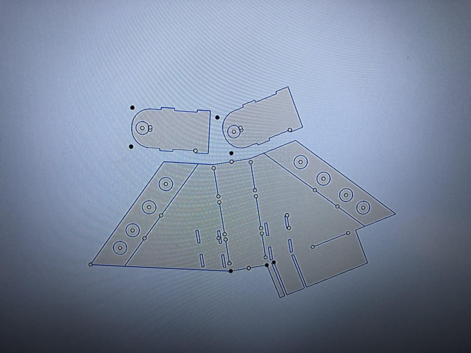

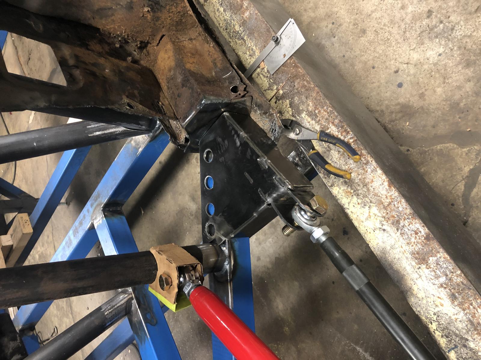

      So over the past couple days I have been working on designing the rear suspension on the car. I’ve had to make a couple conversion parts, but the hard design work had been done by Factory five. I just duplicated what I saw on their diagram for the part. The front two bars had me thinking for a while. But this is what I came up with.
Size:  354.7 KBName:  B63CE6D0-7C13-4ACC-9F69-68445F1A6CBC.jpg
Size:  257.1 KBName:  8F9741DB-935E-4680-AD18-1CF418A8C6F6.jpg
Size:  338.2 KBName:  B2C09BB1-64D2-458F-88B0-6FFAF6AE0BD0.jpg

      I now have serious tool envy. I want a small CNC plasma so bad. Nice work there.
      That arm layout looks so odd to me after I look at more traditional control arm setups (pure observation, I see nothing wrong). Are you somewhat following the factory control arm layout from the Subie?

      It is based off of the 818 kit cars design and they basically followed Subaru’s design. With a modified spindle and replacing the strut with an upper control arm. I am trying to follow the basic concept based solely off what I have seen in these pictures and the limited knowledge I have from studying suspension design and tuning. What could go wrong 😳
