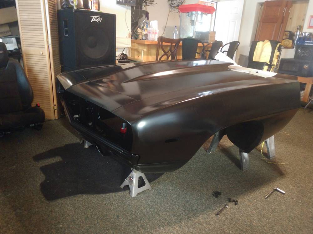

      AME front subframe has finally arrived along with new doors and front sheet metal from Real Deal Steel...time to get back to work on this baby.Attachment 167037Name:  IMG_20190719_154515904.jpeg
Size:  77.8 KBName:  20190828_173858.jpeg
