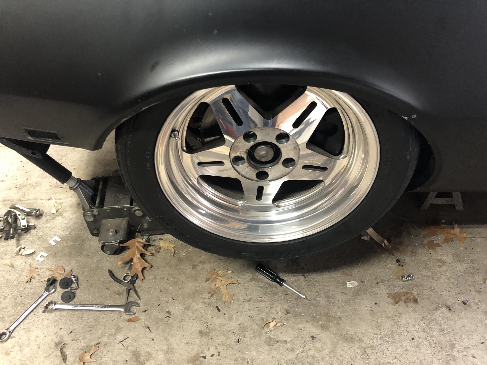

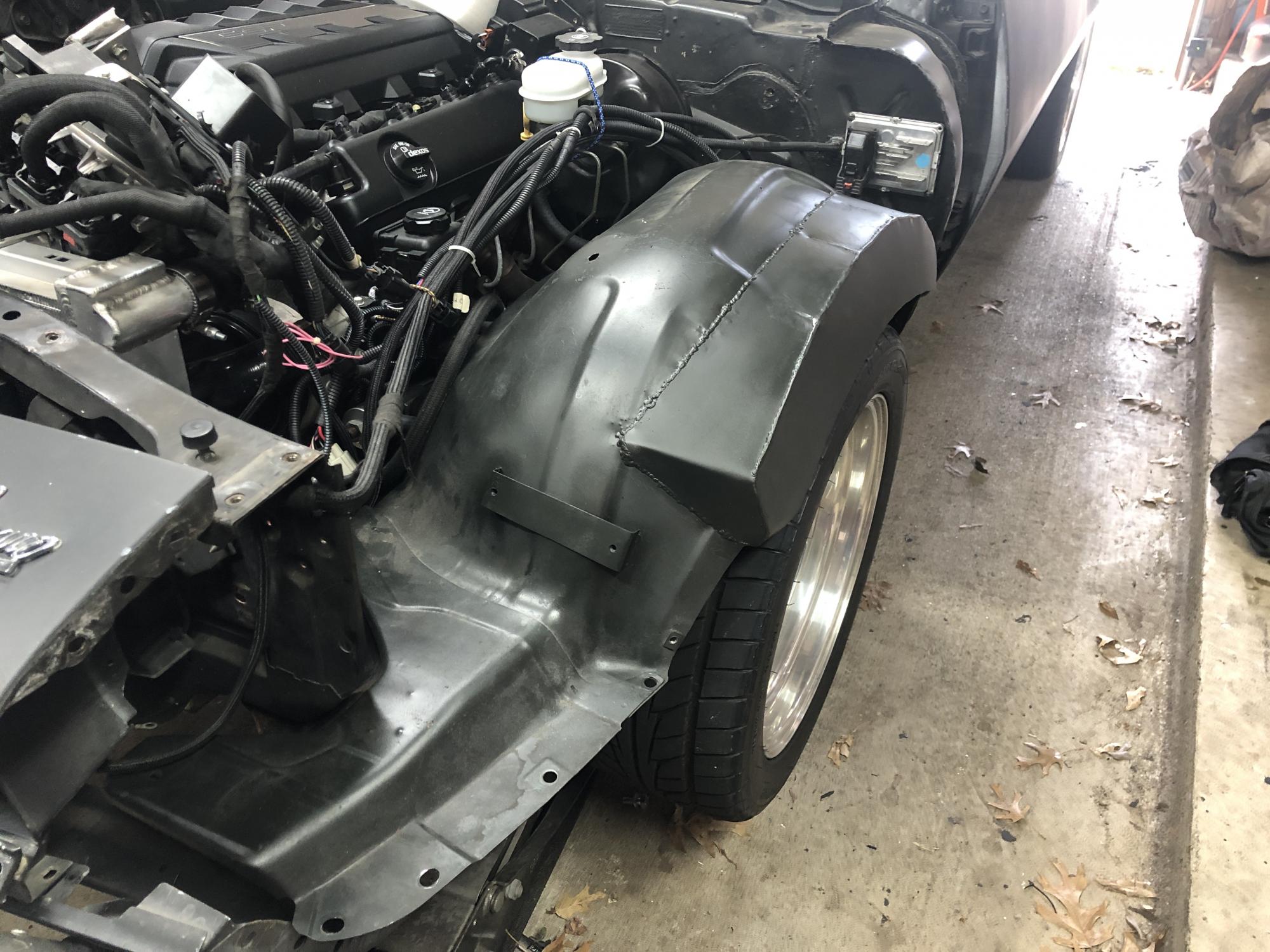

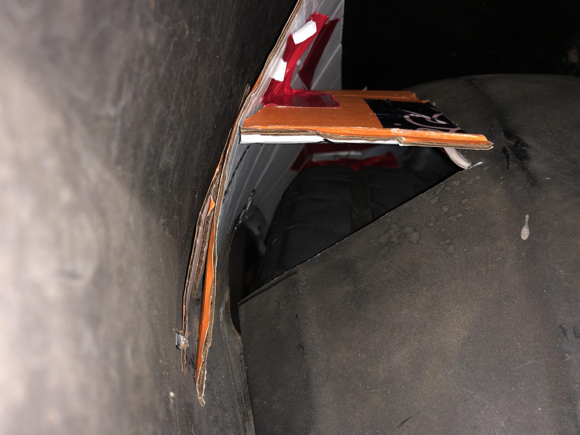

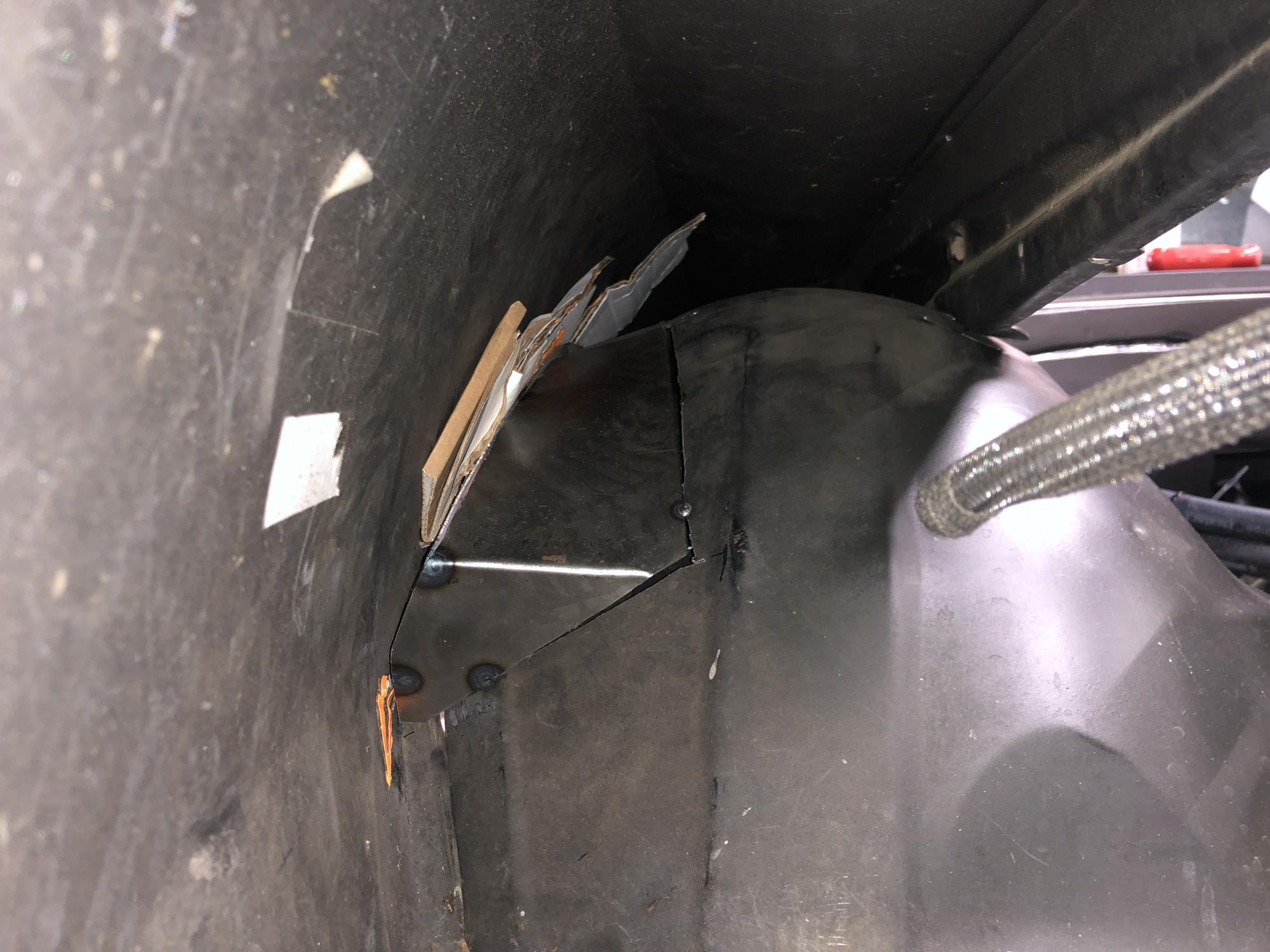

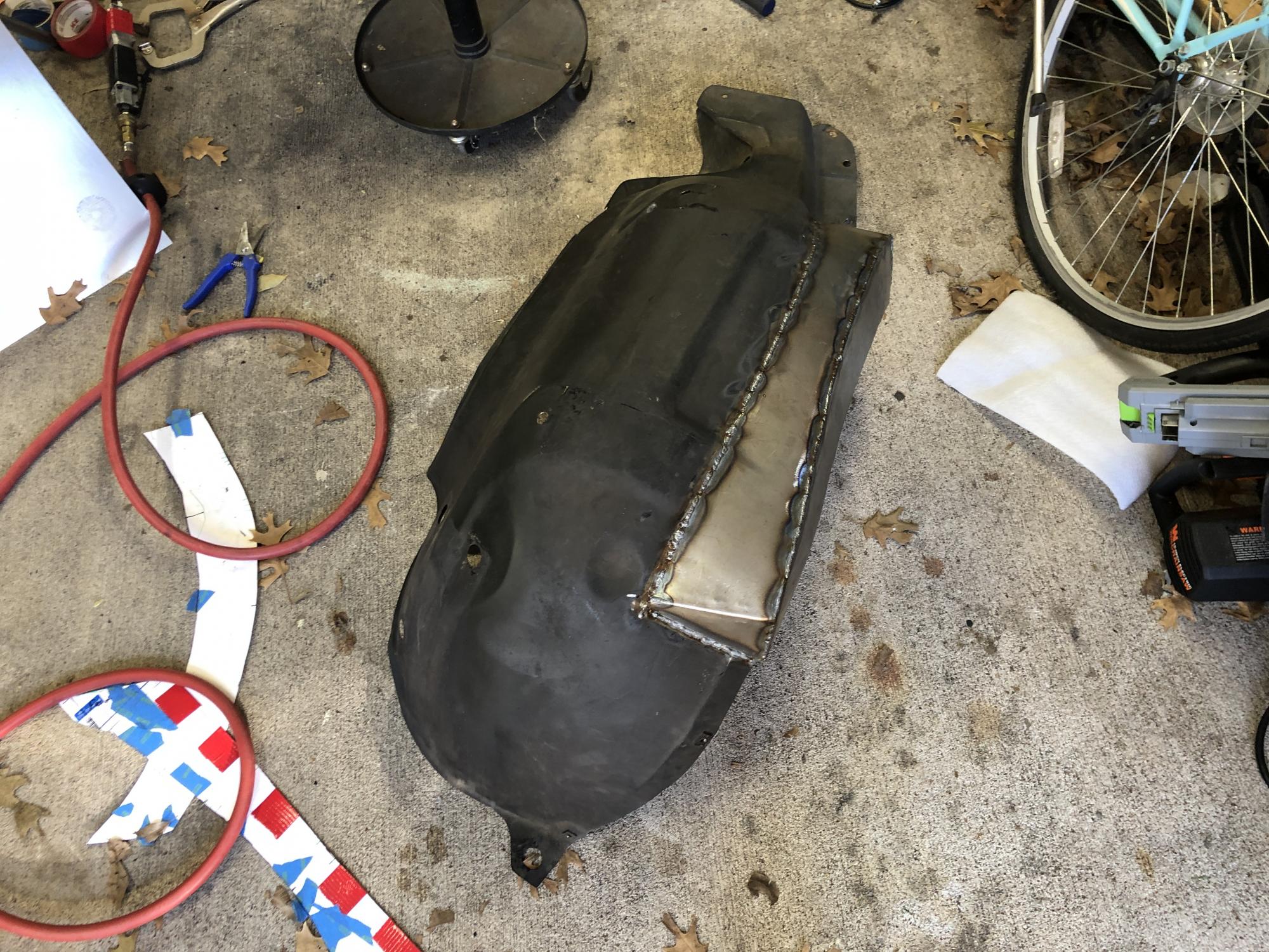

      I haven't updated this in a while but wanted to give an update for those who were following. My 8" wide wheels with a 4.5 backspacing up front would rub a little over large bumps on the inner fender so I decided to "mini tub" it. Turned out great and didn't take too long to do. Needed to get this sorted before paint so I would not mess up the new paint. I've got much more room, no rubbing and could setup up the wheel/tire width quite a bit if I want to later. Pics are a little out of order.Name:  IMG_2632.jpg
