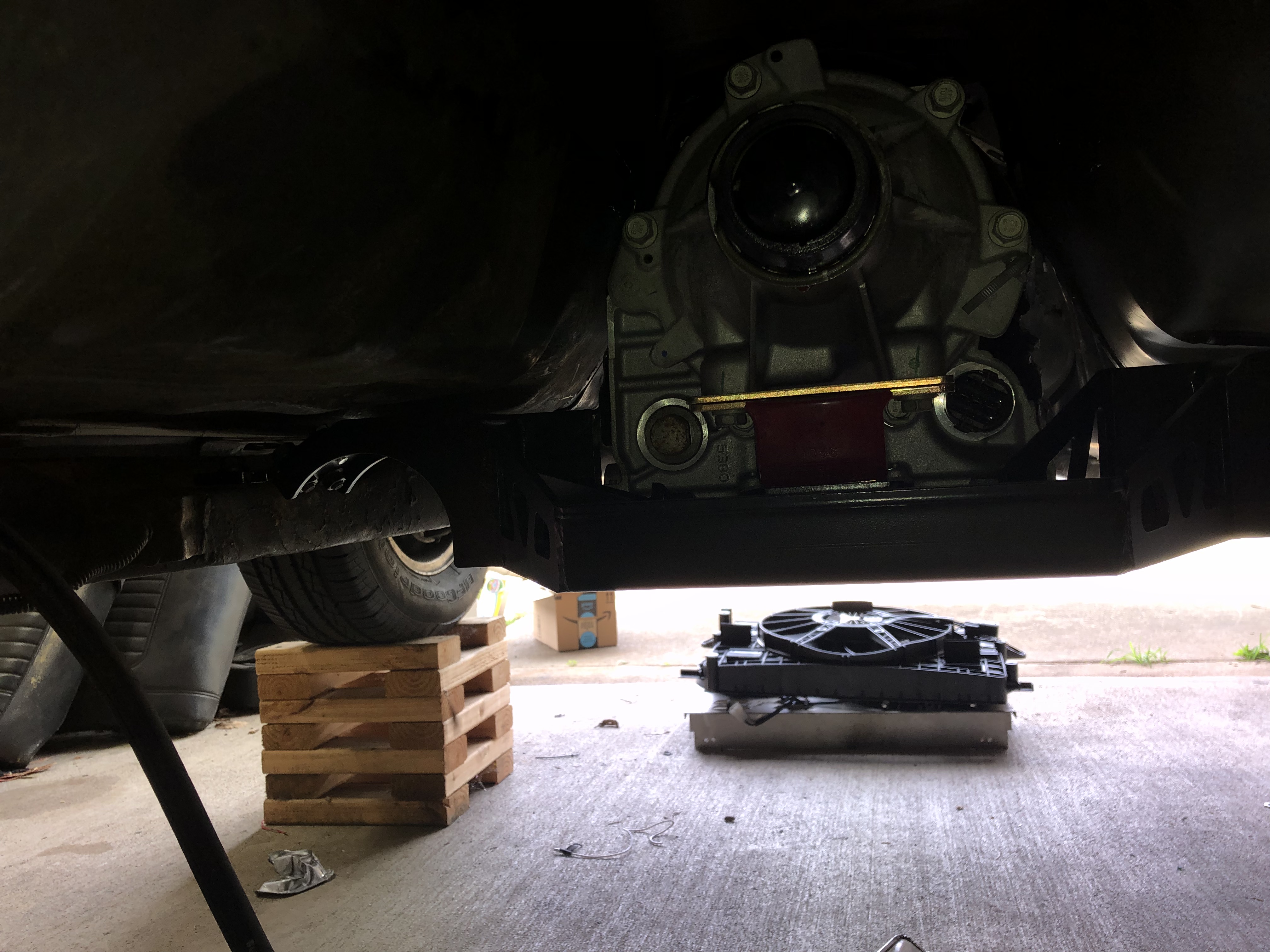

      Now that I have stuck the motor in and out I figure it will be the last time I stick it in so I decided to test the fitment of the trans inside the raised tunnel. Of course, as I finished sticking it in I remembered wanting to shave down the power steering box a little to clear the headers as mentioned when test fitting them. I might be able to keep the motor in there while I do it we'll see.
      Here are some pics of me sticking it in there trying not to dent the firewall. Speaking of firewall, I took off the cowl vent and hammered out the remaining dents and put a little filler and smoothed it out some. Came out nice, not perfect but easy on the eyes haha.
      Trans has plenty of room in the tunnel and the ground clearance is good. I have not seen the trans pan on the car version of this 10 speed but the truck version's pan is not deep in my opinion. The trans is currently sitting on the stock crossmember and a 2x4. The crossmember was moved a few inches back by the previous owner to run the 700r4. I planed on using the same corssmember in the original position with a little cutting and welding to get it where I need it to be.
      Jul 2017
      167
      I ended up hacking up my stock crossmember (saw someone else do the same) and offset it a few inches back to accept the new trans. The height was not changed, only the rearward position. I had some 1/8" plate laying around and this is what the stock crossmember is made from. It crossmember is very solid but the weight of the trans worries me a little for some reason. I think I'm going to stiffen it up a bit and clean up some of the tall edges that kiss the floor a little. I placed a spacer between the crossmember and mount so I could drop it a little if needed to get the angle corrected once the car is together. I also have quite a bit of room to raise the trans if needed too.

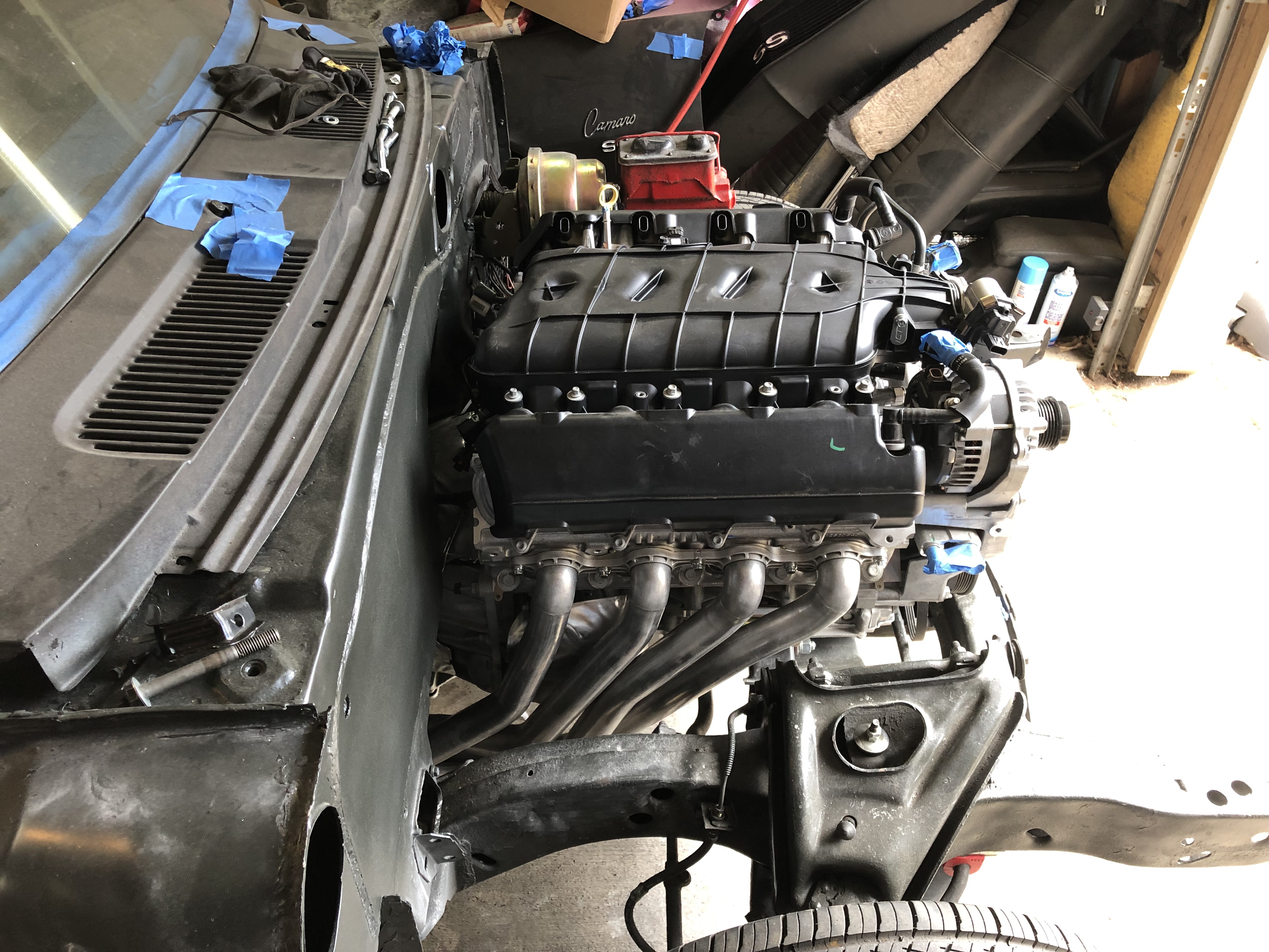

      I also received my ICTBillet power steering pump bracket and installed it. Due to my position of the motor this bracket hits my a-arm and will not work for me. Like most things with this car plans have now changed. I'll be returning the PS bracket and going another direction with my setup. I have found a replacement accessory drive from Drive Junky that is pretty nice, it keeps the water pump so thats cool but I cannot use my factory compressor or vacuum pump. I should get the new drive installed in the next couple of weeks.
      Jul 2017
      167
      Got my headers installed! I ended up needing to massage the steering box and one of the tubes slightly to get them to fit due to the motors position in the car. These headers fit tight against the motor as advertised, this presents a small issue with the new Holley trans crossmember I'm installing. The PS header does not line up with the exhaust relief cutouts on the crossmember. Easy fix, just need to rout the exhaust over a bit, I post some photos of this later on. Another issue was the DS header flange had an issue sitting flush on the head, it seemed to be bulged out a hair in the center, hopefully the gasket and bolt torque will account for the misalignment issue. If you hold a straight edge across the header flange its off by a few thousandths in the center. PS header also clears the factory starter heat shield so thats kind of cool.

      I ended up changing my mind about my hackjob crossmember I made and figured I would purchase a Holley crossmember and hack it up instead. I found a post on ls1tech where a guy used a T56 crossmember to install his 6l90 so I figure this would be a good starting point.
      Sorry for the lack of photos, I away from the car but I'll get photos of the crossmember installed later on.
      Here are a few pics of what needed to be done on order to make it fit. I had to cut out some of the diagonal gussets to clear the pan and then I had to lift the mounting position roughly 2" high and 3/4" forward to bold up to my trans witht he trans sitting at 3 degrees. Also reinstalled the diagonal gusset plate off to the side to maybe help keep strength.
      It ended up working out great and is way stronger than my hackjob crossmember. I did not want to risk hitting a big bump and the stock crossmember bend and screw things up so this should help that not happen.
      In order to lift the mounting point and move it forward I just used some leftover Ridtech axle tube tabs from my 4-link kit and the plate with the mounting holes came with the crossmember, I guess it might be a spacer?

      Here are the photos of the trans crossmember installed. As you can see the PS header is tucked in real close and does not line up with the crossmember exhaust relief.

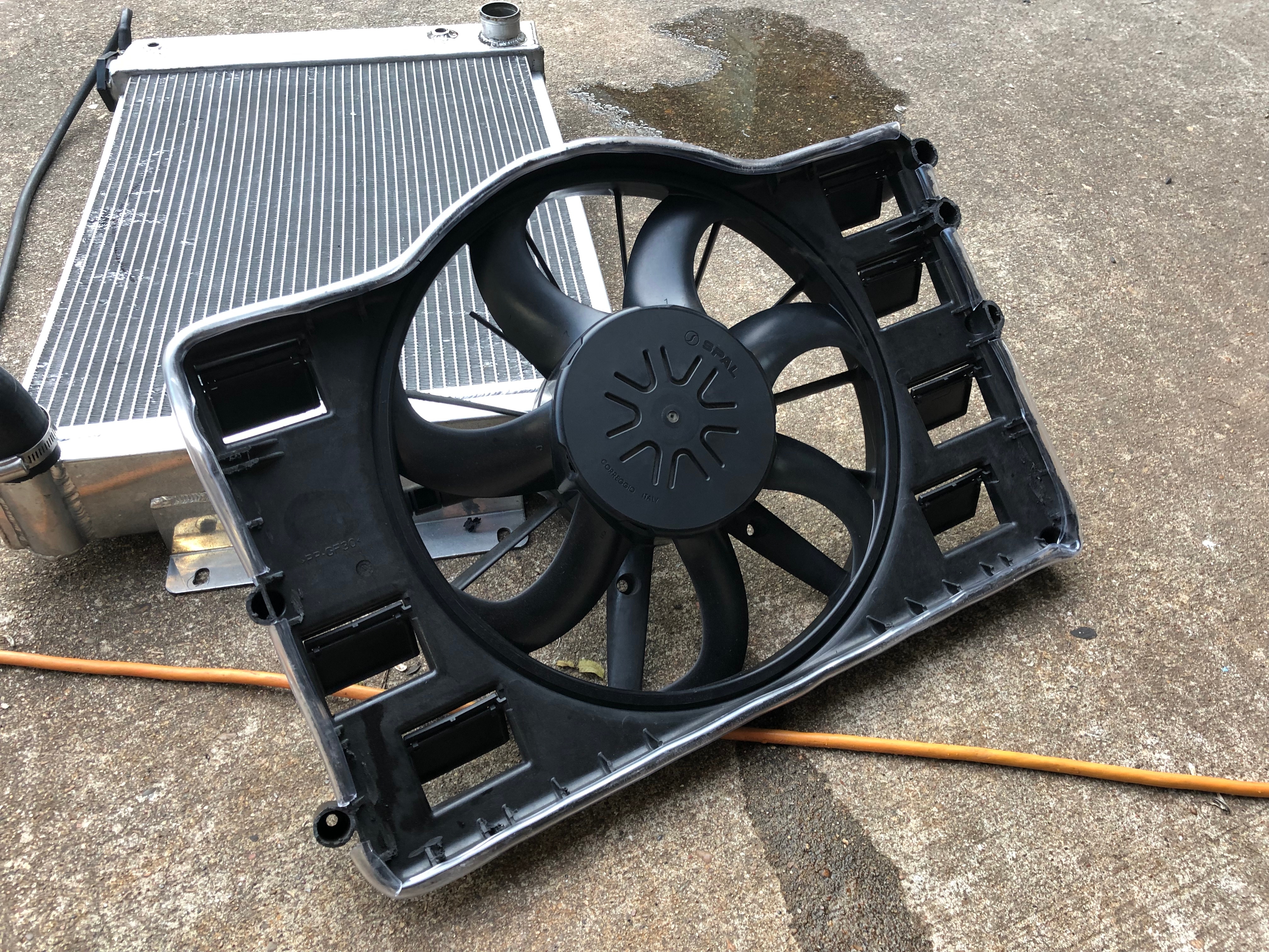

      I spoke to my harness builder/tuner and he suggested I use a pwm fan from a 6th gen camaro. The PWM fan is the easiest fan to setup and works well with the gen v stuff. From what I have read the ECM does not send out a reliable signal for a relay to activate traditional fans and the signal sent out is a pulsed signal. The best way to run traditional fans is with a temp sensor and a trinary if using AC.
      I was unable to find a 6th gen camaro fan for a reasonable price so I went with a C7 fan. Truck fans are also an option but they are a little too wide for my car. I spoke to Spal and they do not sell a shroud for this fan to so I ended up using the shroud that came with the fan. In order to use this shroud I had to cut off about 3/4" of the outside rim to let the fan sit closer to the radiator and make room for my intake. Added some rubber hose sliced down the middle to help get a better seal against the radiator. I also had to trim a little off around the fan blades to clear my intake piping. The fan assembly exposes a little bit of the radiator at the top, this should not be an issue as the C7 vetts have a ton of exposed area on their setups too. I used 4 ziptie style radiator fan hold downs to mount the assembly but I might add more reinforcement later.

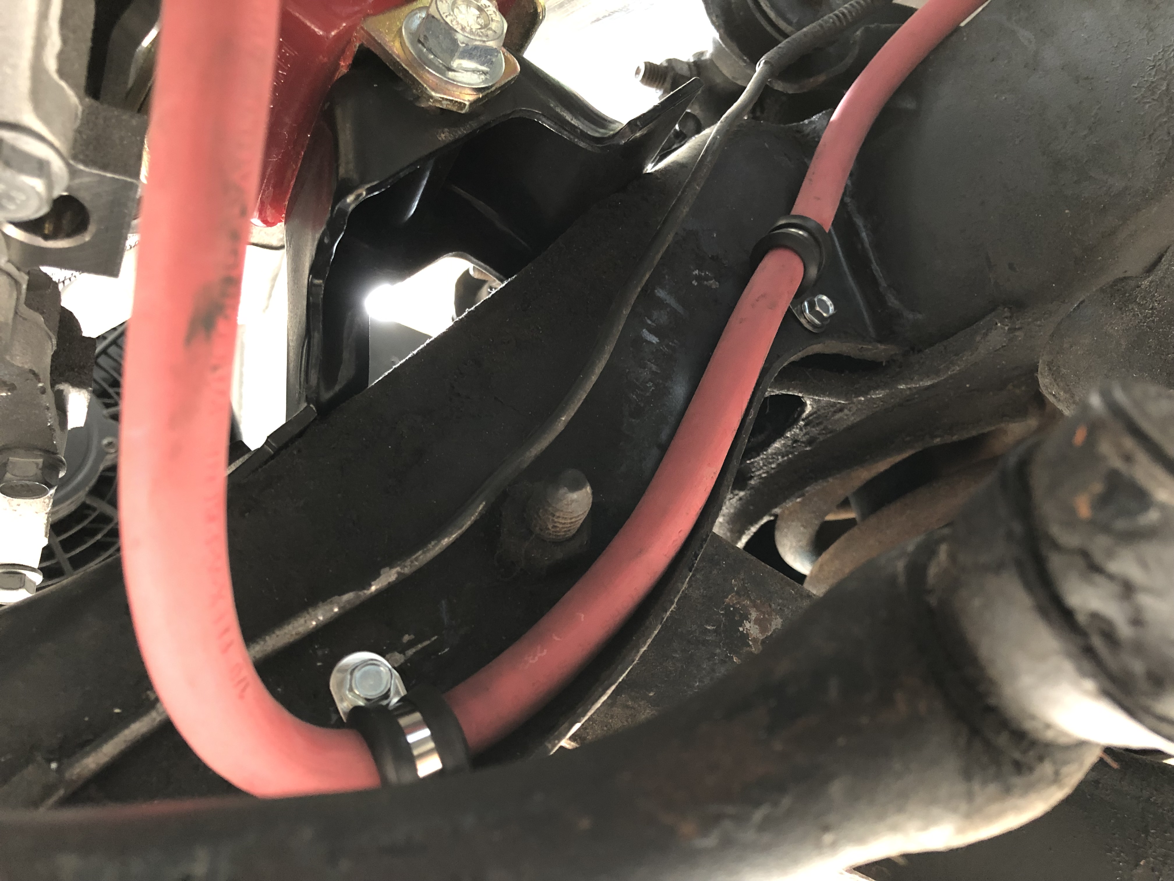

      I installed the power steering lines with earls hose and fittings on the high side and some push on barb AN fittings on the low side. I did not purchase enough hp hose so its not as hidden as I'd like but it will work.
