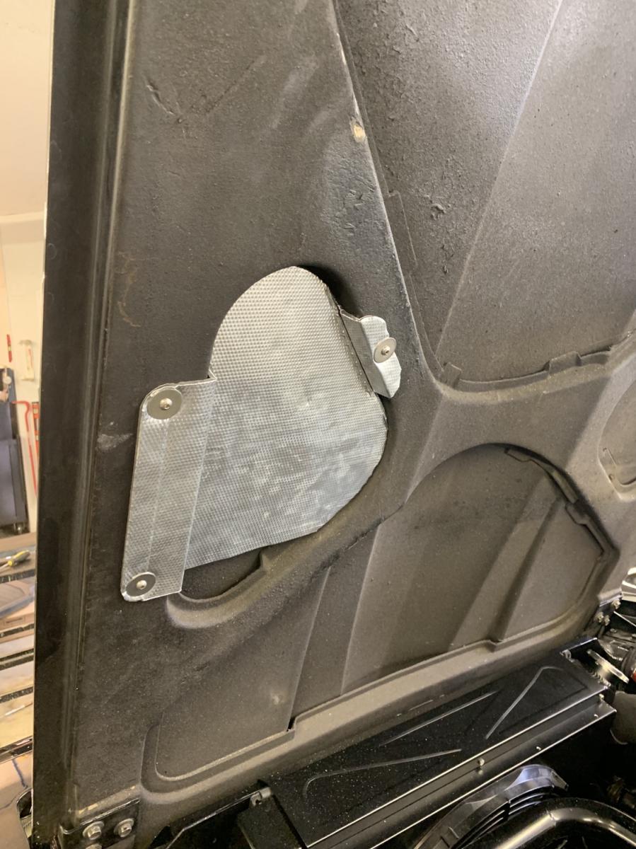

      Well, the hood is on. I feel like that is a good sign.
      Like pretty much everyone else, 2020 has put us through the ringer. There have been delays on this build but we’re moving forward and are finally approaching the finish line (fingers crossed).
      The car is idling with no leaks. This is big progress. We also struggled with the cooling system holding air pockets and have remedied that situation as well. Only some minor tweaking to the final overflow setup and it’s finished.
      These panels are fabricated to protect the hood just above the turbos. The location for these couldn’t have worked out better.

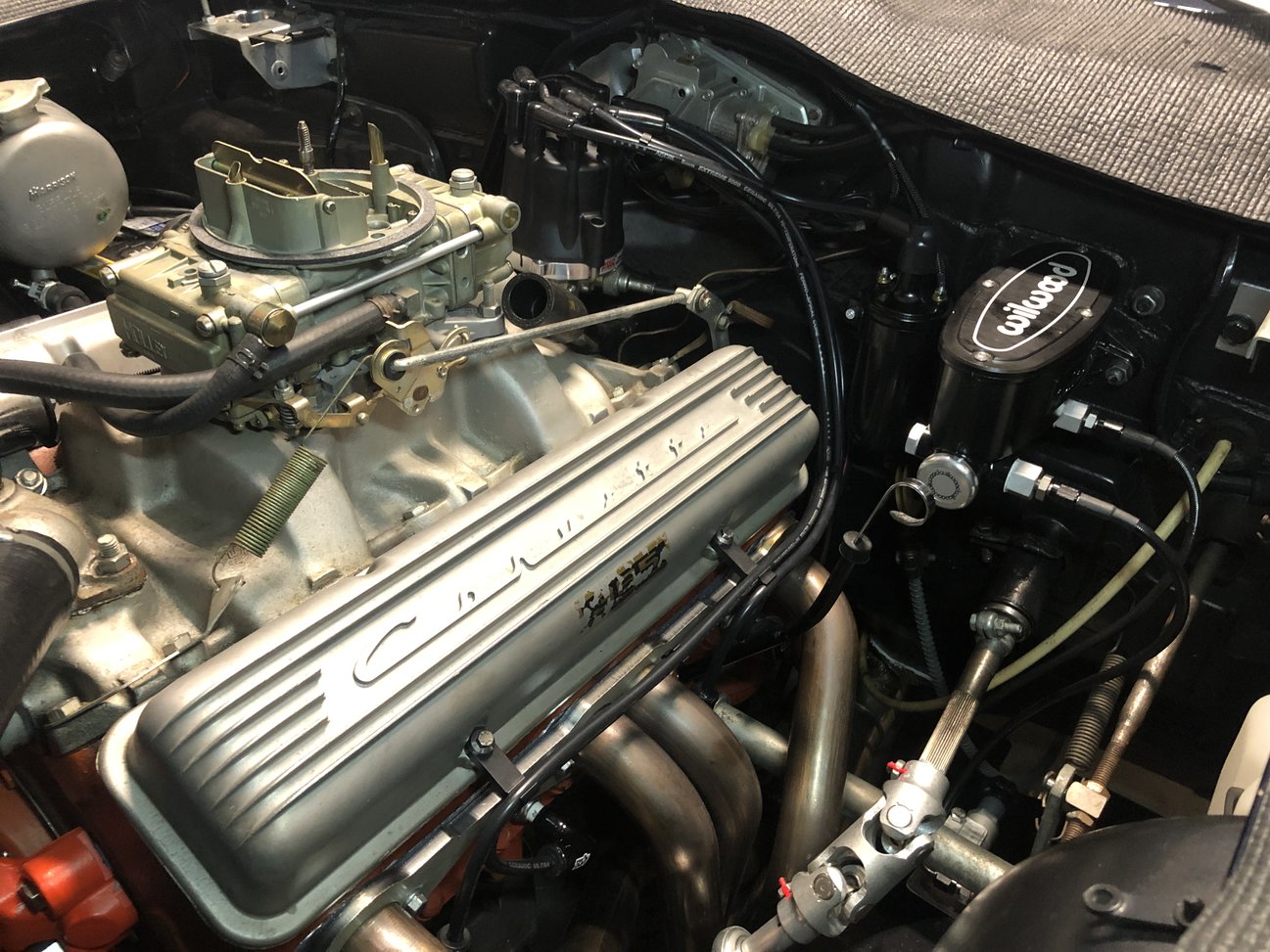

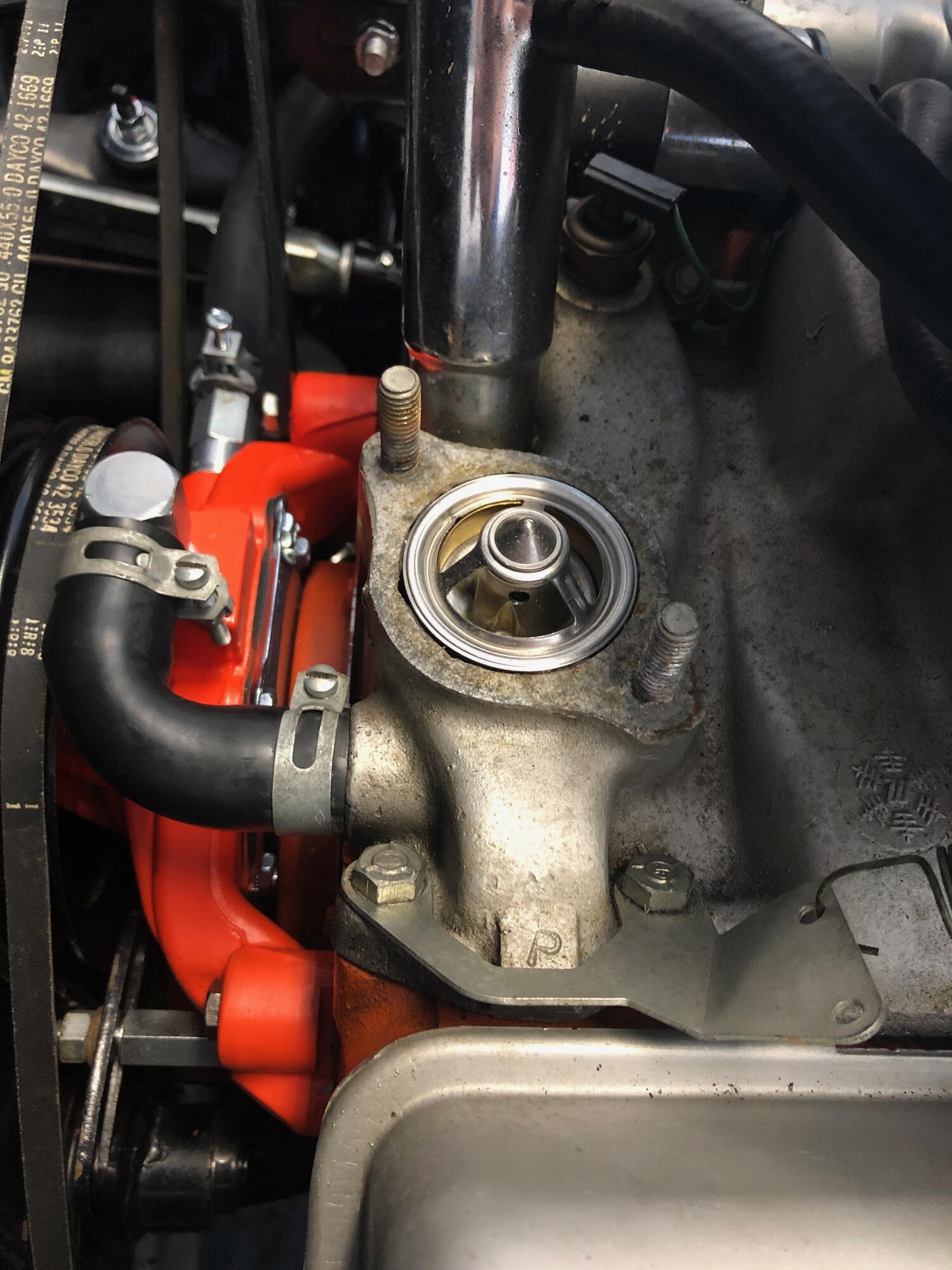

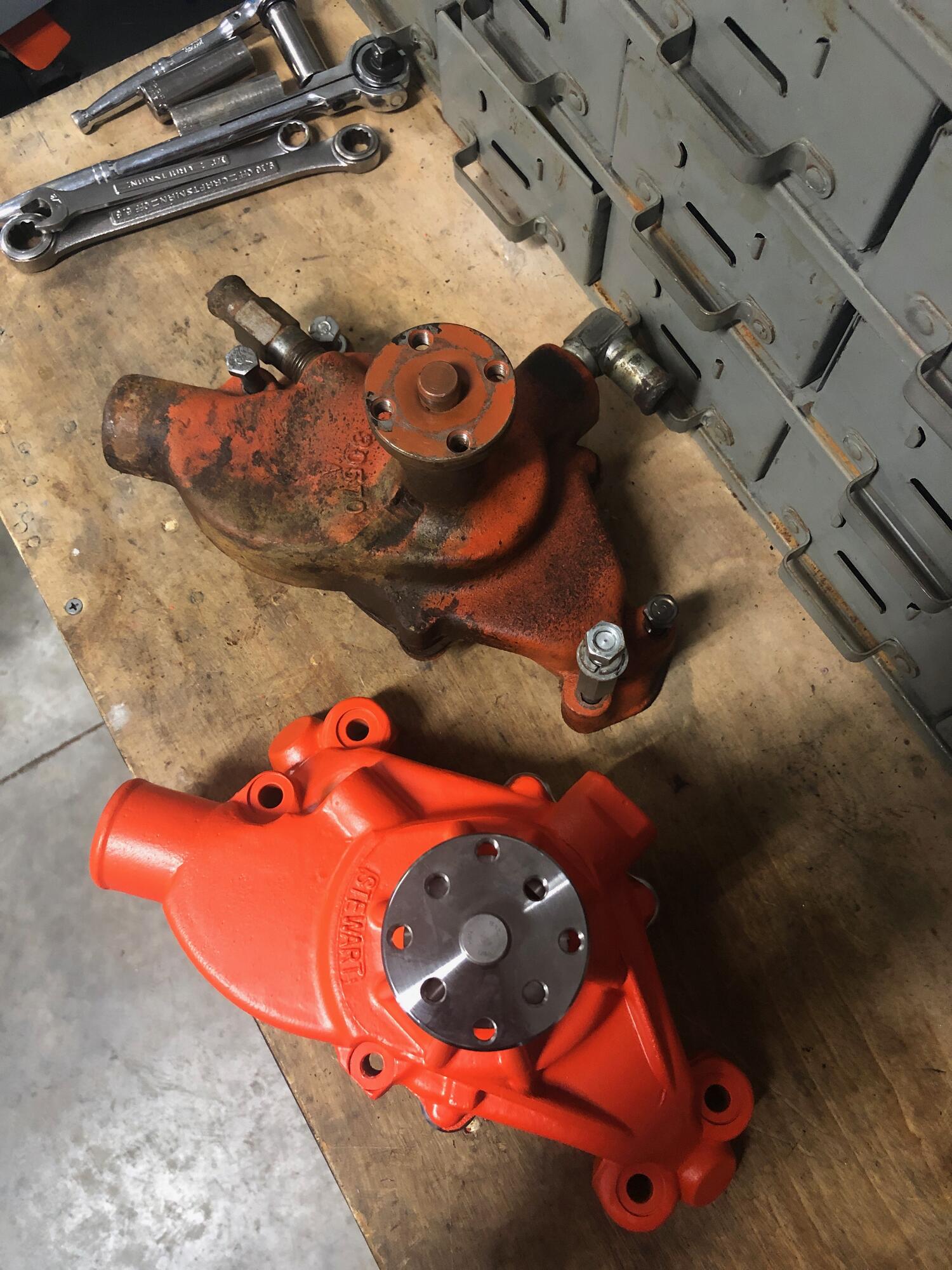

      This thread is long overdue for an update....though I don't have anything super exciting, as I've put more miles on the car, I've found plenty that needed fixing in the name of reliability.
      We'll start with my failed attempt at a dyno tune. Theres a local shop race shop that also does tuning, so I made an appointment as I knew the car was running pig rich, and I was sure the timing could probably be tweaked a bit. Abacus Racing started by welding two bungs into the exhaust just downstream of the header collectors in order to be able to use a wide band O2 gauge with the car on the dyno.
      All was looking good, but we found that timing was breaking up above 4K RPM to the tune of +/- 10 degrees...

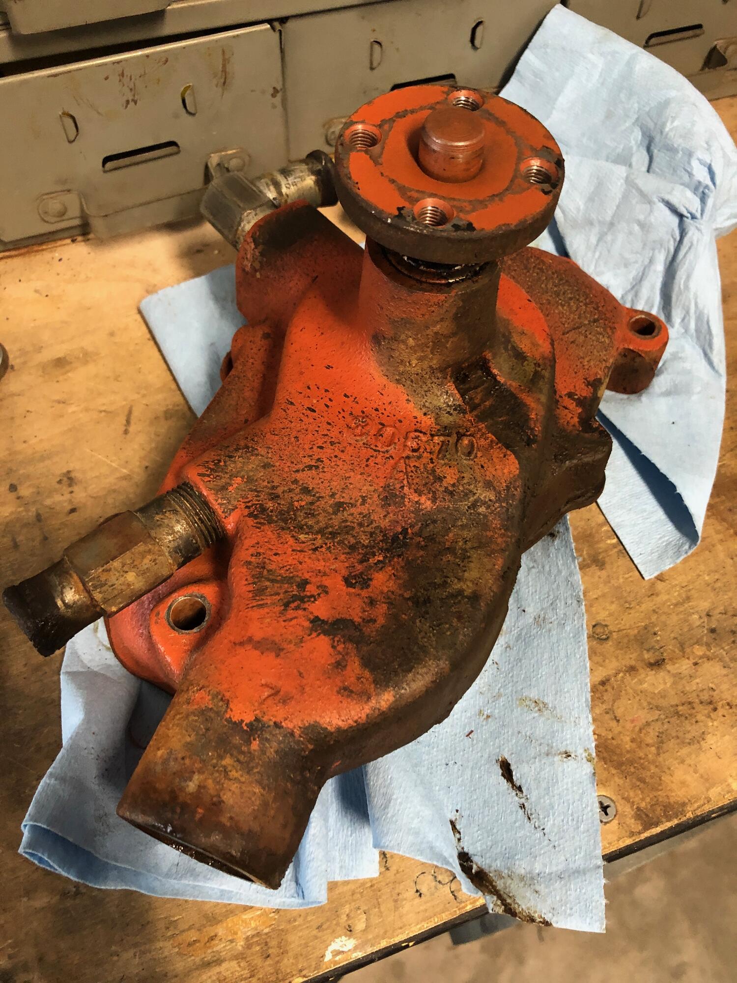

      On further investigation, we found that the stock distributor had excessive up and down play....roughly 4 times the factory spec. I looked into rebuild options, but found they were all far more expensive and time consuming than just switching to an MSD distributor and box. Additionally, we found that the original water pump was puking its guts out at high RPM, so a new water pump was in order.

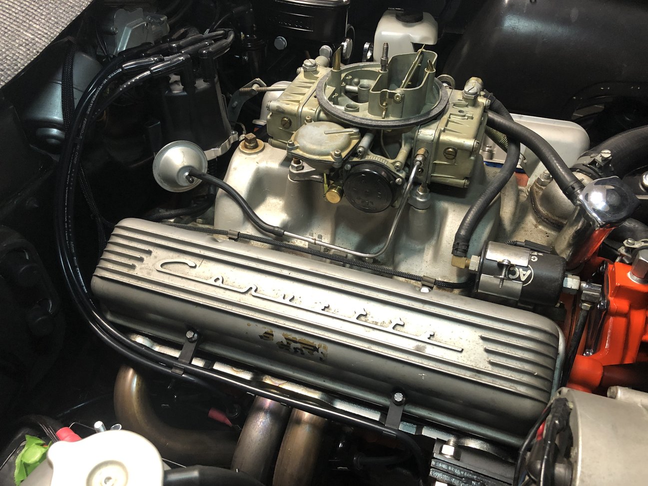

      So I moved on to a Stewart STG 2 aluminum pump, with the appropriate thermostat, and the MSD billet distributor, ignition box, and coil. I mounted the box inside the car, under the glove box. A lot of people complain about the MSD boxes failing, but generally, those same people have the box mounted in the engine compartment near heat. I used one of the mounting holes in the firewall for the factory sound deadening to install an aluminum grommet and pass the wires to the distributor. I used the same trick with the coil mounting bracket so as to not drill any new holes.
      I also cut up a custom set of wires using Accel's ceramic boot wires and some trick separators from Squeegs Hot Rods.

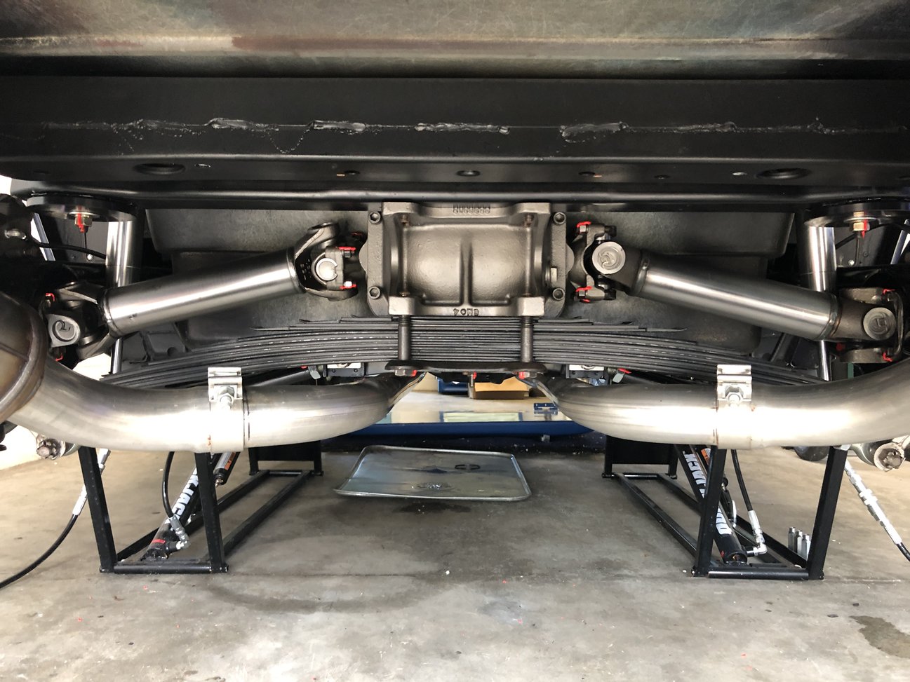

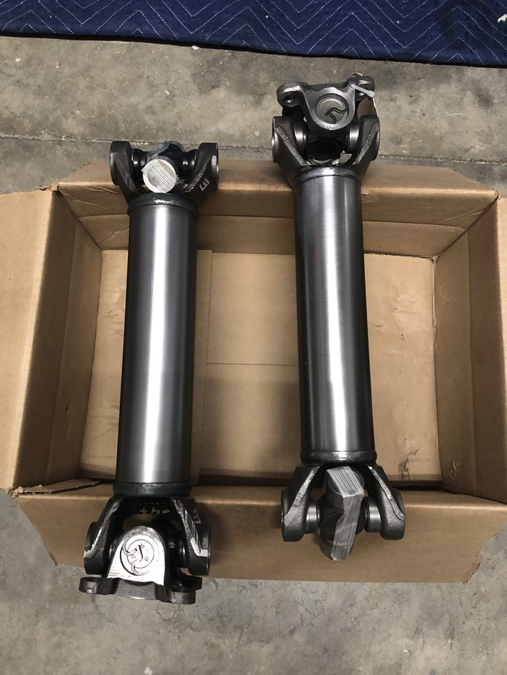

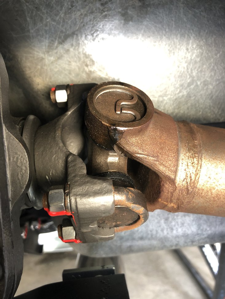

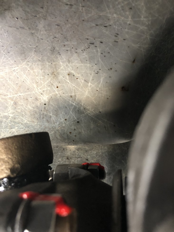

      Coming off the dyno, I also found that the factory half shafts were slinging liquified grease EVERYWHERE. So it was time for a rebuild...
      So that brings us pretty much up to speed. I've been driving the car regularly when the weather permits. It has a hard starting issue when its been sitting for a while, which I suspect is a fuel pump on its last legs...I have one on order. We're moving to Austin in June, so I need to get this thing completely sorted as I plan on a cross country road trip sometime in April to drop the car at our house and fly back as I dont trust Navy movers to move the car undamaged. Plus, I'm excited about a 4 day cross country drive taking only back roads in the car.
