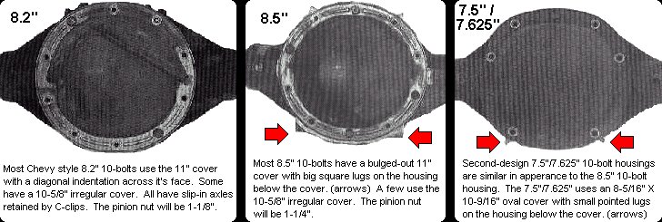

      You've got the 28 spline unit, I'm 90% sure. The late 80's/early 90's truck ten bolts (and a few select passenger cars) went to 30 spline.

      Probably an 8.2" also that are weaker than the 8.5s used in most second gens.
      Yes. I would agree. But check it, could be a nova 8.5, common swap.
      Mine is the middle one with the lower squares

      So what kind of medications can be made to a 28 spline, 8.5, 10 bolt rear end?

      Have the axle tubes welded. I'm an assuming you can get 30 spline axles for that housing off the shelf. Then you can get a new differential and step up to the stronger axles. That is what I used in my 2nd gen 8.5
