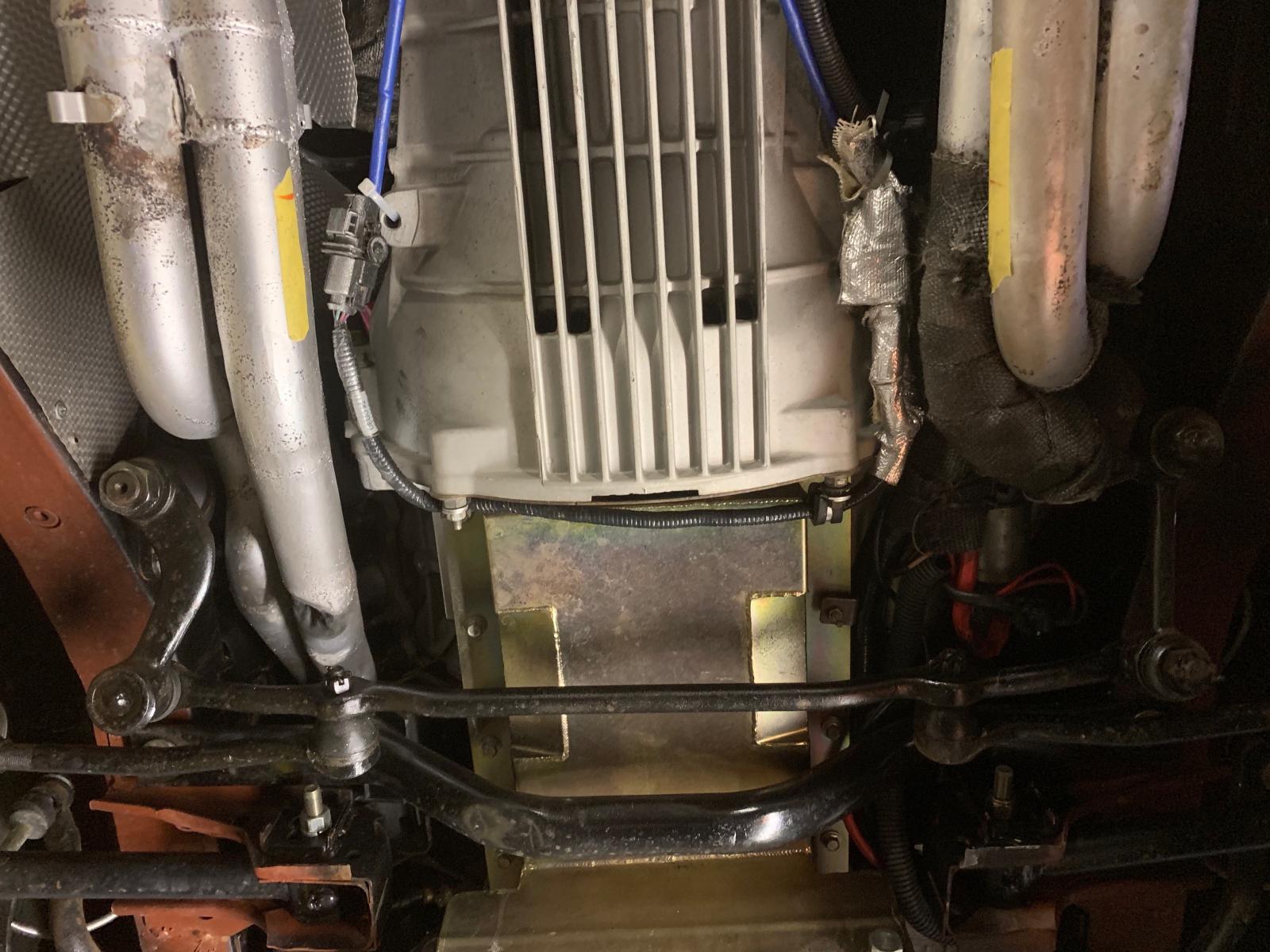

      1969 mustang 5.0L coyote swap. Please tell me the headers that can be attached to the gearbox's vehicle.
      I would like to exchange it.Name:  IMG_2201.jpg

      https://www.stang-aholics.com/i-2658...ll-finish.html
      Is this product attached?
      Normal, IL
      256
      Doug's headers makes a set, but they might hang low.
      Mountain Springs, Texas
      4,823
      1957 Buick Estate Wagon
      1959 Apache Fleetside
      Dec 2009
      San Diego, CA
      235
      Most of the headers listed work for eliminated shock towers. So I suspect they will not clear the steering box. From what I see, would it be easier to modify the one tube that gets hit by the pitman arm (I'm assuming your current headers fit around the box). So I gotta ask, did you do a coyote swap using a real boss 429 mustang?

      Quote Originally Posted by 1bad68cat View Post
      Standard Mustang is the only tower boss 429.Thank you
