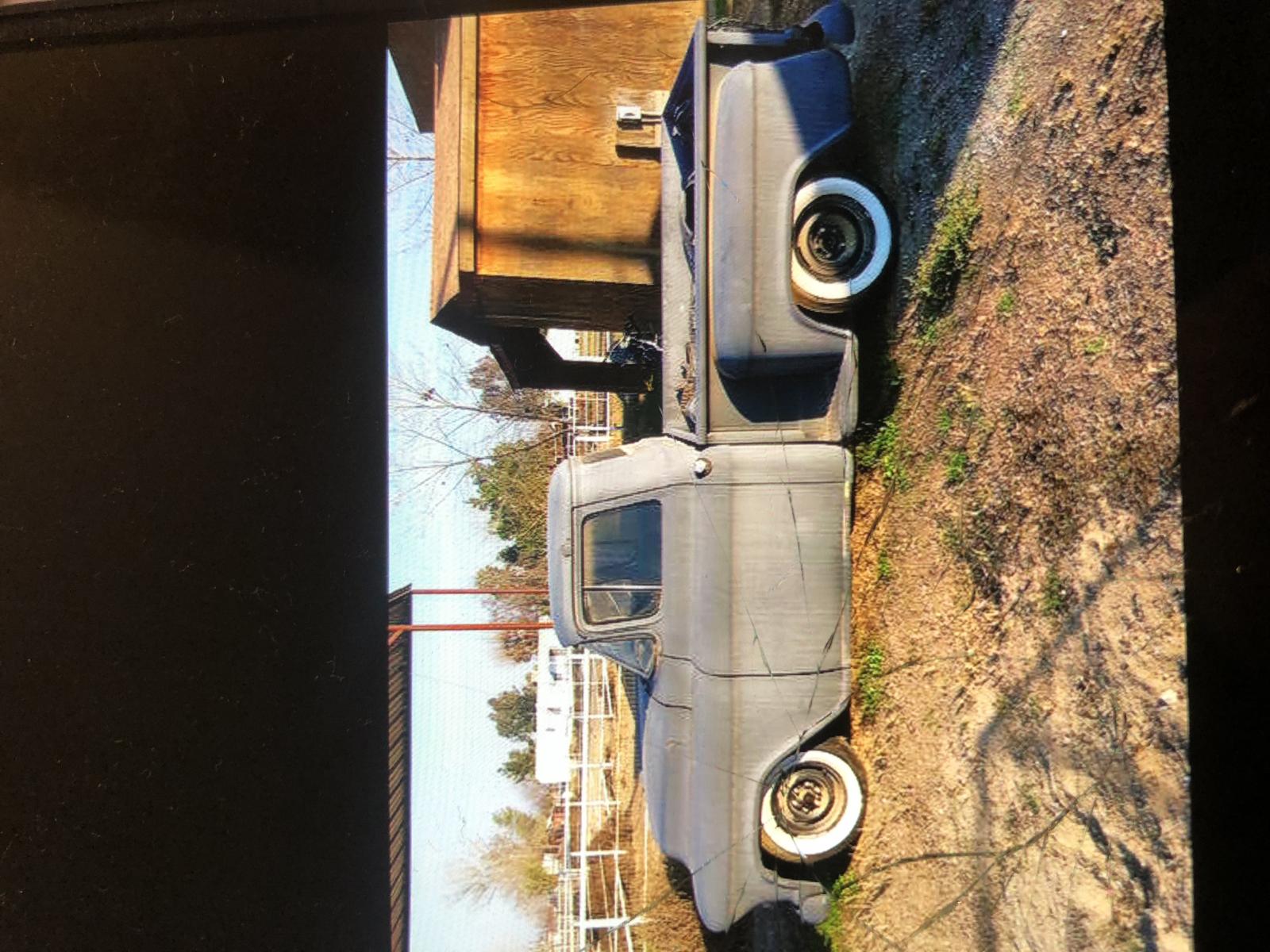

      Truck is super ugly and now in pieces. It was supposed to be built a couple years ago. But my best friends brother took my truck and was supposed to build it. Well long story short he stole both of my motors, aluminum fuel tank, wheels, steering column and some other stuff so now I’m back to square one. That’s why I want to get it on the road and drive it with my kids. So that’s why I’m keeping the axle since it’s already in it

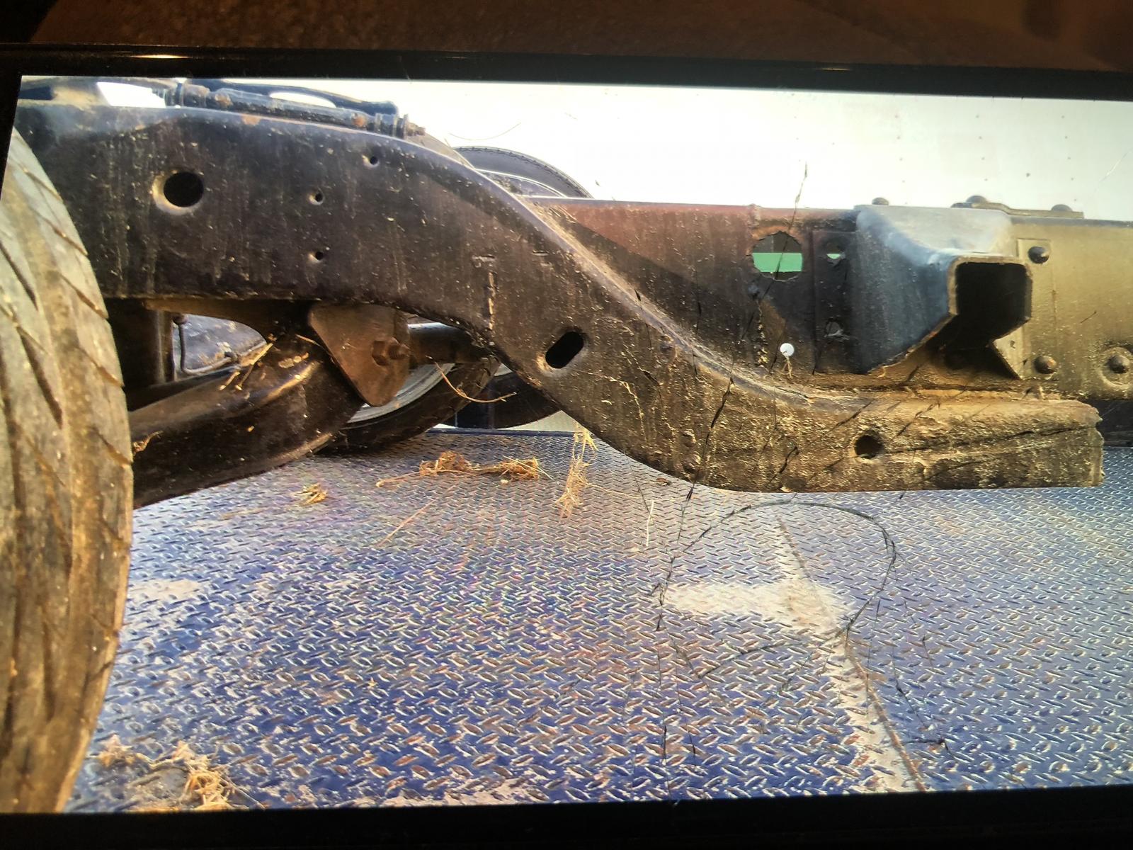

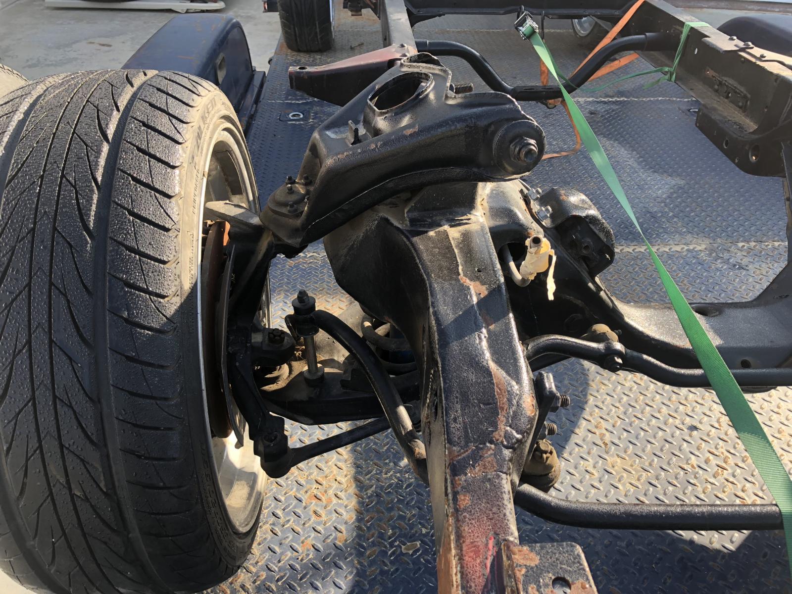

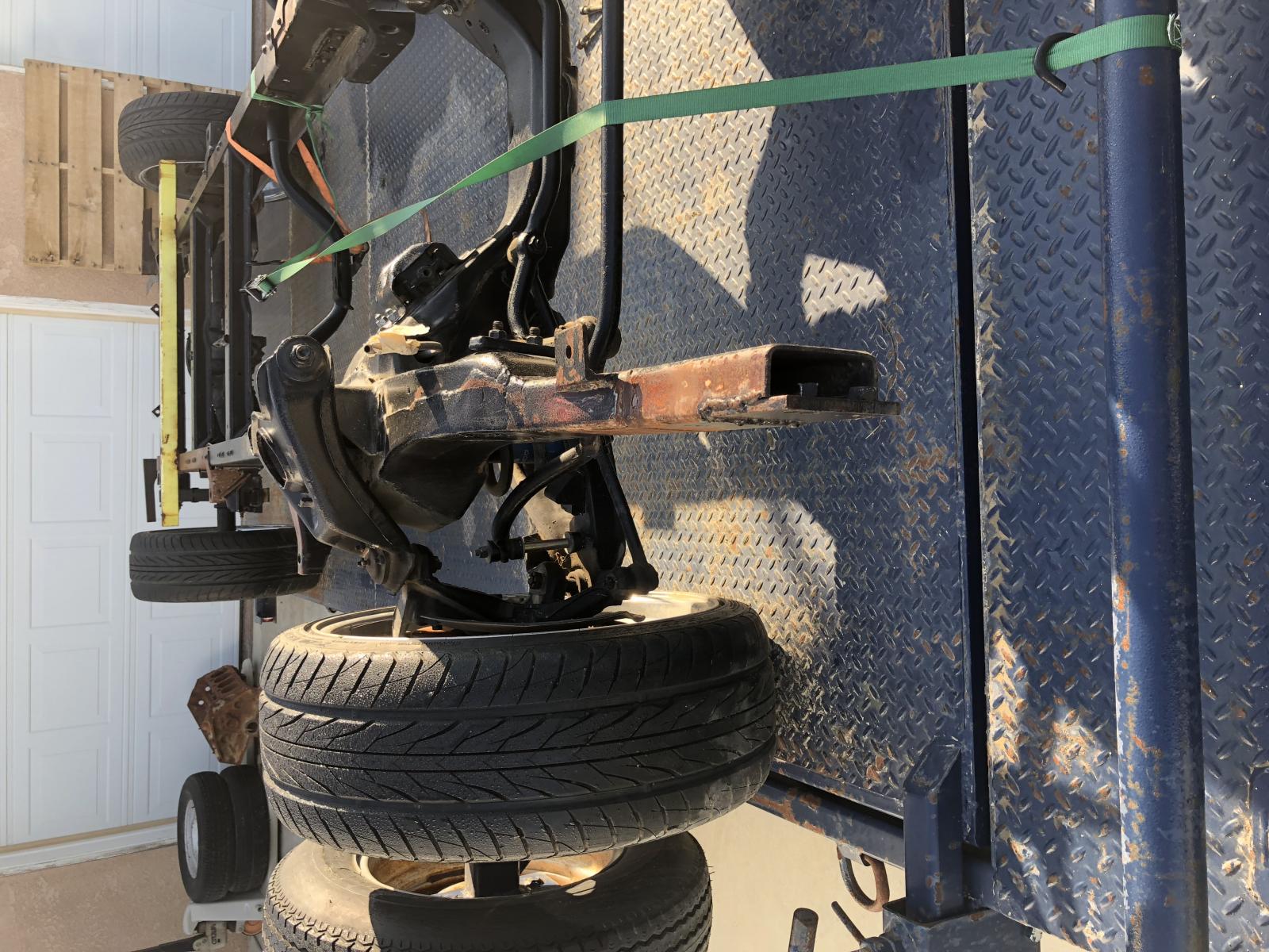

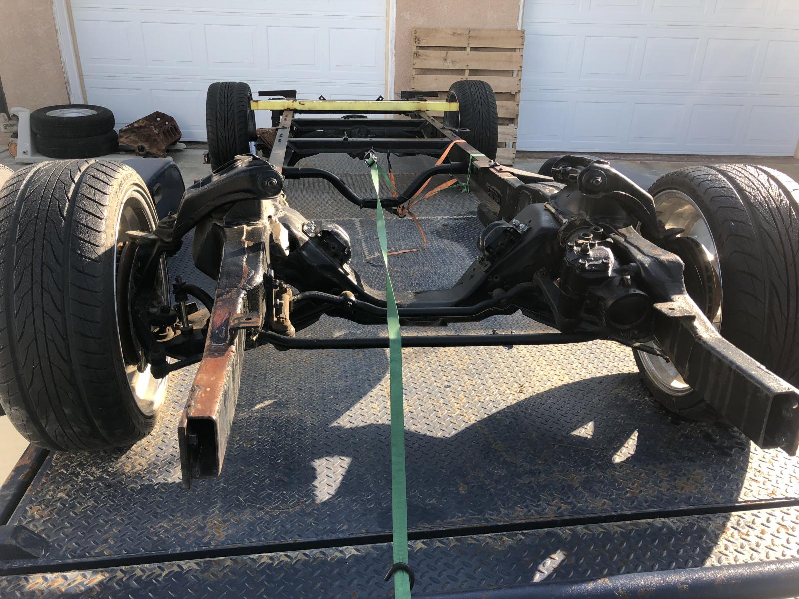

      Hey Guys I was just wondering. If the camaro suspension is an option would that be the way to go or would it still better to go with the wide ride. The reason is I’m asking is because I have a frame with the camaro clip welded in already. In needs to be taken down and out in a machine to see if it will align. And I know it needs new ball joints. The other bushings look fairly new. So I’m assuming if I do use that I would upgrade to coilovers correct? Leave the stock control arms? Upgrade the steering box and possibly tie rod? Is all that correct. So since I have the frame already and if it’s good would that be better. Or is it smarter and better to just wait and not mess with that frame and save up until I can do the wide ride? Thanks guys I really appreciate the advice

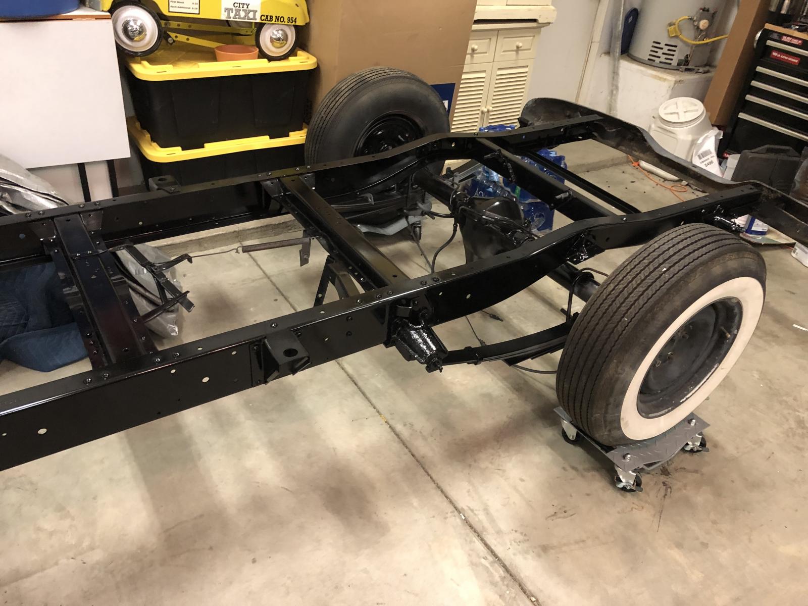

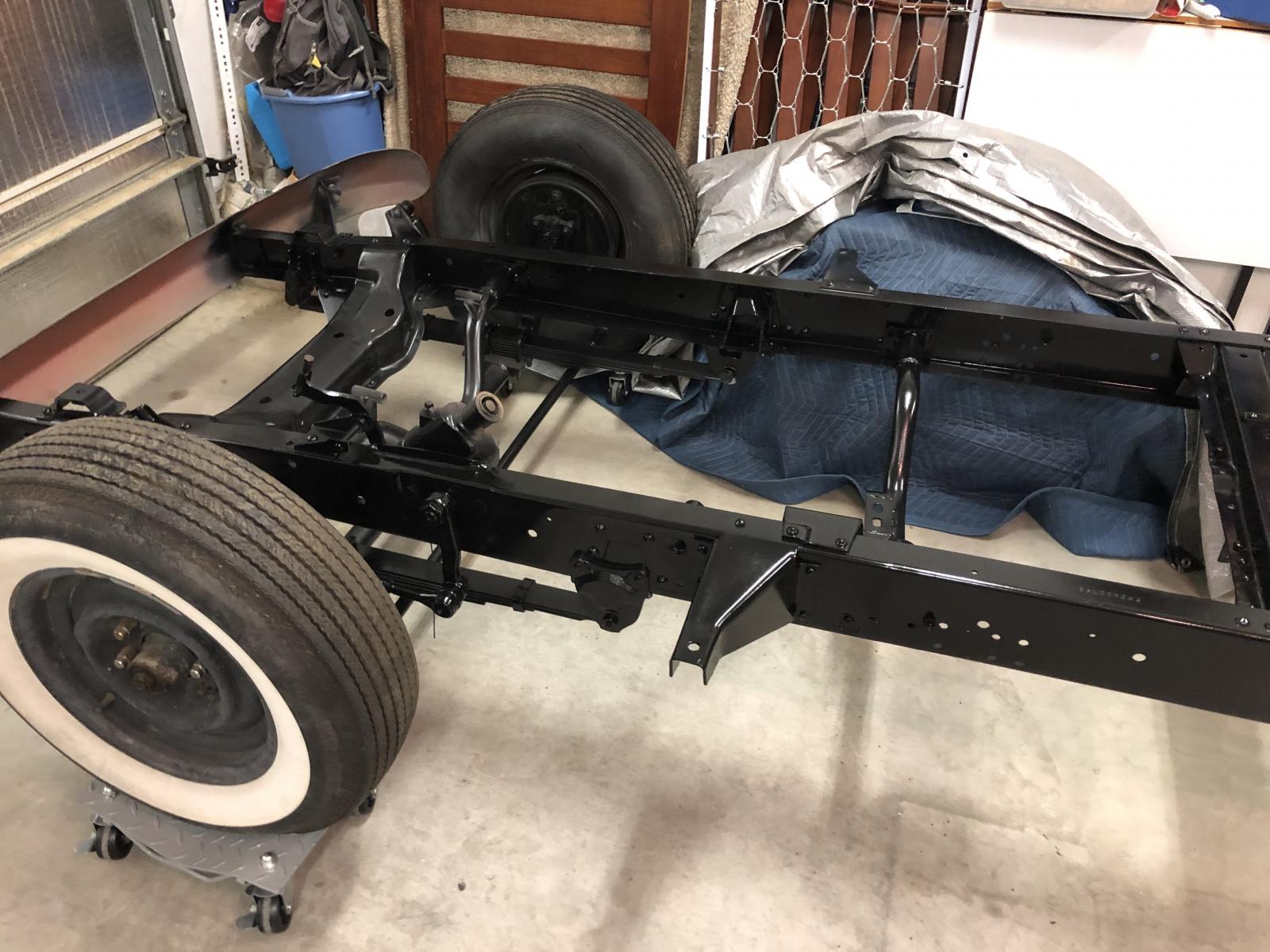

      More pics
      738
      My .02.
      I would remove the front springs and shocks. Get some 1/2" threaded rod in place of the shock. Adjust the front end down to your desired ride height then take it to the alignment shop to see if caster and camber can be set to spec. Then also they can measure from the rear axle to the front wheels to see if the clip is welded on square.
      The good thing about the Camaro clip is that their a ton of aftermarket support.

      Not terrible. From the picts, I call that an "Overlap" graft. Not the ideal way, but this method is a lot easier for someone to get it in straight. So, you odds are going up. To the installers credit, all things considered, the front bumper/core support mount is way better than most, if the metal lines up. Keep this in mind. The chassis jobs can be separated (in thought). Job-1, hold the front and rear suspension in the correct locations (can be checked with a tape measure and at the alignment shop) Job-2, Hold the body together, in the right place over the wheels/tires. So, you can always mod the front core and bumper mounts to fit the sheet metal. BTW, this is 2nd gen Camaro IFS, and, the sub wasn't cut in relation to the suspension mounting points. If it was installed square, it will align with no problem. ** Tape measure - from the center of the front cab mount hole to the center of the shock hole on the sub, pass and drivers side straight forward. Then, cross measure from the same points. Pass cab mount to the drivers side shock hole and vice-versa. If you are within a 1/16, or even an 1/8" side to side, it's good to go. Next, set it on four jack stands, under the front cab mounts and just in front of the 'front' mount for the rear leaf. Shim to make the frame level (side to side) at these two points. Now, check the chassis in three more places. 1. the very back bed mount 2. the top of the upper A-Arm mounts, 3. The front bumper or core support mounts. If it is within the 'bubble' on the level, it will be OK. And if so, use it.
      My .02 on the subs. Just rebuild it. I used to get kits from Kanter or PST. Just use the rubber for a cruiser, urethane for more perf. While agree with the coil-over positive comments, I an not a fan of coil-overs on GM subs, as they reduce the amount of wheel travel available. There are lots of good coil springs available. I like the Eiboch 1" drop variable rate springs. Use a good non adjustable shock. ridetech, Bilstein,...... to hard to get to the knobs on these, so you won't take advantage of the $$ spent. Brakes are good, maybe some good (Hawk) pads. If you want it lower, get some drop spindles. Get a big Helwig swaybar. (or another, but 1 1/8"+) and go. I would build this chassis instead of the straight axle chassis for the cruiser/driver, and save your nice uncut chassis for the next one. This will drive way better that the S.A., so you will drive and enjoy it more. We have a dvd #102 That shows how to mod the OE rear springs/shackles to make it ride nice and drop the back. Hope this helps, keep Truckin!
