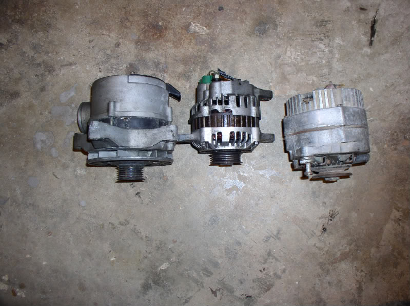

      This is the one that is small- not the super small one (35-50A) - it's found on early 90's Suzuki Swifts/Geo Metro 1.3l with AC- Stock is 75A- I had mine gone through and it's now 125A. Went with the smallest pulley to get max output at idle. This is the best one to go with- size and power output.
      Here's a comparison of size-
      Also notice the small size of the BMW pulley
      BMW 140A - mini Nippon-Denso (not the one I went with) - GM stock Corvette

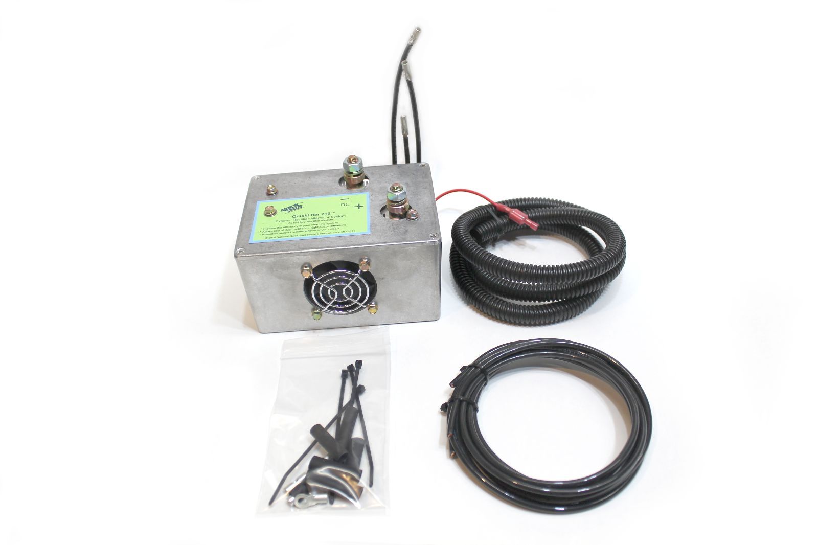

      I had a guy that I use to work with go through it- there are several guys that do it- the best way to really get the output increased and run the small case is run an external rectifier.
      Don't know the max shaft speed- I'm running the stock pulleys from BMW.
      Something like this- and it has it's own cooling fan.
      https://www.ebay.com/itm/Alternator-...-/161173273360
