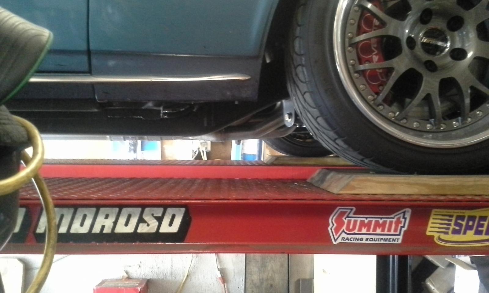

      I have a set of Hooker Blackheart long tube headers in Stainless with my DSE sub and really happy with the fit. They tuck up nicely.

      good to see the hookers tuck well. I ordered the hooker black heart earlier today
