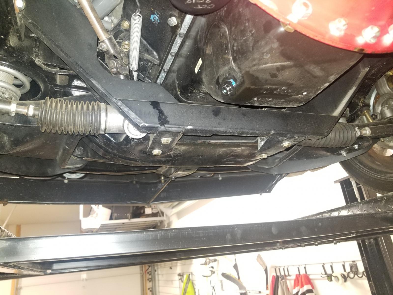

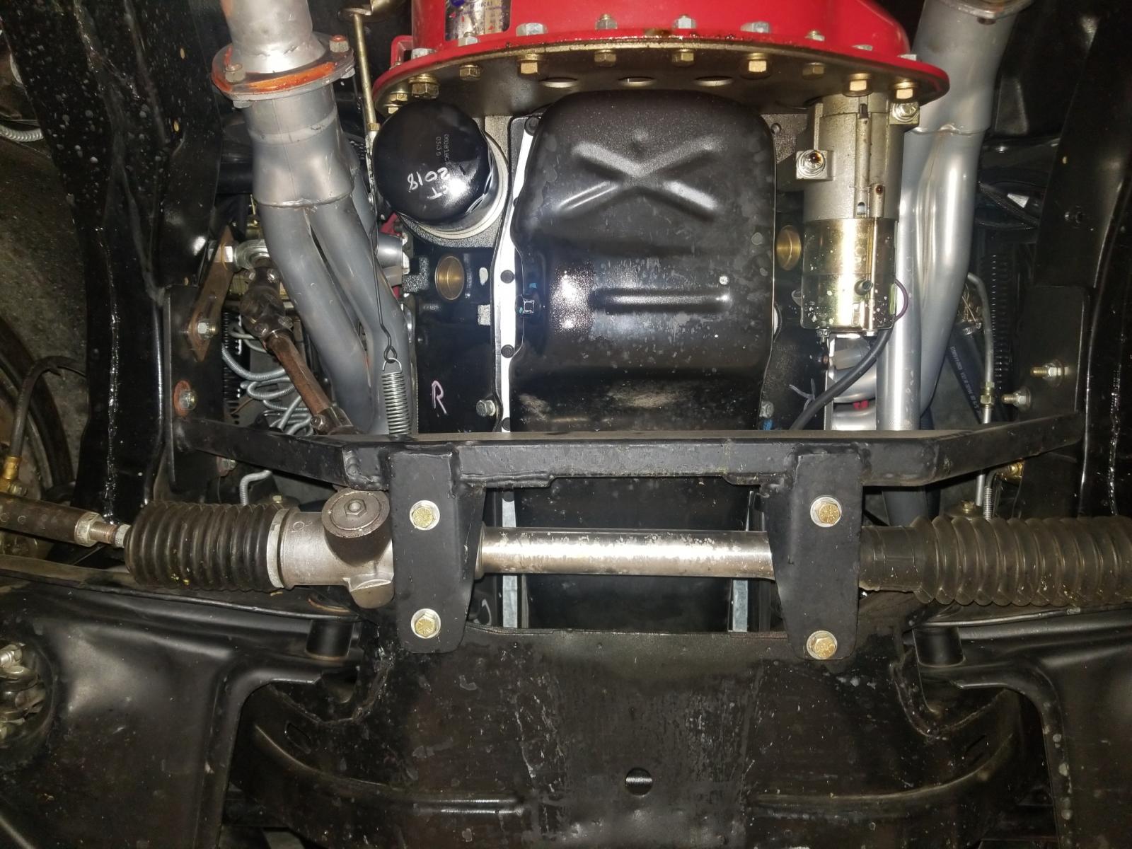

      Here are a few pics of the rack (rear mount).
Size:  233.2 KBName:  20181109_232012.jpg
      Mountain Springs, Texas
      4,827
      You are not likely to find anyone here running that rack conversion. There is a couple guys over on Camaros.net with Holley and TKO. Post your questions over there.
      Don
      1957 Buick Estate Wagon
      1959 Apache Fleetside
      Jul 2016
      348
      I have the Holley mounts and Hurst Driveline x member, LS3/TKO 600. (NO R and P set-up). Only problem is with exhaust clearance. I'm using the Holley/Hooker headers and the exhaust will hit the x member. You will need a custom exhaust shop to help with this.
