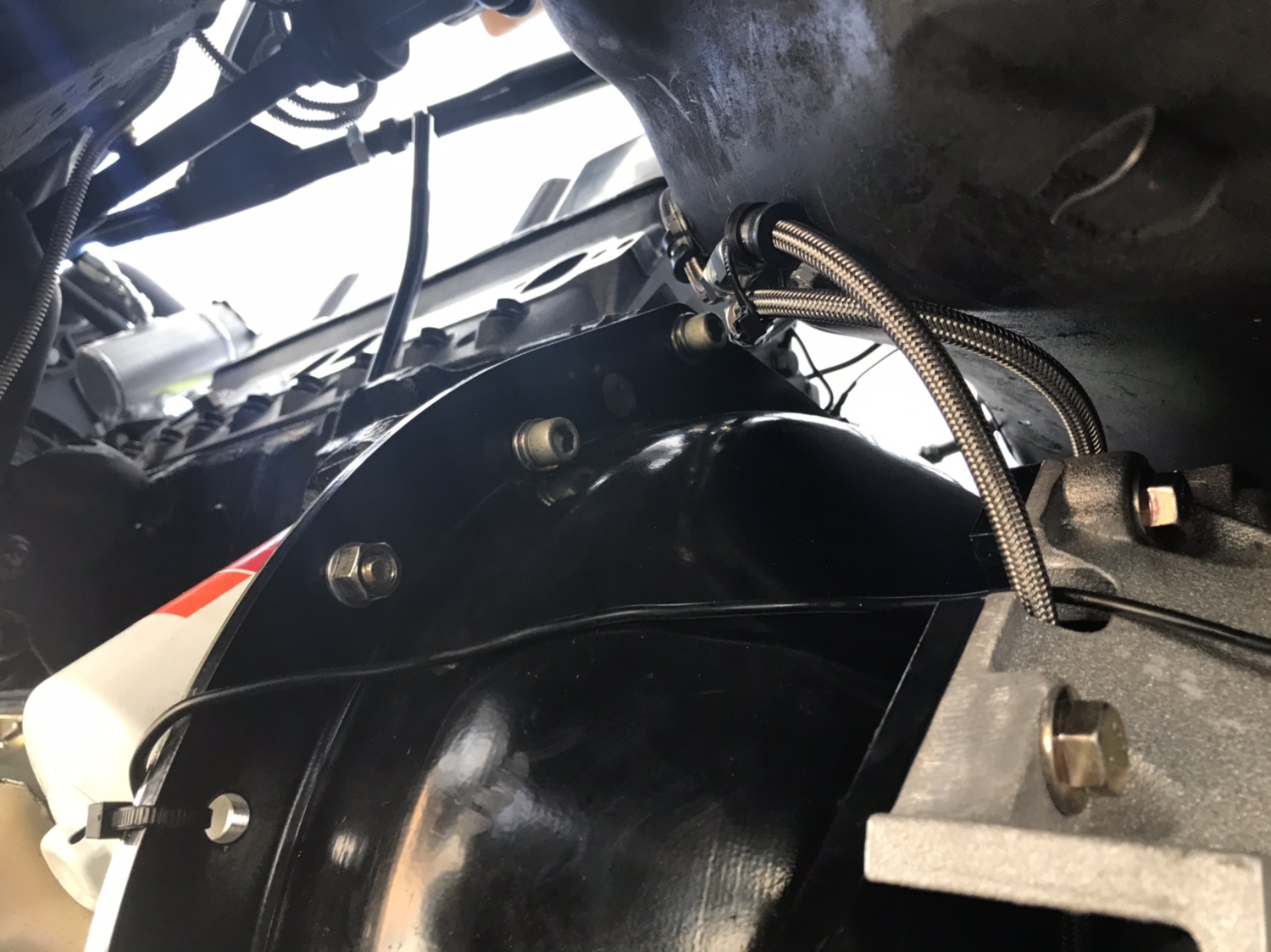

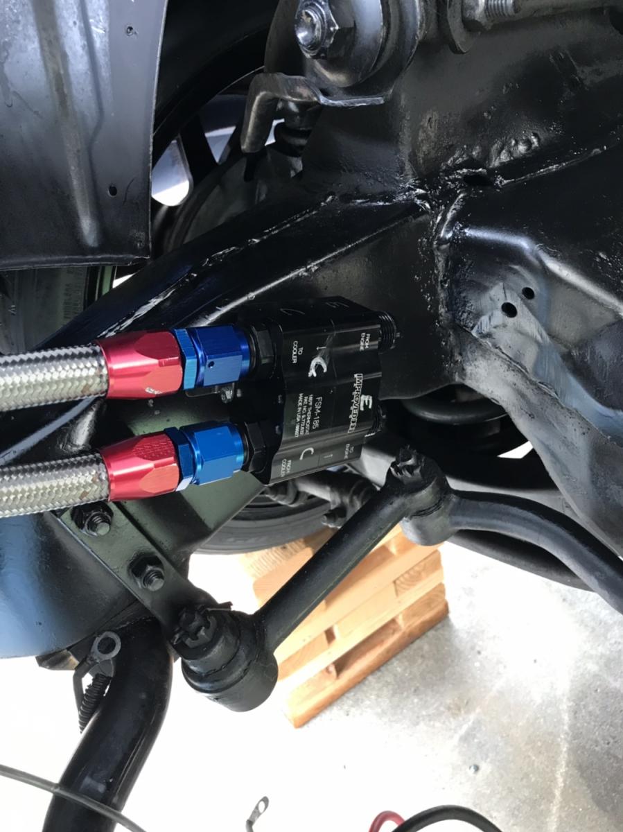

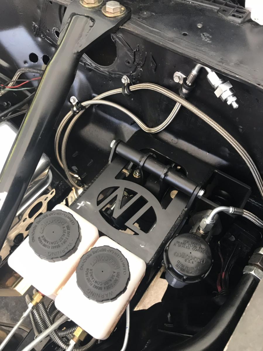

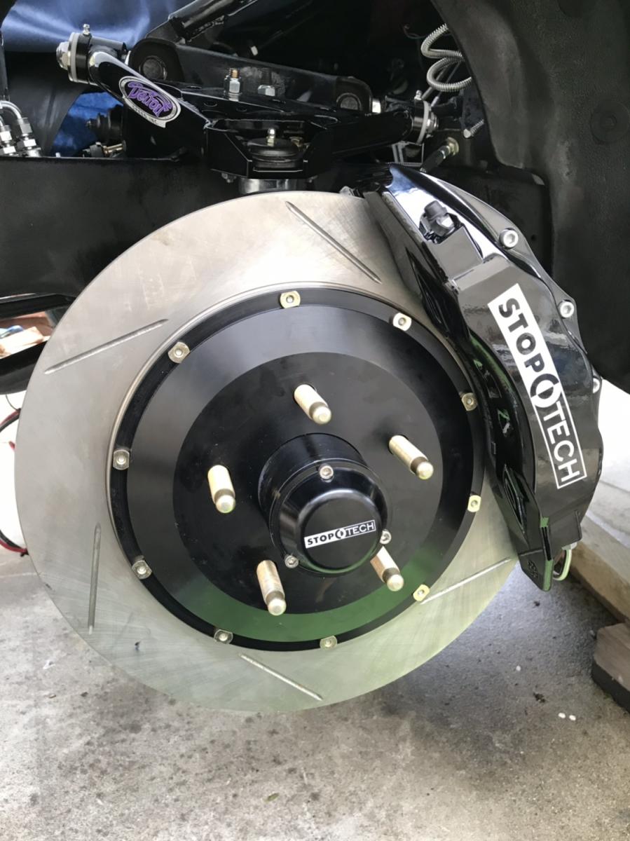

      Got brakes final assembly done both sides along with new DSE UCA and bilstien shocks. Also mounted and did half the plumbing for oil cooler and 185 deg thermostat.

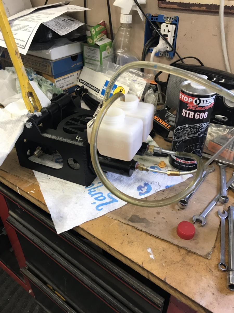

      Bench bleeding masters using the bracket.

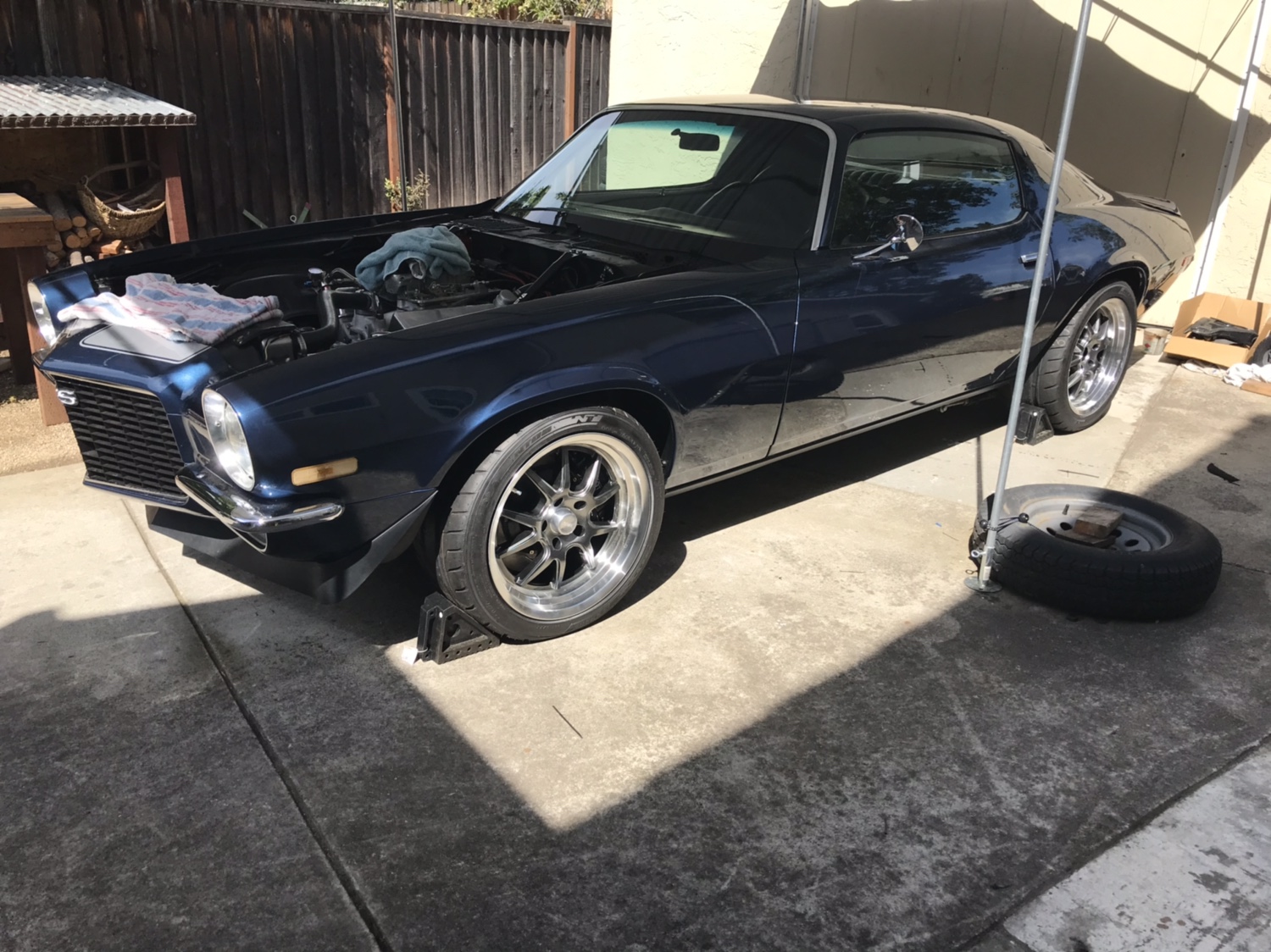

      Motor with T56 back in the car.

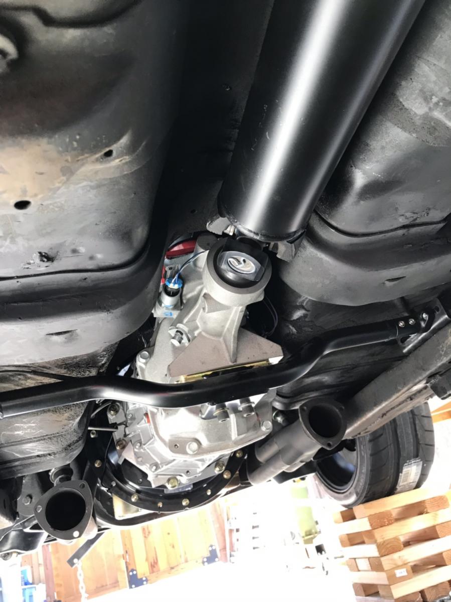

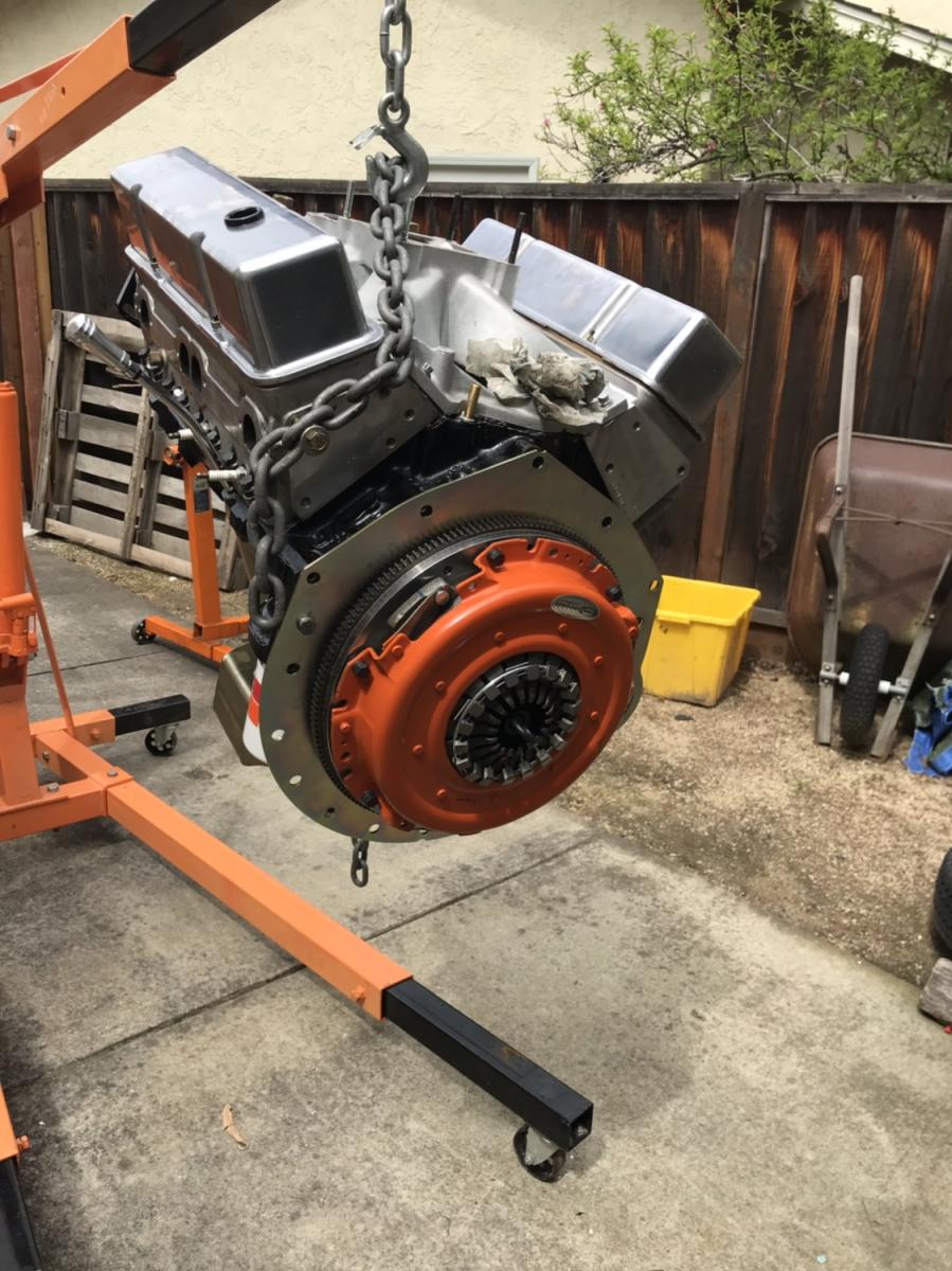

      I installed clutch and bellhousing on motor. Had car on 18” blocks on the tires. Went over front with the motor and mated trans from below with a trans jack. Went smoothly. Tilton 6000 TO bearing assembly on the trans.
      Speedtech trans mount. Very well designed part. Very adjustable and located the trans perfectly. Currently sitting at 2.5deg negative with no spacers. Nose is still 1.5” high at least. So will come down a bit from that.
      Only snag is I have to move the driveshaft safety loop back 6”.
      Interferes with the big sonnex yoke.

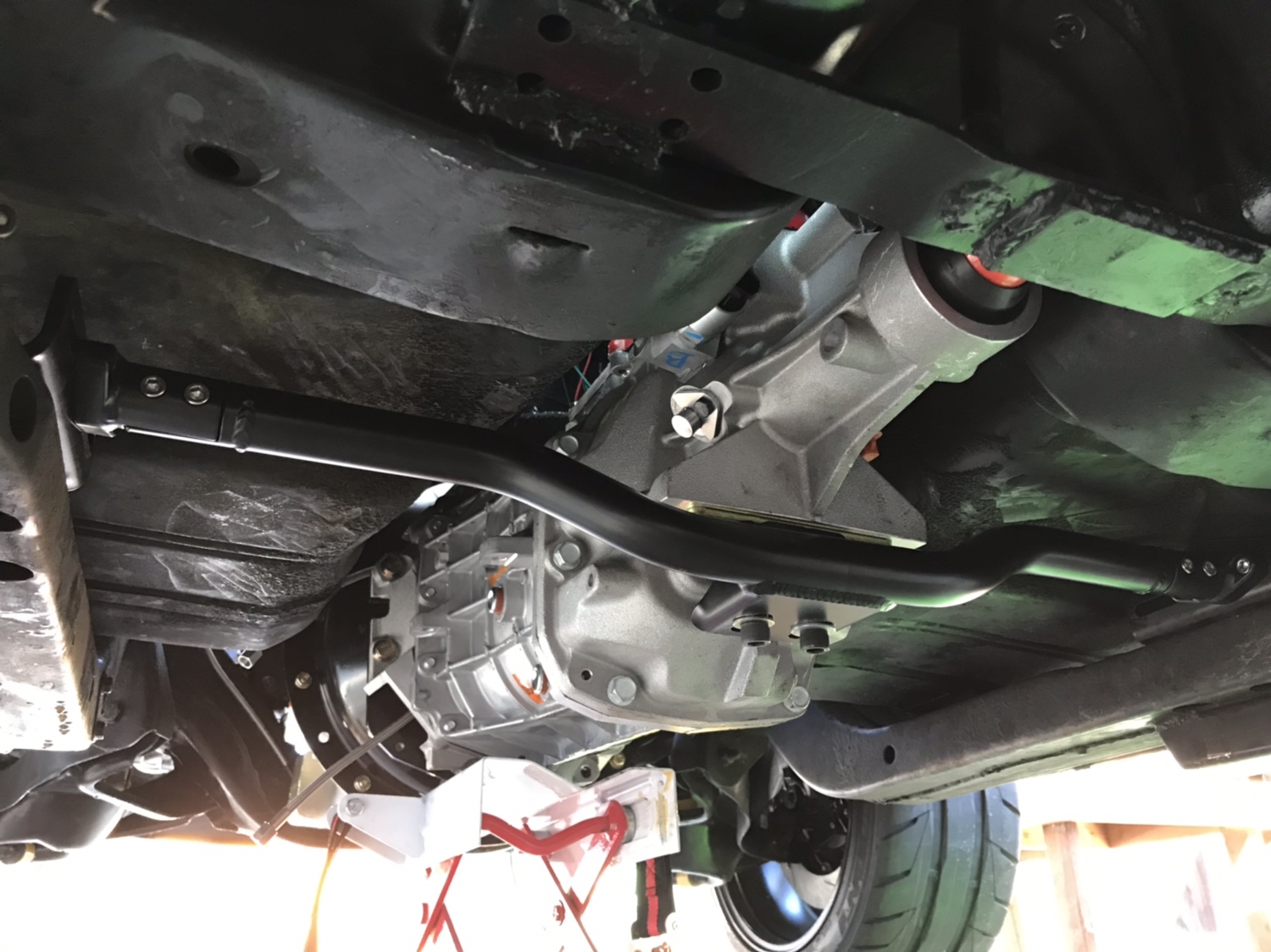

      Driveshaft loop removed. Was welded on. That was fun.
      I’ll bolt it on next time.

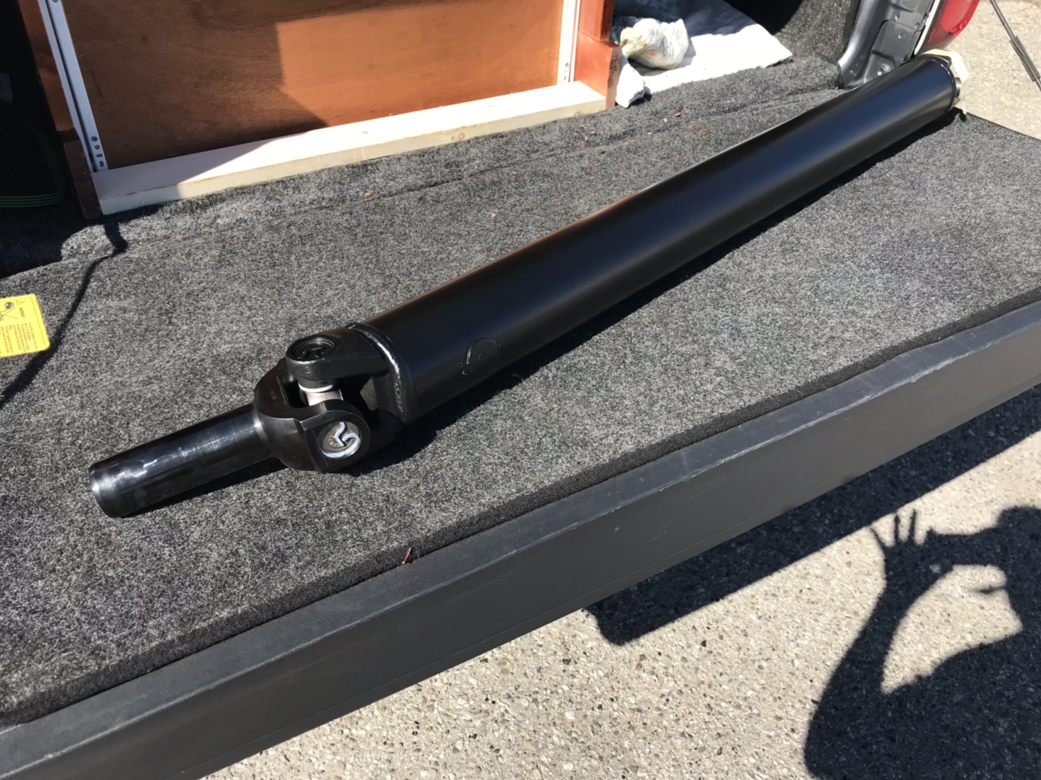

      Got a new driveshaft built and installed. Wired the trans and wrapped up some other misc wiring changes in the interior.

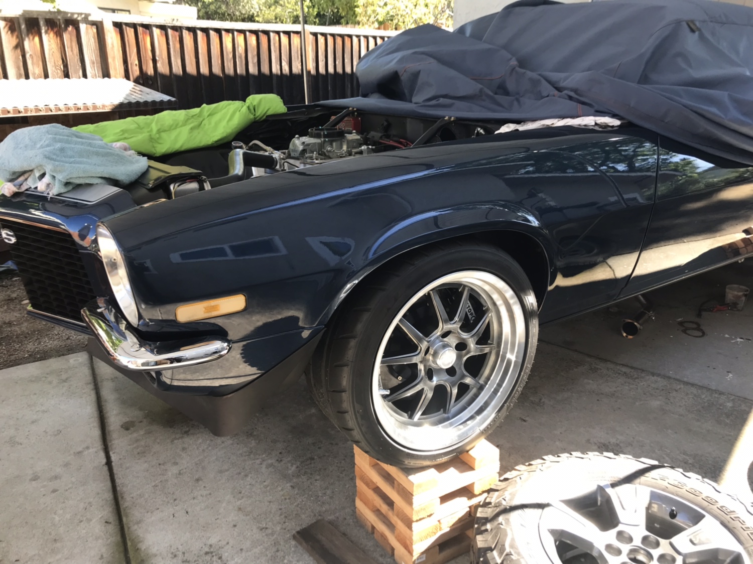

      Motor / trans sitting at 2deg negative. So should be a good starting point. That’s without any spacers in the mount.
      Plenty of exhaust clearance.

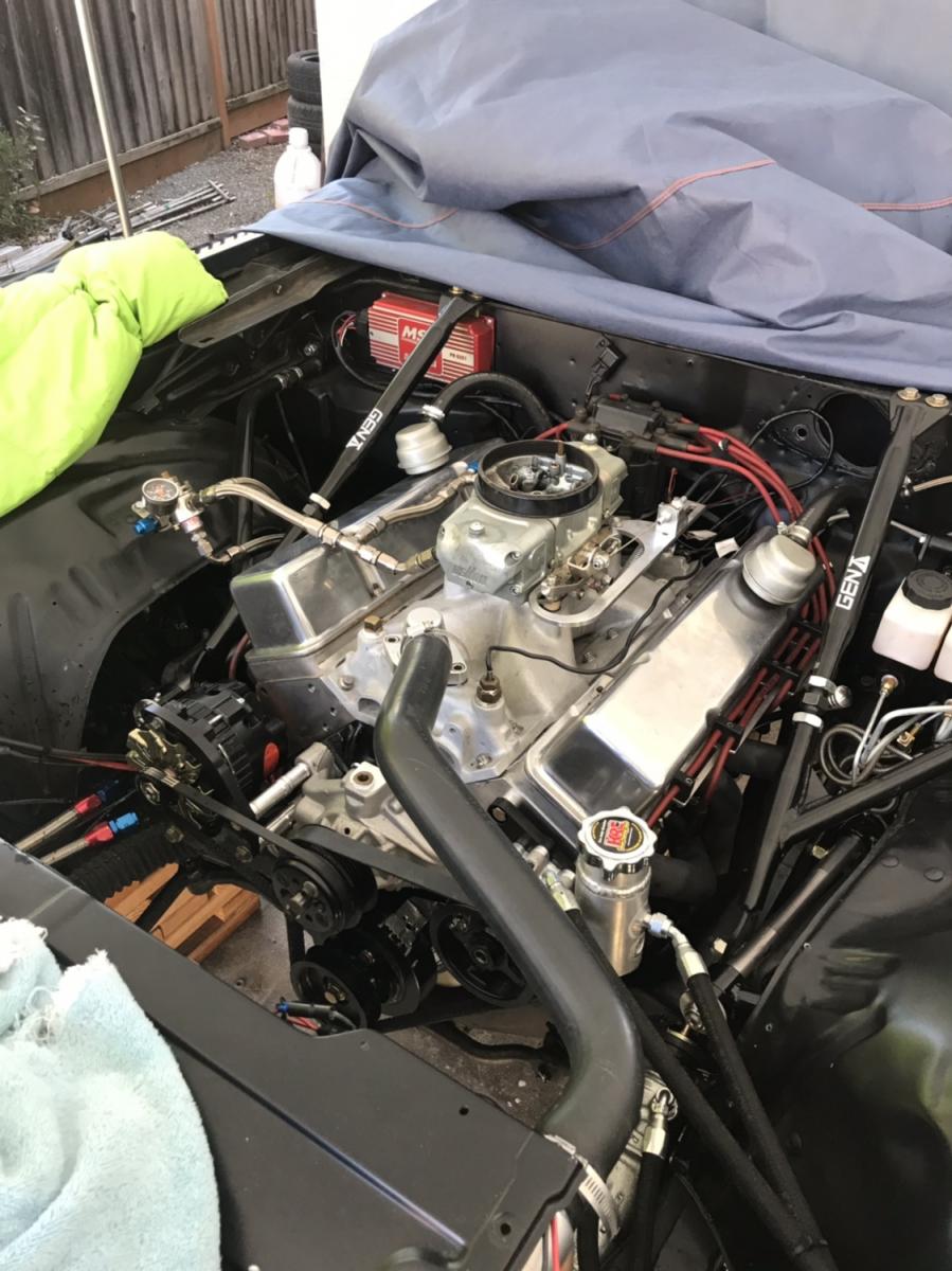

      Never did find them but had some new ones that worked.
      Fired up no problem - got timing adjusted and brought to temp. No leaks. No issues. Minor lifter tick for a few minutes but went away so all seems good now. Motor hasn’t run for 5 months. I did swap rockers so it’s a fresh valve adjustment. Hyd flat tappet cam.

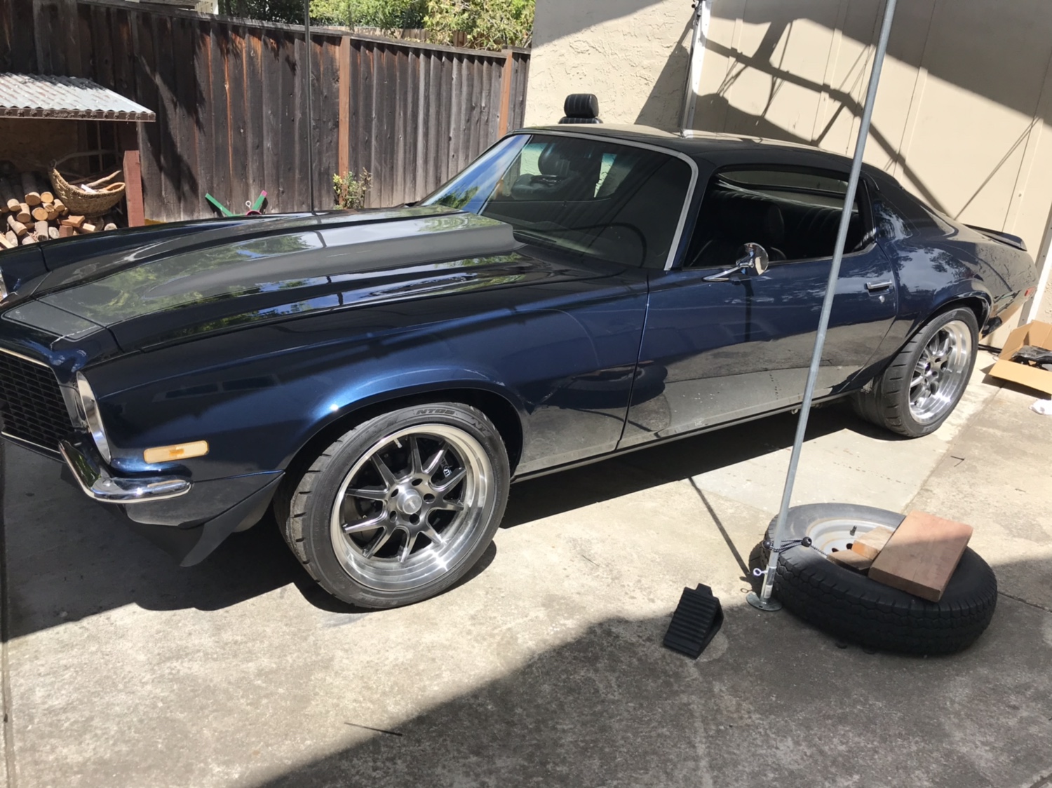

      Thanks. It was weird. I found 4 bolts in a bin behind the car that I used for various things I thought must be them. Tried getting them started for 30min. Then realized it was a smaller bolt after all and used new bolts I had recently picked up. Still haven’t found them. Really strange. I found everything else without issue as I only used a few places to store things. Not those dang bolts!

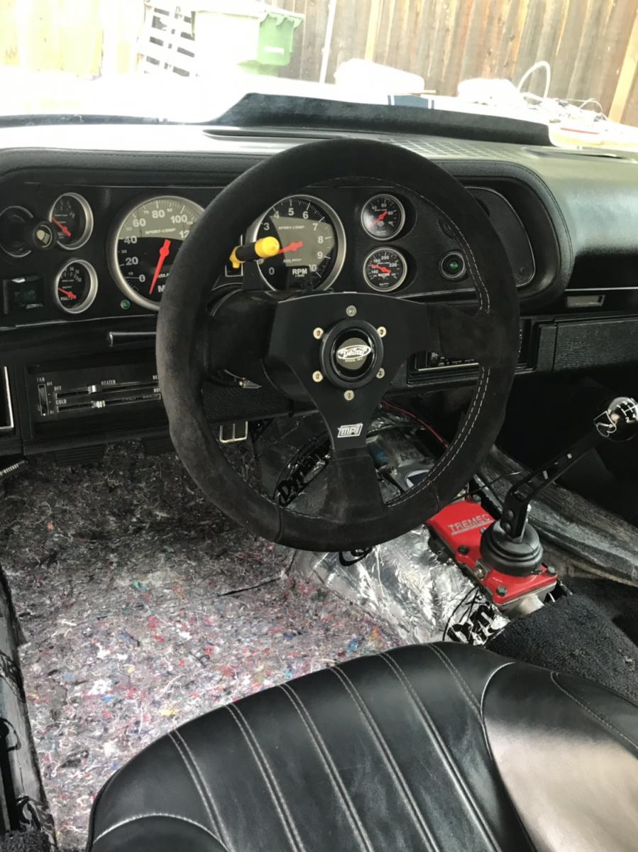

      Got the clutch stop done per tiltons instructions. There is less than 4” travel and engagement is 75pct into that. Feels pretty good so far. Reverse works - I used the brake light signal per the bowler instructions. But I’ve heard that may over power that circuit. I don’t see how that could be possible - it sees 12v and the current is only dependent on the resistance of the circuit. Seems whatever 12v source is used to power it will result in the same current.
      Also got my DSE steering wheel installed.
      Stance is looking pretty good - May still settle half an inch or so. Have not driven it yet. The front wheels really tuck in nicely - doesn’t look like there is a 275 tire under there !
