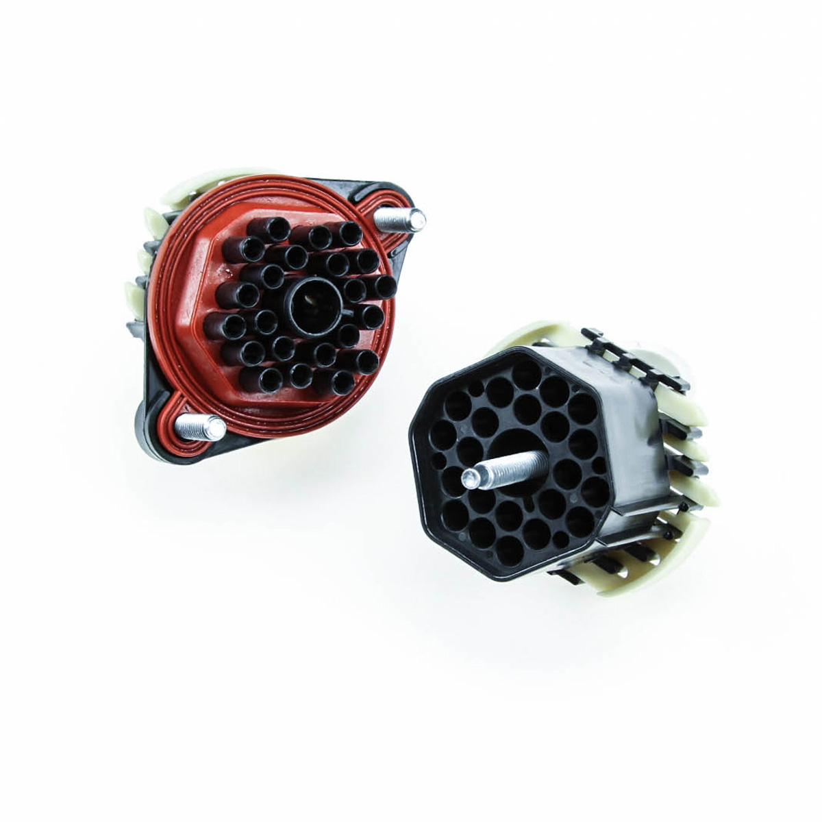

      623
      I'm going to use the ones in the link below. They're about the 8th item down the page. They're the most affordable bulkhead and make engine removal easier. You use regular wire terminal crimpers so that makes them more affordable.
      https://paradiseracing.com/page/2/?p...duct&s=Harness

      What harness for FITECH ? I was planning that as a future upgrade, But I am all out of under dash space !
      But Also to your point--> I added spade connectors to empty slots of the bulkhead connector to add some of my engine area wiring.

      An inexpensive item that makes a nice firewall grommet is a gladhand gasket used for semi truck. They're cheap and can pass a 2/0 cable through the hole.
      Tracey
      90
      Here is another low cost option I just came across.
      https://ceautoelectricsupply.com/pro...wall-grommets/

      I use Mil spec MS3470 connectors - Large bulkhead connectors I use the 32 pin style - Smaller ones I use for things like wiper motors and what not.
      downside is the cost
