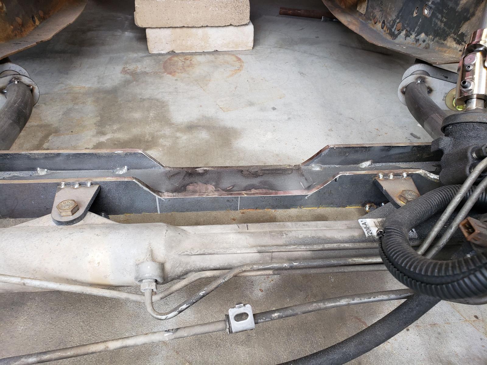

      First up after the initial test fit was to notch my front cross member. Nothing quite like cutting a chunk out of a day's work.

      This is after an inch notch so I could lower the entire engine/trans package. It kept just hitting the floor of the cab when I was matching the pinion angles and I'm really trying to avoid a bunch of sheet metal work this time. In a perfect world I would have moved the entire oil pan behind the cross member (5 inches back) and lowered it another 2-3 inches down. I then remembered that I've already gone wayyyyyyy further with this project than I ever intended and doing more setback meant all new sheet metal behind the engine bulge of the firewall. No thank you. Every cylinder is behind the front axle. I'm calling this good. You can already see how much I've had to modify the firewall for valve cover clearance.
      So the inch worked and now I needed to prep the frame to have mounts and braces welded to it. My AWESOME neighbor (seriously my neighbors are better than yours) cut me strips of "scrap" 3/16 steel plate to box the frame. But I wanted to add in some internal support behind the plate around where the trans would mount (or so I thought).

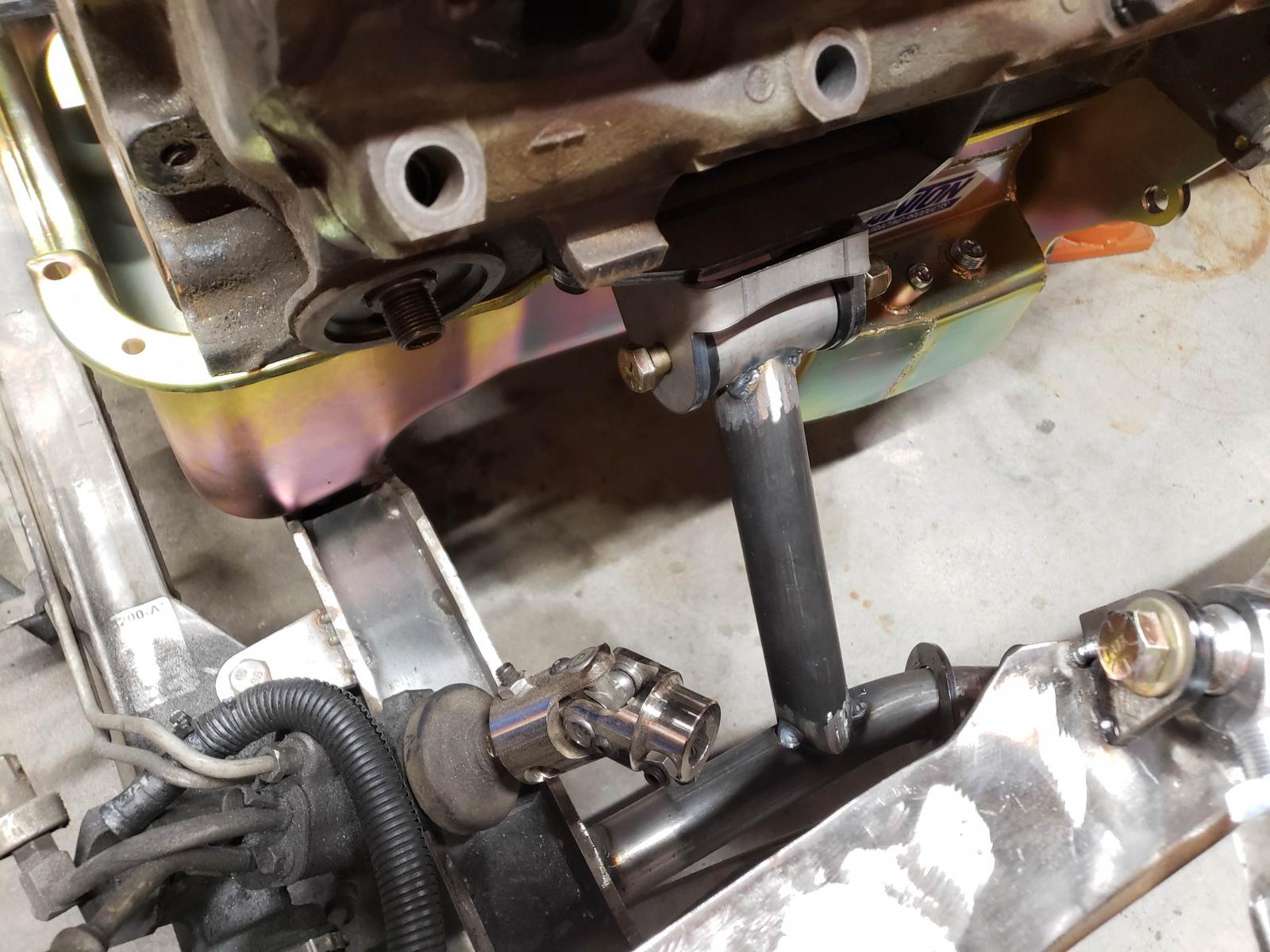

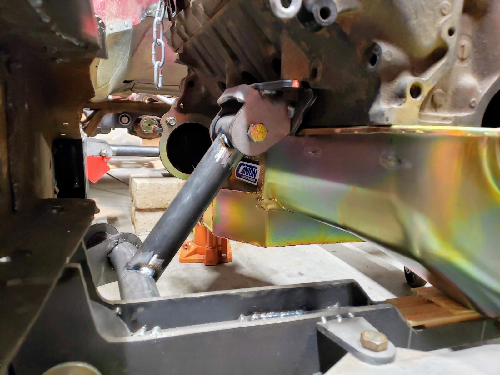

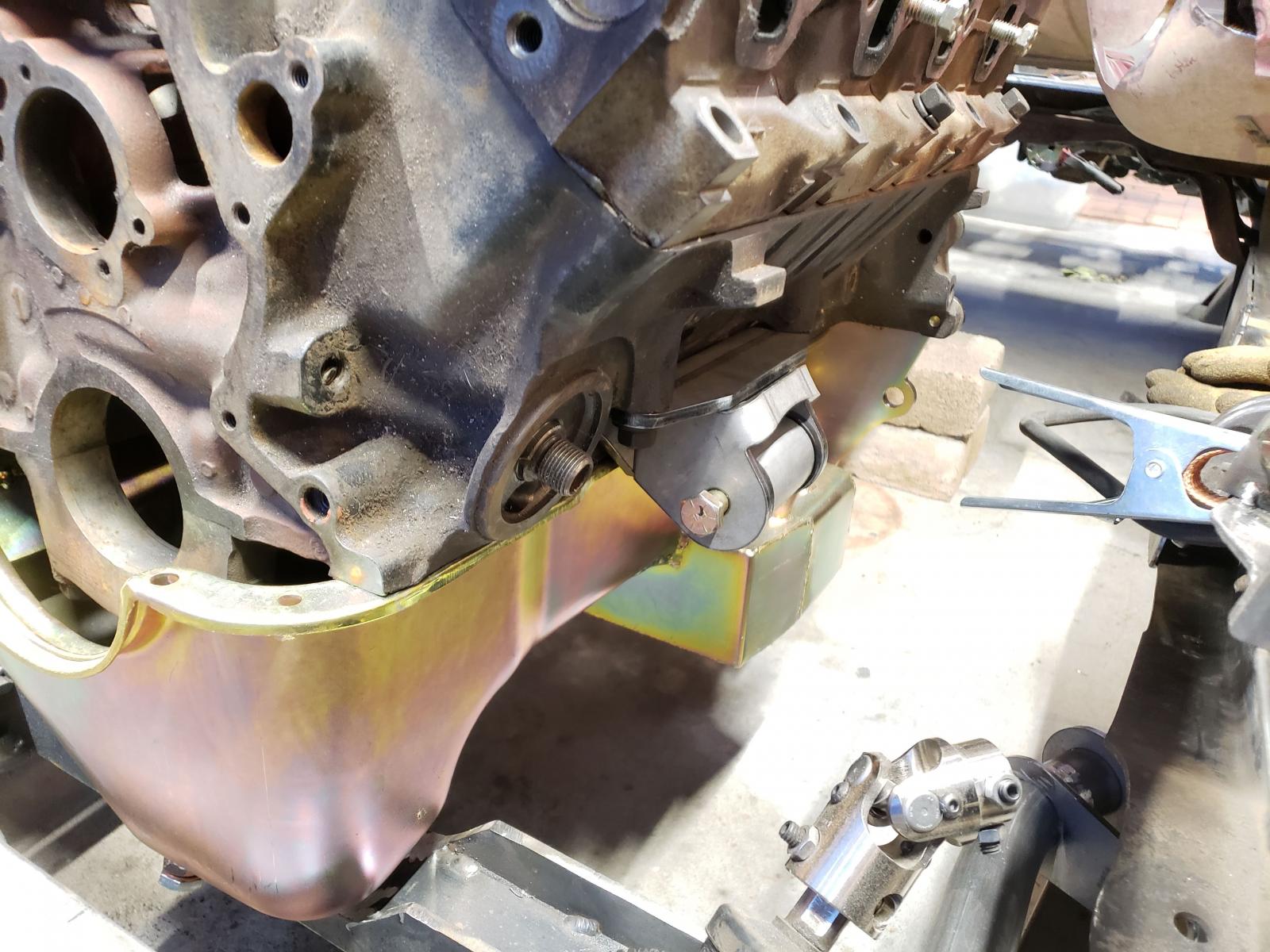

      With a good foundation to mount everything I tacked those Ruff Stuff motor mounts I've had hidden in a box. Little pricey, but man they are nice. VERY easy to mount and align. I'd recommend these to anyone with a SBF that likes this poly mount all the LS swaps use.

      Then I shimmed everything to match my 3 degrees of pinion angle and leveled the motor. Suddenly I realized those tubes I added to mount the rear of the lower control arms were the perfect base for my motor mount stand offs.
      Ta da! And no header interference for once. I'll add a little bracing to these just to tie everything together.

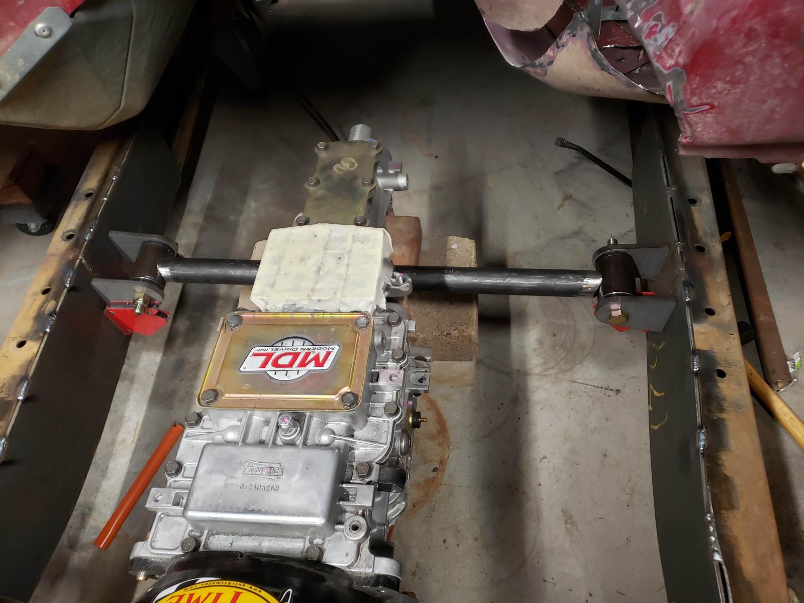

      Then I started on the trans mount. I thought I would go to the plating on the frame rails. So here is V1.
      Not a fan. Its long and would need loops for the exhaust. Just didn't seem like the right move. I don't have enough tubing yet, but those poly mounts will be moved to mount on the chassis "X" that I'm doing next. Then I'll have more exhaust space and it will all tie together better.
