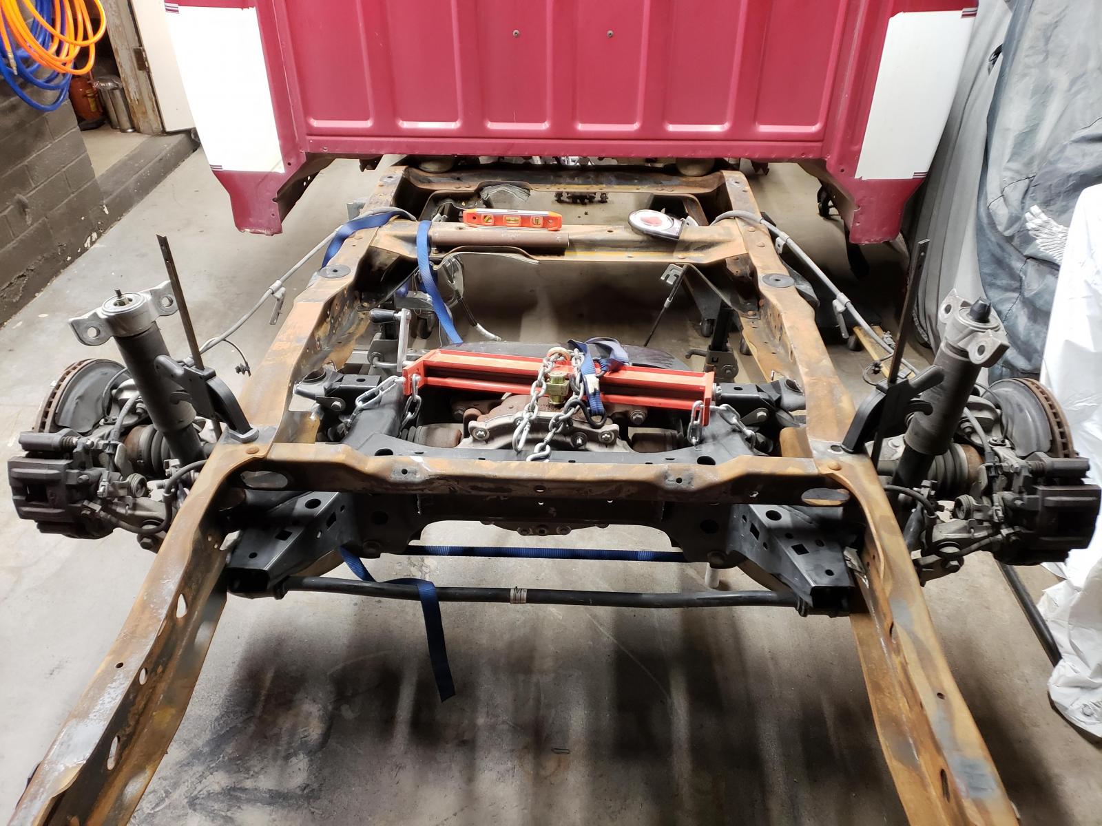

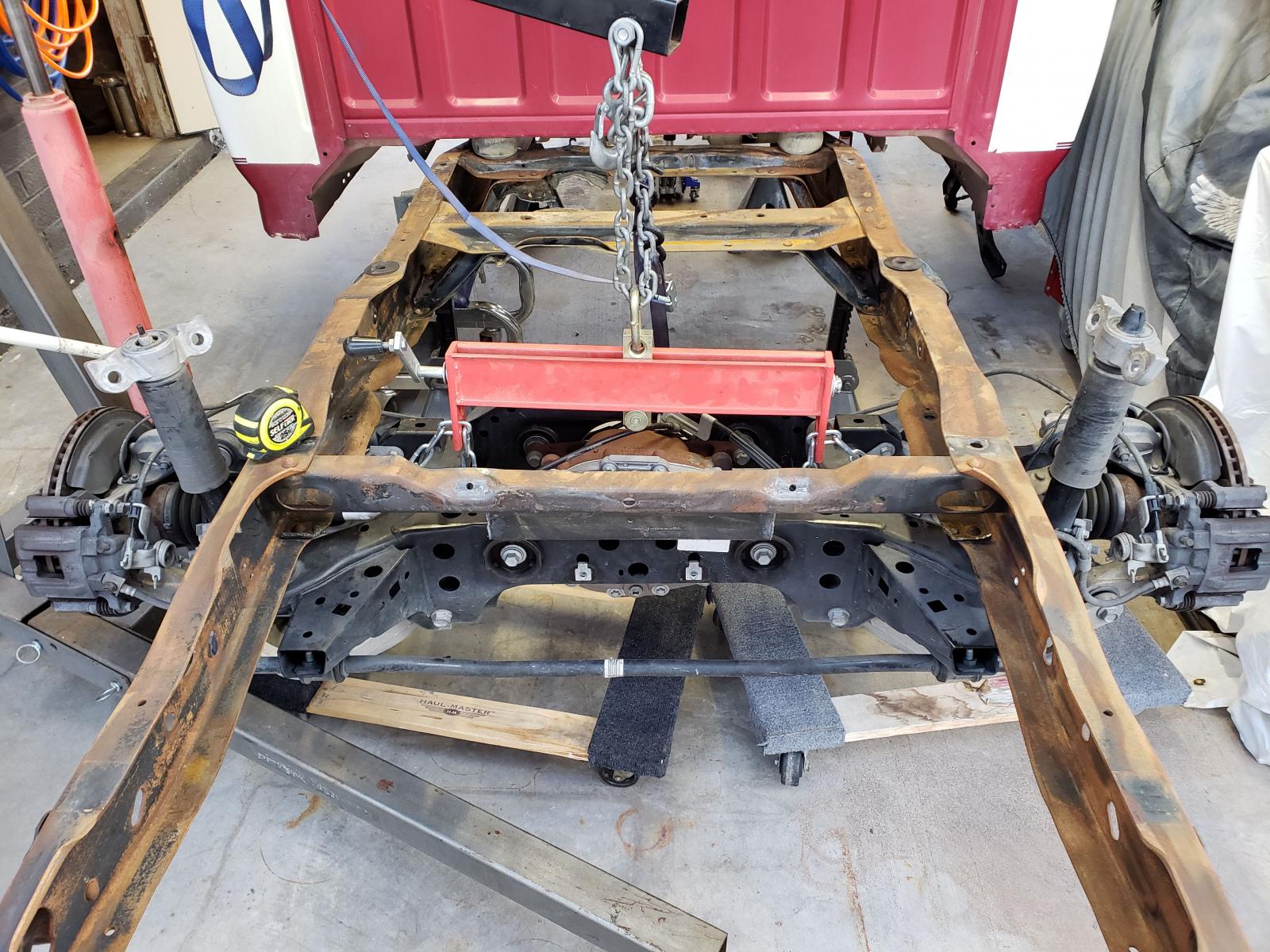

      I didn't really get a ton done today. Definitely nowhere near what I planned when I woke up, but house stuff sometimes has to get done. Can't play race care builder all the time.

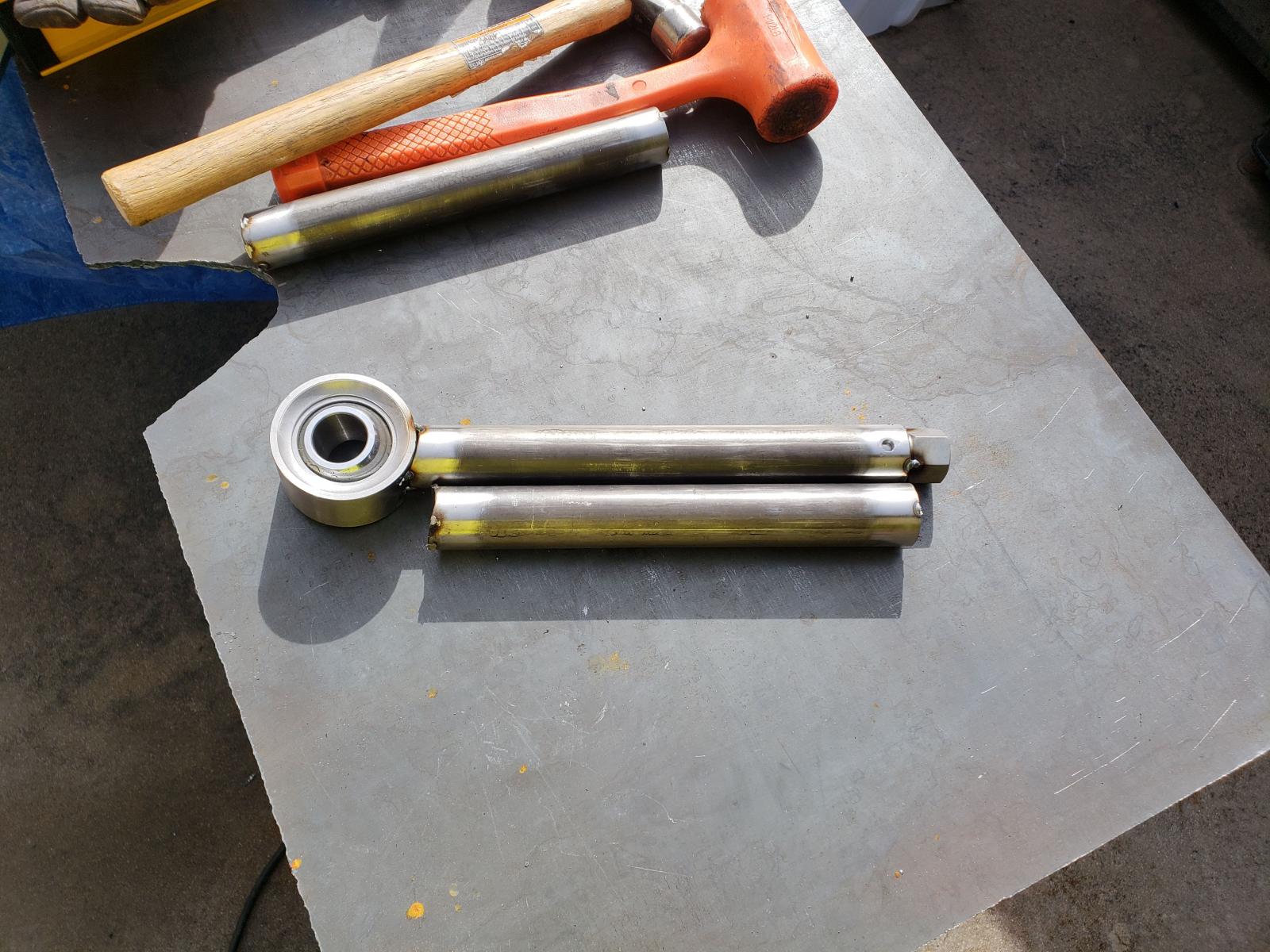

      First thing I did was remake my main lower control arms:
      But I'm much happier with the results
      So now I have beyond adequate movement available in every joint. Plus I should now have enough adjustment every where to get the alignment right when that time comes.

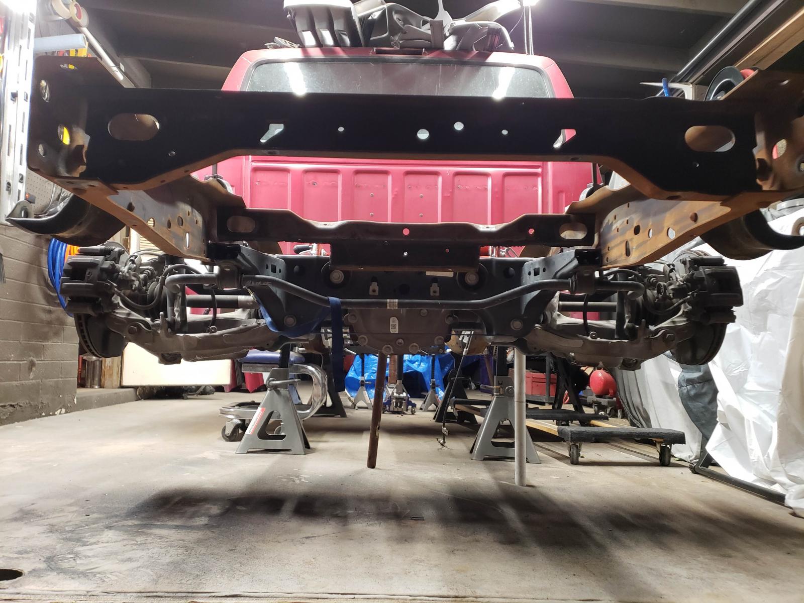

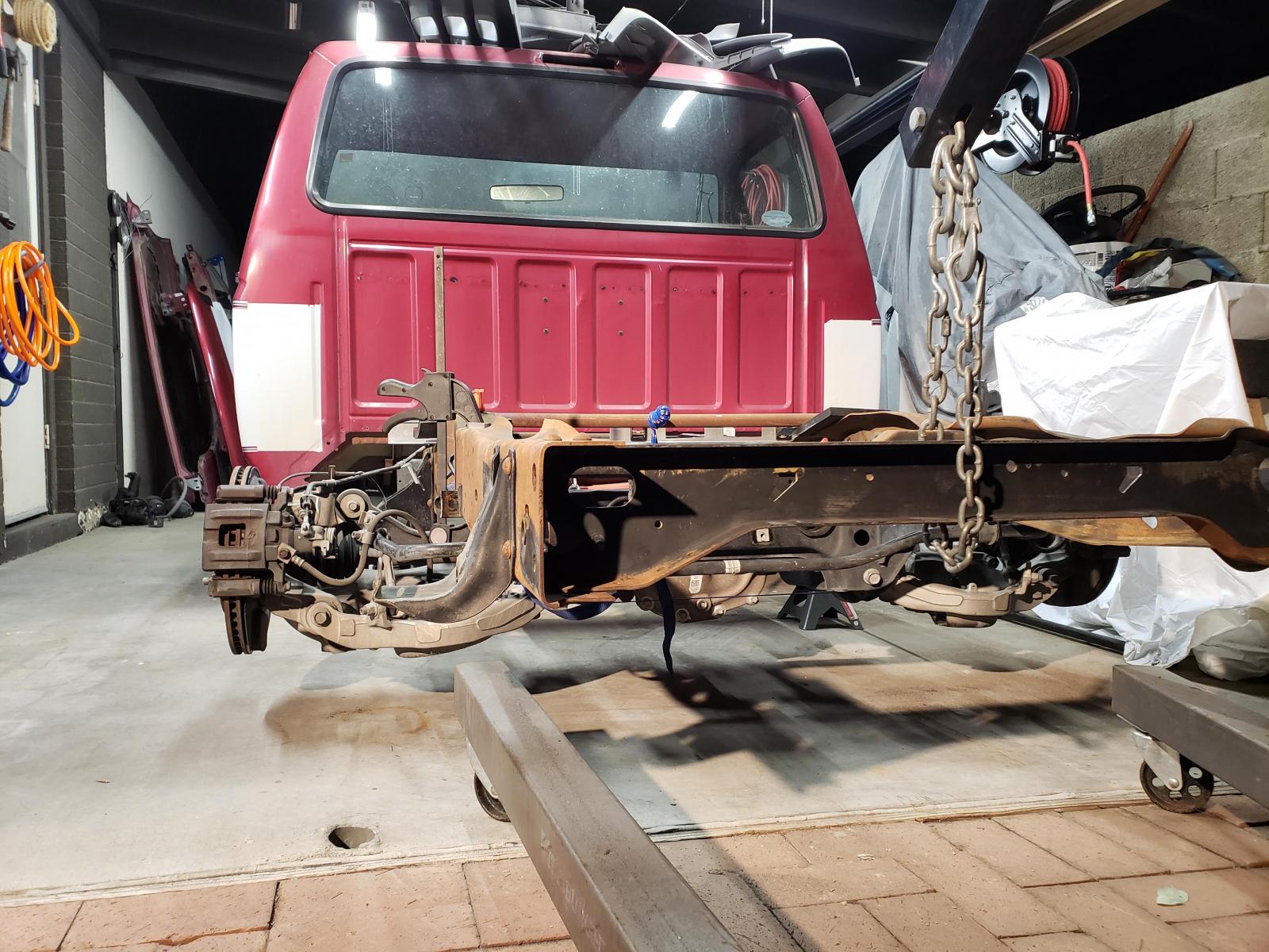

      The last thing I really did was remove the bed. Thanks to a few guys on here I did it by myself using the engine hoist. I forgot to snap a photo so all you guys get is the results.
      I just power washed the frame and cleaned my work area after this. House stuff took over and so hopefully I can attack the rear end in the evenings this week. I'd love to see it hanging in there asap! And of course I now need to measure everything better and see if the switch to SN95 stuff is worth the work. Better now than later though.

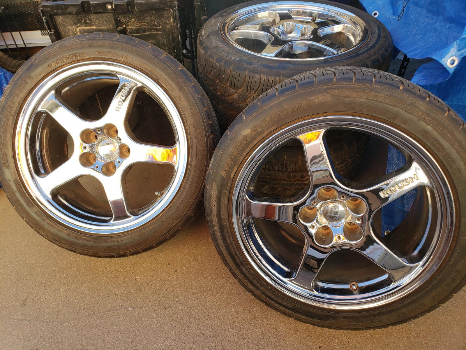

      It's now been a week and I finally have an update for you all just like I said I would.
      Scored a crazy deal on some 18x10 Roush wheels with decent tires. These are genuine and in amazing shape. The old guy that I bought these from has 23 cars. 7 of them were classic Corvettes in some form of restoration. He does it purely for a hobby. Gotta love the people you meet through the car world. No, these aren't the wheels I plan to run in the end, but they fit decent and will be great for now.
      Had to try one out just to see...

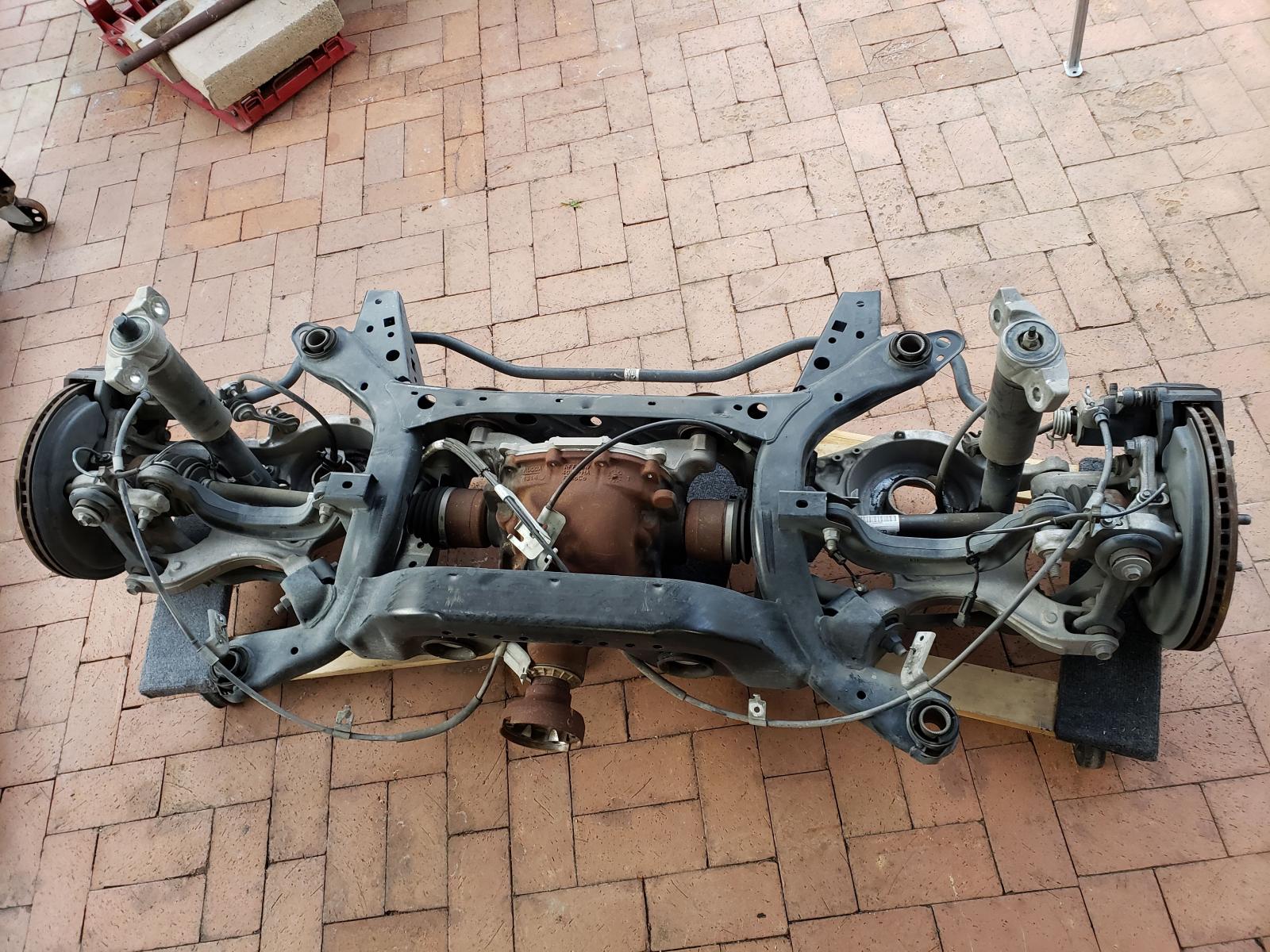

      What you all really want to see though.....say hello to my new (to me) 2015 mustang IRS. This is from a Track Pack (PP1) car so it includes 3.73 gears, 13" brakes, and a Torsen T2R limited slip unit with beefier diff housing. I'll take it all apart after I'm done making sparks with the install so I can clean it, paint it, and install all new bushings.
      I went back and forth on this idea for a few days before pulling the trigger. The main tipping points for me compared to the Mark VIII was it being stronger, tons of parts availability, and includes components (like large brakes) that I would have to buy for much more to add on. I'll still have some money in new bushings, but still makes more sense to me. Plus it is about 65" hub to hub so that means it will work better with my wide front end. And yes...I have to remake the front lower arms for a third time. 3rd time is the charm, right?
      Here it is just lifted up into roughly the right position (how did anyone ever work without and engine hoist?!). I'll need to notch the frame about 2.5" for it to fit at the correct ride height. Plasma cutter will make that go quickly. It's being welded in rather than making brackets to bolt in like original. Feel free to ask why if you don't understand.
      All in all I'm chugging along slowly. Hopefully this weekend I can wrap up 90% of the suspension fabrication and set it down for the first time. I'm anxious to see if all my measurements resulted in the right stance.

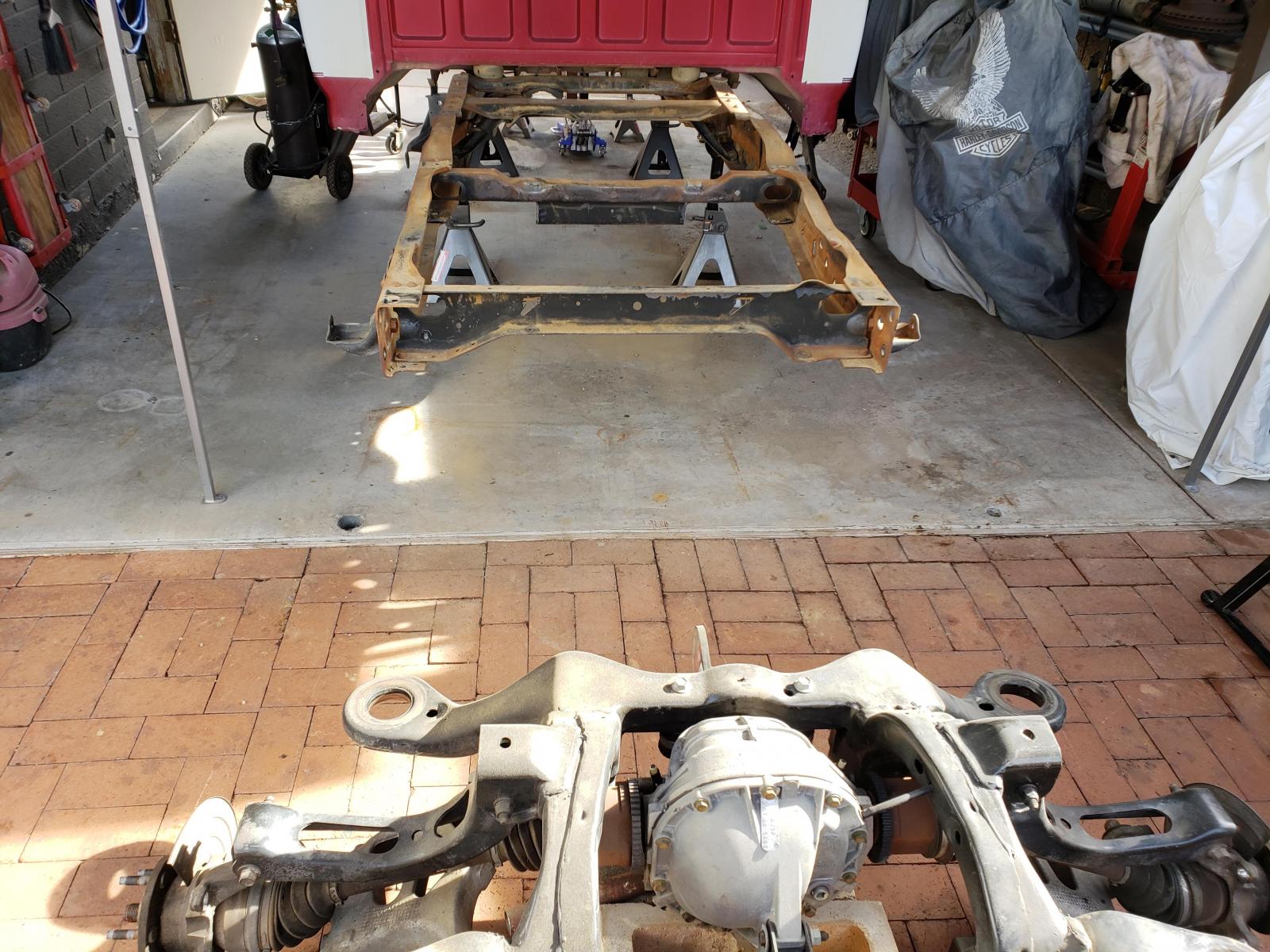

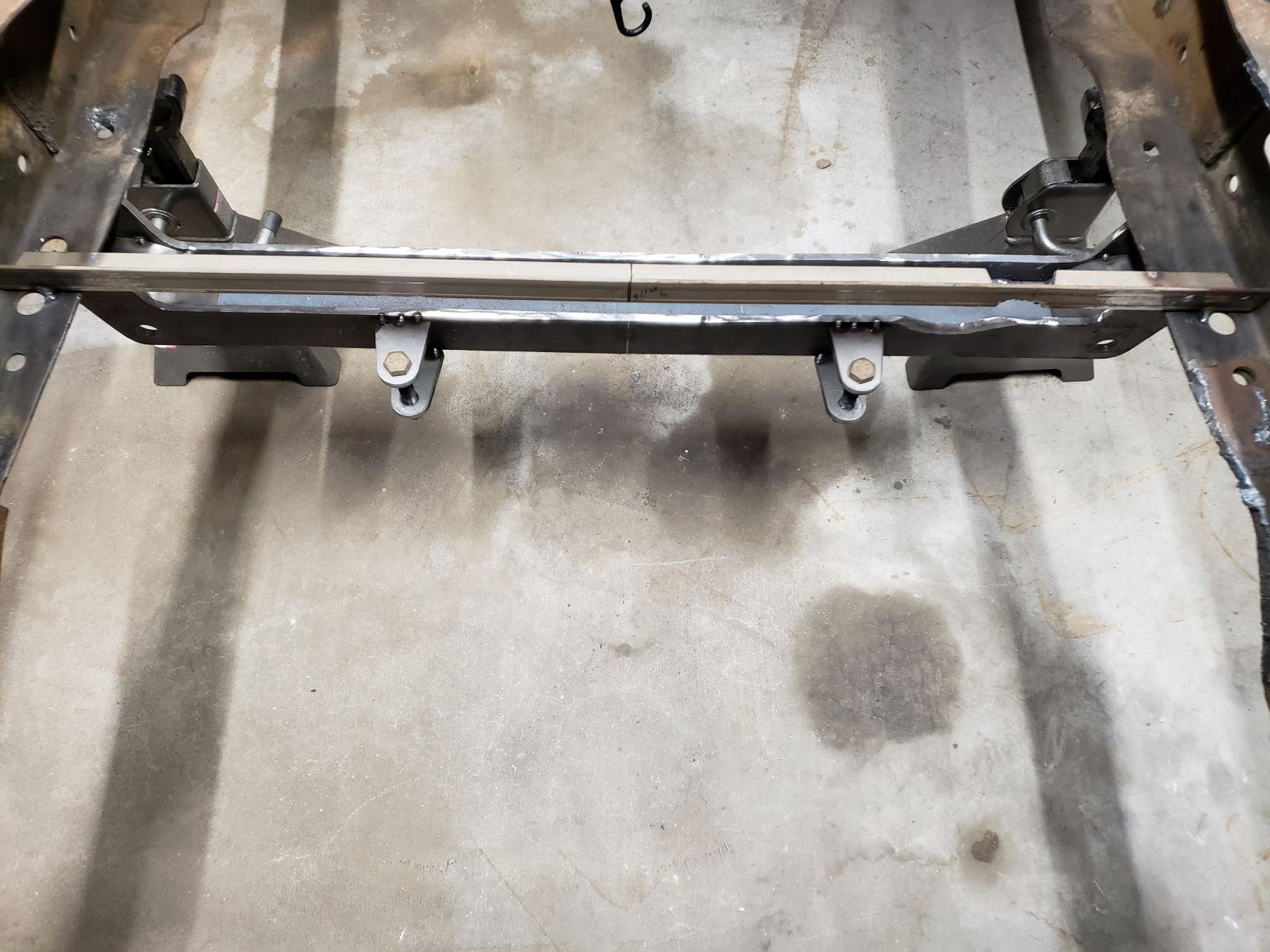

      Somehow had some time to work on the IRS install tonight. It's not welded but it's about 95% ready to permanently install.

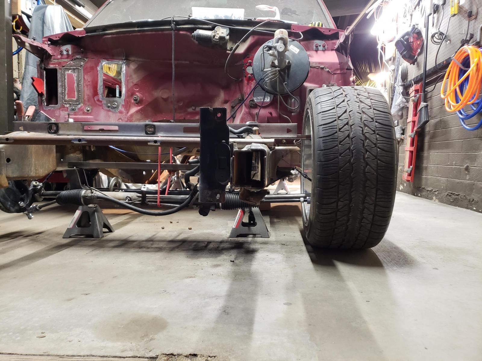

      I do have some concerns about my ride height measurements so I'm planning to set the truck down to actual ride height tomorrow evening and see if I'm happy before going further. Goal is about 5" between the lowest point on the frame and the ground.

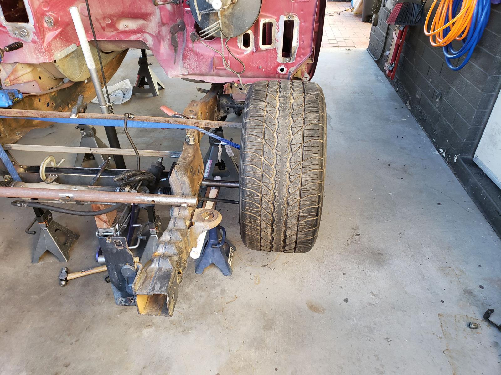

      This evening's task was to drop the entire truck down and level it at ride height. That was.....interesting. Aside from the crazy running back an forth from side to side to gradually lower the jack stands (yay for working solo), I ended up actually dropping the truck on the ground. Scared the hell out of me at the time. I guess a jack stand got kicked sideways and fell. Luckily nothing broke and it was already halfway down. Sorry I didn't get pics. I was focused on picking it back up.
      Here is where it ended up. Bear in mind that this rear sub frame is sitting 2.5" too low. I had my suspicions and jonesbs9 told me that it would seem like it would be setting too high in the frame, but it would really be right. He knew his ****. By my original measurements, this should have been acceptable. No big deal.
      The entire point of doing this was to find issues like this:
      Somewhere I didn't quite measure right and you can see that my lower control arm is angled up. This will royally screw my roll center so I'll probably just cut the tacks on the cross member and shave about 1/2" off the top to raise it. At least the steering rack will have more ground clearance this way.
      MOAR LOW! I'm 5'10" for reference. Lowest point on the frame to the ground is 6.5". I think this makes it manageable around town but low enough to handle great. Time will tell.
