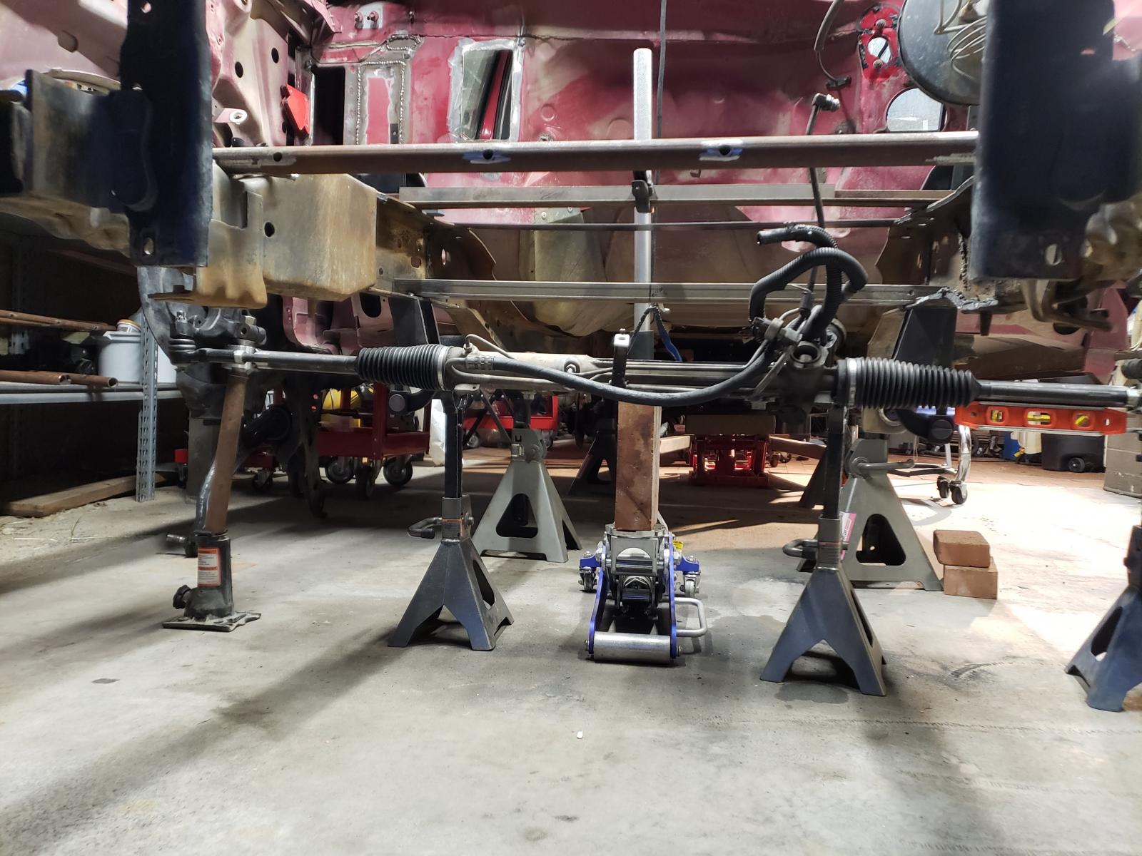

      I went and picked up 1.5 and 1.25 DOM tubing along with a big sheet of 1/4" steel so I can get this front suspension done. I'm so over thinking about it. Haha.

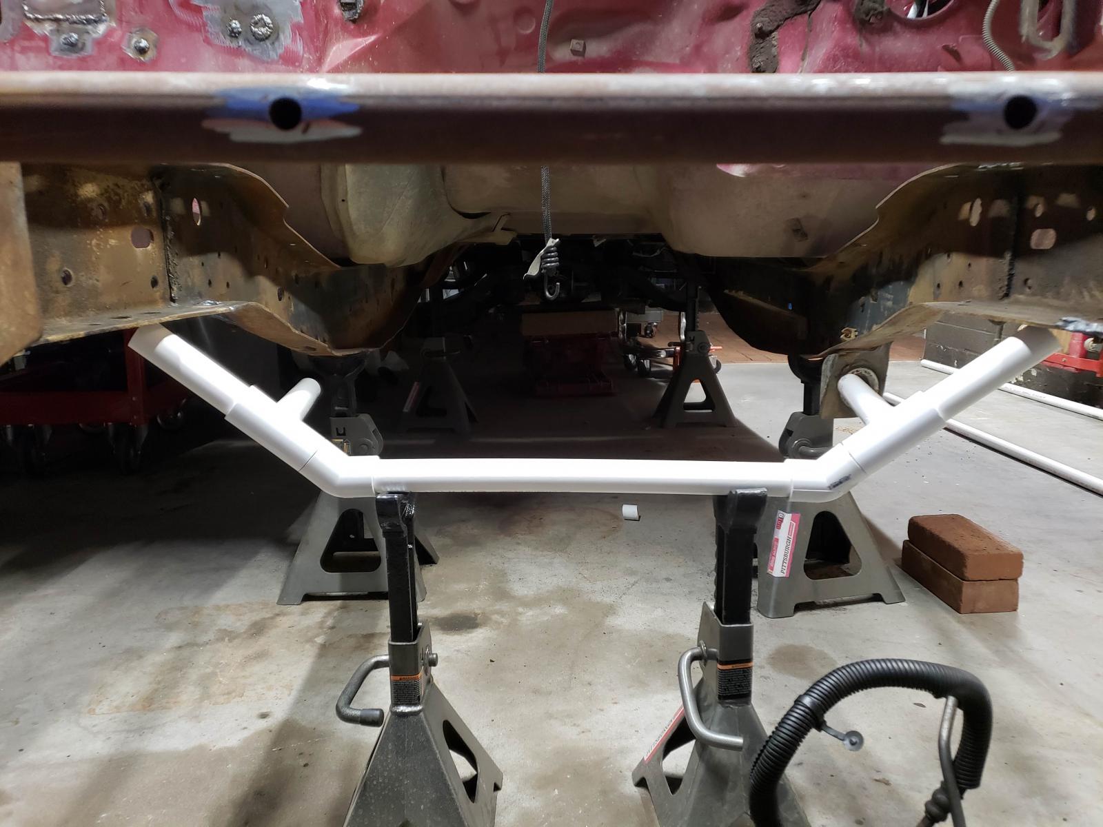

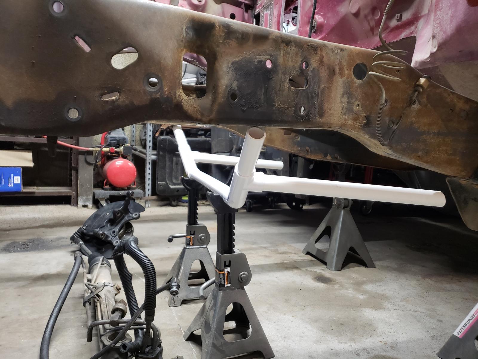

      I found some PVC and fittings around the house so I decided to do a VERY rough layout of what I had in mind. What do you guys think of the idea? Ignore the exact angles and lengths. I'm a visual guy so I had to just see something there.
      That leads me to needing some input. Again. If I bend the main cross bar of this new subframe I loose about 3" of width on each side. So my lower control arm mounts would be long. This seems weaker in my mind. I was just thinking that I could miter it all together instead and use gussets at the joints. Wouldn't that be more than strong enough for a 3600 ish pound truck on sticky 315s?
      Throw in your ideas here. I'm putting something together this weekend darn it! Right or wrong. Haha. I need to keep moving so I can get motor and tranny mounts done before the end of the month.

      Personally, I would rather see one tube bent and longer tabes than a miter cut and joined part.
      That being said if you had a longer tab and were worried about it moving add some gussets, reinforcements, and support tubes. I roll back to my off-road days and spend my time looking at trophy trucks and class 1 cars. if you have access to a plasma table or just a cutter you could fab some super strong crossmember out of 3/16 MS and incorperate the pick ups for your suspension. it wouldnt move at all. the frame will move before that will.
      Just because someone has not done it on a autox or road car build doesn't mean it can't be done.
      Just my few pennies in thoughts.

      I don't disagree at all that 1 bent tube would be nicer than 3 mitered together. Maybe I'm just being lazy, but I spent 2 hours trying to do the math on the bends last night and I still didn't get it right. Haha.
      To your point about the tabs, maybe I should bend it narrow and make longer tabs from that. Having some kind of structure to measure from would be MUCH easier. That's the real hurdle for me. There isn't really any place to accurately measure without anything between the frame rails right now.
      The thought about making it out of plate like a TT did start to creep into my mind too, but I think the tubing will be easier in the end. Probably cheaper too. Would be nice to have all the pivot points built in though.
      Any tips on measuring this better?

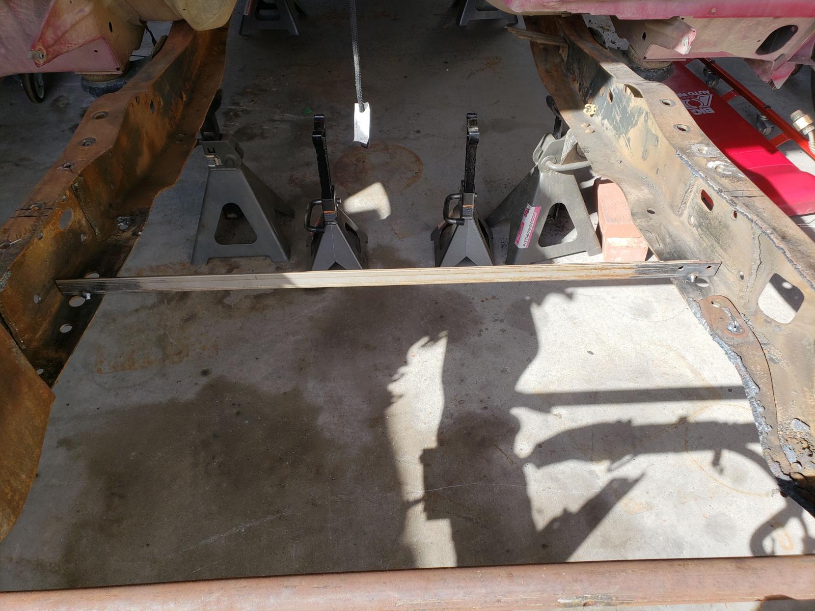

      What are you trying to locate?
      I would think you could tack a couple tubes across the frame, use the existing holes and cross measure to find the center and use that as a reference point.
      And measure 20 times. And then check a couple more times.

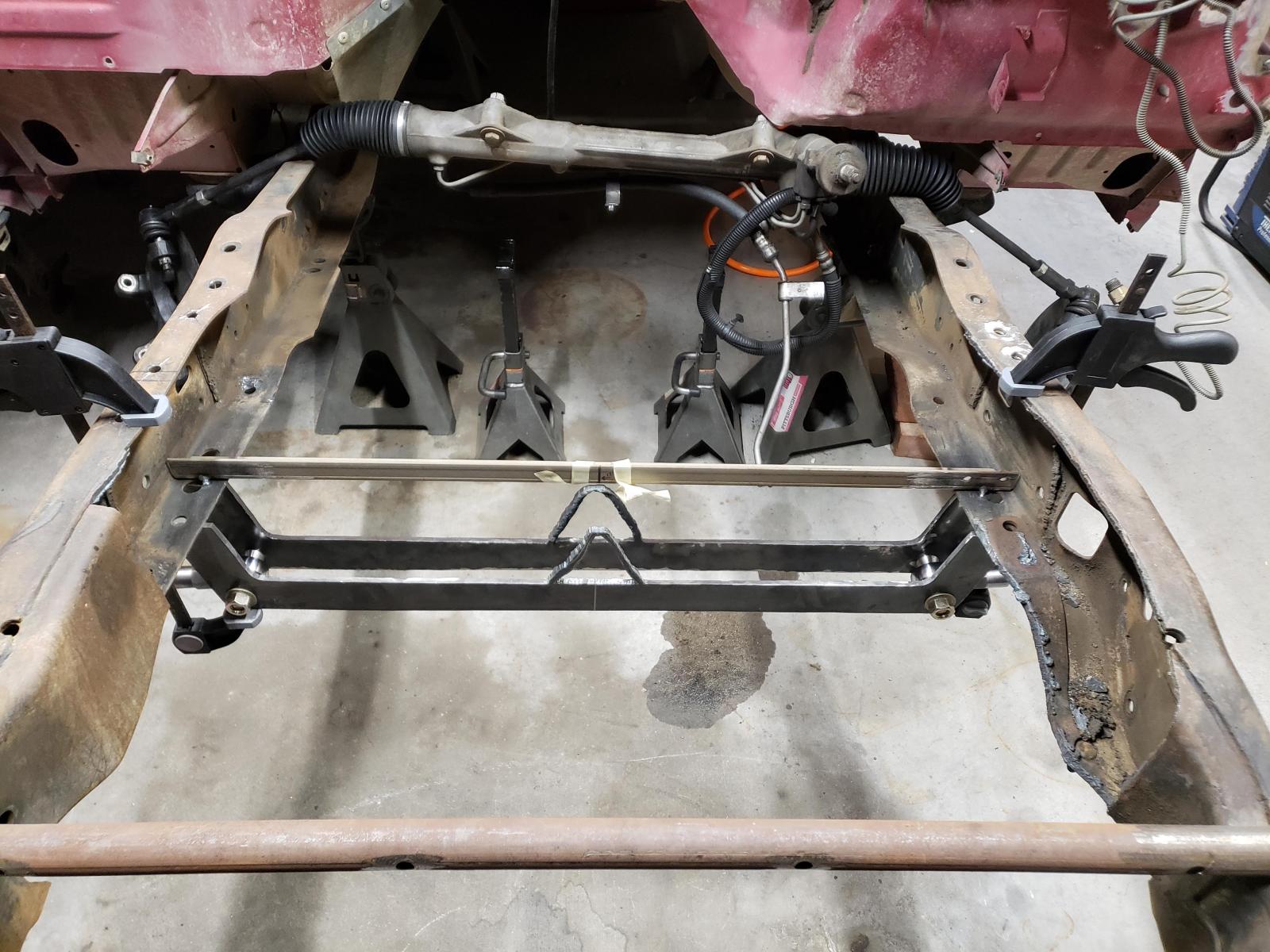

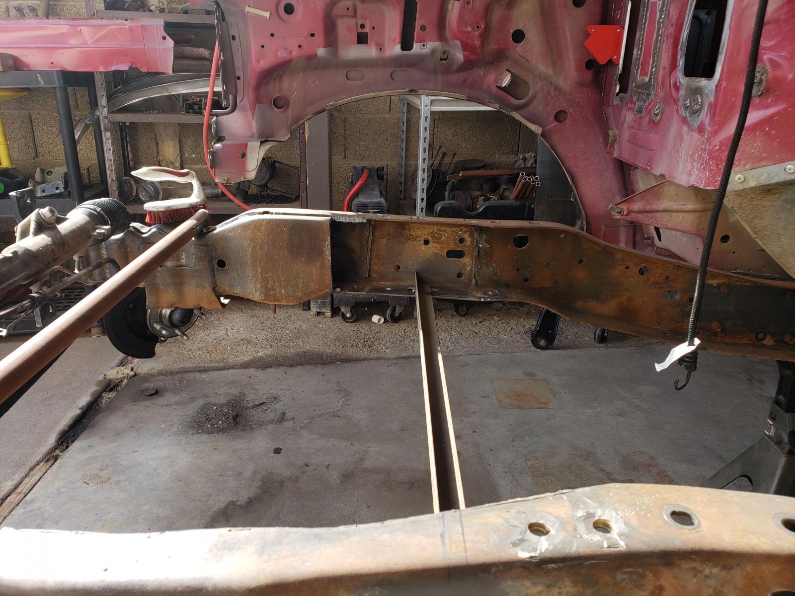

      I feel like today's progress is minimal given the amount of hours that it took, but at least I am executing on a plan.

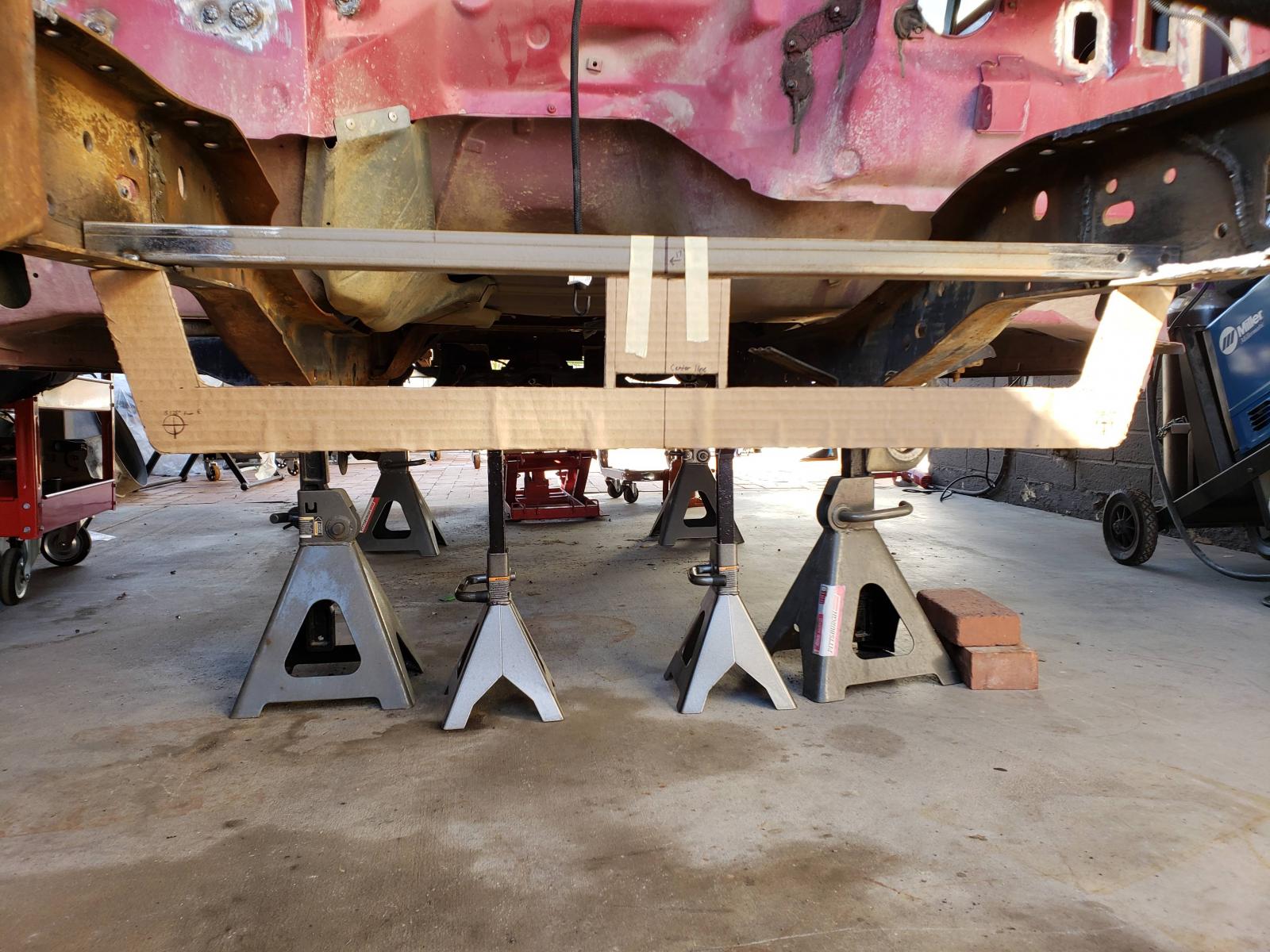

      Thanks for the idea for adding a piece of metal across. I had this extra 1 inch angle iron that was perfectly straight. A few solid tacks later and it made a perfect center line. Can't believe this didn't cross my mind before. SOLID tip.
      Funny thing about finding the center line on this truck...the factory beams aren't perfectly in line so instead I am measuring the center on the wheel opening as best I can. If it's off a few mm in the end I'll use some of the adjustments to make it right without killing my geometry.

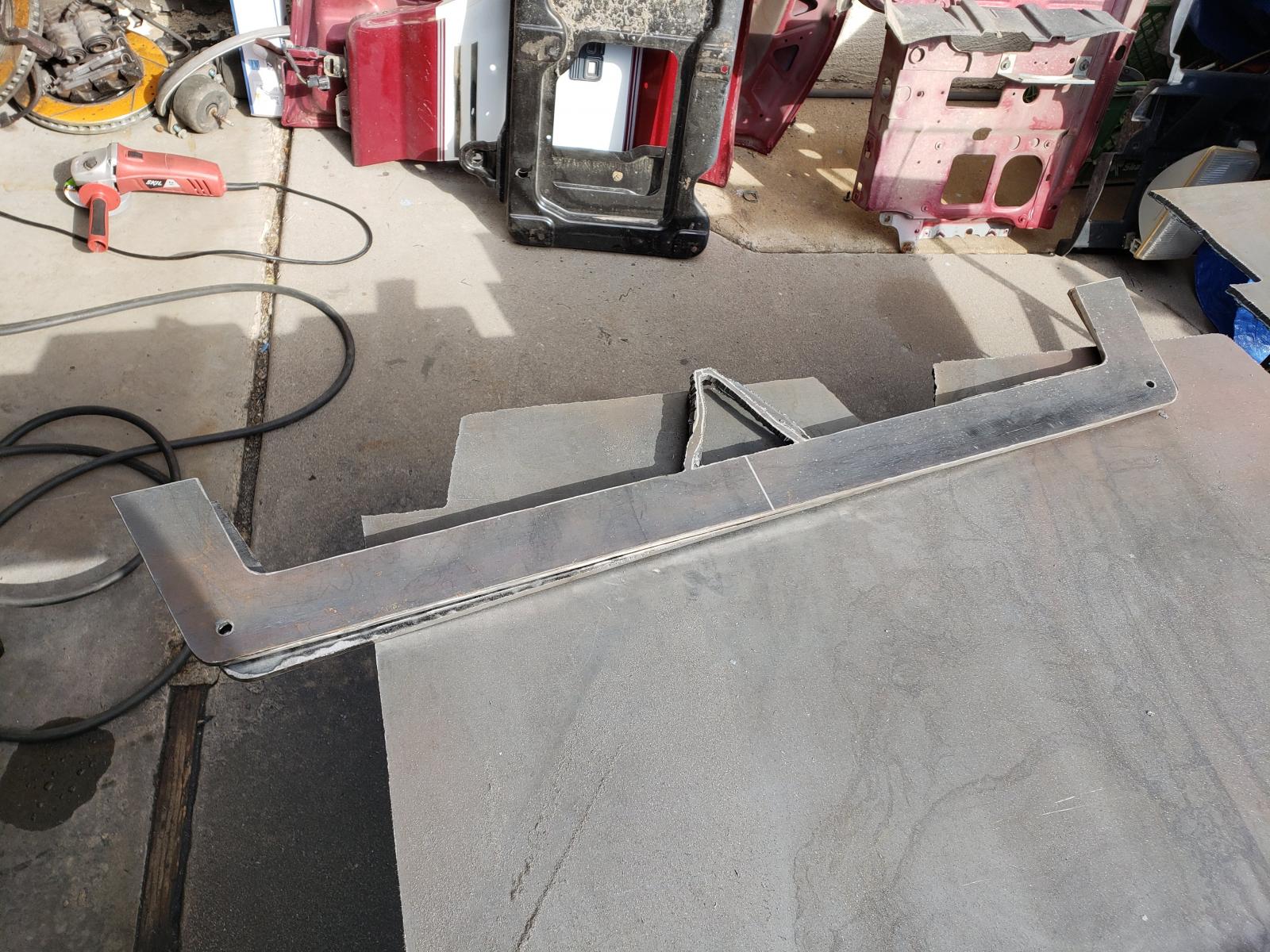

      This is the final cardboard template for the main cross member. It's 2 inches in width all the way around and cut from a sheet of 1/4" steel. There will actually be 2 of these that sandwich the front lower control arm joints. I'll add thinner steel plate in between and then box it all in. Should be stupid strong. Just like a Trophy Truck.
      I got it all marked in silver sharpie and borrowed my neighbor's plasma cutter, but a rain storm blew in from CA so I had to pack it up for the day (ugh). Hopefully I can get this cut tomorrow. I'm excited to see it in place...FINALLY.
      Thank you guys for your input. It's been invaluable.

      Today I actually feel accomplished. By the time I got moving this morning the rain had cleared and it was a really nice day. So I went right outside and fired up the plasma.
      Here is the two main parts of the cross member just after grinding the slag off. Ignore the little triangle things. That's just for a centering line I made. I'll be cutting those off as soon as it's actually in the truck. I also realized right after that I needed bolts so I went and grabbed Grade 8 zinc coated bolts. Didn't realize how expensive big bolts are.
      I forgot to take a picture of when I bolted them together and ground the edges to exactly the same. It's not that exciting. Grinding a 1/2" of steel wore out my hand.
      I had a hell of a time drilling those holes perfectly, but when I clamped this in it was all worth it. Feels AMAZING seeing this in place. I'll tack it in and start boxing together hopefully tomorrow. I ran out of time today. Remember that I'm adding material inside and around so that gap won't be there and it won't just be hollow. I can't wait to see the end product! What do you guys think? Btw, the bottom of this is exactly 1" higher than the lowest point on the frame and I should have miles of room to the oil plan.
      Final boxing and lower control arms to come next! And if any of you get the terrible idea to try building an OBS Ford too, I am keeping all my templates. So yes, I could reproduce this setup again if it really works.

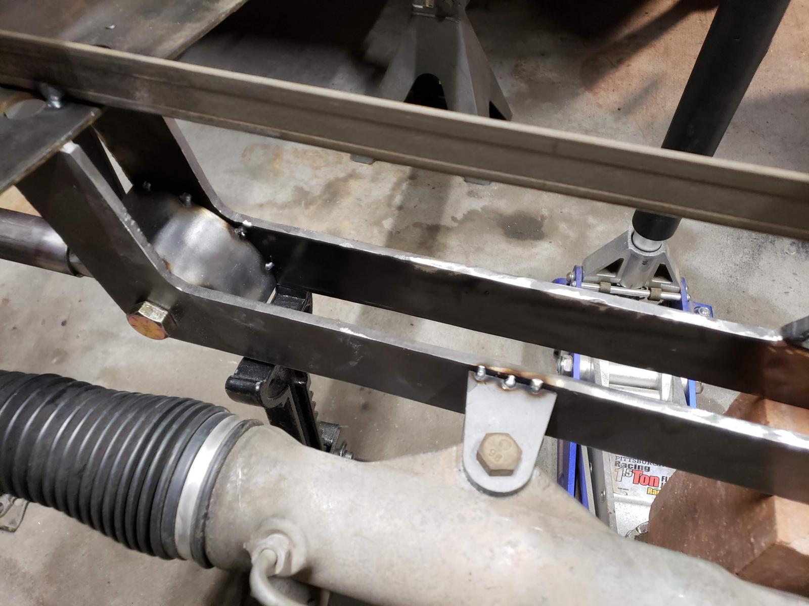

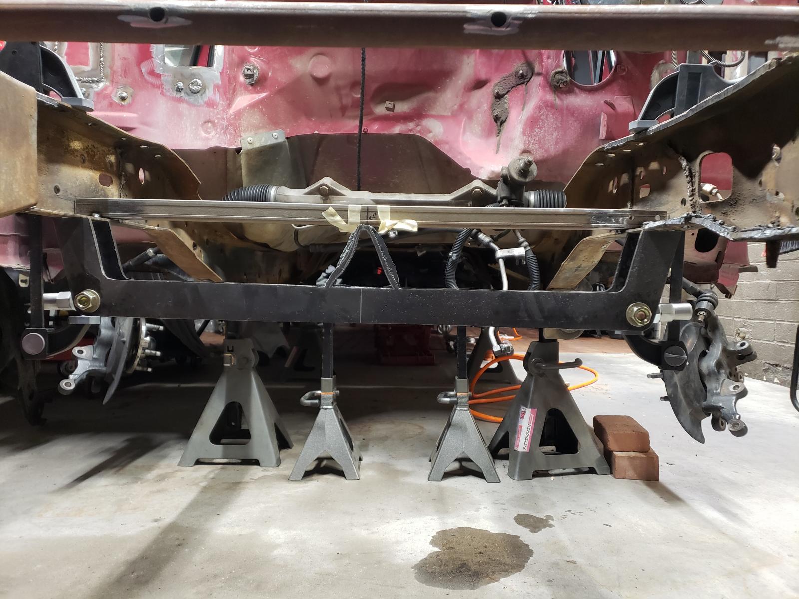

      Well I had to wait all week to get more time to work on this front suspension, but I made sure I got stuff done today. It's really starting to come together.
      This is the main part of the lower control arm for each side. I'm missing pieces from QA1 due to a back-order still, but they should get here this week. Then I can finish the other half of the lowers and make the whole upper arm for each side. I'm hoping this is way overbuilt. Certainly looks the part.
      Here was the steering rack going in. Took me a while to position it right and get the mounts lined up, but that's kinda how all this suspension has gone. Measure, move, measure, move a little more, repeat 50x. Takes longer to measure where everything goes than it does for me to make the mounts.
      Here you can see the beefy tabs that hold the rack and the 1/8" plate that I formed into a pocket for the lower heims. I'm really happy with how this is all going. I'll leave everything tacked until it's all 100% together. Then I'll disassemble, finish weld, and paint all of it. I have come to really enjoy taking it all apart at that point because you always notice where something is hard to remove so it can be redesigned then. I want this to be super simple to replace pieces while laying in a parking lot if I have to. Perfect example is that bolt. It hit the rack before it comes out so I already flipped it around.
      The only real issue that popped up was I tried to shorten each control arm slightly to shrink the track width since the S197 mustang is wide. I might not have enough adjustment in the tie rods for a 1/2" on each side. Worst case I'll make slightly longer arms. What do you guys think?
