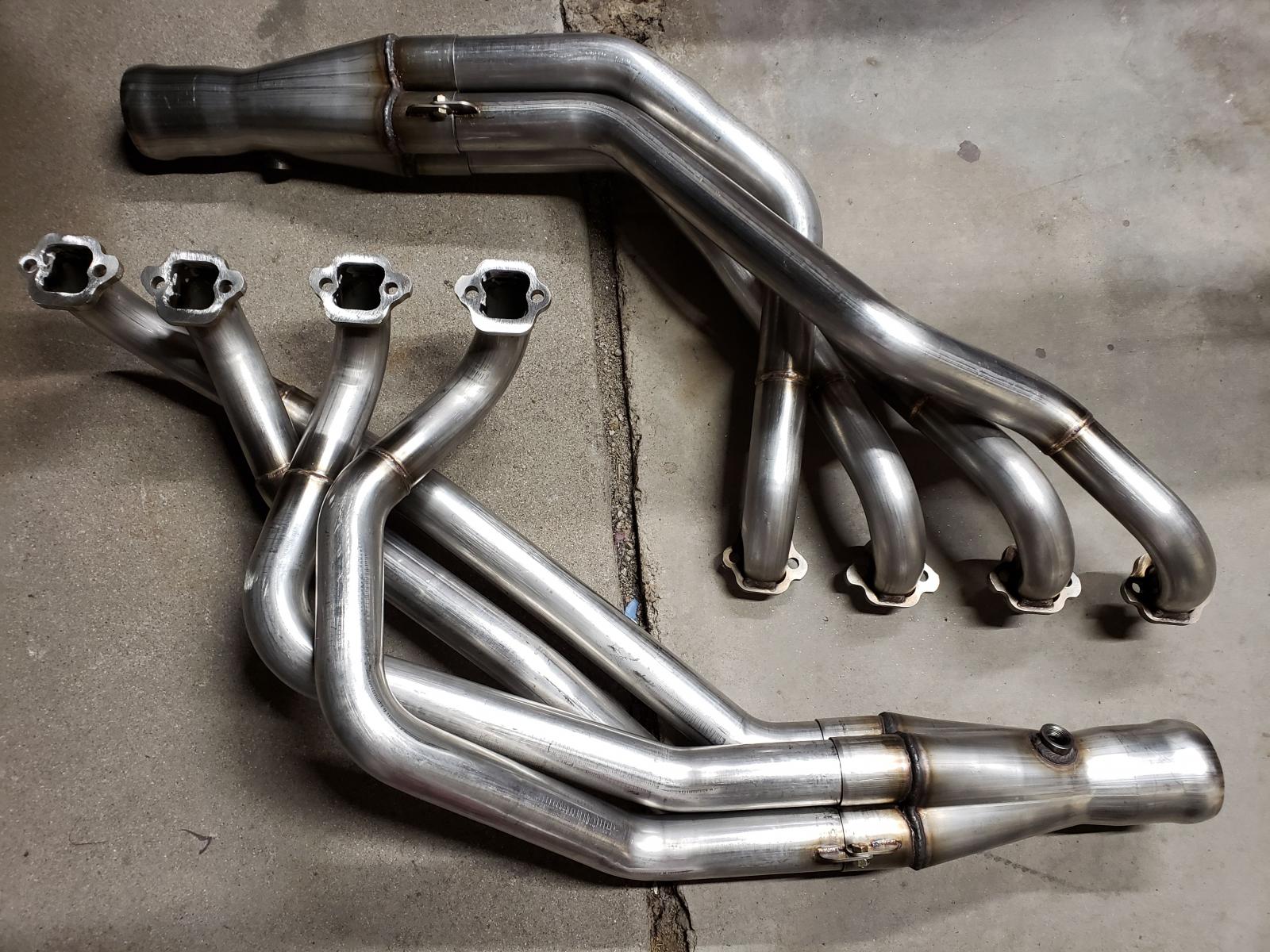

      This is what a $1300 gamble on made-to-order headers looks like. These are for a 90's foxbody with a 351w swap and stock everything else. Nobody makes large primary stainless headers for this truck. I am guessing that the little mustang has less room to work with making me good to go. We shall see. Yes I can make my own, but if you've ever done that before you will understand why I'm trying to avoid it. I spec'd 1-7/8" primaries with 3" collectors in 100% 304 stainless. They are produced by American Racing only if you call.
