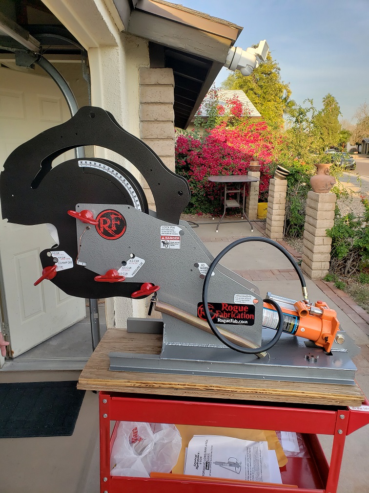

      If you've never seen this bender or heard of Rouge Fabrication that's a shame. They make awesome fab tools like this thing for usually much less than other companies. A lot of the crawler guys love this for bending 2" tube so I figure it will handle my 1.75" stuff with ease. I just need to build a real cart for it.

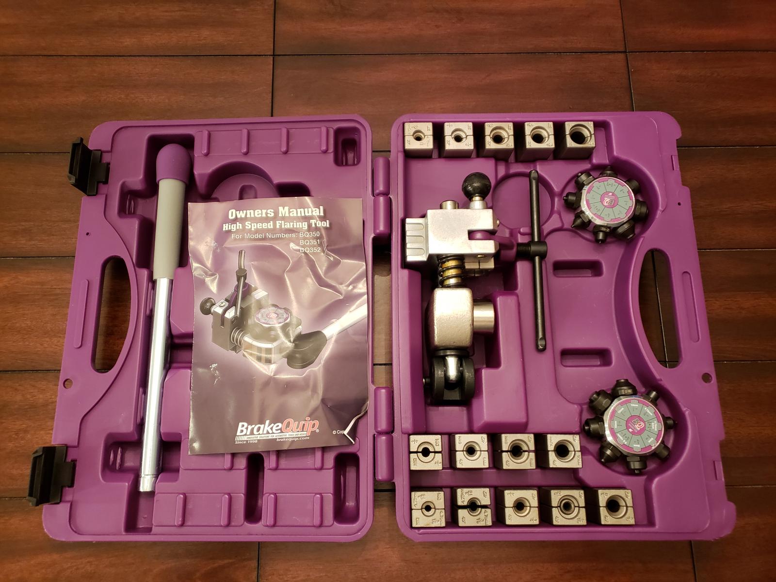

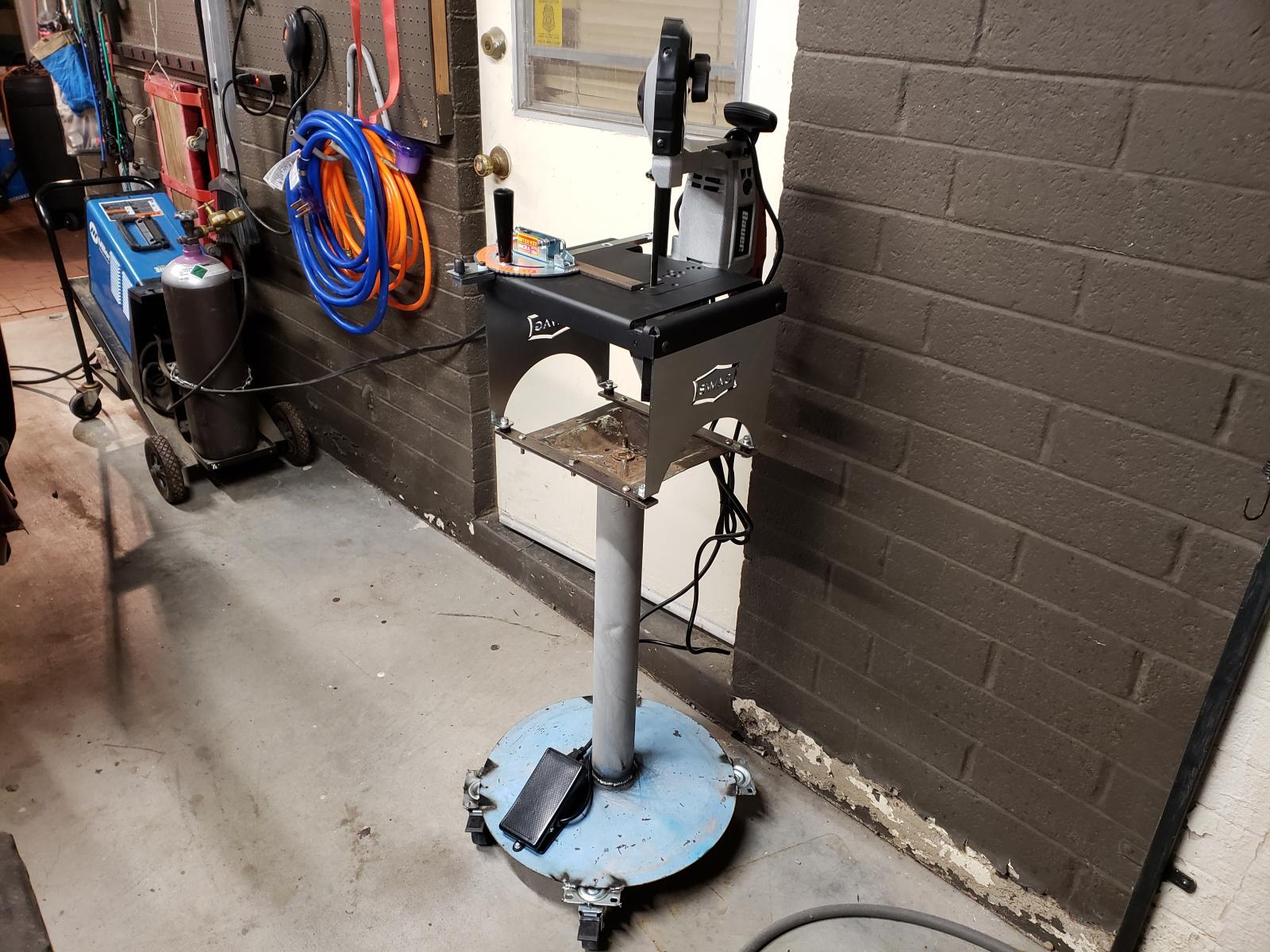

      Picked this puppy up on a coupon from Harbor Freight (keep your china comments to yourself). Then I bought the little table for it and made the stand with some casters. I'm only at like $300 as it sits for a metal bandsaw with a 6" throat. It's already been handy.

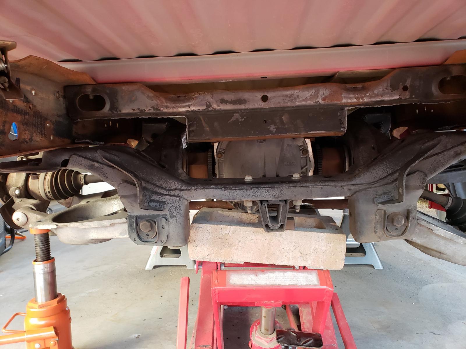

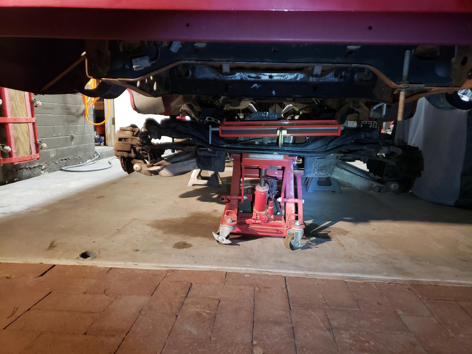

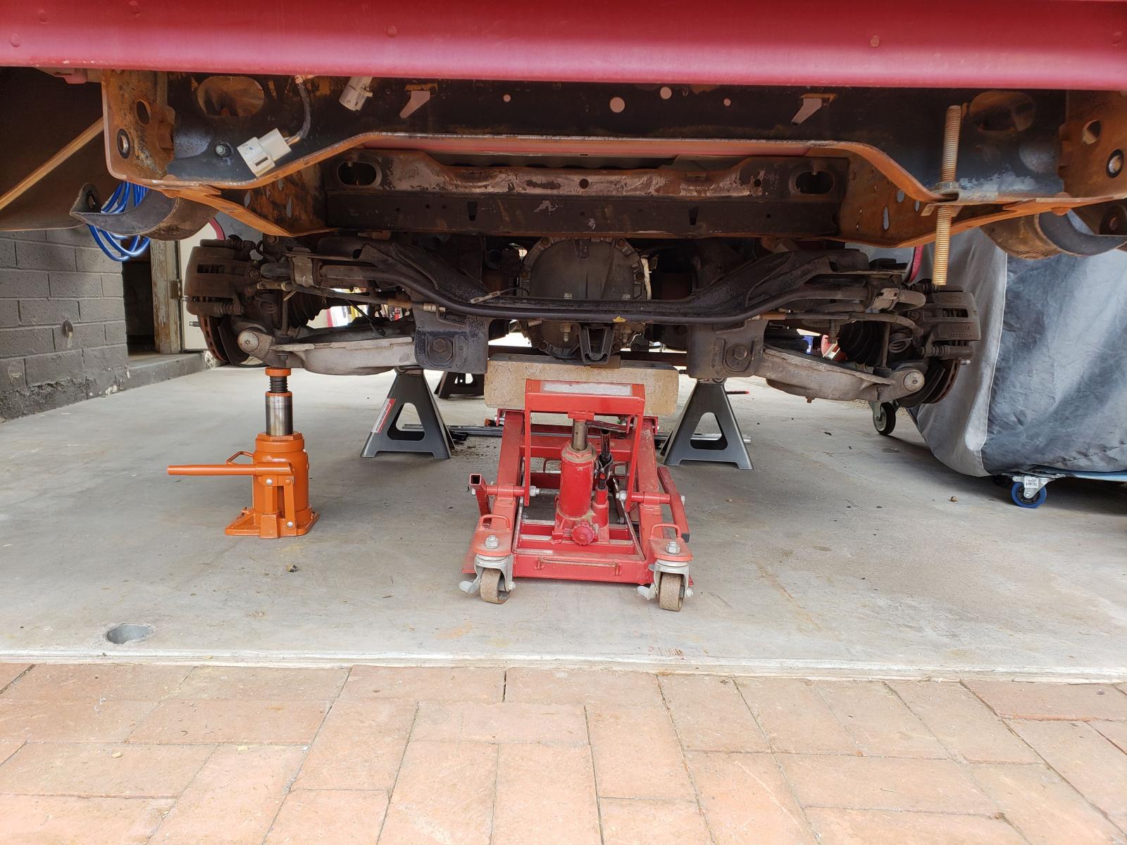

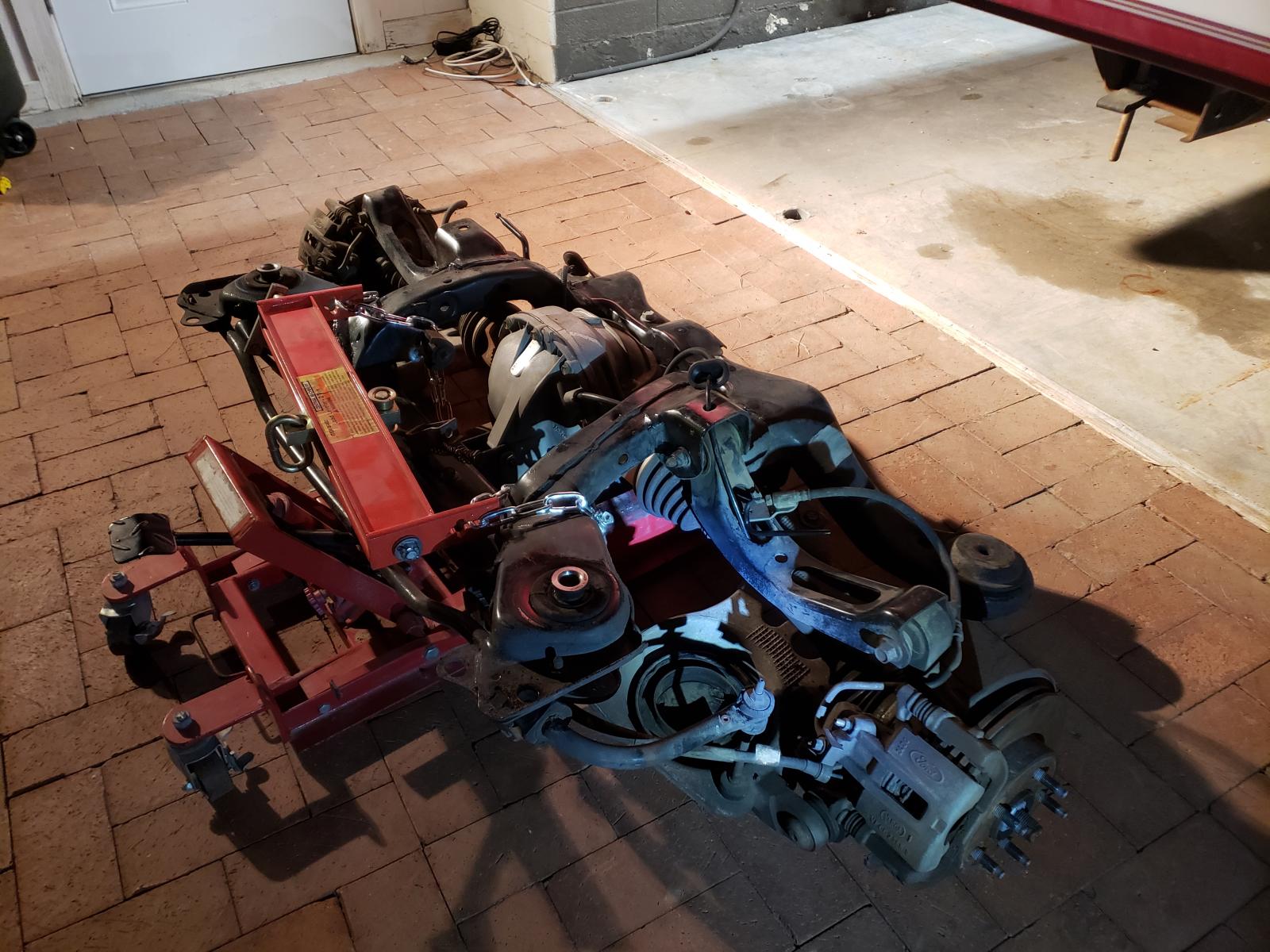

      And the most important update of all....I got a DEAL on this 1995 Mark VIII rear subframe. I couldn't believe it when the girl told me $175! I am swapping to cobra hubs, bearings, and brakes. I'll add 3.55 gears and probably TracLoc. I'm open to suggestions for LSD units. Also, why does nobody seem to make replacement bushings!? I found one place and it's almost $500 for poly! F that. Maybe I'll go throw Delrin in my buddy's lathe later and make my own. For now I'll get going with what's there.
      Little test fit with the ATV jack. It almost looks like it was made for it. I need to go pickup some 1/4" plate and borrow my neighbor's plasma cutter so I can get it installed.

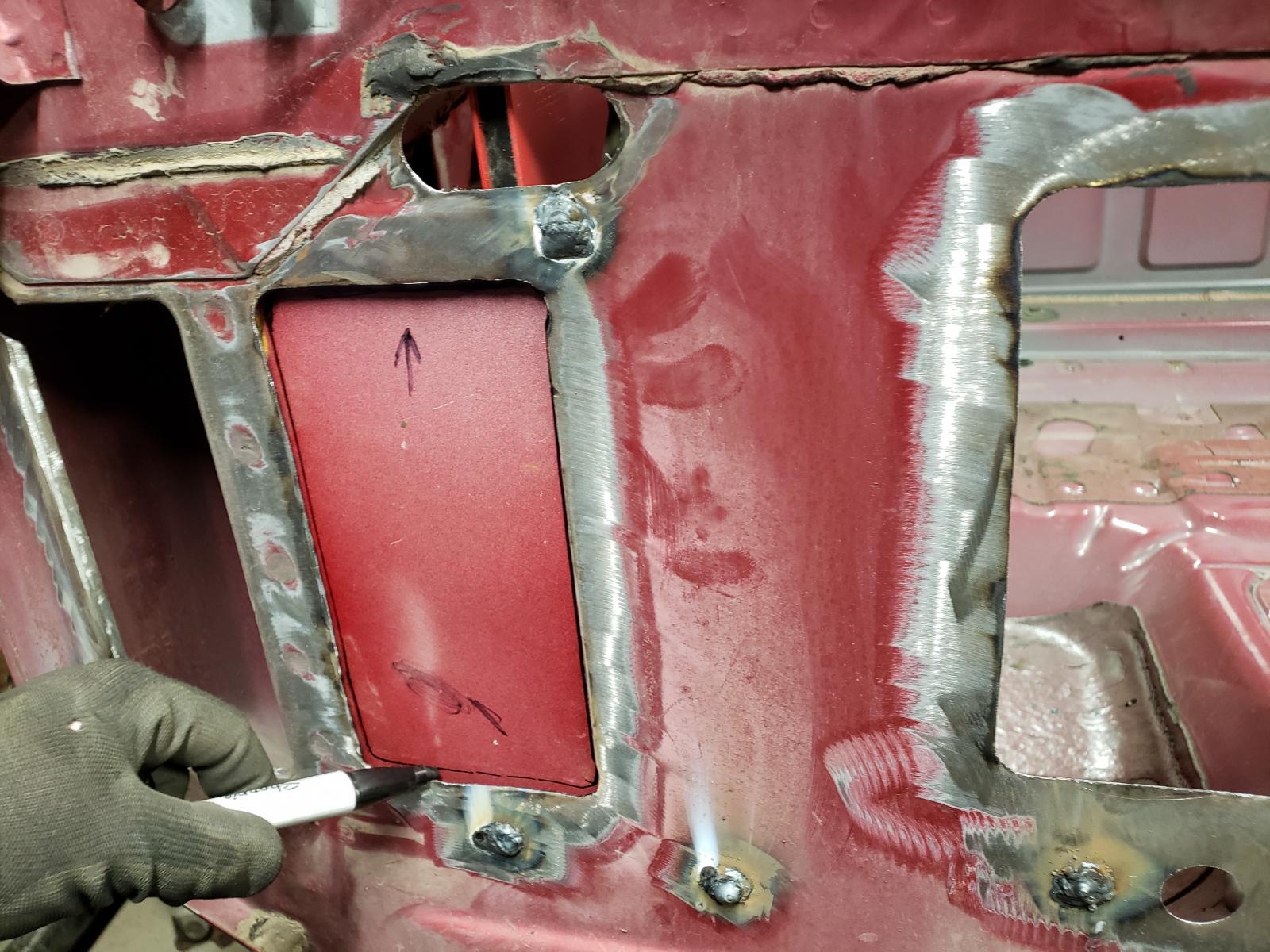

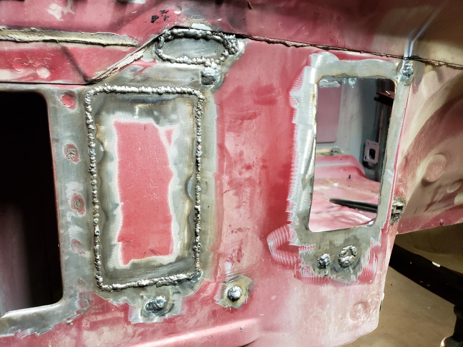

      Also started on the sheet metal patches on the firewall. I knew I was not excited about doing this for a reason.
      Funny thing is that the welding wasn't too bad. I'd like to be able to turn my MIG welder down a little more, but it works ok. No, the fun part was as I was tacking away and started hearing a hissing noise. After a couple minutes it got the better of me and I walked over to find that my regulator committed suicide and leaked half my new tank out. Yay. Luckily Harbor Freight is open on Sunday's (practically my church lately) and carries a decent regulator. So as you can see I got some holes done. I'll grind it all after I'm done welding.

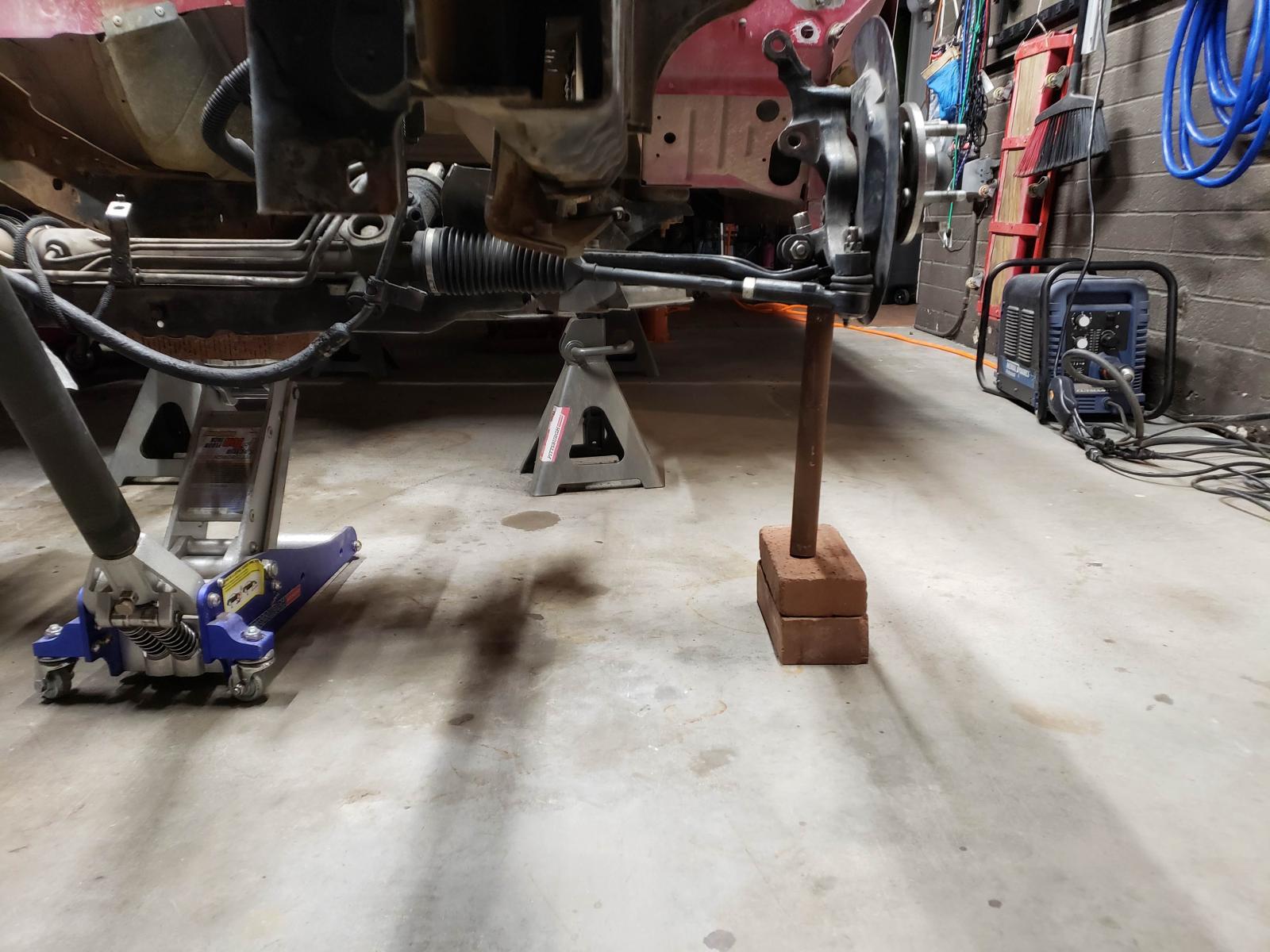

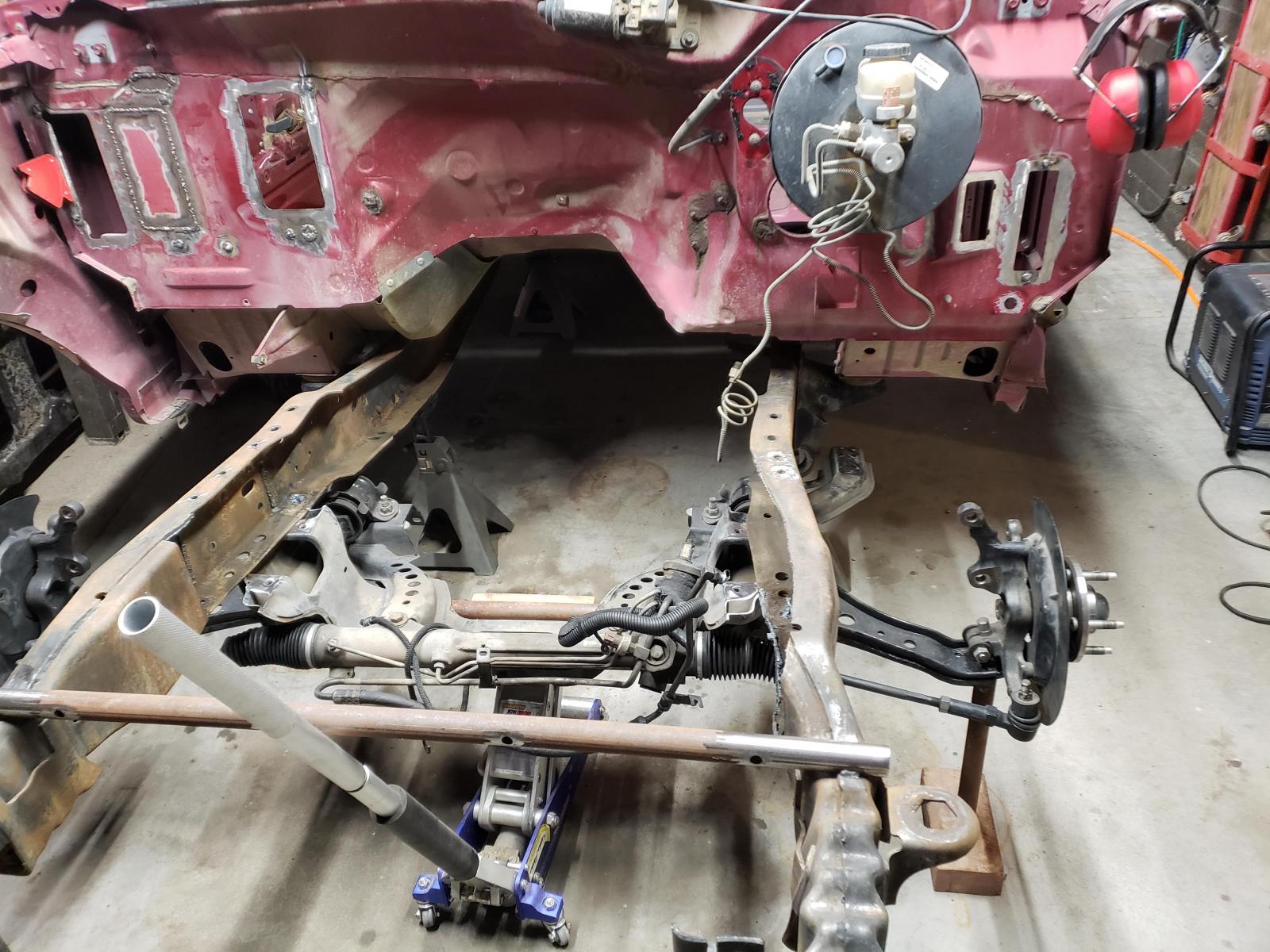

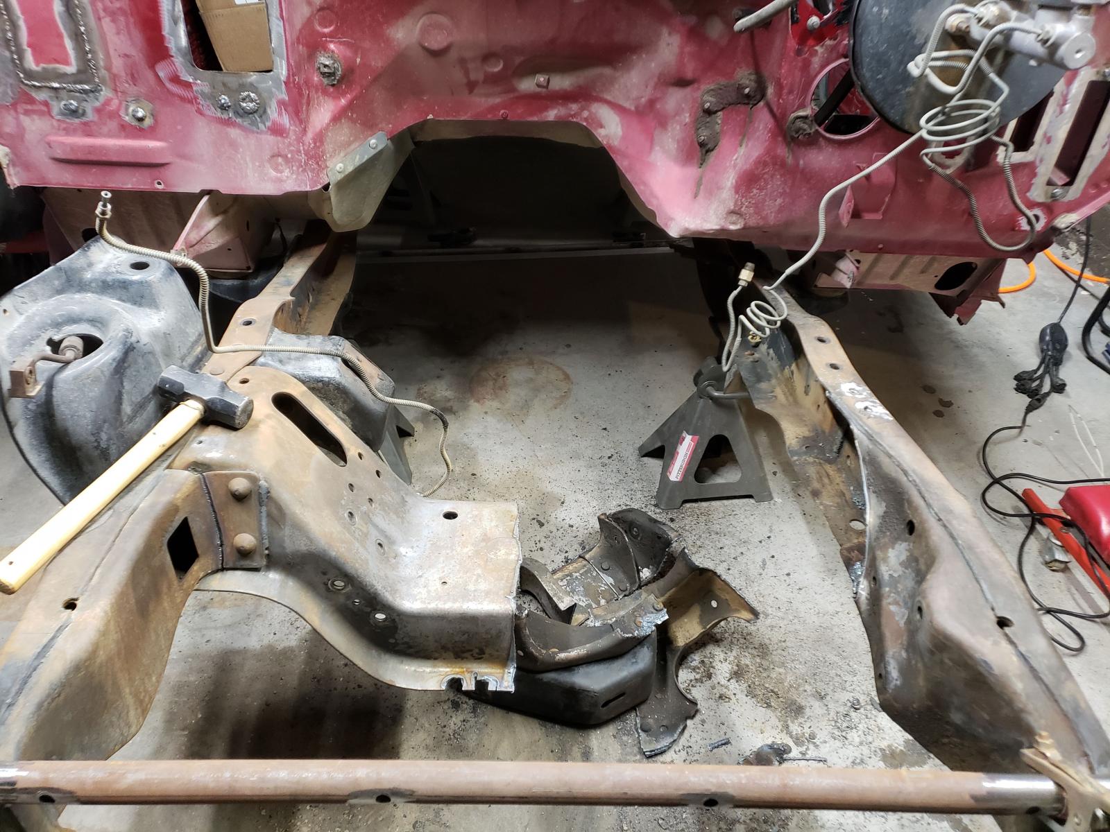

      So I stayed true to my plans and worked on the truck most of the weekend. I actually feel like I was productive and got stuff done.
      For leveling I opted to make the bed sides level front to rear as the cab would follow. Then I put 3ft long levels across the frame rails for side to side. It was an annoying process on a floor that has a weird slope and this frame looking like rolling hills. But I got it. Didn't grab any pics. I was too glad to be done with that.
      I ran down to borrow my neighbor's plasma cutter. I can't figure out why I don't own one yet other than feeling cheap there. I can honestly say that this job was 1000% easier having one. An angle grinder would have made this miserable. It's already enough work by myself. So I burned in a tube to hold the frame rails steady to start. Then I tore into that cross member. I've wanted to cut this thing since I got the motor out. Felt good. My god this thing is HEAVY! I cut it into chunks to make it easier to manage and save my toes.

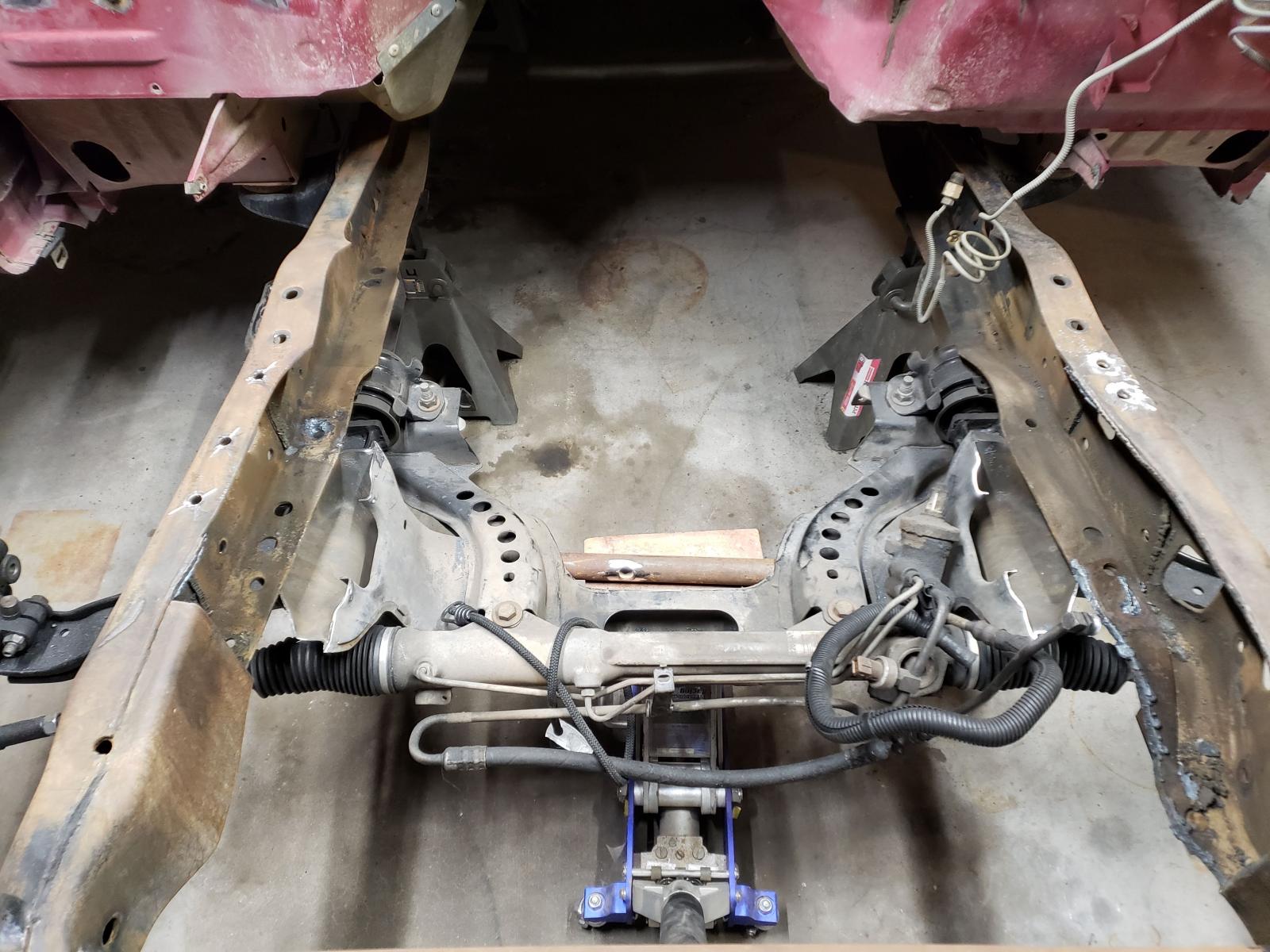

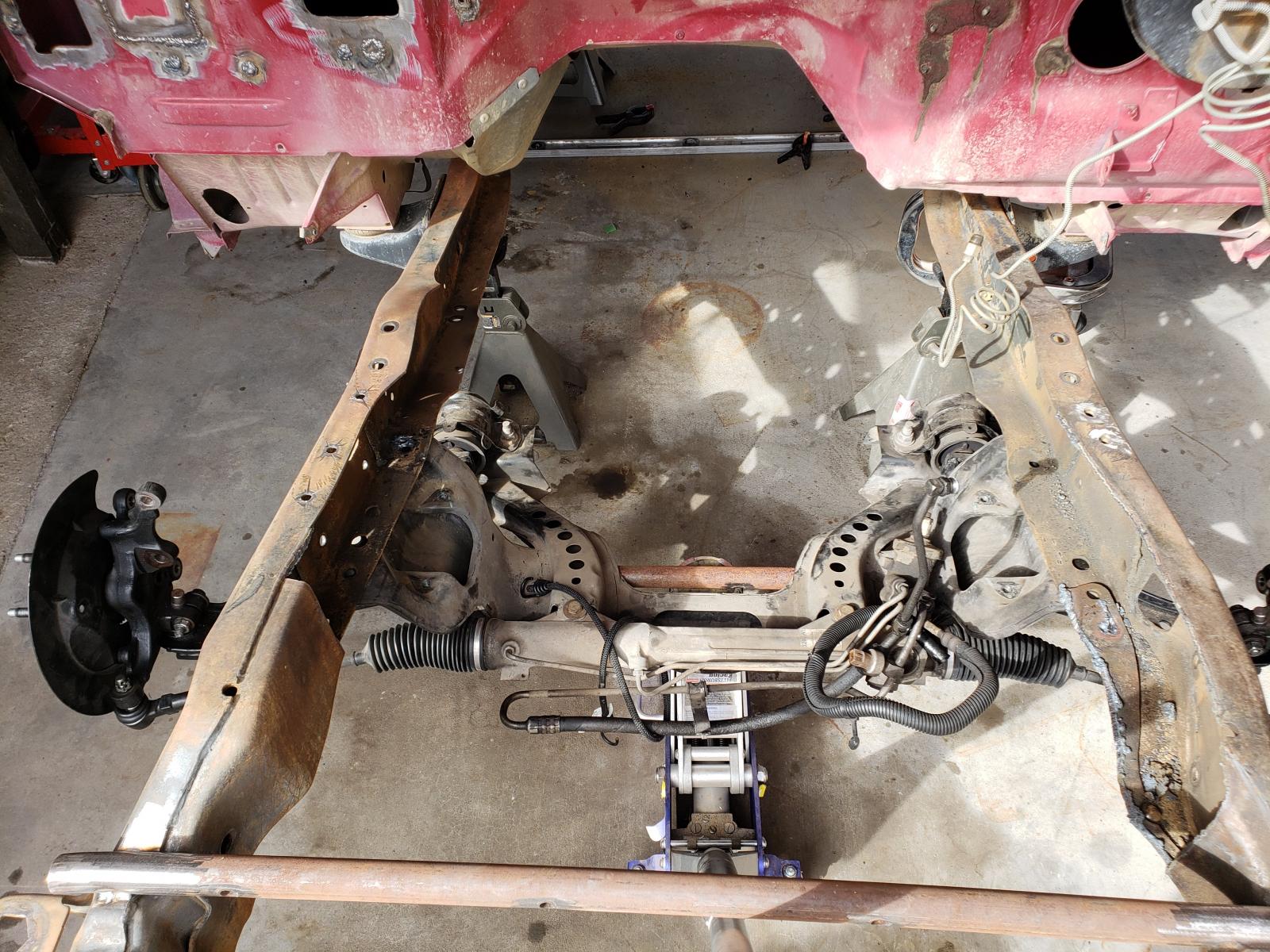

      Success! Then I could test fit that Mustang subframe. Let me say this...if someone ever asks if they should start with a piece like this or just build from scratch, I'm saying scratch. Looking back that is what I should have done, but I'm this far and money is spent to I'm pushing through. After measuring, I needed to raise the sub frame up to get my ride height lower.
      So I started trimming down with the plasma and grinder.

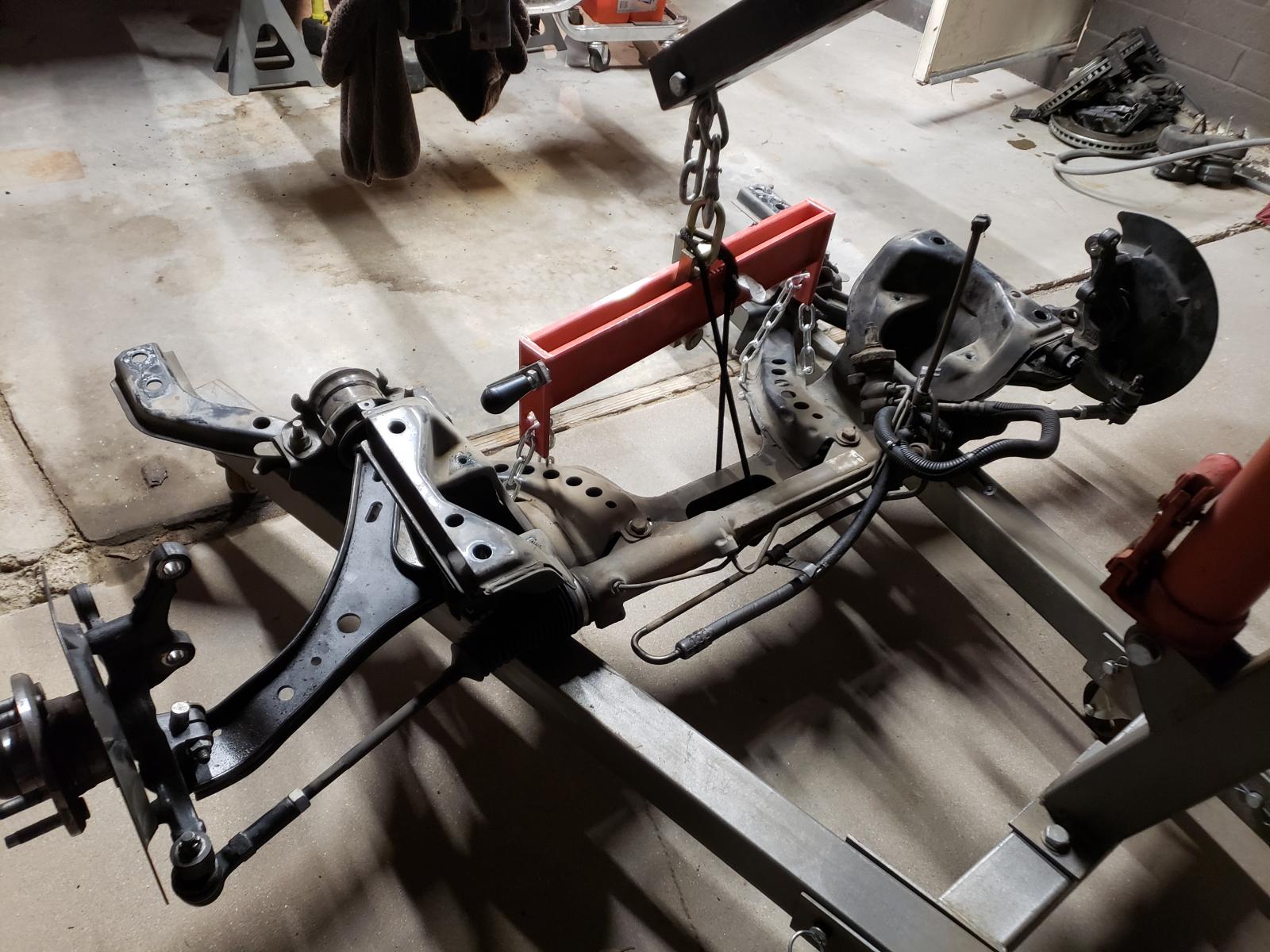

      Fit #2
      Fit #3

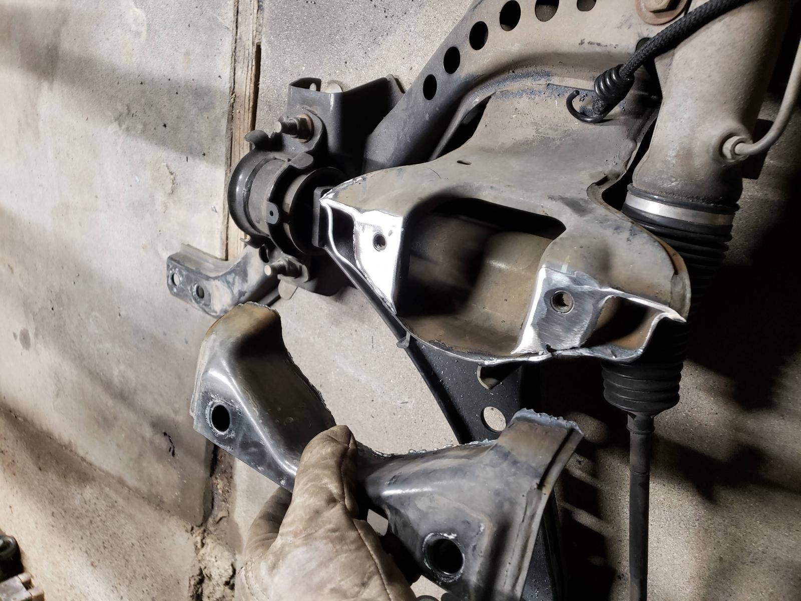

      I think this is about where I want it. It looks scarier than it is. I'll plate it in once I verify everything is in perfect alignment. Should be plenty strong. Usually I don't like to NOT bolt this stuff in, but if it ever needs to be replaced I'll just build a new one myself. This should work great for a while at least.
      As I'm going I am also fitting the rear. I don't typically like to bounce back and forth like this, but doing so here allows me to make sure that both ends have similar final right heights and good arm angles. This **** takes forever!
