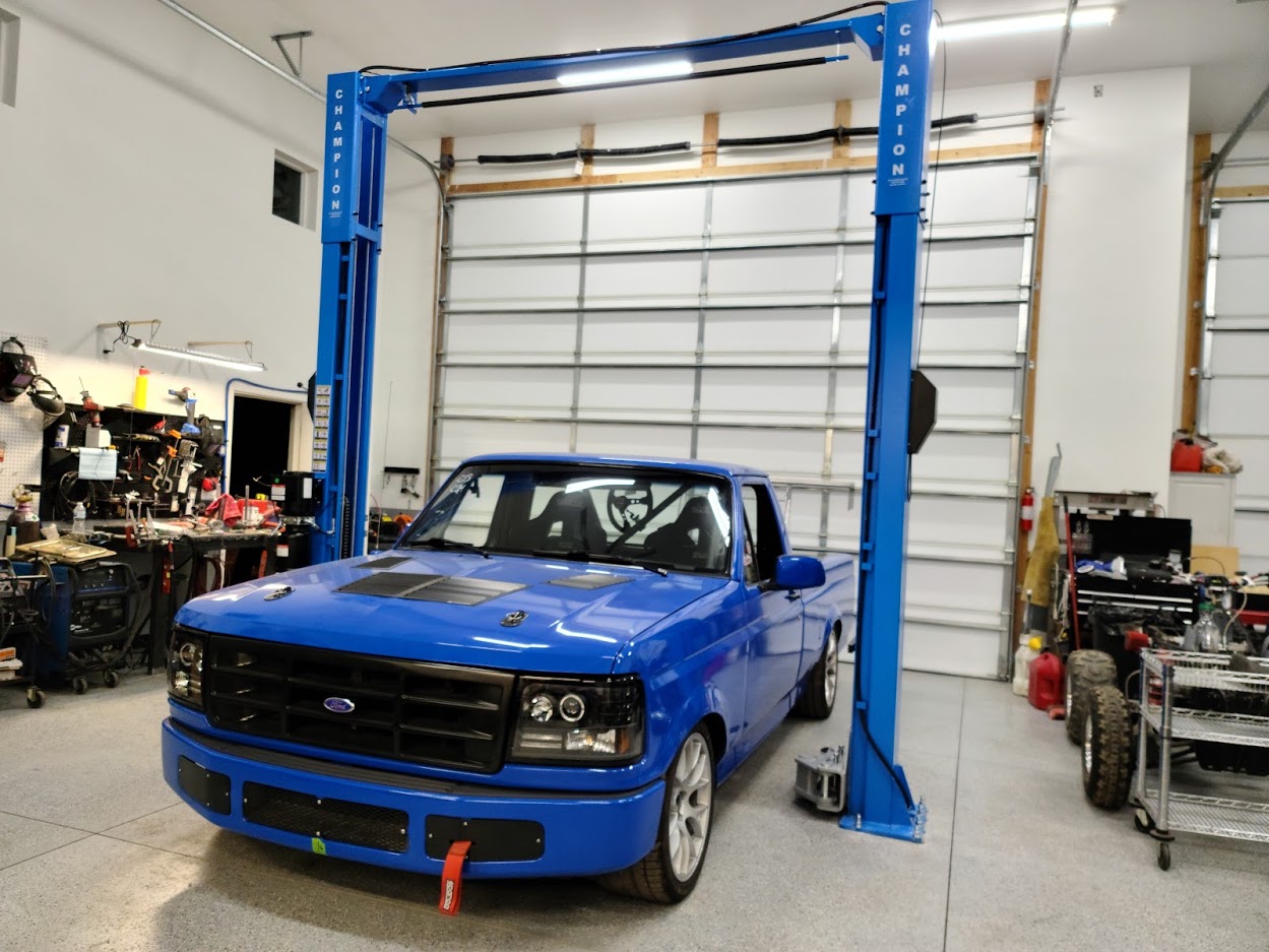

      Maybe not a major update, but a major dream of mine has been now realized.
      That's right...we got a lift! So excited for what this will allow me to get done with both speeding up tasks, and making work under the truck much more accessible. Saturday I have an electrician coming out to help me run power over and from there the possibilities are endless. All my cars (still makes me laugh to say that) have time "scheduled" on the lift already.

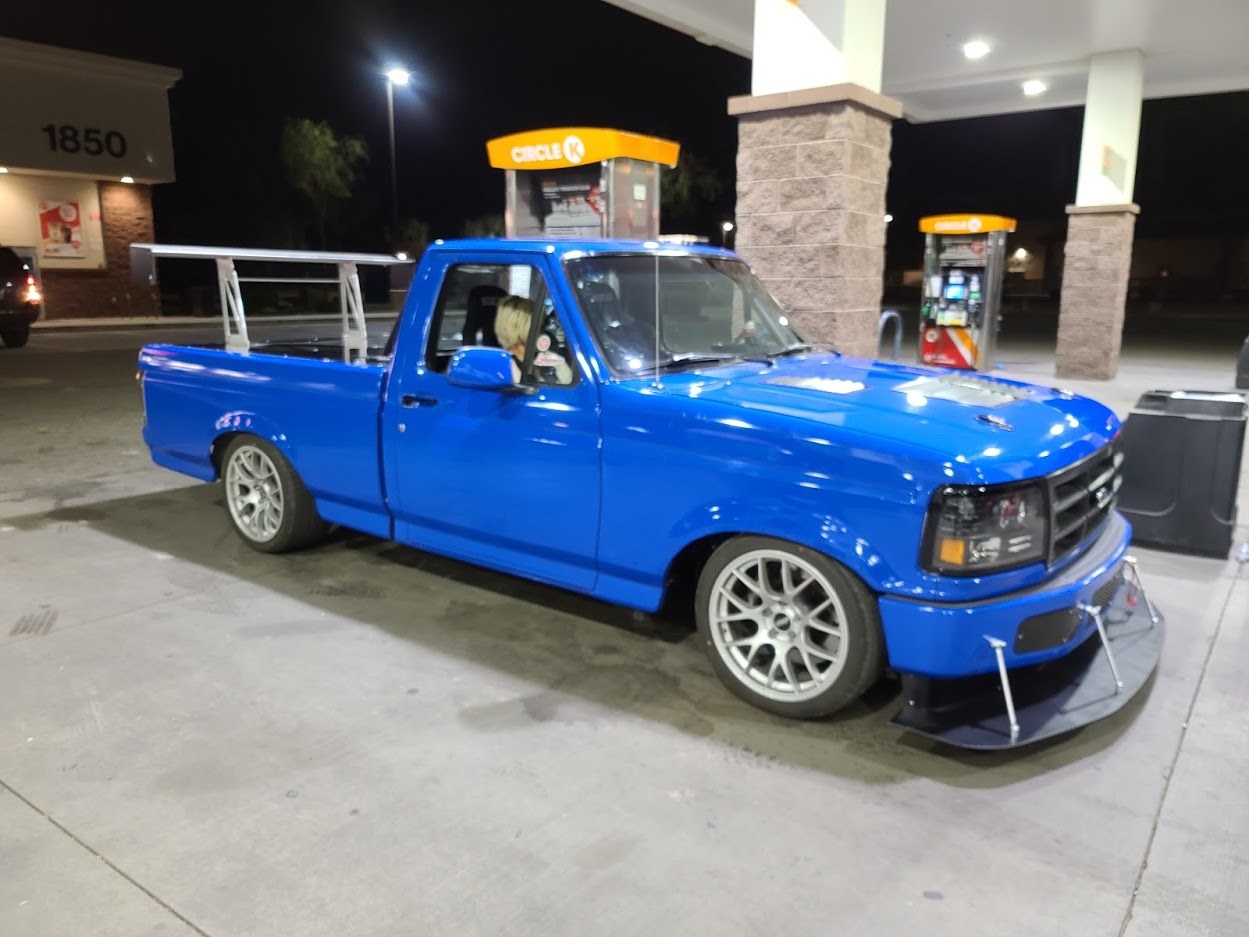

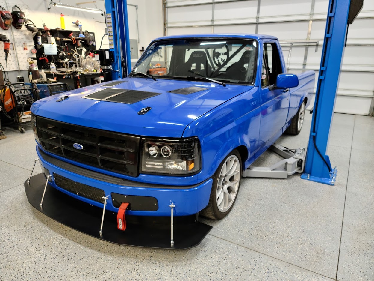

      Ever since I first started planning this truck I have had this vision of a full aero package. While I realize some of you might chuckle about that, I feel it will help a lot to stabilize this brick at speed and also provide that "look."
      With the wing mounted about the new bed cover, I finally was able to get the truck up on the lift and finish the install of my splitter that I designed a month ago. Between my right angle drill and the lift, I don't know if this would have been very easily done any other way.

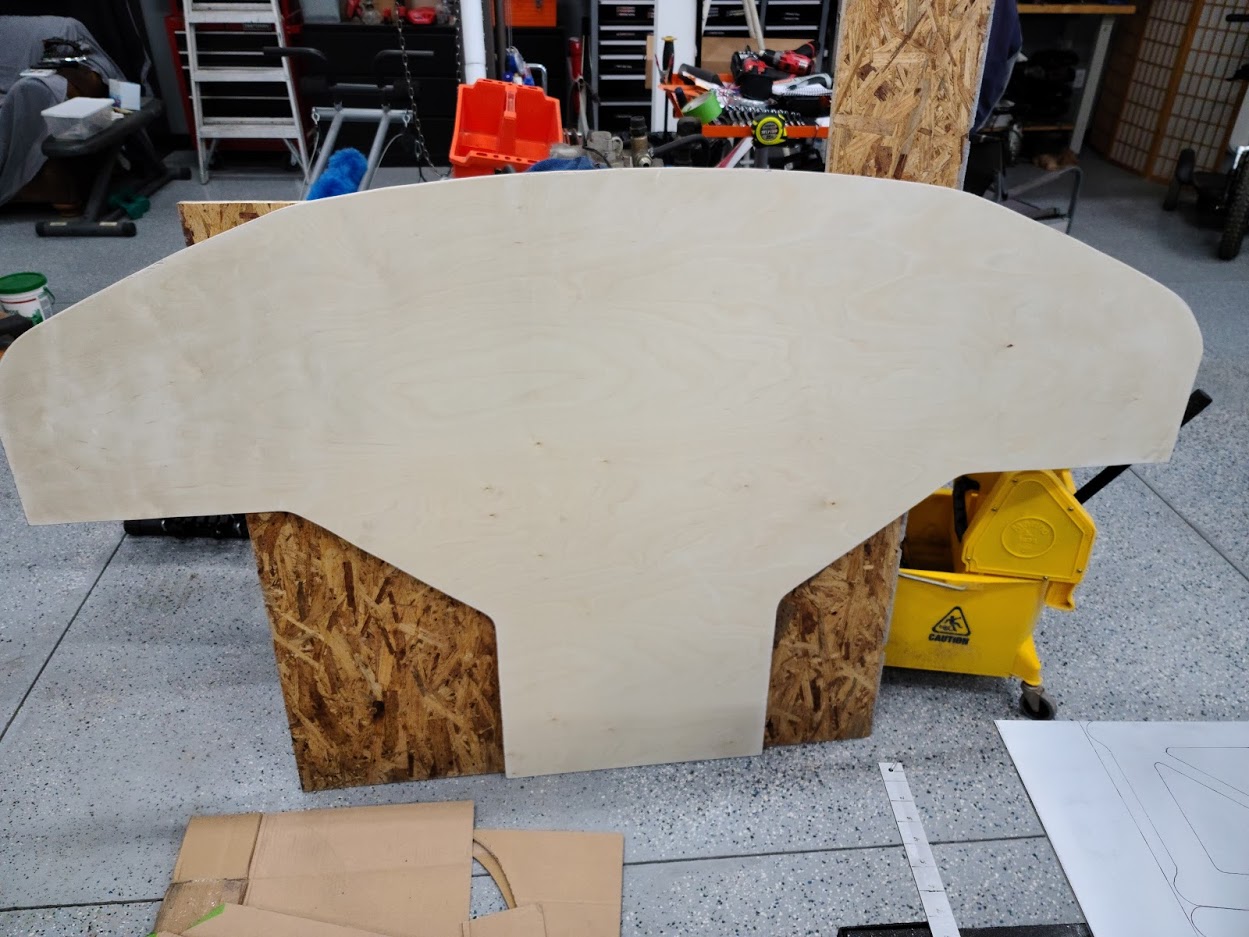

      I started by taping together a bunch of large pieces of cardboard I had laying around the shop from the many boxes I get. Using that, I slowly trimmed a shape that followed the bumper line +6 inches. I also wanted to have an integrated undertray to reach back under my suspension. That allowed me to transfer the shape to my 1/2" birch plywood and cut to shape.

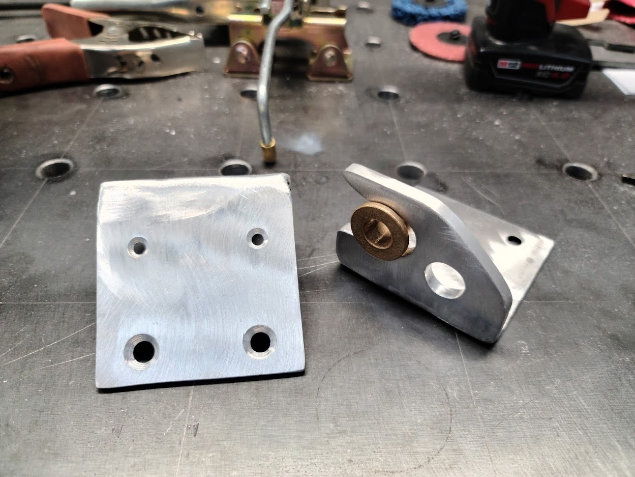

      I then wanted to design a tool-free quick release bracket system so trailering would be made much easier. After a few sketches I had my prototype.
      Those support the rear half under the engine. The bronze bushing is permanently bolted to the subframe and the aluminum brackets bolt to the splitter. Took me a little extra time to make by hand, but the result is exactly what I was looking for.
      I do also have a middle support that pins on just in front of the tire, but I can't get any photos under there that make sense to look at.

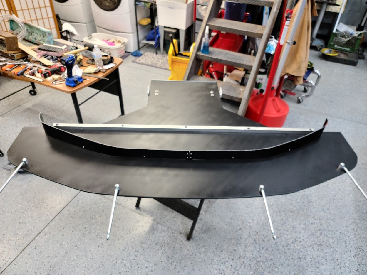

      Then needing a splitter wall, I tried bending a leftover piece of that ACP I used for the bed cover. Turns out it bends very nicely and I had enough leftover. I made the wall in 2 parts (left and right) so it was easier to cut and I only have to replace half if a cone or road debris attacks it. That is attached directly to the splitter itself to improve ground clearance when this is off the truck.
      I considered making my own splitter rods, but FTR (Fully Torqued Racing) makes nice parts and it just made more sense to order theirs. The only change I made is the upper part will eventually have a quick release pin to speed up install and removal.
      Then disassembly for a truck bed liner coating before bolting it all up with stainless hardware.
      The aluminum square tube is there purely for added rigidity and only added 1lb. This plywood does like to flex a bit on it's own.
      A quick test drive last night told me everything I need to know. It is not going anywhere under normal driving to 85mph (so far) and it barely clears speed bumps and most driveway entrances. Plus it looks awesome to me.

      I would too. I do have a local course and I'm evaluating a couple different sanctioning bodies to run on road courses during 2021. Absolutely expect me to do aero and non aero tests on the same day since I've made it all so easy to install/remove. I can tell you from being the one to drive this truck 1200 miles since it was built that you can feel the rear more firmly planted at over 100mph with no splitter, but the nose doesn't feel as stable. The entire truck feels much more planted and stable above 80mph with the whole package on the truck. I suspect it is working at slower speeds, but like any good areo, it needs speed to work best.
      You *might* be right about my plans.
      Quote Originally Posted by SSLance View Post
      We'll see on the 13th if they helped him get any closer to my times on an autocross course. :D
      That we will. With 65 days until the truck shootout, I'll be pushing the truck and myself to be super dialed asap. You get the honor of helping me corner weight and verify the alignment again too buddy!
      Quote Originally Posted by Vimes View Post
      I can't imagine the pucker factor when you drilled into that pristine front bumper. I think that if you want to get the full benefit of the splitter you're going to need side skirting and maybe skirting under the rear bumper, down to the same height from the ground as the splitter. Personally, I think it could be a bit smaller as well. Professional race car splitters aren't as big as that one. If you find the need to rebuild, I'd add an inch of height to help with speed bumps, and pull it back about 2 inches from the front.
      Honestly, it didn't even cross my mind to care about drilling the bumper. It just had to be done and I measured carefully. I think at this point I've cut and hacked so many expensive parts and panels on this truck that I'm kind of numb to that "fear." Now when I make a carbon front bumper...yeah that's gonna be nerve wracking as hell!
      You are totally right about skirting, but the benefits for what I'm currently doing are negligible without underbody work. There has been ideas tossed around for a flat bottom, but that comes with a host of other challenges that I'm really not ready to tackle at this time. If I went that route, skirting would be mandatory. I'd still like to do something anyway to just make the body lines more even along the bottom, but I haven't come up with a simple and clever way to pull it off...yet. Open to ideas if you have some.
      For splitter size, this is only 6" from the front body line. That is my smallest allowed splitter by any rules I would fall under currently. It looks gigantic in photos, but makes more visual sense in person. Wait until you see some of the optima GTT class trucks coming soon...they allow up to 10" from the front body line!
      Most "professional" race cars run smaller splitters because their rules don't allow more. I can assure you they would all go bigger if allowed. They also run their splitters nearly scraping the ground because that greatly increases the efficiency of the splitter. I can already JUST clear speed bumps so I would never run it higher than this because I'm already losing efficiency making it "street friendly." I might consider trimming it back if there is an aero imbalance, but with this big 71" wing on the rear, that's not likely to be the case. Plus more rear aero is about to be installed. Testing will tell me what needs to change with data. Right now we're all just guessing because I'm not aware of any trucks tackling aero for this type of racing.

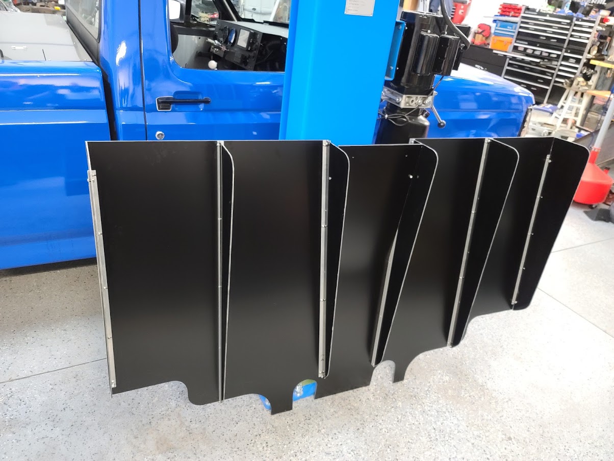

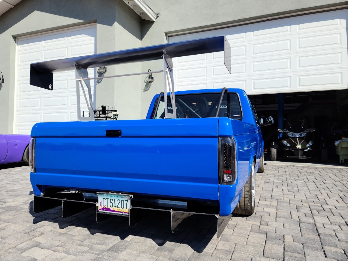

      I wanted to complete my aero package so that meant I needed to fab up a diffuser. Using my favorite new material, ACM, was the obvious choice. I'm now a dealer for this since the sign shops mark it up too much and make it a pain to even find.
      Reasonably light while being plenty rigid. Also made it all easy to replace knowing it will inevitably hit things.
      So now my aero vision for this truck is basically fully realized. I've wanted to do all of this since I started.

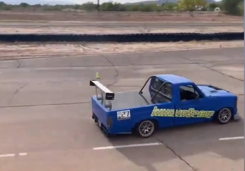

      Ok so the Truck Shootout West was in a word, Phenomenal!
      While there is still some important areas to address (mostly the "rules"), the overall idea is great and each event gets better.
      I came into the event hoping to maybe crack top 10 in any one single event to at least prove this truck was worthy of the hype I've pushed. This runs a similar format to optima. The required events are autocross, speed n stop, and a drivability cruise. There was also an optional road course which I paid and signed up for.
      First up was autocross.
      I only ran about half the runs of most other trucks since they opened the road course after 1pm, but I still put down a time good enough to lock in 10th out of 25 in class. So we were off to a great start of the little 275 BFGs.
      At the road course I really pushed myself and the truck.
      The photos might be terrible, but my times were not. I got down to a 67.8 lap time which stuck all the way through Sunday to hold down the 2nd fastest overall time for that event! Seriously, the only truck to beat me was a 2600lbs, 700hp, tube-chassis C10 that cost about 5x what I have in my truck on Michelin slicks. You can hate downforce all you want, but it WORKS. I even had the amazing chance for Billy Johnson (look up Billy Johnson Racing) to flog the truck and he nailed a 66.3 lap with no setup changes. His feedback was exceedingly positive about the suspension system I have engineered.

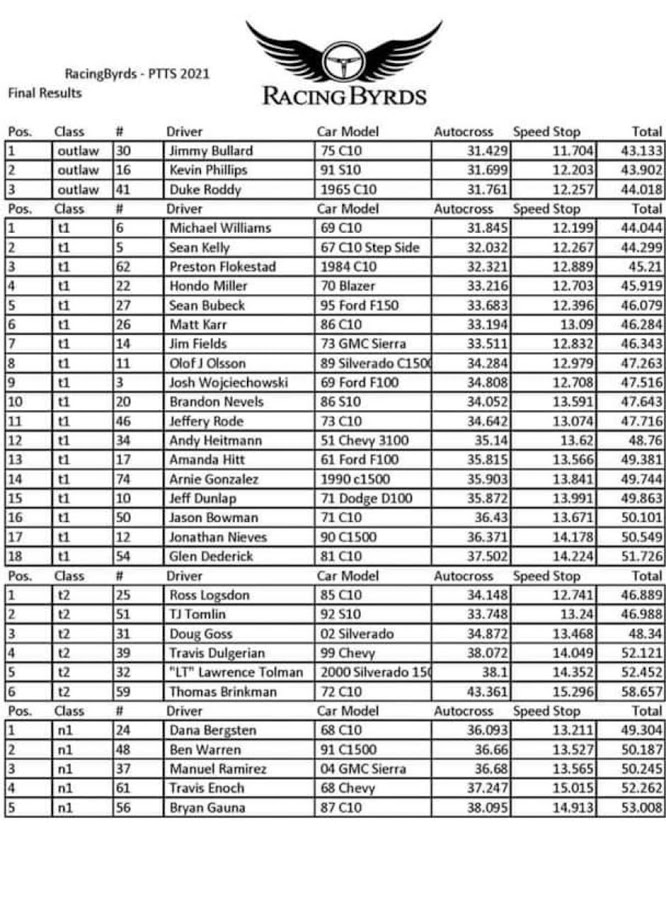

      So how did we finish overall? Well they combine your times from each day to get your overall total.
      I ended up 8th overall and 5th in class! This is way better than I anticipated and I feel very motivated to keep pushing the limits here.
