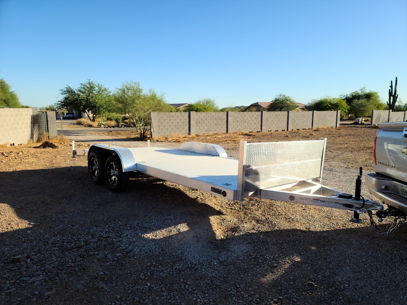

      Ok so with the Pro Touring Truck Shootout quickly approaching I needed a trailer to make the 1760 mile tow each way. Turns out aluminum trailers are hard to find in-stock right now and backorders are about 16 weeks, but luckily I found a local place with 2 left. Due to the limited tow capacity of my RV I had to go as light as possible.
      That meant I had the ability to now get there so the truck needed a few things to really be ready to compete. First up was the intake. When I first got it running I just shoved on a cone filter and moved onto other things. Well with the summer heat and now badass fan I needed to stop sucking in crazy hot air. So I made a quick CAI to help a bit.

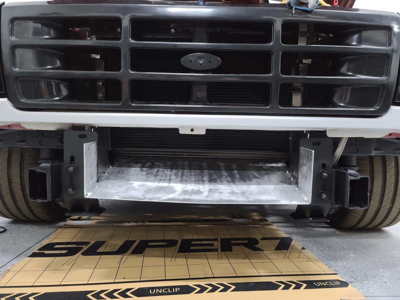

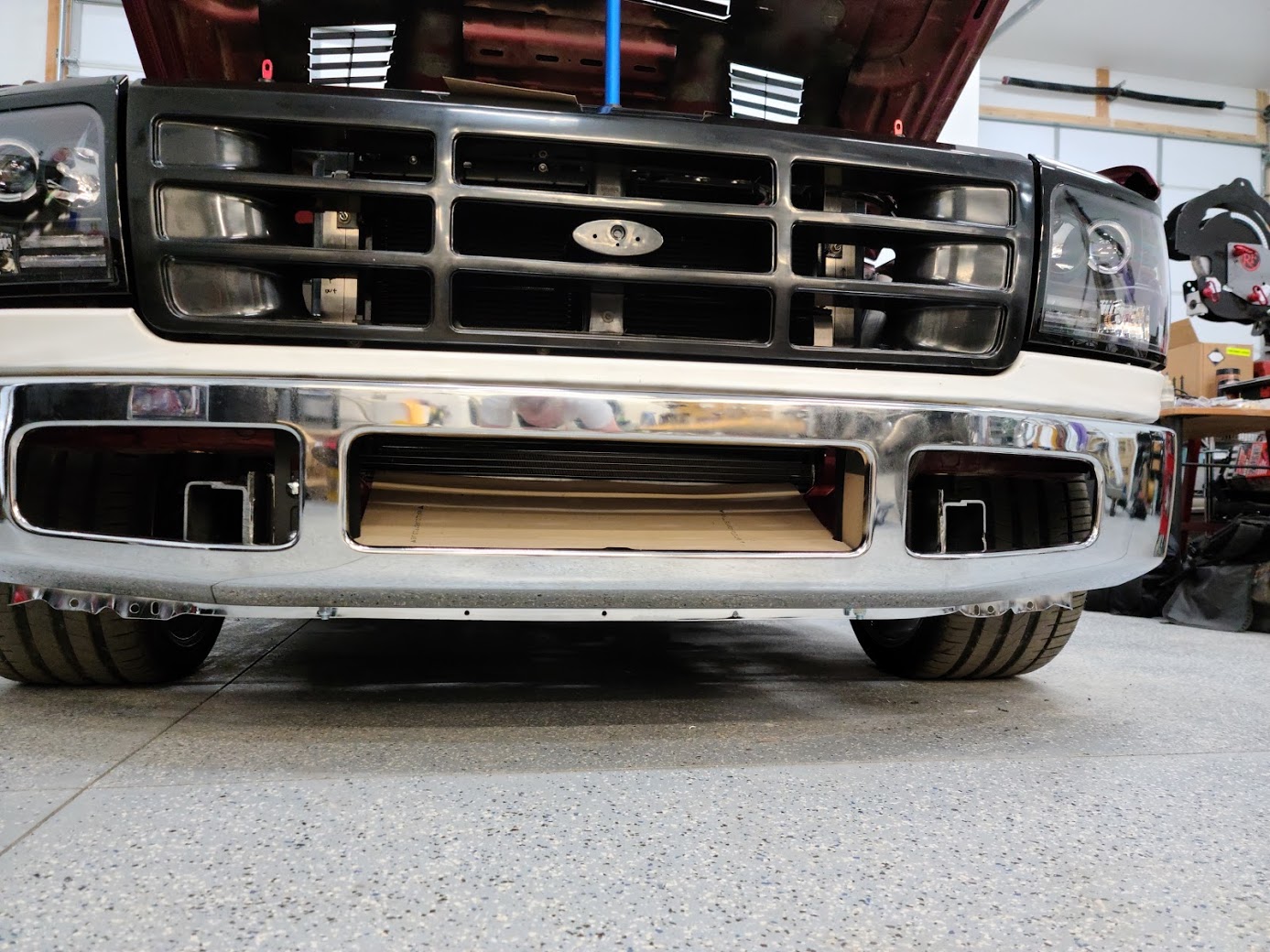

      Then I needed to tackle front air management. I believe with the position of the radiator and bumper that about 70% of the air coming through the bumper actually goes under truck since it will want to follow the path of least resistance. That should further assist everything working optimally at speed.
      So I started off with my favorite template material, Ram Board.
      After a couple long evenings of fitting and cutting I got the result I was looking for.

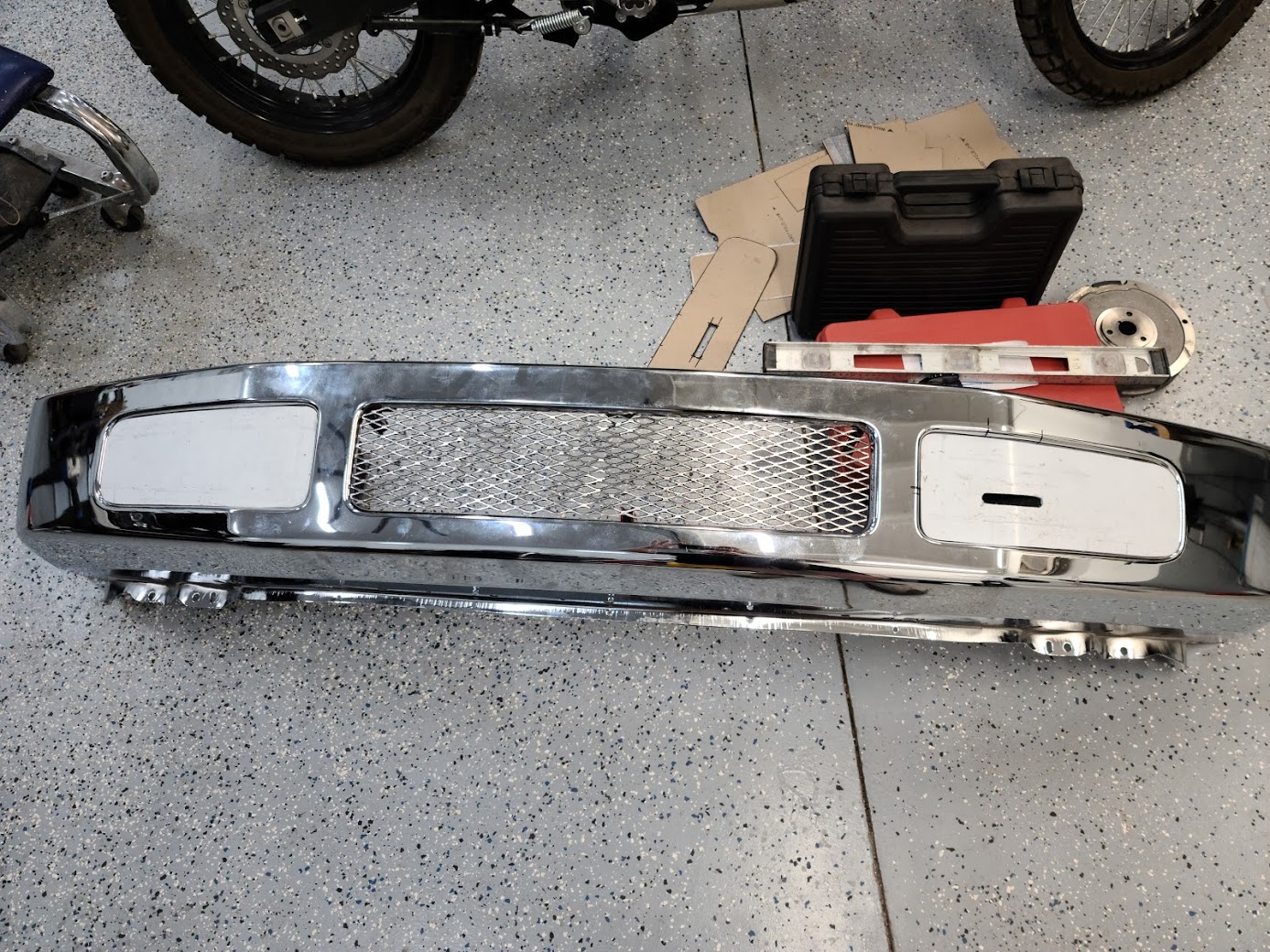

      Then that made me want to help reduce the potential for debris to take out my radiator so I decided it would be smart to just make covers for all the bumper openings.
      I think that is a massive improvement and only adds 3lbs. Win-win.

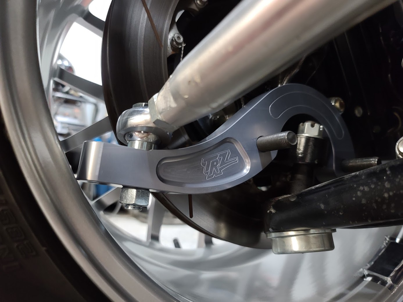

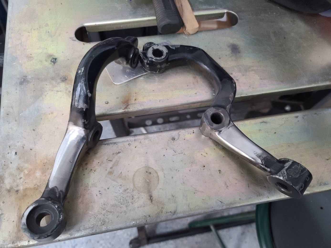

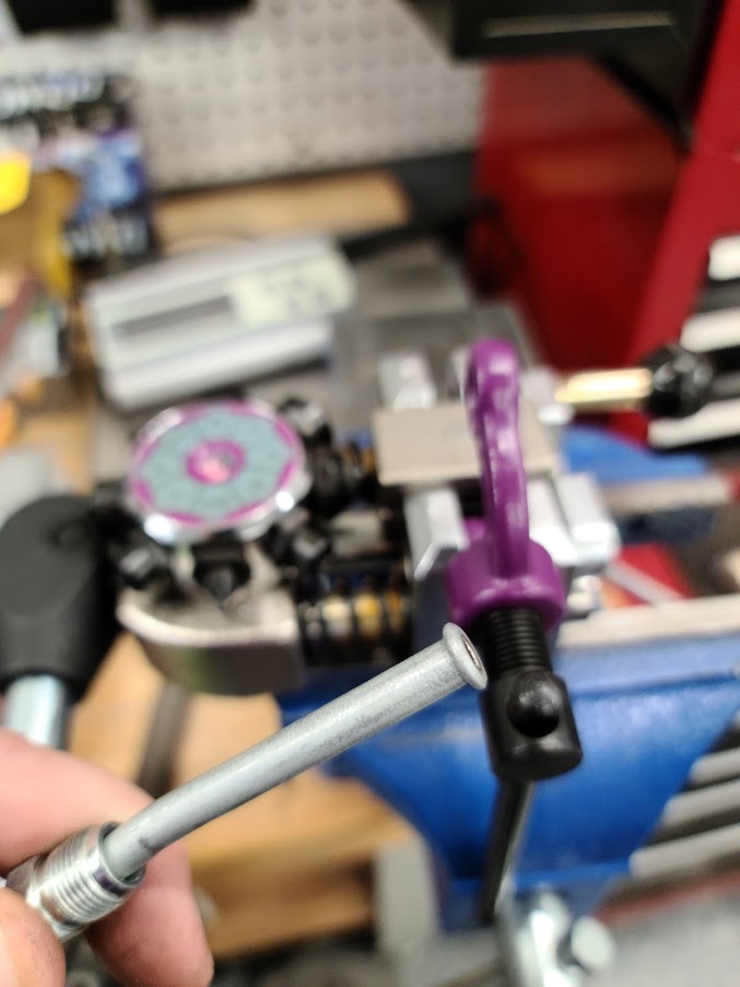

      While I had the truck down for these items the steering arms starting nagging at my brain again. Even though the modifications I made way back have worked pretty well, I still haven't had much Ackermann and the outer heims are maxed during full droop. Unfortunately the ONE guy that used to make correct front-steer arms stopped 6yrs ago and absolutely refuses to make them or send me CNC files even if I pay. So I decided I would order the TRZ arms and see if I could mill them down and create Ackermann since theirs have dead zero.
      Ah if only it were that easy. If you pay attention you can see it just kisses the barrel of my 18" wheels. So I started to cut them shorter and make it work, but spending $200 to them modify them when I could modify my steel arms for free got the better of me.
      So this past Saturday my friend Tanner came by and helped A LOT with correcting the Camaro arms. Remember, these are the ridetech tall spindles. Looking back, there was probably better options, but they are all significantly more expensive. Now I definitely have Ackermann and it all clears with some room to spare. And yes, we were very careful when welding these. they are forged steel and I beveled 70% of the thickness before we welded them together. Tanner actually welded, ground down the weld about 1/3 of the way and made another pass. Then we let them very slowly cool. My mind will blow if these don't hold up.
      Just to show that there was no porosity or anything like that, here are the arms just after I 120 grit flapper-wheeled them clean. I did not reduce the size of the arm at all, only ground the surface of the weld flush, just like before.

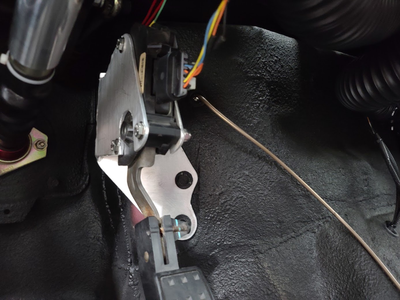

      Finally for this update, I got the DBW (drive by wire) conversion done. Andrew talked me into this about 3 months ago, but I've never taken the time to make a bracket and run the wiring. Took an afternoon to do, but I made the GM pedal bolt to the factory spot nice and rigid.
      I will admit it's a little closer to the brake pedal than I intended, but it works well and heel-toe is stupid easy. Andrew worked his magic for idle and ramping. Seriously...if you run Holley EFI, hiring Andrew is VERY worth it. This truck starts, runs, and drives as good as any modern vehicle. Only I now have 520 gas guzzling horsepower on tap with room to grow.

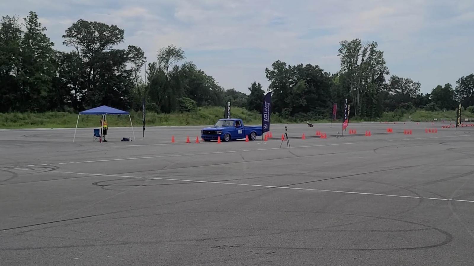

      Wow what a weekend and really what a trip overall! I would say that Arnie and the crew did a kickass job putting on the Protouring Truck Shootout. Everyone, including me, is already planning on attending the next one when it is announced later on. Seriously, if you like grassroots motorsport events and seeing cool old trucks getting beat on, this is a MUST attend event.
      Ok so for how the truck did. In a word, impressive! Remember, this was the first real competitive beating the truck has had (thanks Covid). It didn't miss a beat all weekend. I think the biggest thanks has to go out to Andrew. His tuning brilliance on Holley EFI systems has this motor happy as can be. I saw the 6600 rpm rev limiter a couple times and absolutely used every bit of RPM I had all weekend. Sure, Duffee Motorsports built a solid motor, but you can kill anything with bad tuning and this little Ford just ate. And even in this VERY safe tune provided this truck was viciously fast....when I had traction.
      Attachment 178538
      While I didn't place like I would have on Saturday, I dropped 13.3 seconds over 7 laps for a best of 47.1 seconds while my class average was about 45 seconds. The FTD that day was Rob Mcgregor (No Limit Engineering) in Hellboy with a 40.1 second lap. On Sunday I struggled to nail my braking zone for the Speed N Stop and only got a best of 18.8 seconds while FTD was 15.3 seconds. But I don't look at this as bad at all. On my first time in such an experimental build I was seeing huge reductions in time and I was learning the limits of both myself and the hardware.

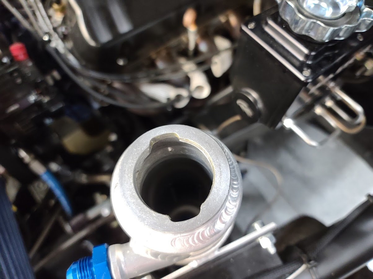

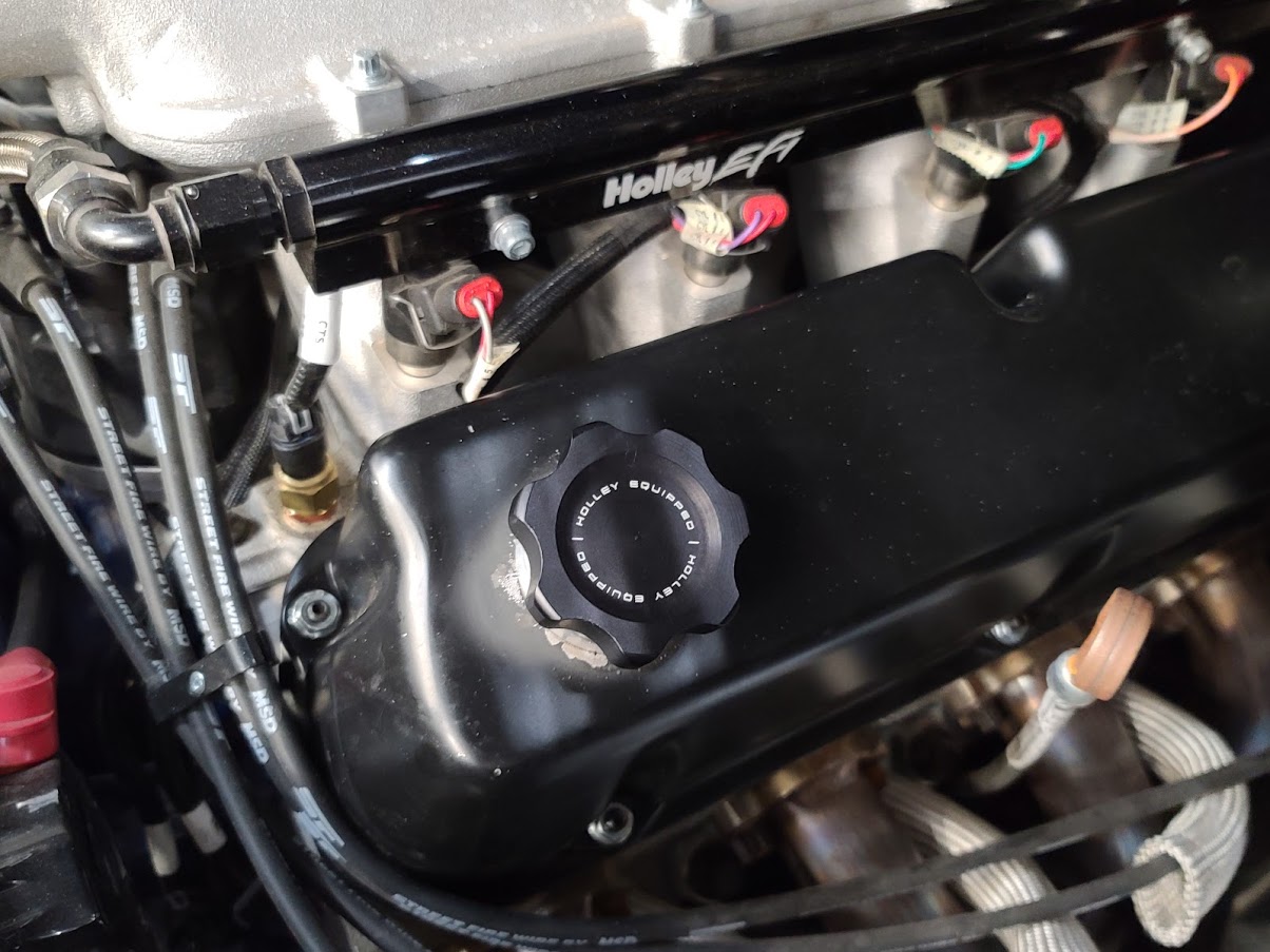

      I have really enjoyed following your build! You've done a great job of tackling issues one at a time with perseverance! It looks like you were in the minority with a Ford at the event. At least the pictures had a lot more GM vehicles in it. It sounds like your truck has a lot of potential after some tweaking of the setup.

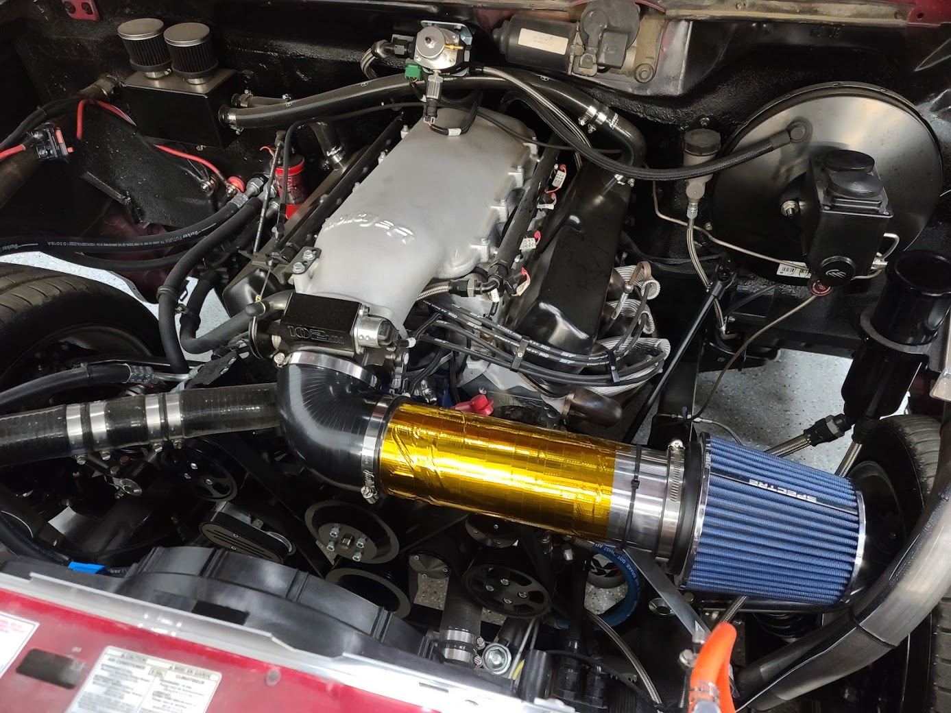

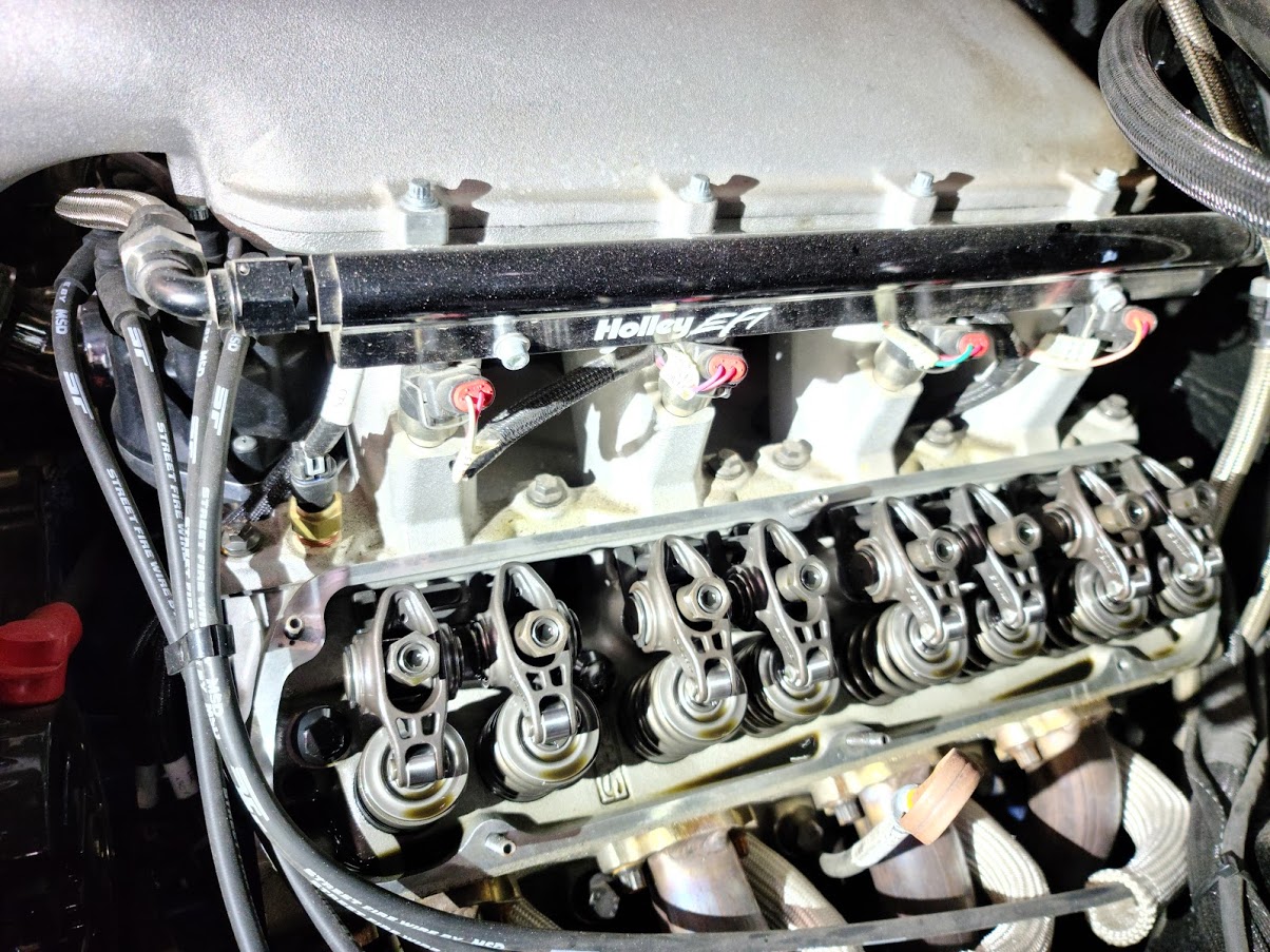

      I see you went with DBW. In your CAI picture I still see the cable throttle body. What DBW throttle body did you switch to?
      Thanks! Definitely was the minority at the event. I believe I was one of only 3 fords out of about 50 trucks competing. And all the Ford guys knew exactly who I was. Haha.
      I didn't event realize I hadn't shown the engine bay since the DBW stuff was installed. I am using the LS2 throttle body since it matches the largest OEM TB GM ever used on the LS family of engines. Nice budget option at only $100 ish brand new. The Holley EFI system already has the part number listed in the drop down as well making things easier. And for the record, I wish I had done DBW from the beginning. So much better.

      Well looks like I got a little distracted and a bit behind on my event recap.
      Name:  2020-09-20 Autocross_7.jpg
      Overall the truck took 12 runs of abuse and didn't really complain until it was time to load on the trailer.
      Name:  2020-09-20 Autocross_9.jpg
      Unfortunately I never got around to ordering springs until today so I wasn't able to test that change out. AMP is an interesting pad to run since it does have a decent amount of marbles and a few spots that unload the car which I didn't learn well enough early on. Definitely requires excellent throttle control. That being said, it reminds me of running at the Mineral Wells, TX airport with the BMW CCA and that was always a blast.
      We had to deal with some unusual restrictions which included a mask on anytime you are out of your vehicle and limiting the attendance to 50 in the morning and 50 in the afternoon. While this allowed a rapid event with each driver getting 6 runs, it totally eliminates the social aspect of the event that I know myself and most others enjoy. But hey, we got to do some racing so that's the upside.
      I managed a best of 49.98, but my CAM-T class leader was a low 45. So I have a long way to go to get where I want to be. Luckily there is another event coming up on the 17th where I should have the new parts installed and we can see if that helps. Some people noted that I still seem a bit timid with this thing so I guess I'll have to push harder.

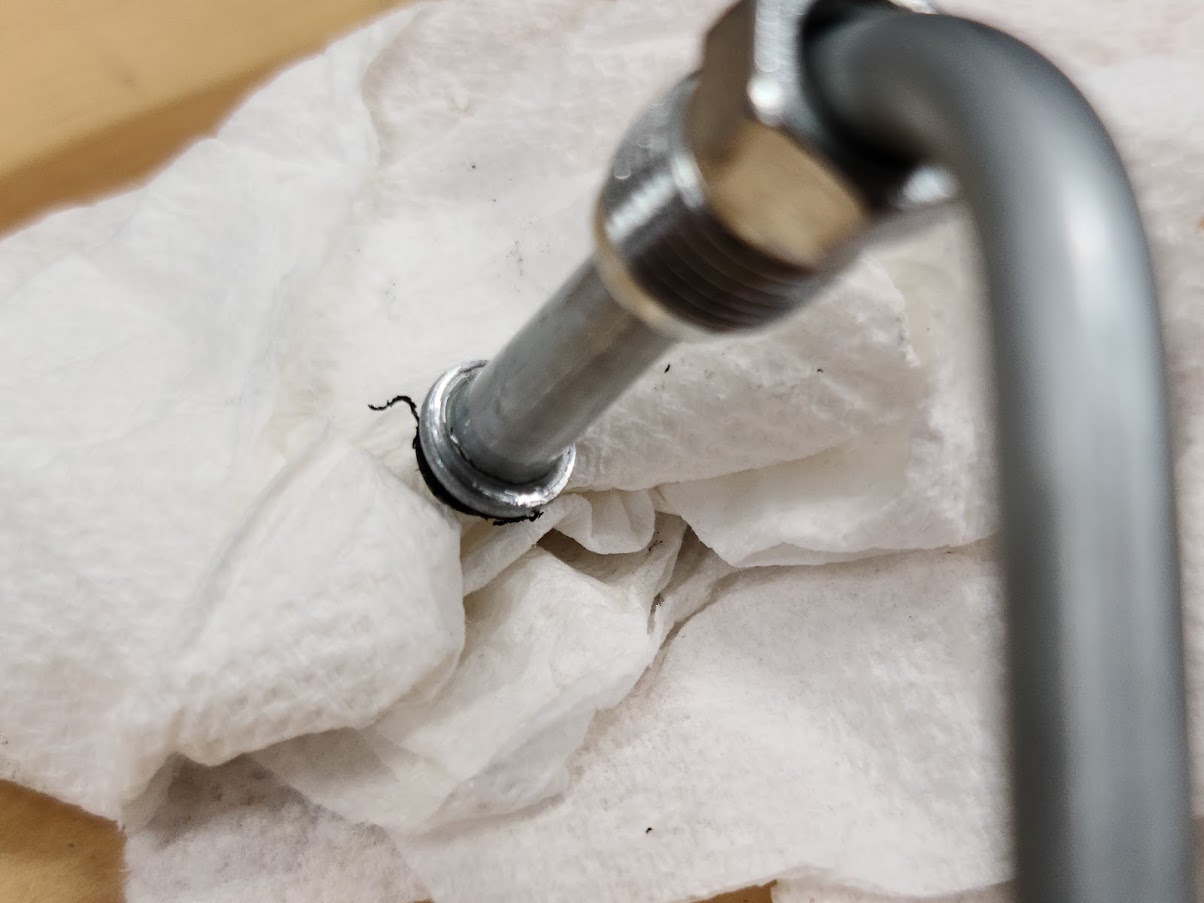

      The inevitable finally happened. I had a part fail that made the truck undrivable.
      It's kinda hard to see, but there is a little black line right at the flare which is actually a hairline crack. Turns out this POURS power steering fluid when you have 1000 psi of pressure going through the rack...imagine that. I originally thought it was just the o-ring, but obviously that was wishful thinking.

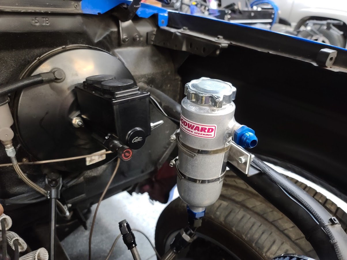

      So for over a week after the event I searched all over for those stupid hardlines that allows the rack to be powered. Turns out mine is a really strange size and I had zero luck. For the record these are called Hydraulic Fluid Transfer Lines. Not all manufacturers make replacements. So in a single act of desparation I got out my flare tool and used the wrong dies to make the right flare. TA DA!!! Whew...glad that's over.
      So what would cause this? I think my power steering fluid reservoir, that came with my serpentine kit, has always frothed the fluid resulting in air bubbles. The pump has always made that classic whining noise so I believe that stressed the flare at it's weakest point from the constant pressure fluctuations. Recently I've come to love Swirl Pots so I went looking and stumbled onto the fact that Woodward makes one themselves. Well I love my Woodward steering column so it was easy to trust their engineering again.
      The saddle mount was something I had to make. You can buy theirs very similar to this, but i would have needed to modify it anyway. Plus I still needs lots of AL welding practice. It's a SUPER nice piece and seems to be working flawlessly. Comes with the AN fittings installed so you just plumb it and filler er up. If you look close there is an inner and outer layer with a screen in between so the returning fluid has ample time to settle before being drawn back down into the pump. It's always far quieter than before and the steering feels much better too. Another win in the books.

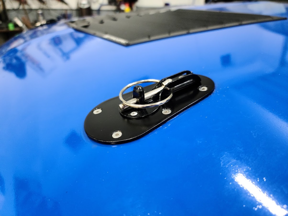

      Next up was to address my failed AeroCatch hood latch system. I know, I know, everyone else seems to love them. I just haven't had a good experience at all. Mine have constantly bound up needing a little wiggling at best before finally having the internal slider just break. Maybe the intense UV from the sun broke down the plastic extra fast? Who knows, but I needed something better so I could more easily use my hood. Especially when making shock changes since that's the easiest way to reach the front clickers. I decided that an all metal solution would suit me best here.
      Noticed this style of pin on some rally cars and knew I had to have it. Keeps the pin captured so you can't lose it, but makes it super easy to use and is made of aluminum with a stainless steel pin. The black plate underneath was how I covered the hole left by the AeroCatches and so far it seems to be exactly the solution I hoped it would. I can now open the hood in about 5 seconds taking my sweet time.
      Final steps was to swap spring rates, do a valve check, weld on a real oil fill cap, and do an oil change. As of this maintenance the truck had exactly 500 miles on the odometer. Definitely wish that number was higher, but this year has been exceptionally busy for me and I do have multiple other toys to add miles on as well.
      Every single valve was dead on spec per my engine builder's instructions. Nothing looks like it's wearing funny and this really has been a quiet motor for being solid roller. VERY happy!

      Long overdue oil fill cap. Found these with the threaded bung and it's exactly what I was looking for. Now oil changes are less of a pain (been filling through the breather at the back of the valve cover).
