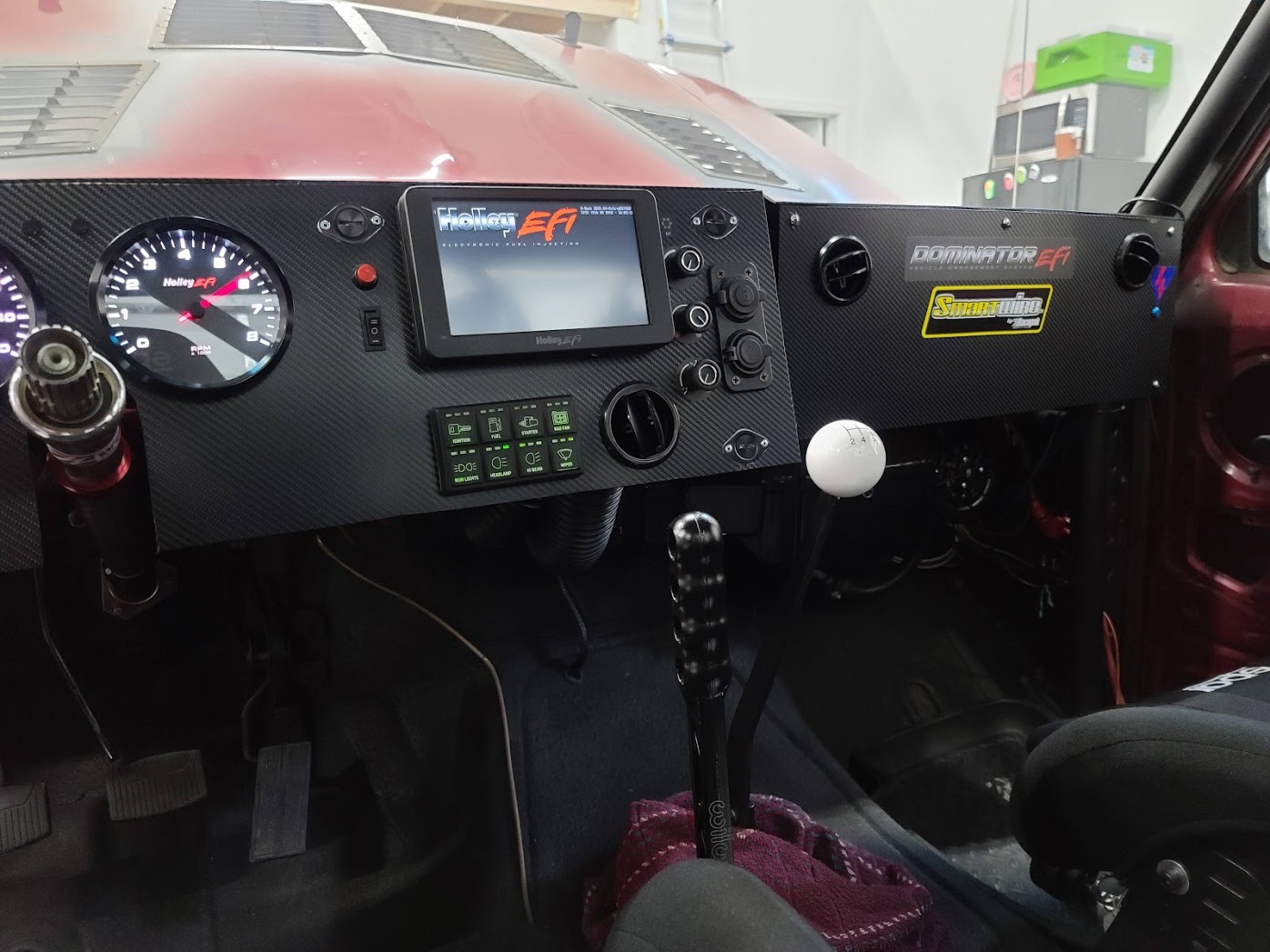

      Quick update,
      I got the Vintage Air AC charged and blowing cold. Honestly, I'm super impressed with all their documentation an the overall ease of installation. It is kinda weird to me now that I'm sitting in basically a racetruck with the windows up and cold air blowing. I could totally get used to this. The main area I deviated from the normal wiring on was passing compressor control through my Smartwire so the CANbus is signaling when the shutdown is, just like a modern production vehicle. I continue to be very impressed with how well the Smartwire can integrate into a build, streamlining the wiring.
      So with all that I need to run the ducts on the passenger side which prompted me to just finish that dash plate all together. Here is a cool startup pic for those that haven't seen it on social media.
      It's basic and only includes what I need. Which is exactly what I was going for.
      Now I need to seal up a couple areas from leaking in hot air while driving and complete the windshield wiper/washer wiring and that will mean wiring is 100% done! Wait...not true. Andrew talked me into doing DBW, but that is plug 'n' play. More on that fun later.

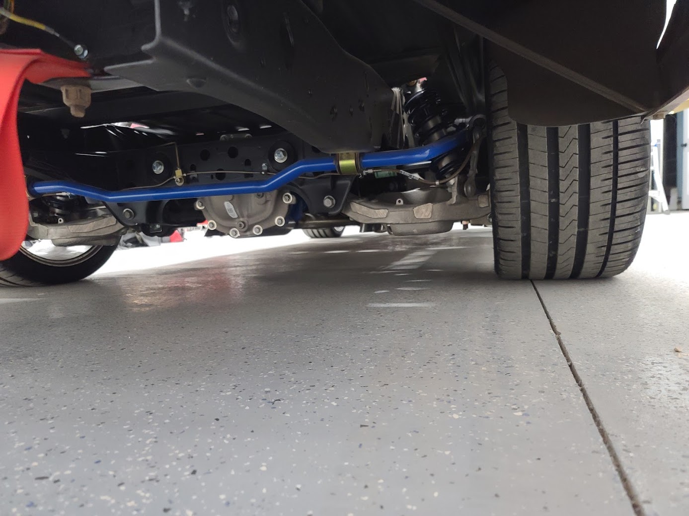

      Ok a few things going on. First up, TIRES!! I have needed tires since I bought these Roush 18x10 wheels over a year ago, but never took the time to do it. The BFGs that were already mounted held air great, but were 12 years old and had seen some time in the brutal AZ sun so they were rock hard. While this allowed for entertaining wheel spin on command it doesn't really help anything when you're trying to make a truck handle like a sports car. So to get me by I found a great deal on some Falken Azenis tires in a 285/35/18.
      Side note: this is still one of my favorite views of the truck. I love seeing that IRS in there with fresh paint and all the billet upgrades. No regrets on doing the work, which wasn't even that bad.
      Once I purchase real 18x11 wheels in the correct offset for my setup I will move to a 315 BFG Rival. Already the truck is a different animal being able to hook in 2nd gear when it just spun like crazy before. I'm looking for some local events asap to see how these do. The Pro Touring Truck Shootout is also still on my agenda in 1 month (YIKES!) but I'm watching carefully due to a number of guys having already pulled out.

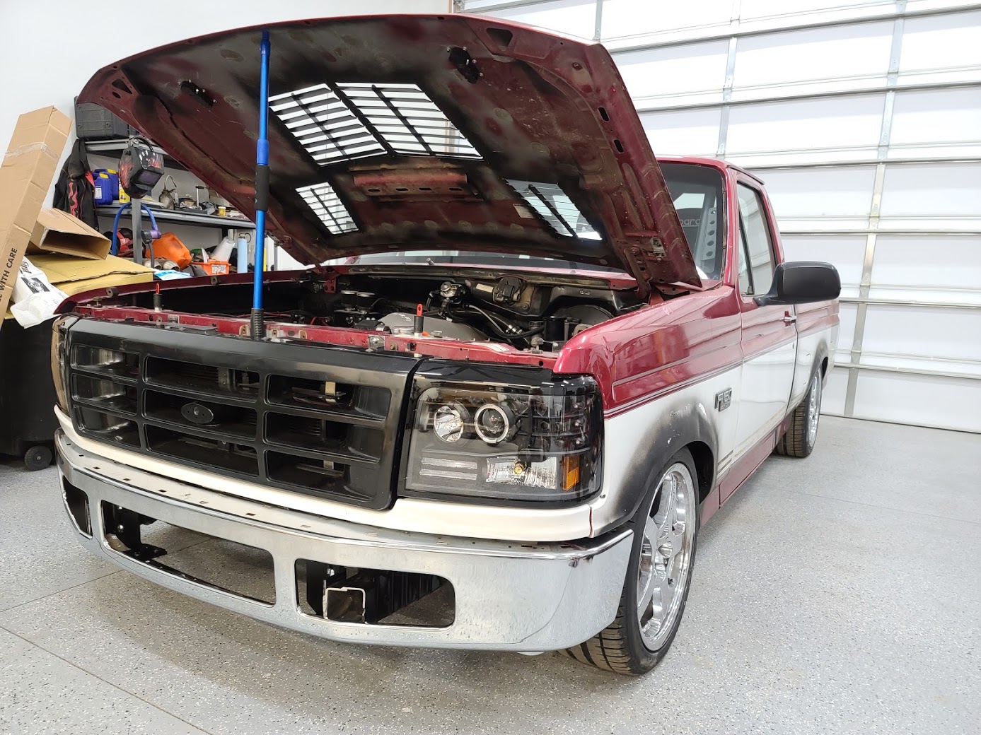

      Somehow I forgot to share with you all that I finally got a bumper too! What a mess it has been to avoid the 70lbs beast that was originally on these trucks. This is known as the 6.4 swap due to the bumper being from the 2008-10 F250. Not hard at all to install and seriously looks right at home on this old truck. Don't worry, it will get the big openings closed/ducted along with some trim to actually look right. I'm just excited that it looks like a complete truck now.

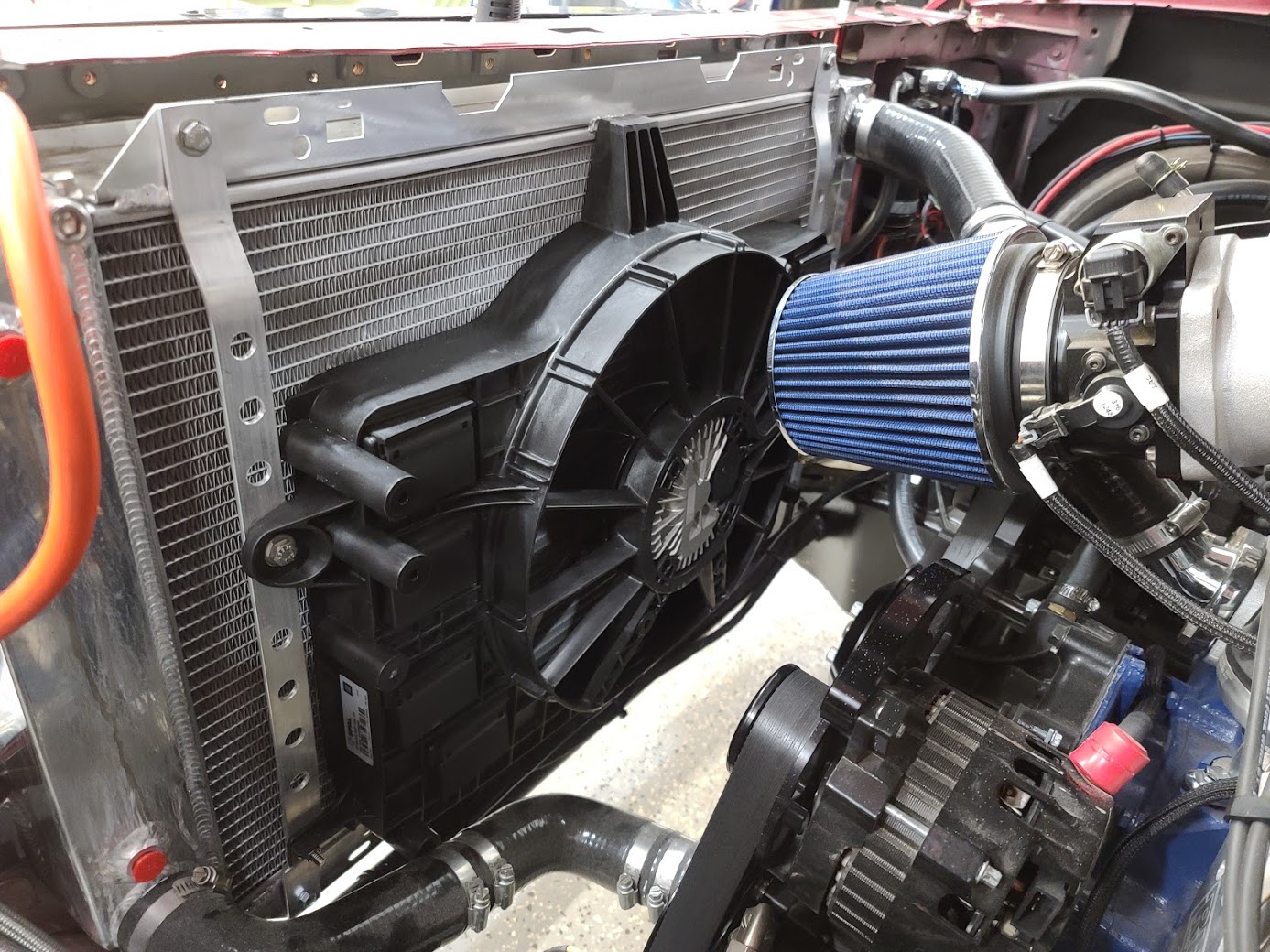

      Then back to the cooling struggles I've had at low speed. Andrew suggested a real pwm fan setup and specifically the C7 Corvette because the controller is integrated and it's a genuine Spal fan for under $300. Hard to argue with that when we know my dual 11" no-name fans and enclosed aluminum shroud are not doing the job. I've wanted to leverage the PWM capabilities of the Holley EFI since I installed it anyway. Win-win.
      Yes I'm well aware that this does not cover the entire core. It doesn't in the Corvette it was designed for either. Even I had to be reminded that this fan has been successfully cooling 700-800hp supercharged C7s for years in traffic with AC (heat soak for days). I imagine it will do well for my little 520hp small block. Just look at that 8ga wiring to power the 500w this thing demands at full rip! If we still see the need for more cooling under 30mph the next step is the 850w CTS-V fan that is nearly the same size radiator core. After we test this evening I'll go beat on the truck tomorrow and see how it does before reporting back.

      My hat is off to Andrew. He knocked it out of the park on this one! Yesterday afternoon we jumped online together and he was able to program the new fan while I made sure everything was wired correctly and ready to test. After we walked through some manual tests that went very well, I fired up the truck and brought it up to operating temperature. Then I turned on the AC to about 60% fan speed and just let the truck idle in about 105 degree heat. Previously the little fans I had would quickly become a problem allowing the water temps to sail past 220 if I let it, but this time it was an entirely different story. The new fan never went past 60% speed and easily held the water temps from 185 to 189. It's that smooth at controlling temps! My mind is blown and I'm excited to drive this truck again without stressing every time I have to slow down.
      I really can't say enough good things about working with Andrew throughout this project and I would HIGHLY recommend his services if you have a Holley EFI system.
