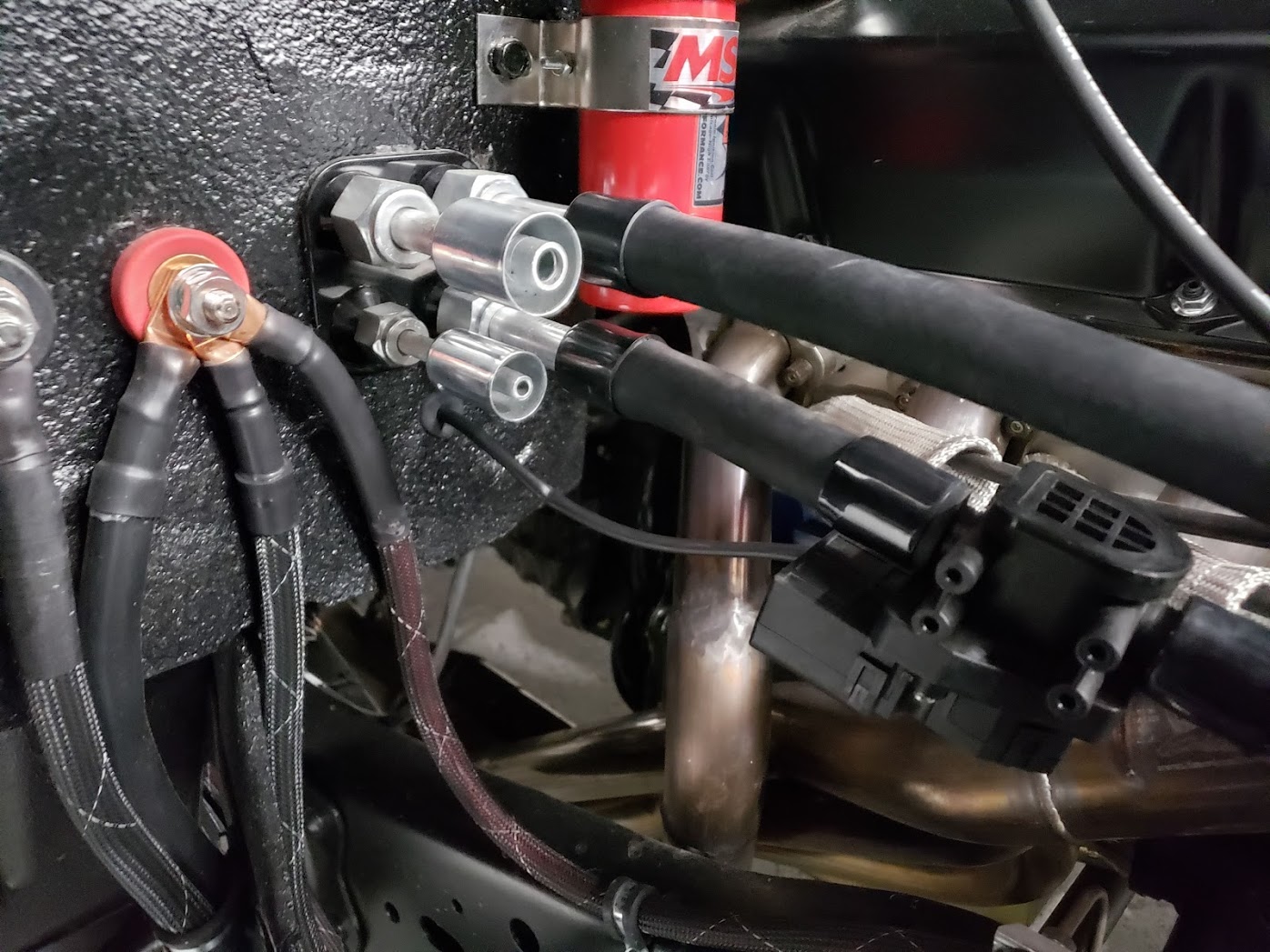

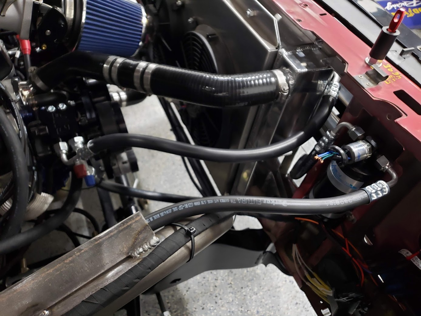

      I think we can agree more than anything else, the slow down of deliveries right now SUCKS! My Gates Powergrip hose clamps finally arrived after UPS delaying delivery 3x and I got them installed last night. I really must thank Jesse at Level 7 Motorsports for this one. He was telling me way back when I first did the cooling system that it had too many connections and to use these clamps. Thanks to my hardheadedness we are now to that point.
      From this mess:
      To this streamlined layout:
      Less connections and a cleaner engine bay always make me happier.

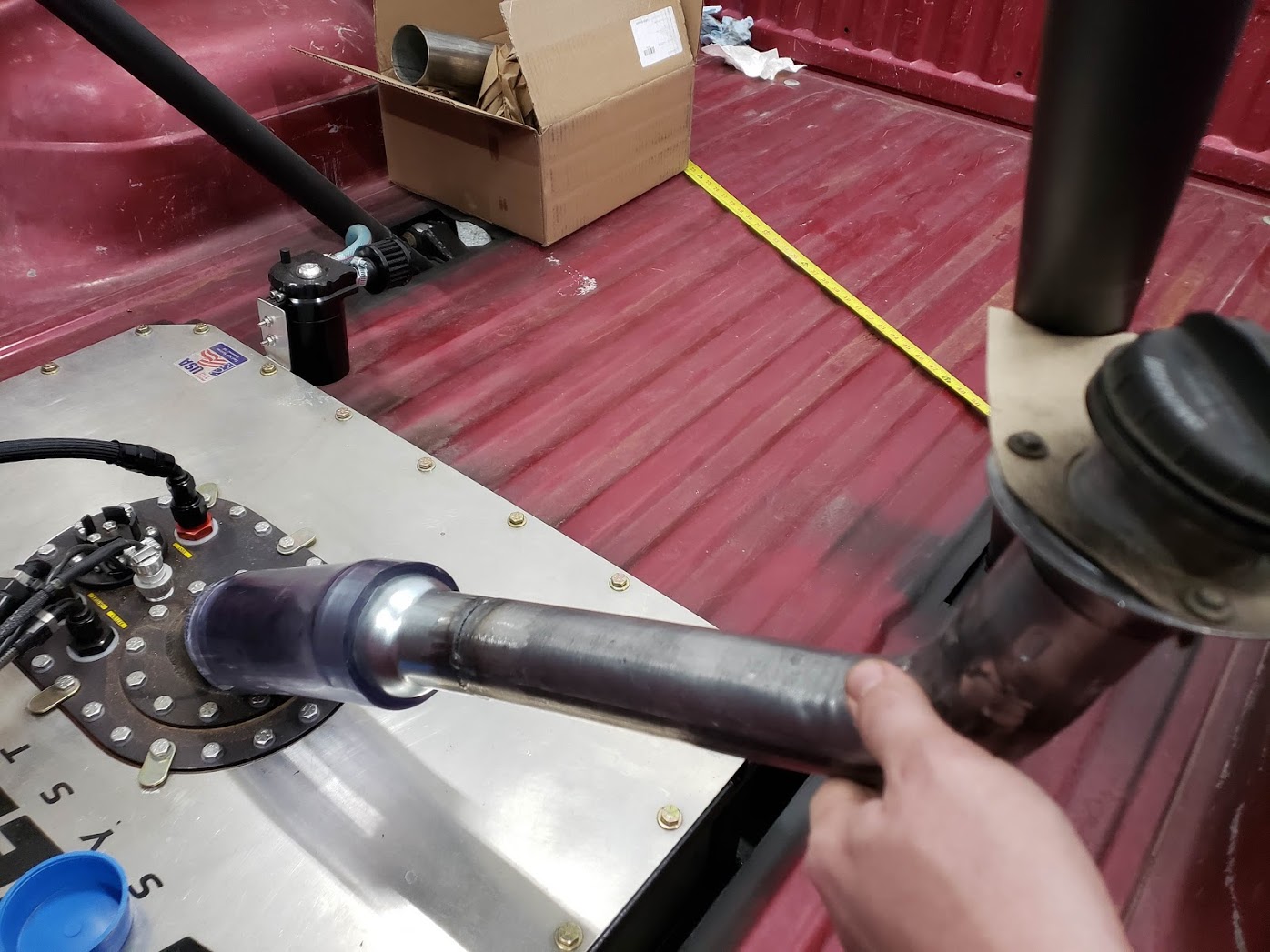

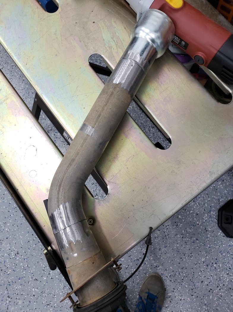

      Now the other pressing matter is wrapping up the real fuel cell filler solution. This never got done purely out of laziness and then getting busy with the whole move. I've very happy to finally be about done with this task. After finding fuel fillers to be excessively expensive I settled on modifying one of the 2 original fillers from the truck. The fuel cell came with a 2.5" inlet neck and the Ford fillers were right at 2" in diameter. My simple solution was to cut and weld the bend of the stock filler 180 degrees from where it came and then add a steel 2 to 2.5" exhaust reducer to the end so they would match. Then a short piece of the special fuel filler hose and boom...done.
      As always I used Ram Board for the template material. I'll cut it out of plate tonight and weld it to the cage bar so I can lock everything down. Some black paint and it will look mint.
      Not the prettiest but very functional. So it definitely matches the rest of the truck. The idea being that this will end up hidden under the eventual bed cover with just the cap sticking up for easy access.

      What is the valve in the lower heater hose from? Is it electrical or vacuum?
      The "after" looks way better!

      That valve is the heater control valve supplied by Vintage Air. Admittedly I'm not thrilled with the way this integrates, but it does keep it universal.

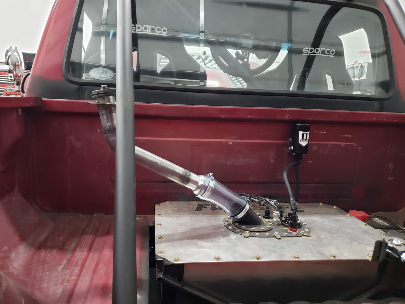

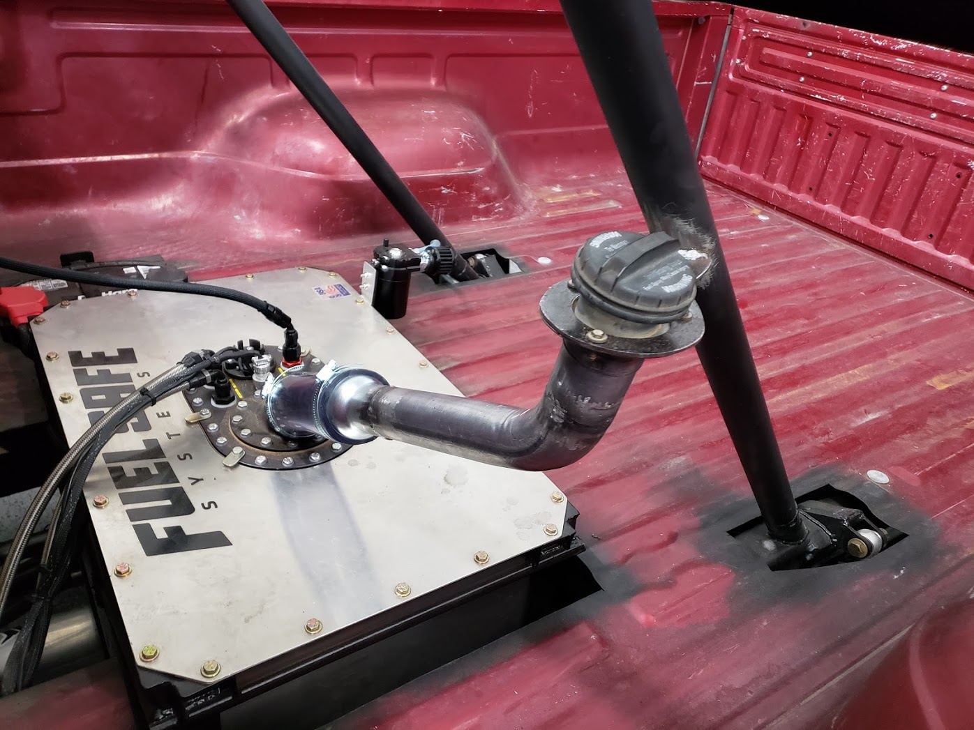

      First up was finishing the fuel filler I made. I made up a quick bracket on my new drill press and welded that to the driver's side rear down bar. The neck is removable with the 3 original bolts just like when it was inside the fender. It all still needs to be painted, but it fits well and I suspect it will work perfectly. Best part about it is this whole thing cost about $50 to make which is way less than any other filler I found.

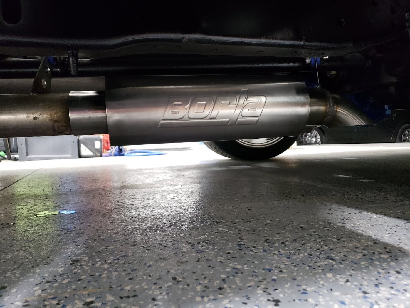

      Then onto the mufflers. Now I personally like it fairly loud, but most people don't. In the interest of not attracting too much negative attention and hopefully avoiding most track decibel thresholds I bought these Borla mufflers. They are pretty light for a stainless muffler and kill a lot of sound while leaving that nice bark you expect at WOT.
      For now they will just be slipped on like you see. I want to come up with a simple way of swapping mufflers without much hassle depending on my mood or the requirements of where I'm running. The crap on the tube is from another muffler, not these leaking.

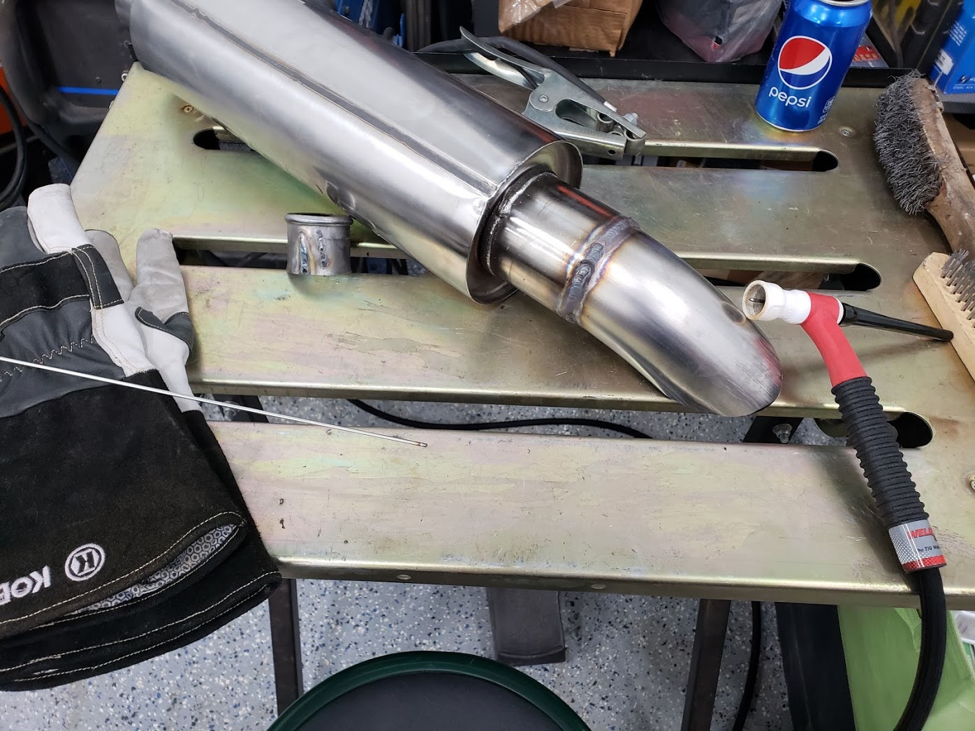

      The turn downs I made myself out of some 45 degree bends. I bought a new gas lens setup to try and get better results out of TIG welding. It definitely helped more than I expected, but I'm also running way too hot. It's a bad habit of mine when TIG welding. To be fair, for about the last 10 years I rarely pick up a TIG torch so I'm seriously rusty. Some practice will go a long way, as with anything.
      So there you go internet, my welds for you to all complain about. Haha

      Our window tinter just got a new Tundra. He went with Borla mufflers on it, and said they were quieter than stock under normal loads, but still sounded good when you gave it some pedal. Sounds like you found about the same.
      When I'm driving down the freeway, I'd like it to be as quiet as possible, but when I get on it, I'd like people to look to see where the sound is coming from. lol

      Part of it is this motor, I believe. Some engines just seem to be louder than others for any number of reasons. A decent muffler seems to knock this thing right down. For your purposes I have to recommend the Flowmaster Hushpower. Every engine I have used them with has had the exact sound behavior you just mentioned. But these Borlas appear to be about the same at a slighly lower price. I'm going for a short drive this evening so that will help me have a better idea.

      Well a short 12 minute cruise is all I had time for. I can say that these are very mellow when holding steady cruising speeds and have a nice smooth roar at WOT. Definitely not super obnoxious under any condition.

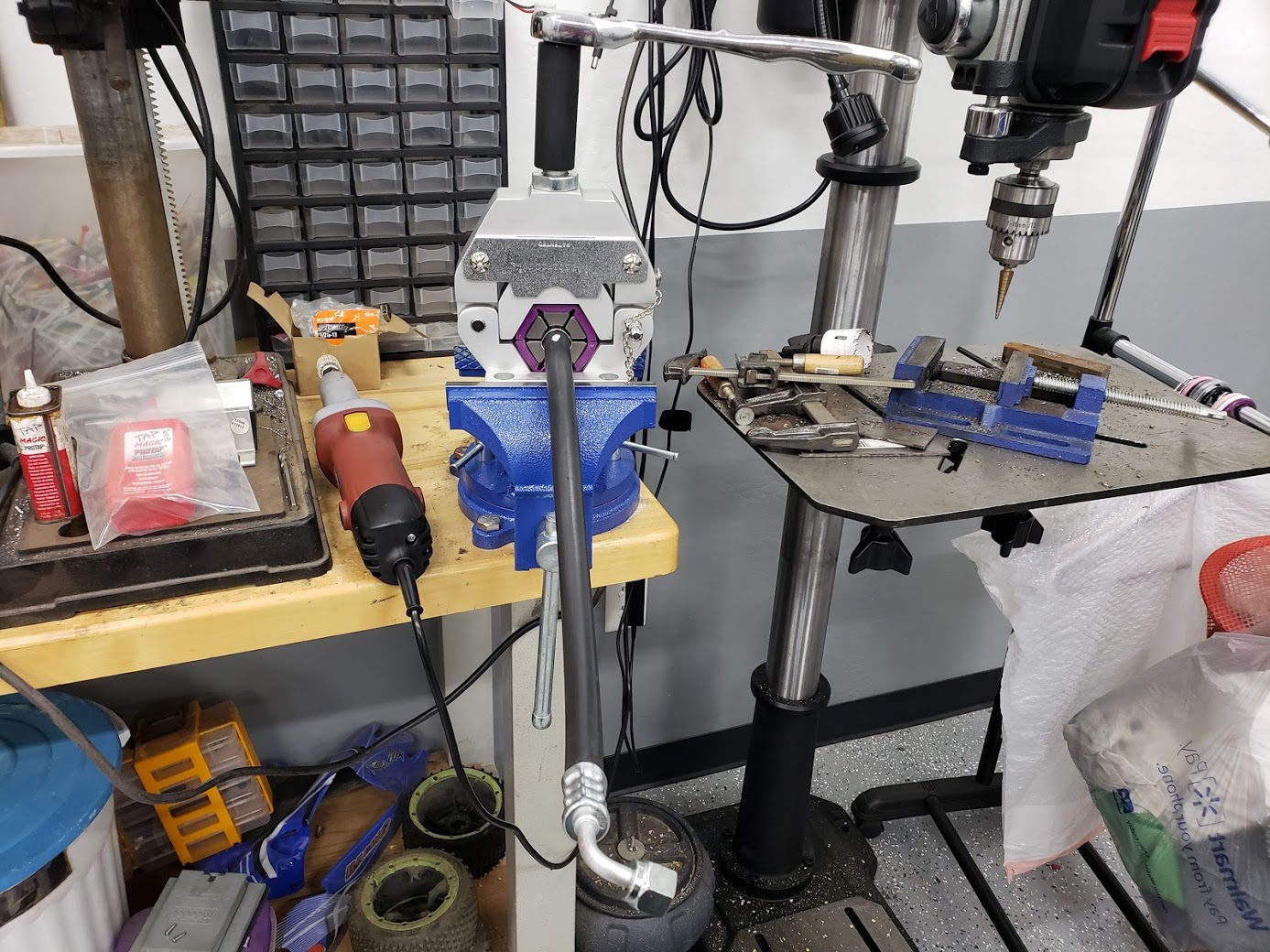

      When I ordered the AC components from Vintage Air I saw they sold the hose crimping tool for a reasonable amount of money. So being the DIYer that I am, I had to have it. It's been sitting on a shelf waiting for it's time to shine, but I expected it to be harder than it was.
      You can see there that a socket/ratchet with the crimper in a vise produces a nice looking result. And it isn't super difficult either. I figured I'd be all worn out from the strain, but everything is clearly marked and the tools do most of the work.
      I used their dryer with a trinary switch for my electric fans. This was also something I was thinking would be tricky, but after studying the wiring this is actually very simple to do. That being said, I am slightly increasing the complexity by routing the wiring through my Smartwire box so that the CAN network will allow the fans to be controlled via solid state along with compressor shutdown above certain RPM or throttle position. Unfortunately I lost my pins so I'm waiting for more to arrive.

      The big question is will it leak? I'll pull vacuum on the system once the wiring is done in a couple days and find out with a leakdown test. I feel confident that everything is sealed. I'm very excited to see how well it performs. Especially since as I type this it is 107 outside.

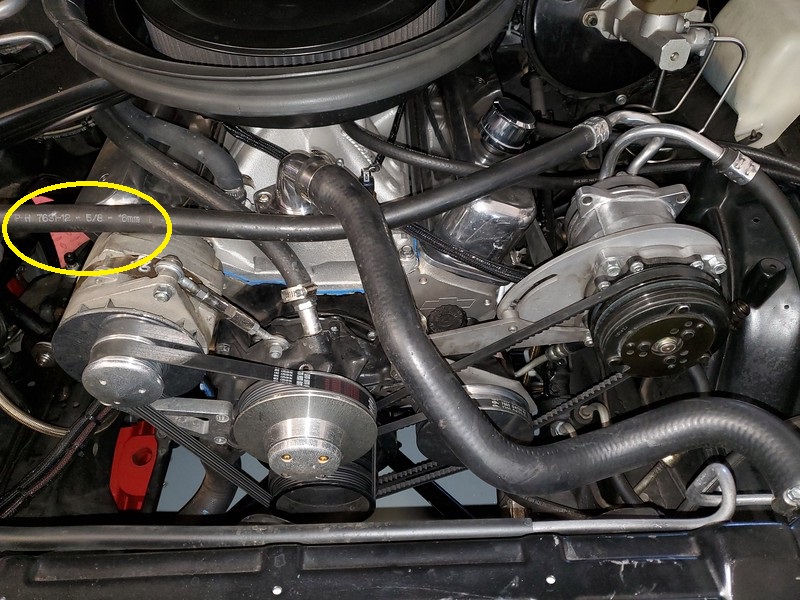

      I have got to get rid of this OEM line running across the top of the engine. Would like to run the hoses from the compressor and condenser up in front of core support and over to the dryer and evaporator on the passenger side.
      How do I figure out what size hoses and connectors I'll need?

      My system from Vintage Air utilized 3 sizes of fittings/hoses. #6, #8, and #10. I'm not sure what fittings yours uses looking at the pic, but I would imagine we can get adapters if needed to utilize the leftover fittings I already have or a fresh hose kit altogether, which wasn't very expensive. I'll have to swing by and look it over so we can formulate a better plan.
      If you look at the hose across the engine it has a part number 7631-12 and then 5/8, -12 indicated 3/4 and 5/8 is the ID which matches the ID of the tubes on the fittings. I imagine your other hoses have that same info on them.

      Good idea, I'll check for part numbers on all hoses then try to decipher fitting sizes from there. Thanks...
