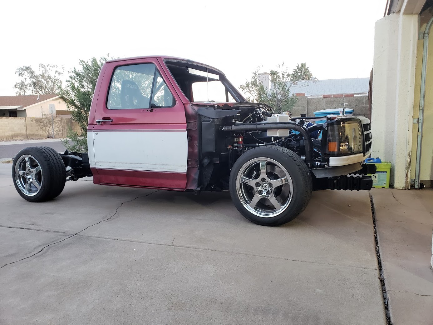

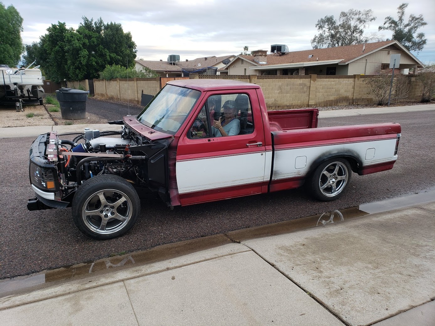

      I'm so fortunate to have cool neighbors. A couple of them heard it thunder by and came running down the block to talk about it before I could even pull back into the garage!
      I'd like to get everything bled again and try this afternoon for round 2 while it's still light out. Lance, you and I will be corner weighting before you know it!
      Who has guesses about the weight in street-legal form? Starting thinking about it...

      I keep finding little gremlins, but better here in the neighborhood than across town.
      So far I've had 2 oil lines leak, the steering shaft come undone (that one was interesting), and a couple small cooling line drips. So I'd say overall this has gone ok, but the alignment is still HORRIBLE. Haha.

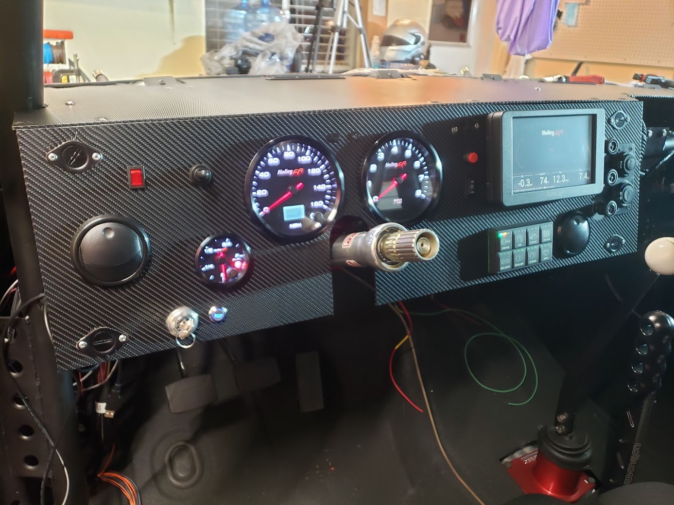

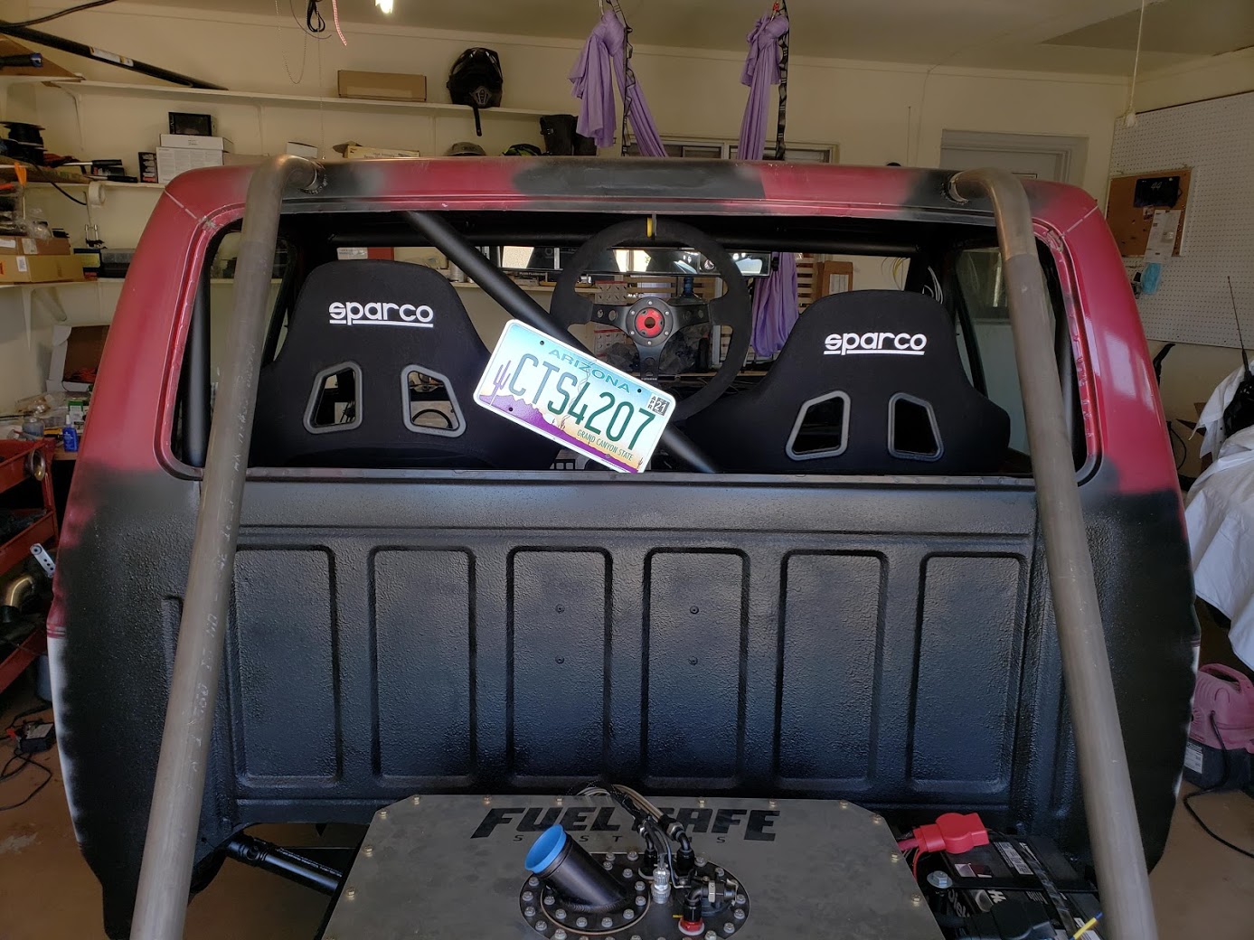

      Hard to show in photos, but I've been doing a little on the truck every night. I got a license plate and insurance so the push is to get everything together enough for street driving. Gotta love how easy AZ is.
      Of course I needed the interior wiring done so the truck is fully functional. That has been most of the the time suck right now. But last night I bolted in the two most important panels and I'm loving the results!
      Even the Vintage Air unit is functional now.
      This weekend is all about prepping under the bed so that can be final mounted, finish the front end install, and install/wire all new lights. That should ensure I won't get pulled over or run into. I expect to be street driving next week depending on when I can get a fresh windshield installed. Now I need a basic tune to keep things safe while I throw break-in miles at the drivetrain. This is so exciting!

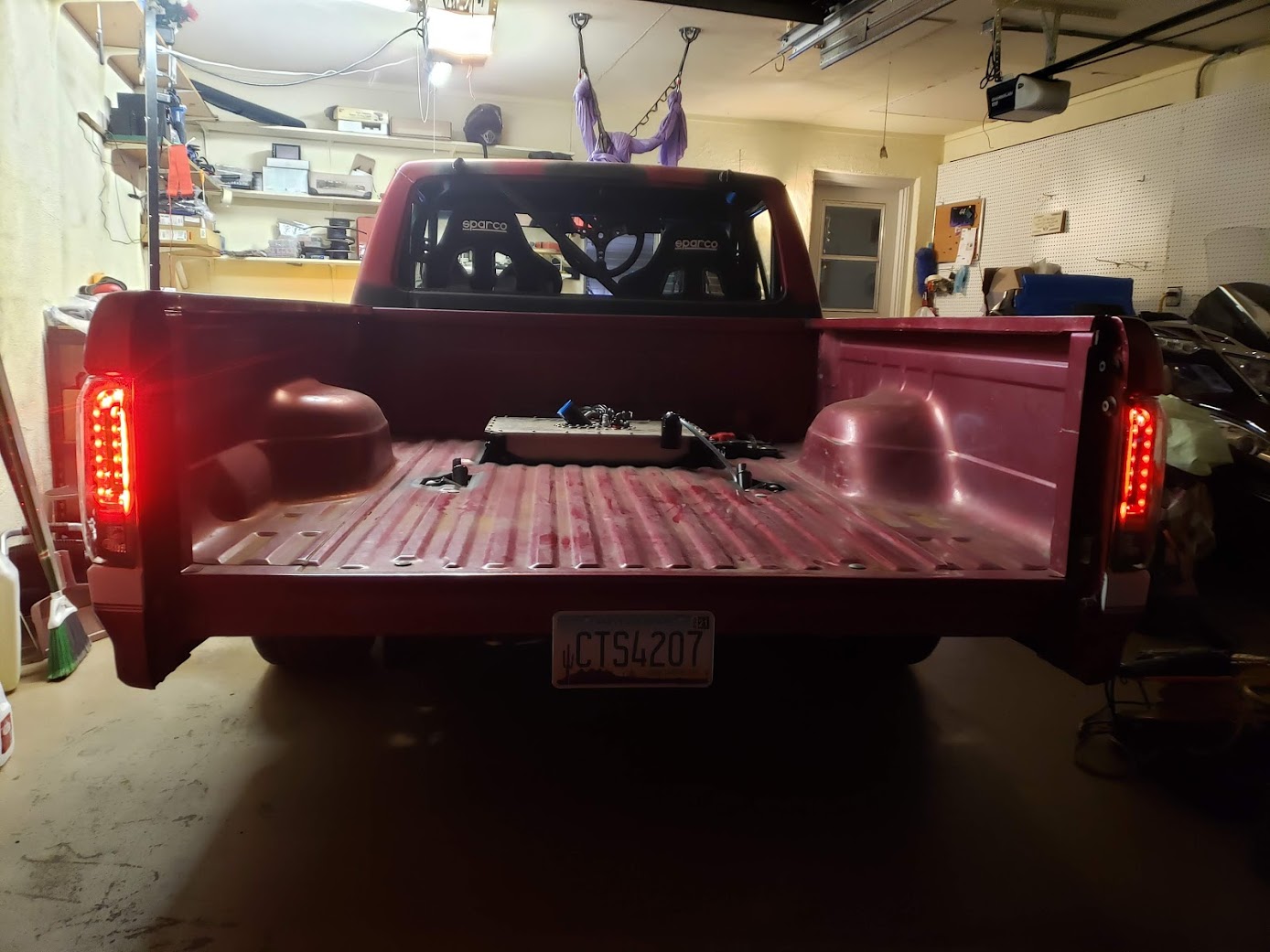

      While it may not look like it, I got some good work done this weekend.
      Big focus was wiring all the different lights. Doing wiring properly always takes time, but better to do it now than chase issues later. Since the bed isn't on yet I focused on the front.

      Must have forgotten to snap some pics, but the bed is sitting ready to install. I routed and loomed the entire rear harness so all it needs is the OEM plug added and we are fully lit. I'm also going to call and schedule for a windshield install this week so I can safely tolerate road speeds. Haha

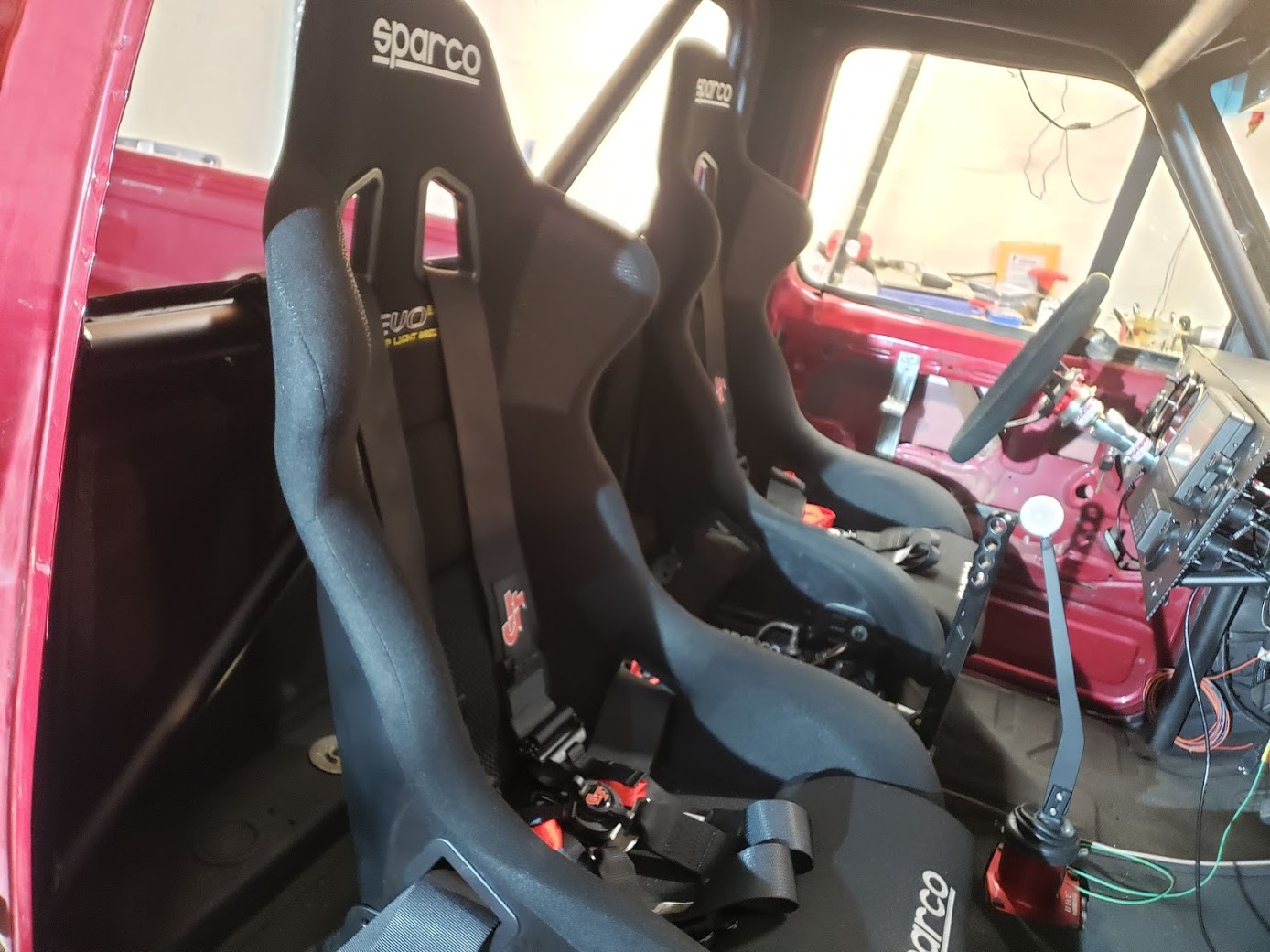

      Well I was trying to get to Lance's to do the alignment and weigh this beast, but I guess I don't quite work that fast. We obviously want to have everything on the truck so we get the most accurate data. Hopefully we can knock that out in a day or two.
      First up was to get fully functional tail lights going. I've had most of the features operational for about a week, but with the Smartwire system you aren't supposed to be able to use a factory tail light housings with dual filament bulbs. I spent some time on the phone with Jesse over at Level 7 Motorsports and we came up with a game plan. I had to pin 2 more wires than the normal "street kit" harness includes, but I got it to work. This system is really cool, but be prepared to just play around in the software to learn and try things. So yes, you can make OEM lights work. I did it.
      Since I now was technically street legal I installed both 6pt harnesses. All lower belts clip-in with approved hardware, but I still believe in wrapping the shoulder belts.

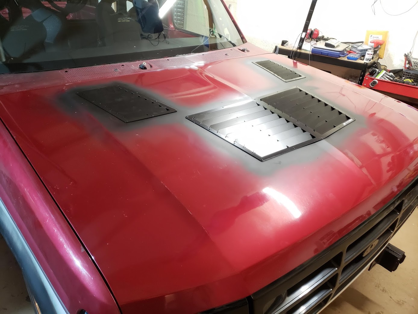

      I found some weight to kill in the front end so I spent half of Saturday and all day yesterday cutting up sheet metal. Only drew blood once so I consider that a good day. I pulled 8.75 lbs off the hood getting it down to 20.2 lbs. Each fender lost 3.6 lbs getting them down to 8.8 lbs a piece. A big part of the weight loss on the hood was thanks to the Trackspec hood vents. Because they add some rigidity to the outer skin I was able to remove additional under structure without making it too floppy.
      Took some hammer work to deal with the center ridge of the hood. I should have gone with a 2pc center section, but this turned out pretty well and will work great. I really like the look too. Ignore the crappy paint with my black coating for now. That was just for rust prevention until I paint the entire truck in a couple months.
      I'm still waiting for a front bumper since I sold the stock steel one. It was way too heavy for what we are doing here. Once that shows up the body is basically done for now. It's getting so close!
