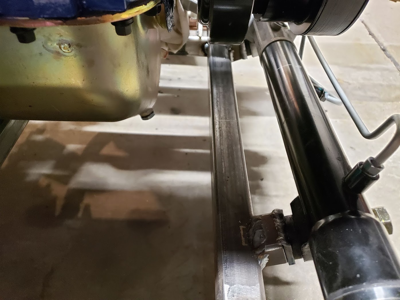

      Speaking of that, yesterday I moved the motor mounts up to the frame which allowed me to cut out my V1 cross member. Poor truck looked so naked without a front suspension. I was able to roughly test fit the new subframe.
      Yes it hangs lower, but is still an inch higher than the lowest point of the frame. The control arm mounting holes are 1/2" higher than before for better roll center at ride height. WAY more clearance around the oil pan now. I did cut the plates so they extend to the inside of the frame. I am going to use that to help with eliminating flexing of the frame rail under load after this is in. There is a plan.
      If I had started with this, I would have mounted the engine about an inch lower, but I'm not changing all that now since I'm happy with how the drive train is placed. It's already almost 2" lower than stock anyway and I'm not about to redo the headers/exhaust again.

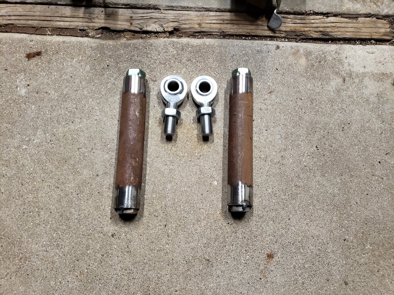

      I did a bunch of calling about the bump steer kits and the longest adjuster I can find is 6". I could do 6.5", but I'm not comfortable with less than that. I thought about buying different tie-rods, which would work, but I have to buy the adjusters anyway so that's $150-200 no matter what and the tie-rods are another $50. I'll just see if the local machine shop can knock out the adjusters for a fair price first.
      I whipped up some dummy adjusters real quick with scrap tube and 2 nuts (thank you Amazon for 24hr delivery on special threads) so I can work on making the rack mount and hold the spindles straight. Totally works for this, but I would never consider driving with these. I'm not even sure I want to set it on the ground with something so minimal.

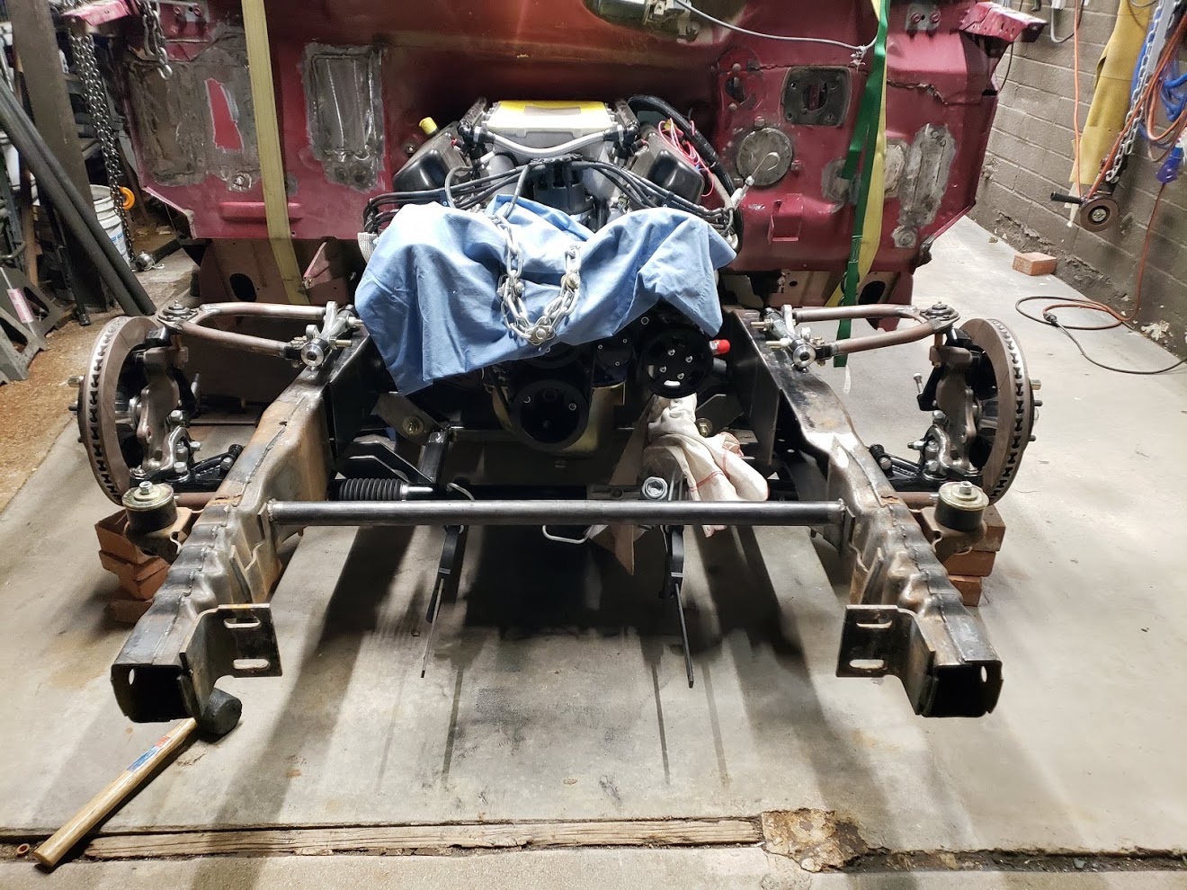

      Now for what you've all be waiting for...upper and lower arms and the new cradle are solidly tacked in. WHEW!
      So 2 weeks of me overthinking and stressing little things resulted in exactly what I wanted. The 2 biggest things remaining is to come up with a new upper shock mount and make the steering rack mounts. The rest of what it needs is all related to finish welding and adding support plates.

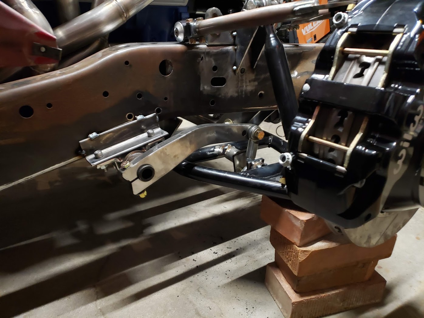

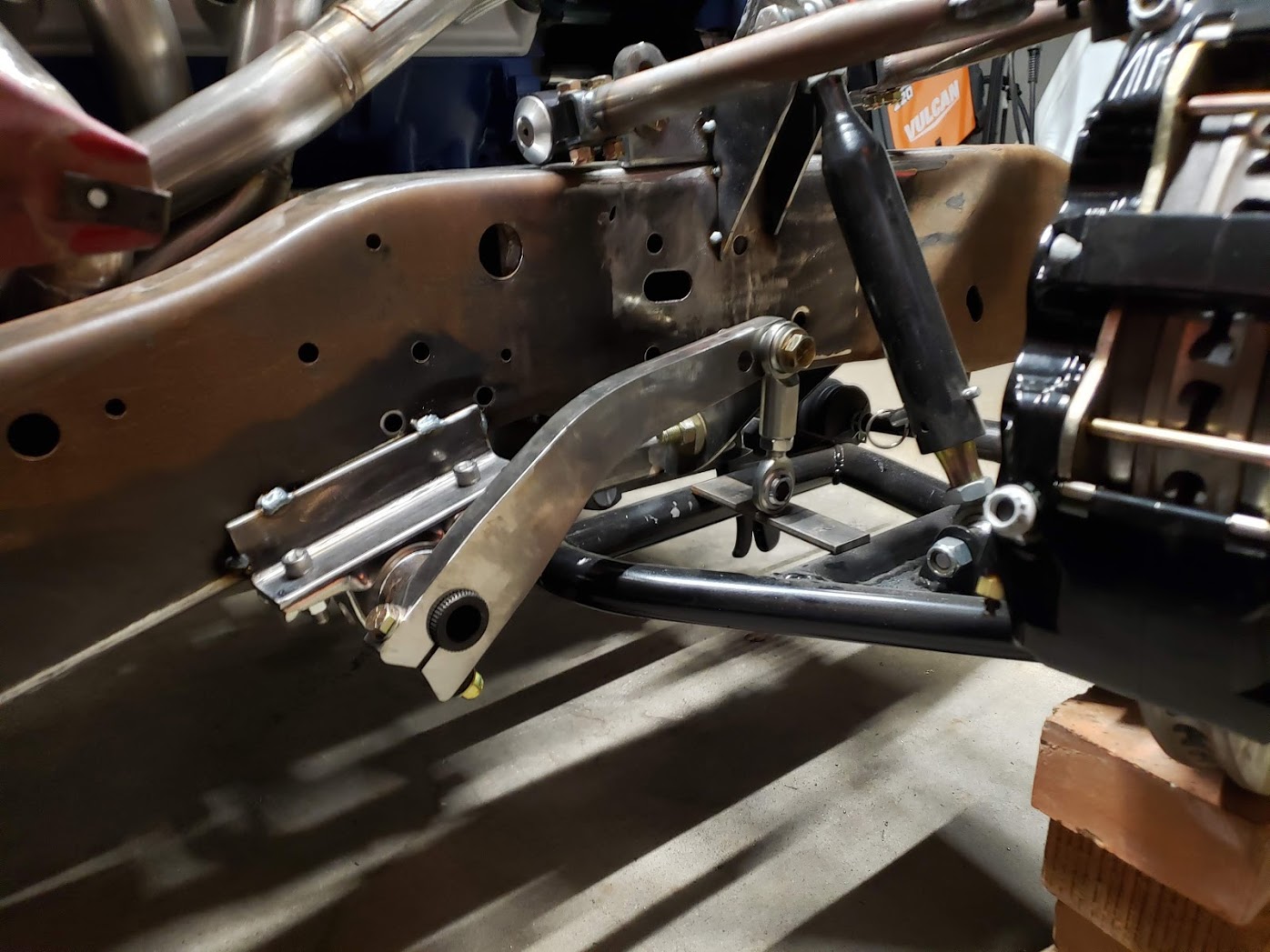

      Last night I got the upper shock mounts tacked back on. I like this setup much better how it ties the A plates into the frame better. I'll still need to add some additional support to feel totally comfortable.
      I have to give all the credit to Lance for my sway bar decisions. He provided excellent insight which resulted in what I believe to be optimal placement for my chassis. It's tucked up slightly above the bottom of the new subframe and just in front of the oil pan sump. All located behind the front suspension so no steering interference.

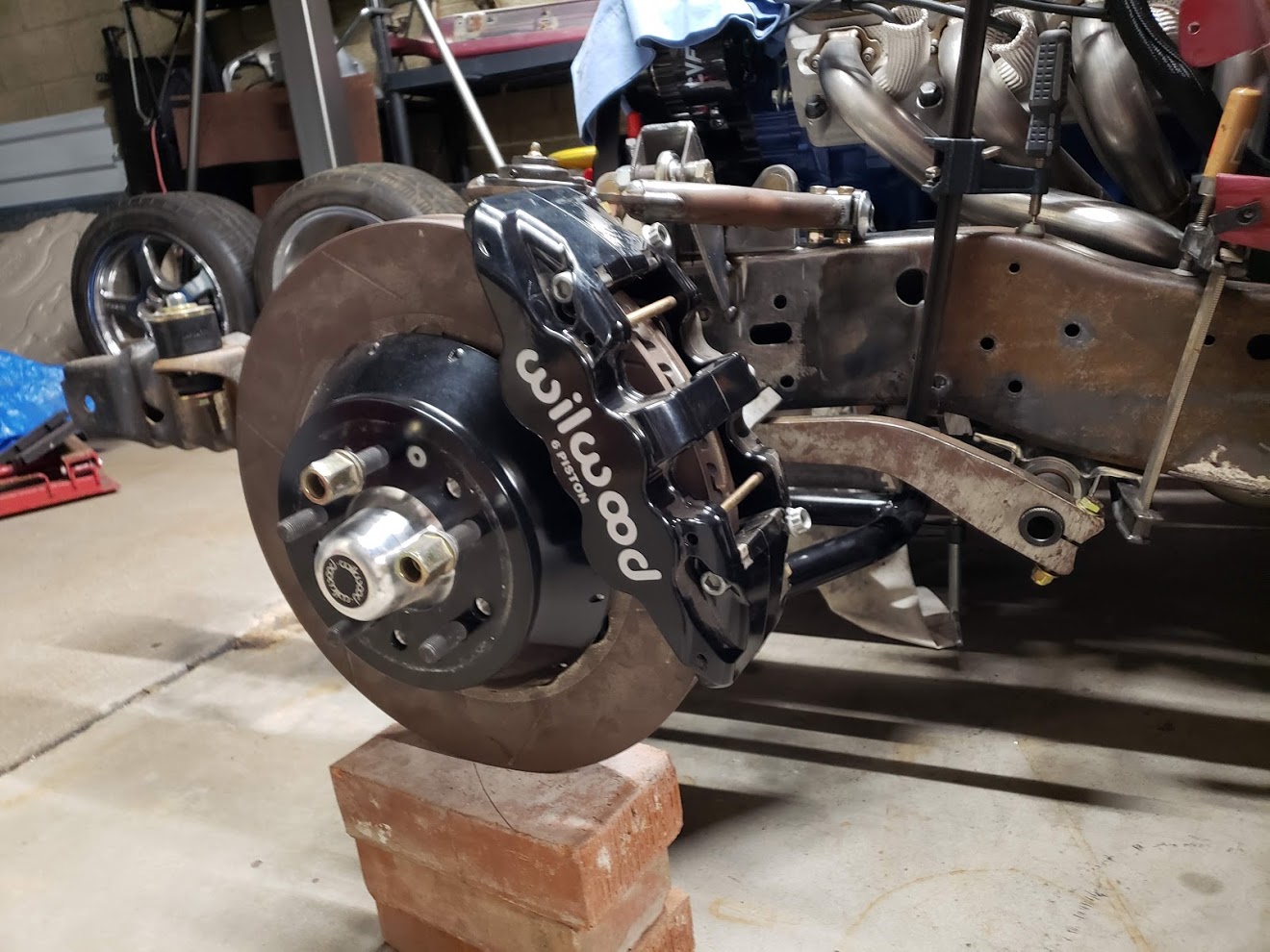

      And just to see what all of the components look like together I grabbed a caliper. This is all going to look so awesome once I weld it out and paint everything!
      So there you have it. Just about done fabbing the front and onto the cage next. Hopefully in the next 2 weeks we are disassembling for final welding and paint.

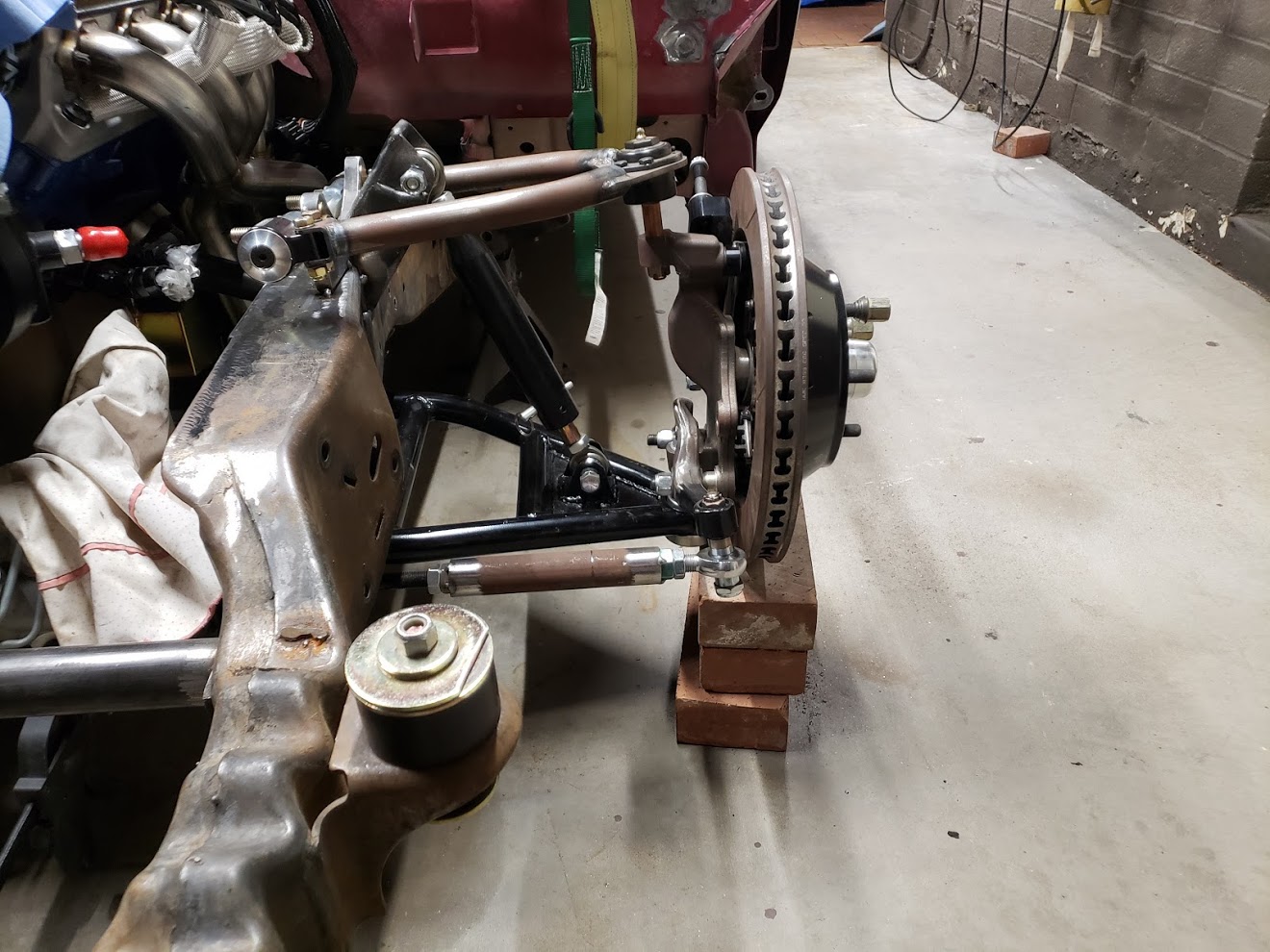

      Didn't have as much time as I wanted to work on the truck this weekend, but I got stuff done so I guess that counts. I have a work trip to fly out for tomorrow morning, but I'll be back in time to do some work Tuesday night.
      We left off a couple days ago where I had just test fitted the sway bar. I got worried about tire clearance at full lock so I mocked everything up with the driver's side wheel/tire turned all the way left. This was also my first chance to see how sharp I can turn. I believe this will be fine to start off. If I want more angle later we can revisit the steering arms again.
      Miles of room if you look at the rear of the tire vs the splines on the bar. And remember that we won't be adding any additional backspacing with wider wheels. That will all go outboard.

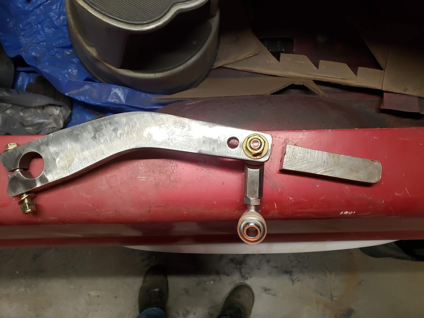

      Then I needed to shorten the arms and drill the holes for endlink bolts. So 5" chopped off and 4 holes later I had the perfect result. The second hole is in case I want to try adjusting the bar firmer later. We will try the softest setting first (yes I know we want a stiff bar Lance. lol)

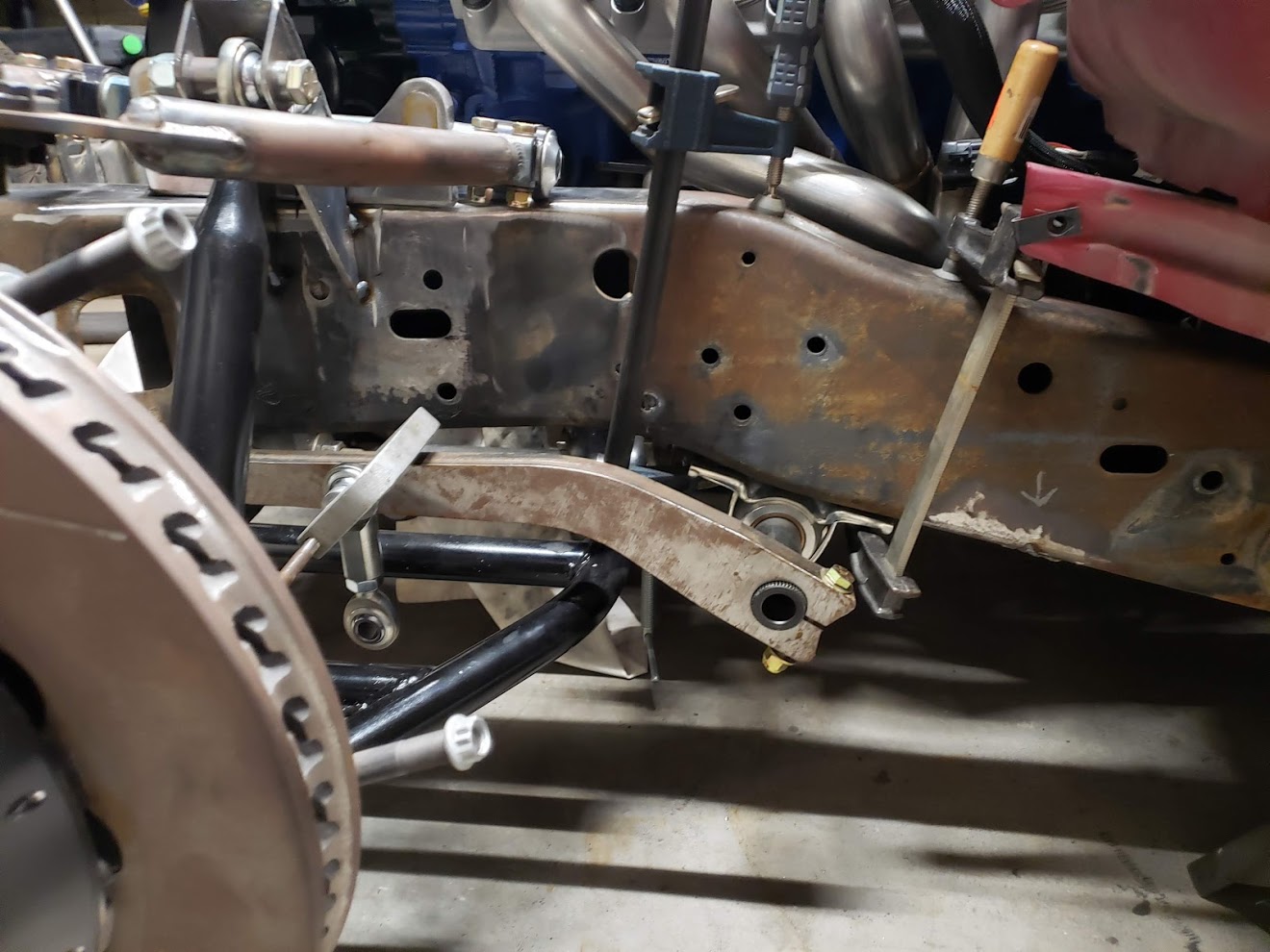

      I spent a while looking things over and generally thinking about how best to mount a bar that is trying to twist itself with forces potentially approaching 900+ lbs. Then I happened to see some 1/4" thick angle iron sitting there and it seemed like a reasonable solution.
      I'll definitely add some triangle gussets to help, but it's pretty solid even just tacked. I didn't snap a pic, but I have room to go to a thicker bar later if I want. I also made sure that the slotted holes on the mounts slide the bar forward for that as well. It's like a symphony there.

      So with that done I started back on the endlink mounts. Literally 2 hours of playing with different ideas later I think I hit one that checks all the boxes. Plenty of range of motion, ease of adjustment/removal, strong enough, and looks good.
      It's not super pretty yet, but it's made with 1/4" wall tube and plate with a 1/2" grade 8 bolt. I have seen lesser mounts on aftermarket control arms hold up on many cars.

      Do you have good tire clearance when you turn right at the adjuster sleeve?
    18. #338
      Oct 2018
      Phoenix, AZ
      583
      Quote Originally Posted by Peter Mc Mahon View Post
      Barely clears, but it is crazy close. Luckily these tubes are about 1/8" larger in diameter than my new solid aluminum adjusters will be so I should be ok. I'm going to be watching that very closely. Yet another reason that I wish I had better steering arm options.
