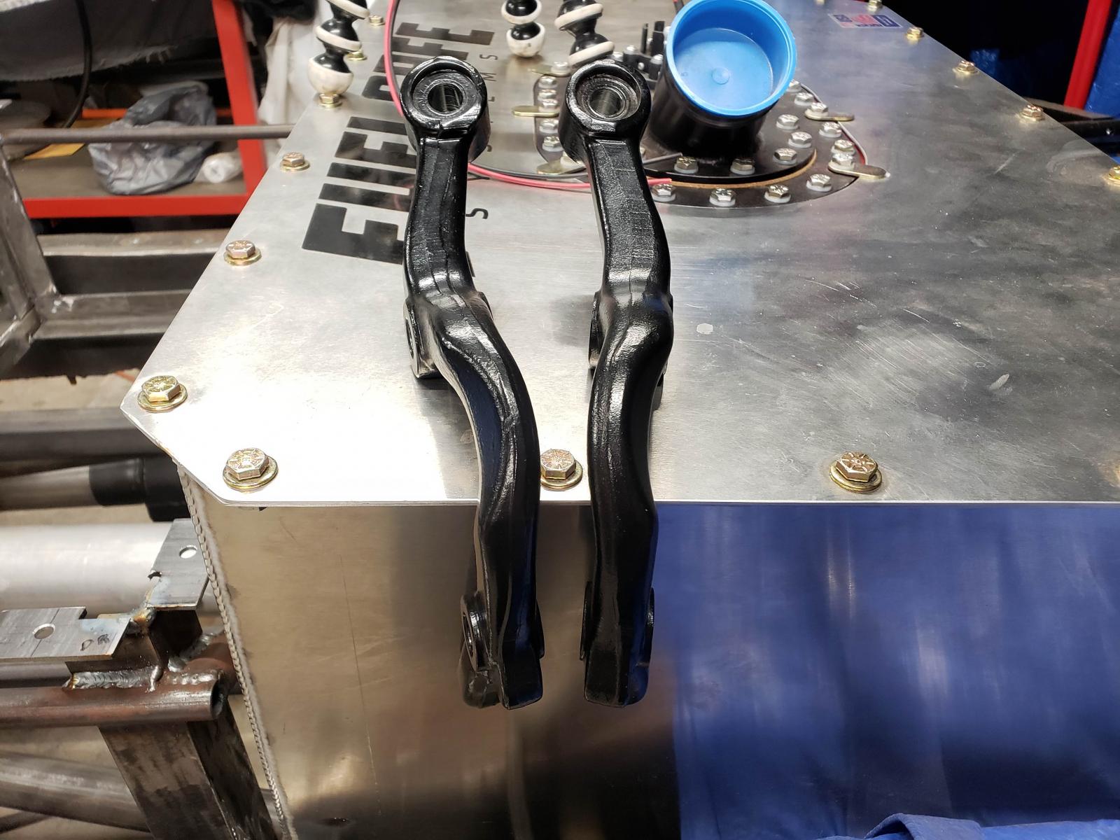

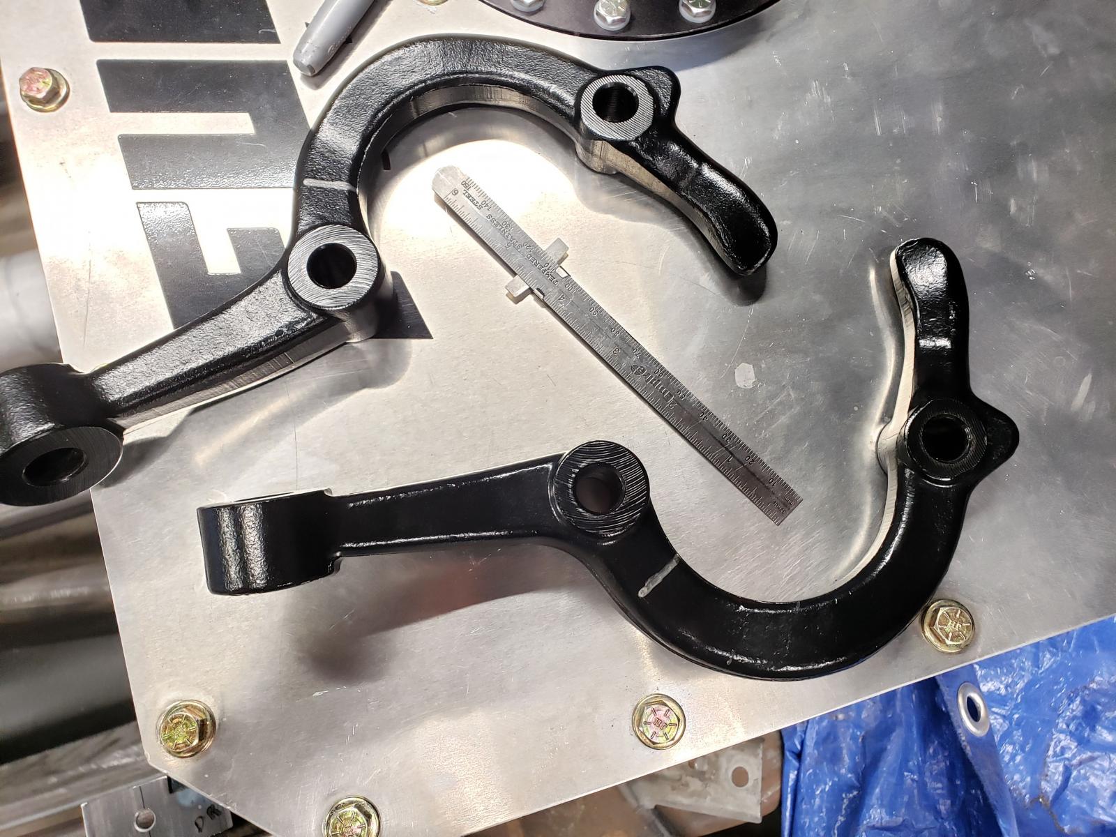

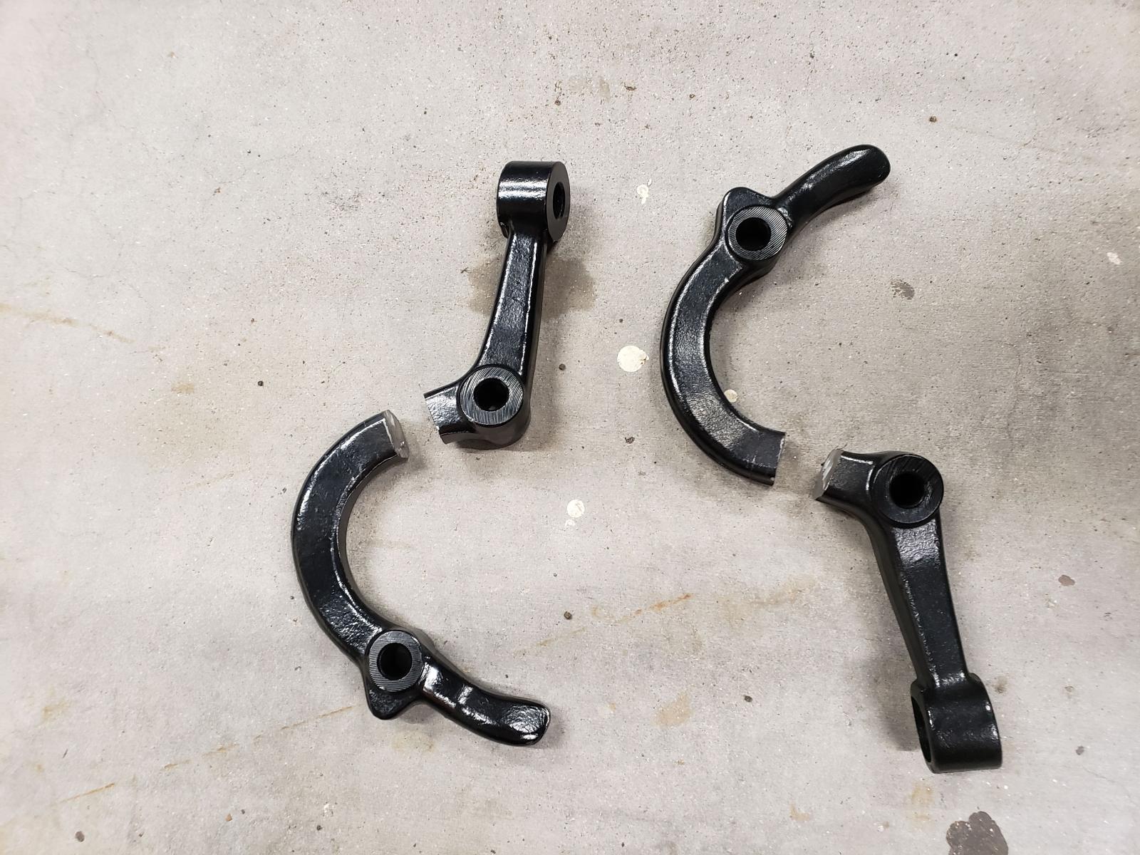

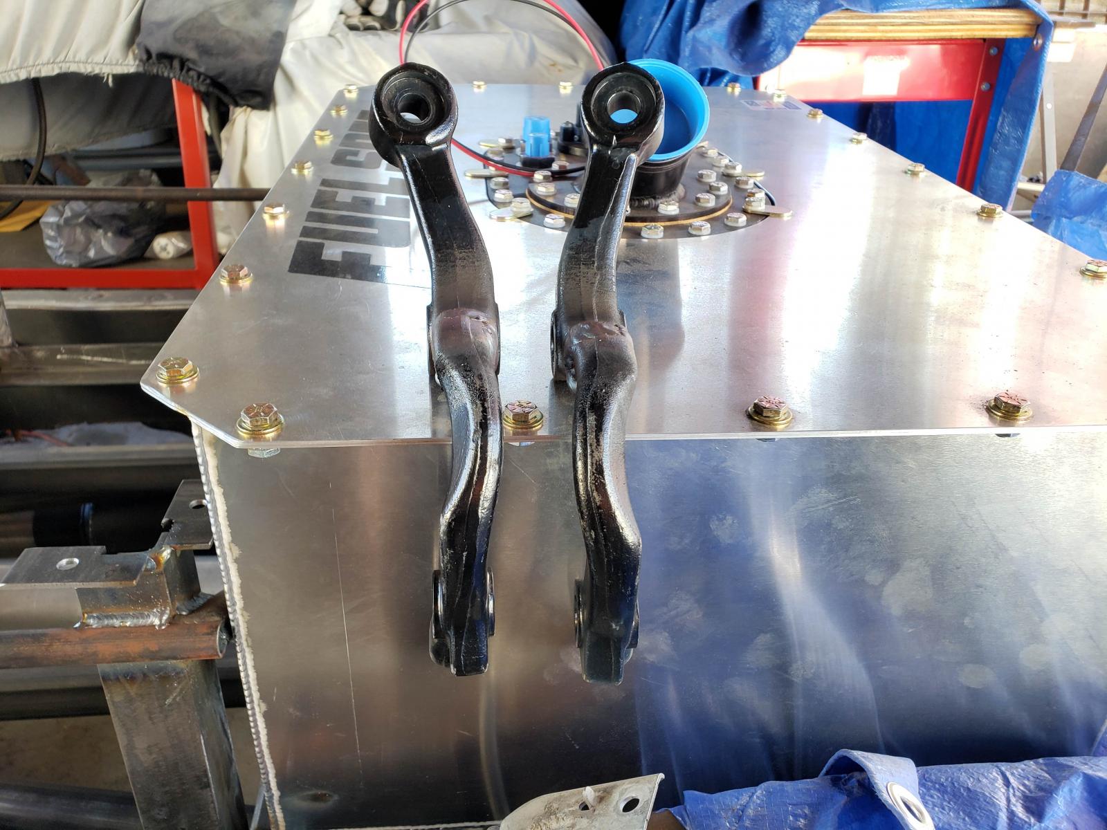

      Going back a few updates we talked about how these A body steering arms work for rear steer, but I have front steer. I did find a guy named David Lemmon (TRZ referred me to him) that made front-steer arms with Ackerman....until 5 years ago. Due to limited interest he sold what was machined and threw in the towel on that idea. I even attempted begging and told him to name a price to make a set, but he wasn't having it. Fortunately he did share some specs to help me make it happen myself.
      I considered asking for his drawings to have a CNC shop knock out a pair or two, but I know what limited runs cost from working in an aerospace CNC shop so I put that idea away very quickly. Then I resolved that I would cut and weld the standard forged steel arms that I already had. They are only $65 from Summit so if I screwed up, not a big deal. I'd always regret it if I ignored this one last thing on my suspension.
      Here's how it went:
      The arms aim inward from the wheel which equals Anti-Ackerman. Bad for me.
      Silver Sharpie and a machinist"s scale to carefully mark a cut line

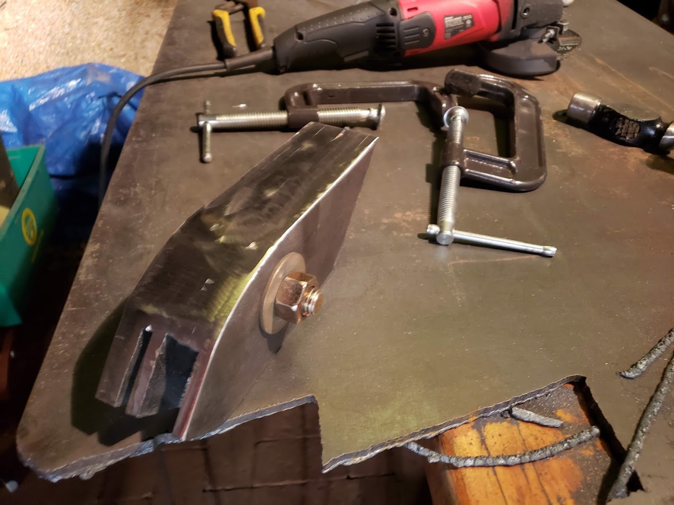

      Then the moment of truth. I attempted to cut these with my bandsaw. It very much disagreed so I grabbed the grinder with a thin disk and it zipped right through.

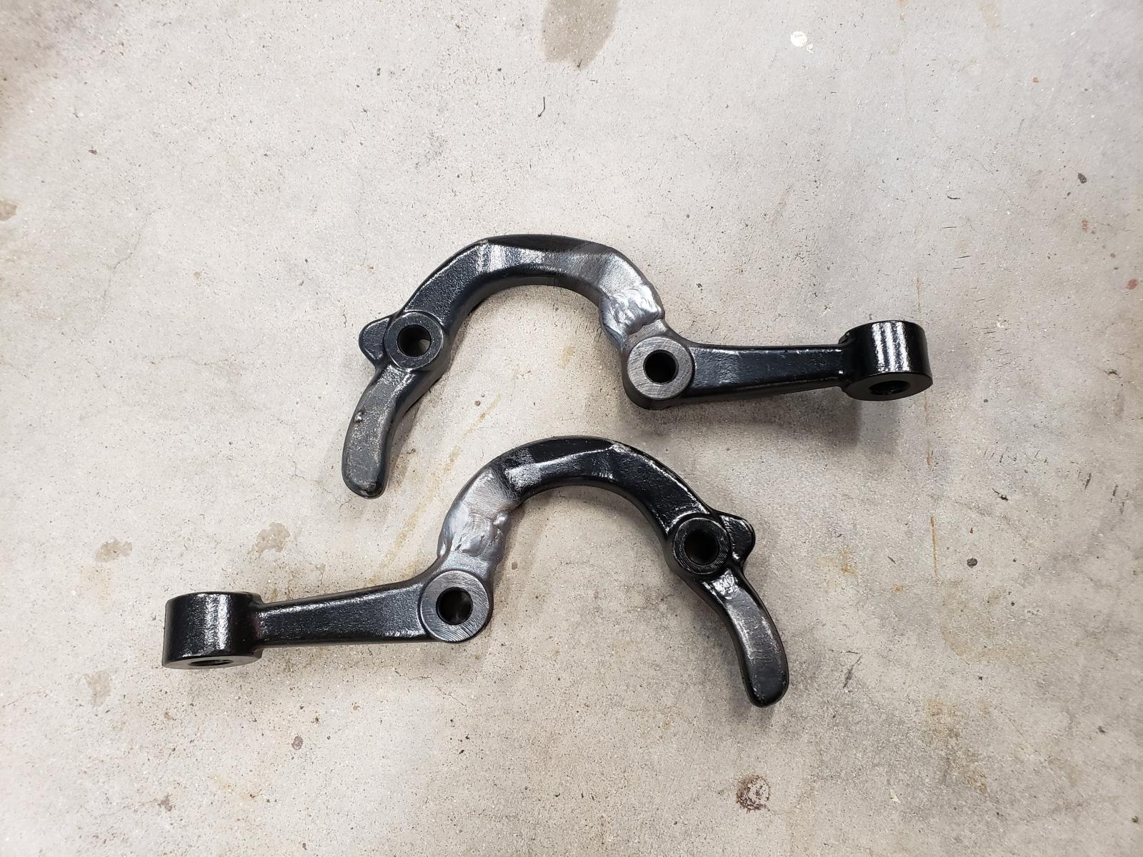

      Since the material is about an inch thick I beveled heavily to insure good weld penetration. Not an area I want to roll the dice with.
      I bolted them up to the spindles and made sure both sides matched and then tacked both heavily before removing again. I don't want to put that much heat and spatter on my nice spindles.
      Finally I cranked up the welder and took my time filling the channel I created before I ended up with this.
      This evening I'll use the flapper disk to clean it up and then paint them black again and you'll never know it happened. I'm pretty satisfied and the weld joint is not out on the arm under the highest stress like I was originally planning. I also got more Ackerman than I need so these can be adjusted with spacers which is a nice bonus. Lemmon suggested about 1/2" offset to the outside of the ball joints. It's a little tight to the wheel for the tie-rod stud, but it clears. If it doesn't workout somehow I'll just go with the TRZ zero ackerman steering arms for my front-steer application. What do you guys think of this solution?

      Nice thinking out side the box... I want to see this picture replicated with the new and improved arms...
      Lance
      Oct 2018
      Phoenix, AZ
      583
      Quote Originally Posted by SSLance View Post

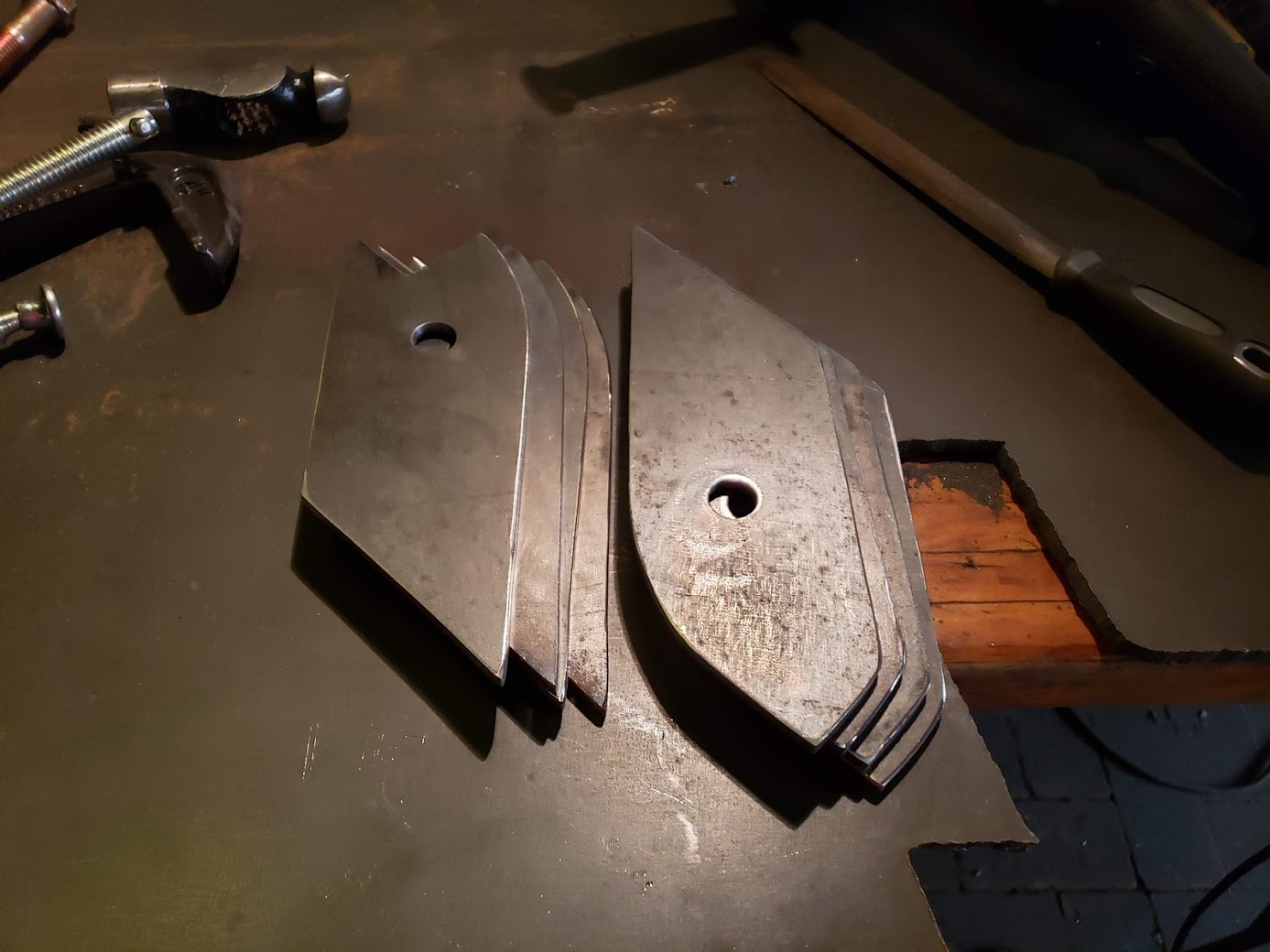

      Thanks! I think this is the best compromise especially when you add in the time and money saved from creating brand new arms.
      As requested....
      4 spacers from now I can consider this procedure 100% done. And this is why I need to stay out of my head. So much easier to do than I thought.

      So simple yet so VERY effective. Nice work...

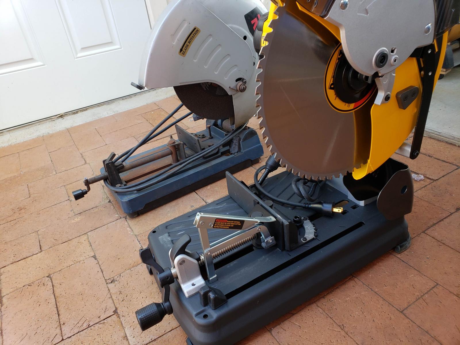

      My old abrasive chop saw was having the worst time cutting in the last week and I suspect it is dying. With roll cage fab coming up fast I made the decision to buy a new one that should last a while. For those of you who haven't used one of these carbide metal chop saws....do yourself a favor and try it. I could cut .250 wall square tube in about 3-5 seconds. My abrasive saw was struggling to even start that cut. And you can see how much bigger the new saw looks even though they are both 14" blades.
      If you have questions about this, feel free to PM me.

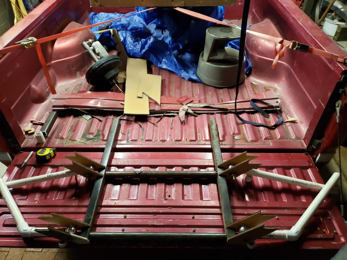

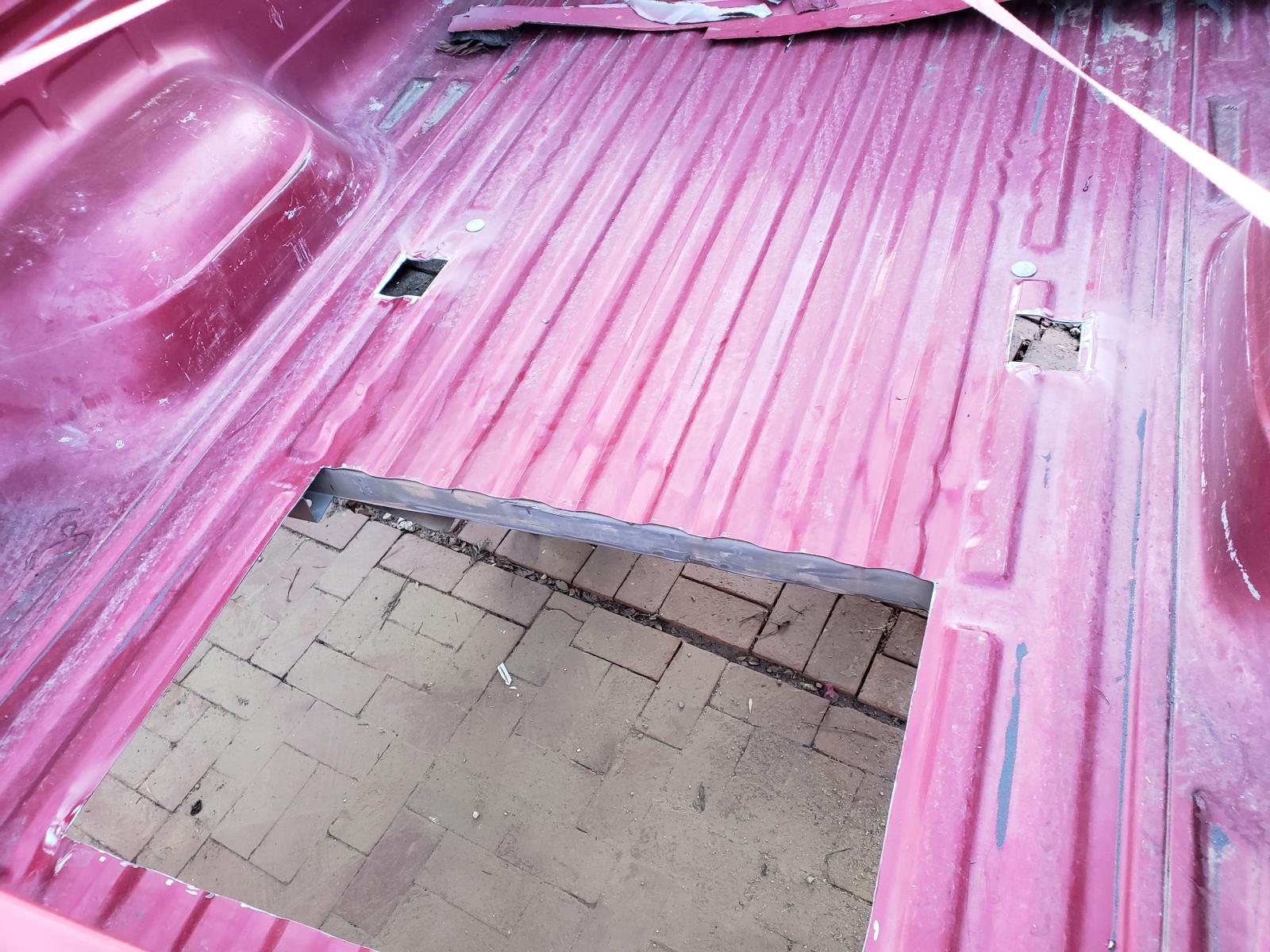

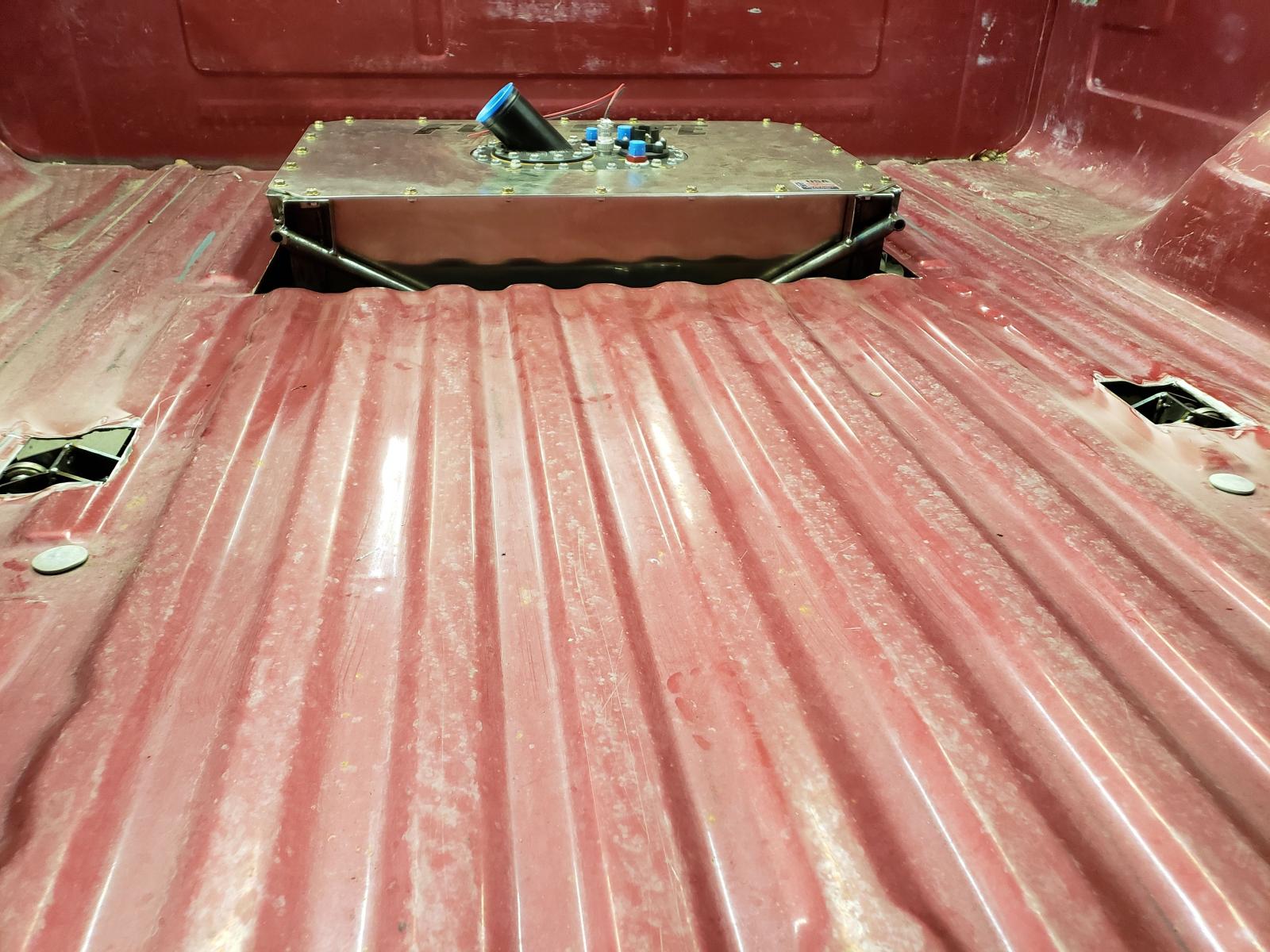

      After that I made a cardboard template of the square I needed to cut out of the bed and took careful measurements. Then based on the mounting hole positions I marked it out. It was a perfectly straight and rust free bed so I needed to cut it up. Haha.

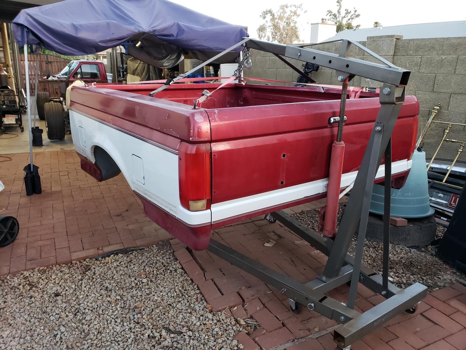

      Then I could use my engine crane to pick the entire bed up and roll it over the frame. This is the same method I always use, but I finally remembered to take a photo to share. I need to whip up some kind of boom extension for this thing. I could always use a bit more reach with lighter stuff like this.
      Somehow it all just slipped together. No fighting, no prying, and not even an F-bomb or crushed finger. Aside from about 1/2" of trimming needed around the holes for the shock mounts, it fits flawlessly.

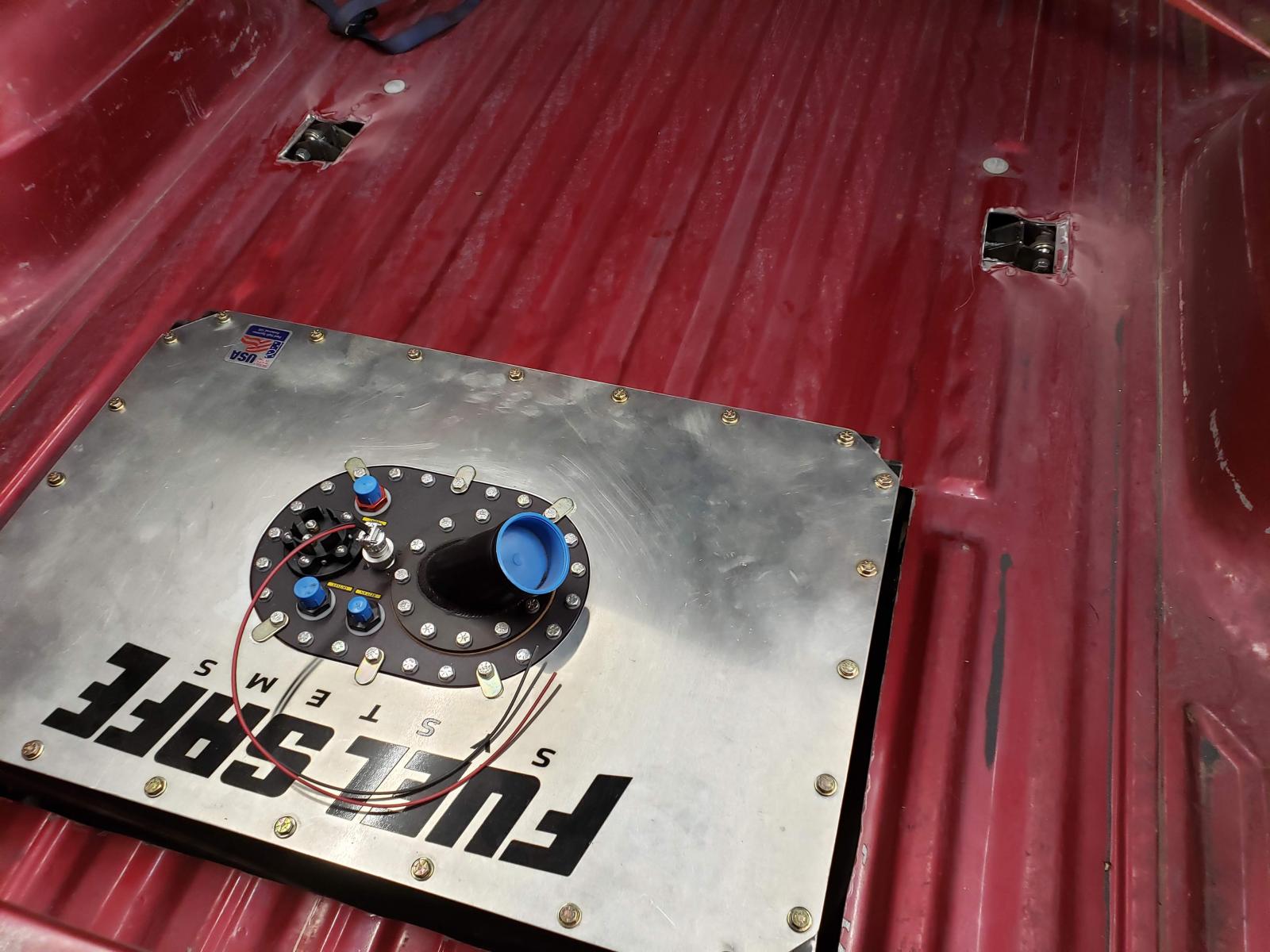

      Fuel cell pokes into the bed by exactly 4" which is how I planned this all along. I feel this slight penalty of weight being higher than mounting it low behind the suspension is worth the benefits of having this load in front of the rear suspension. It will be about 190lbs when full of fuel and I don't want that swinging out back. Beyond this, I only need to cut out holes for the rear cage bars by the shock mounts and make some kind of mounting point for the wing uprights by the back. Then the bed is done other than paint.

      We got one of those types of saw a few years ago, best tool we've gotten in a long time. So much nicer than abrasive discs. Just the parts not getting hot from cutting is worth it in my opinion.
      We made a longer boom for our engine crane since we hated the short ones that come with them. Unfortunately, the tubing size on ours was some weird size that was not easily available, so we had to add some flat stock onto the new tube to get the dimension right lol. Not very pretty, but gets the job done.
      Looking good as usual!

      Good point about the saw that I forgot to mention. You can absolutely hold your hand right on the cut as soon as it comes off the saw. It's amazing. Plus no dust. It makes chips and those don't float around into your lungs like the abrasive dust. I felt less stopped up after this weekend.
      I'll have to look at making about a 3ft extension on my boom. I'm sure I can make something that sticks on with a couple bolts when needed. I know my big crane can do it better, but the little one is so much easier to maneuver. Shoot me a pic of what you made if you think about it.

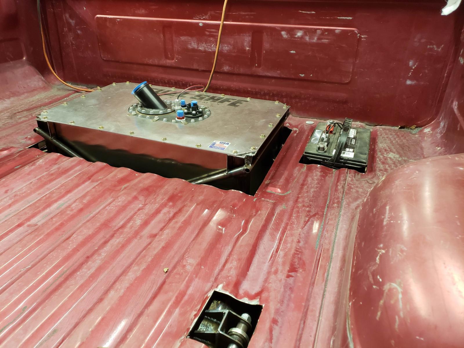

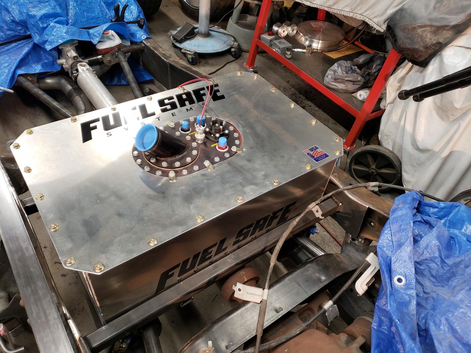

      So to follow up on the bed being test fit with the fuel cell, I wanted/needed a place to mount the battery on the passenger side behind the cab. At the same time I knew that ease of access is paramount for a number of reasons that we can all think of. I settled on the outside of the frame rail at the front of the bed with it just above level with the bed floor. This way I can reach over and remove, jump, or charge whenever I need. I will make an access panel in the bed cover when I get to that part.
      If you are confused by my using the normal battery...don't be. It's readily available and listed for this particular truck. Plus this was brand new when I tore the truck down and cost nothing to use. If I ever need a replacement I can easily find one even in a small town. I only need to add a tie down and that's done.

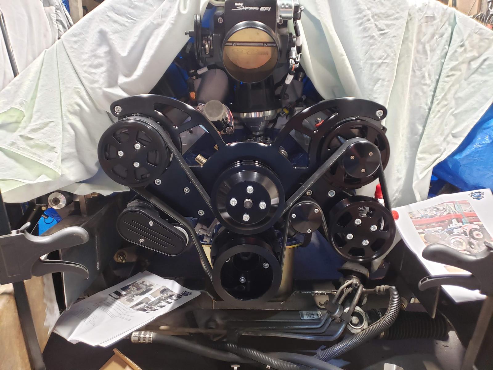

      Something that I have been sitting on for a while is my full serpentine drive system. I met the CVF Racing guys at SEMA last year and was super impressed with their offering for my platform especially for the price. So I ordered their stealth Wraptor kit along with my Vintage Air system so it would all match. Unfortunately I wasn't aware of the difference of standard and reverse rotation water pumps on the SBF (thanks a lot Ford) at the time. Now I'm SUPER well educated on it. Turns out that CVF doesn't have a Wraptor option for reverse rotation, but my motor is just assembled and has that timing cover. I didn't want to change engine parts so I shot a message and made a suggestion to them about whipping up the couple needed parts to make it happen. It's not something they ever get requested so their enthusiasm was.....lacking. Haha. They did end up special making the 6 components needed for me to now have the ONLY SBF reverse rotation Wraptor kit in existence. OUTSTANDING customer service! All I wanted was to return it and buy another kit already done. They went above and beyond to make me happy, probably costing them money on the sale. So please consider their kits if you need a serpentine system because they absolutely will not let you be unhappy, is built really well, and it's made in America.
      I realize this could have waited, but I wanted to add some fun parts and break up the constant cutting and welding.

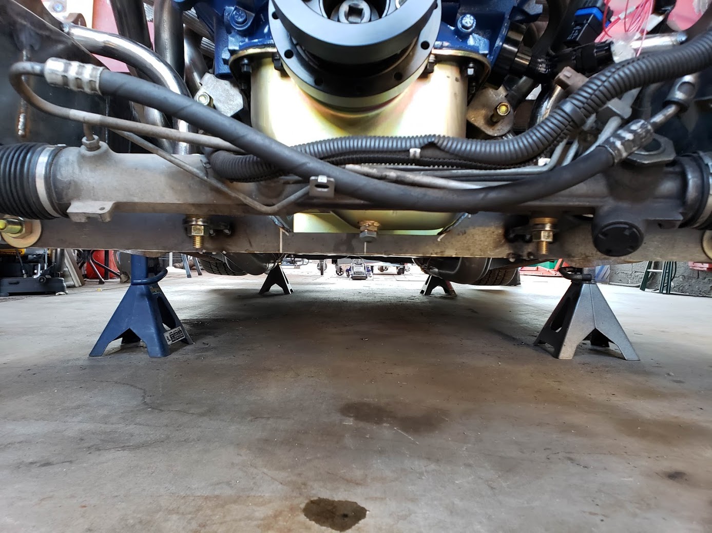

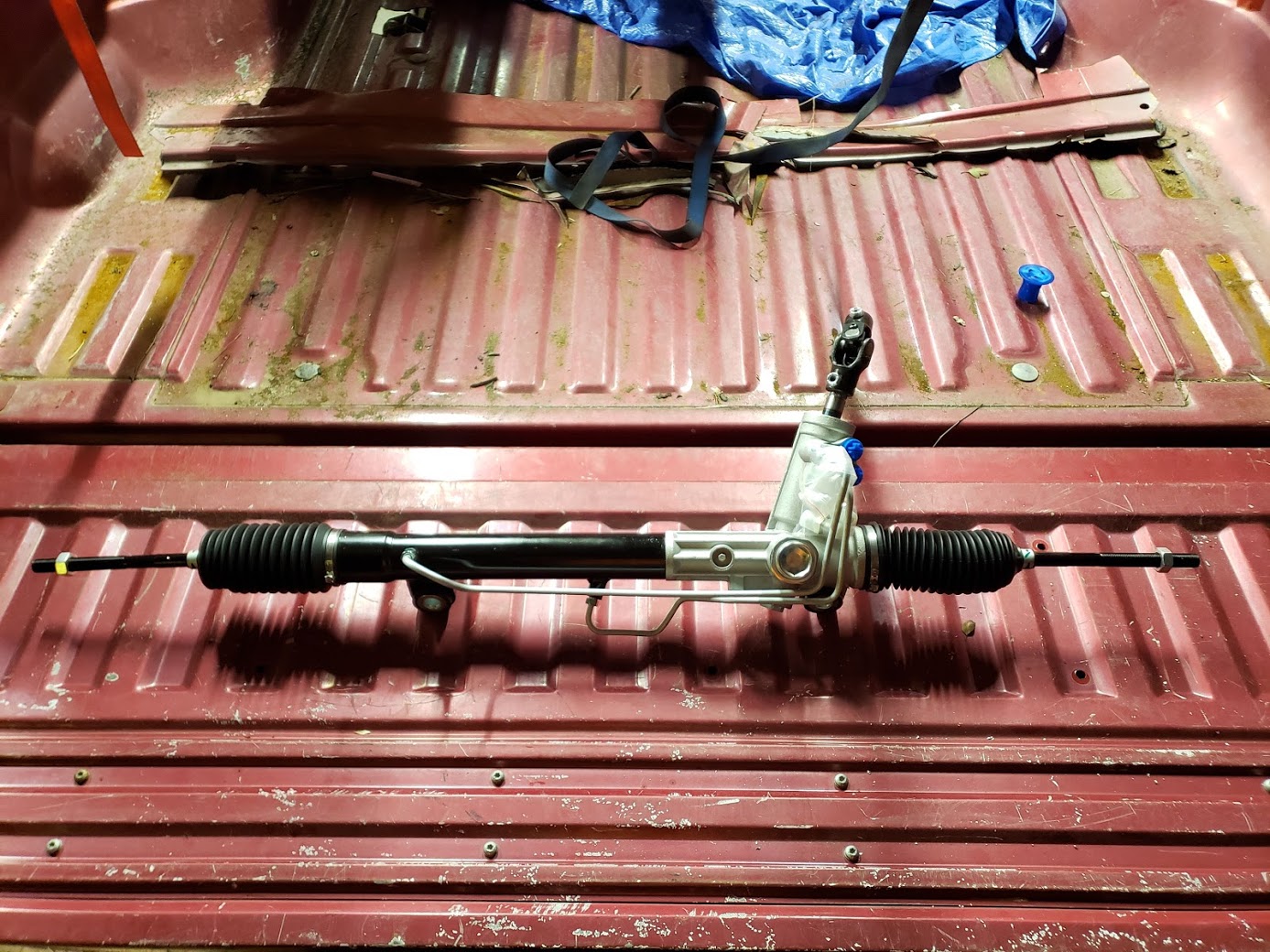

      First up was relocating the steering rack up to correct the bump steer that the new steering arms caused. Ended up having to raise it 1.5 inches, but it was a fairly easy task. I also like the new mounts much better than before. As a bonus, the rack is adjustable with washer shims too.
      Also, looking back under the truck there I feel really pleased with where everything is. Looks like this is turning out the be a fantastic setup for street and track use as far as clearances go. Double duty is always a compromise, but I like this one.

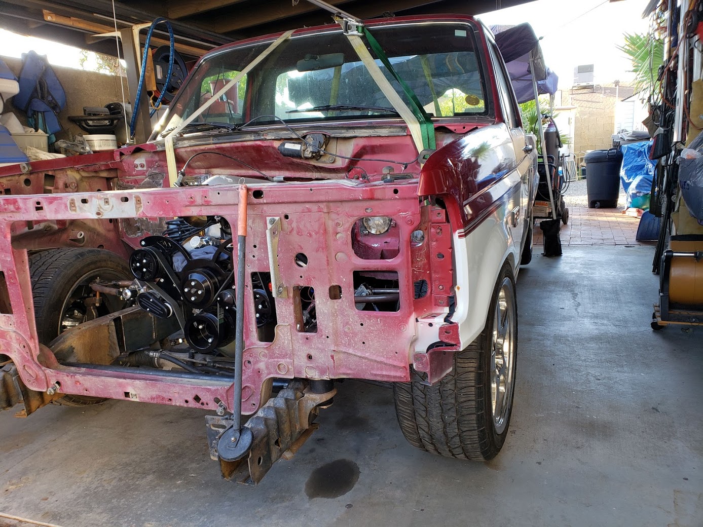

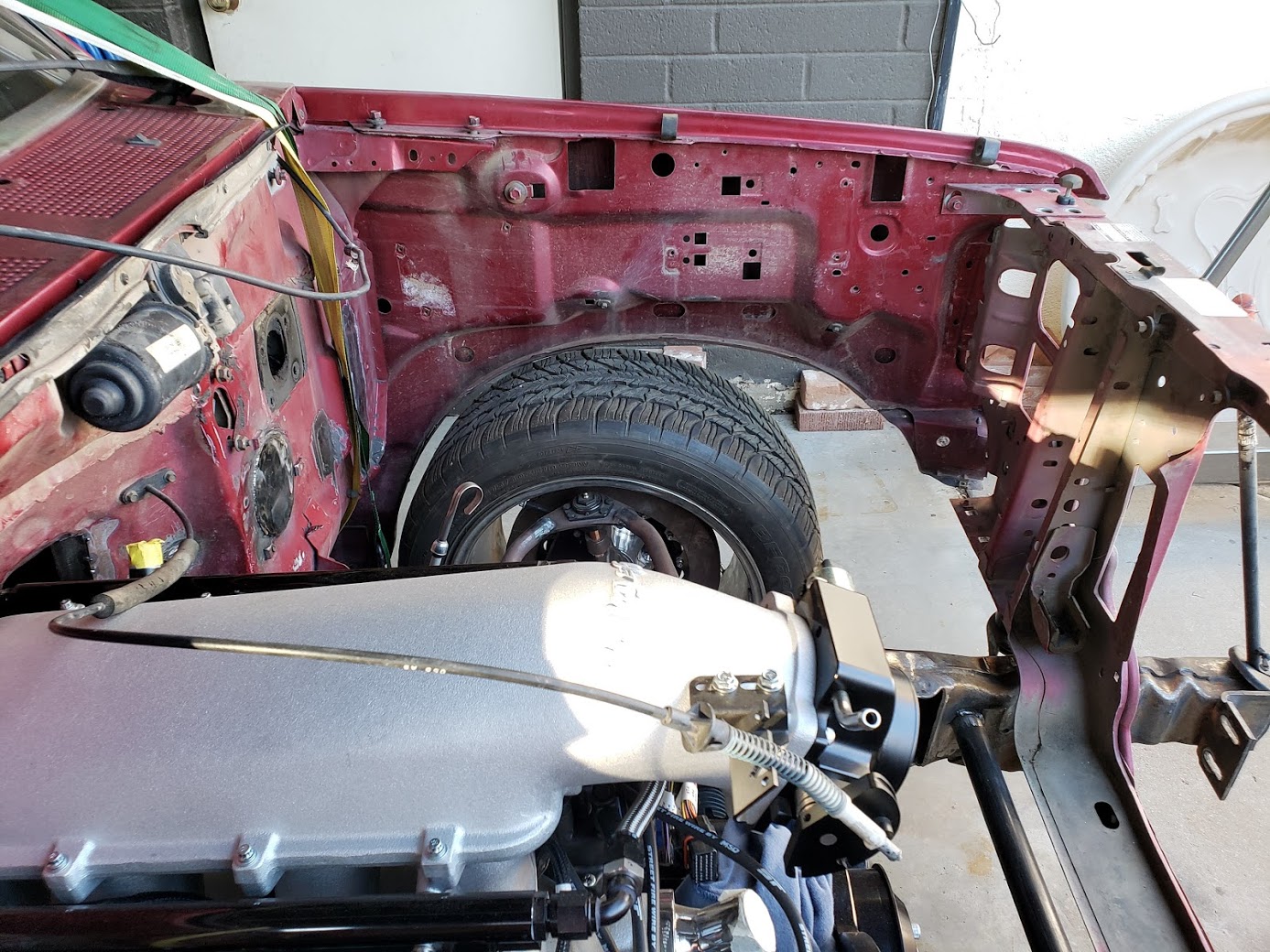

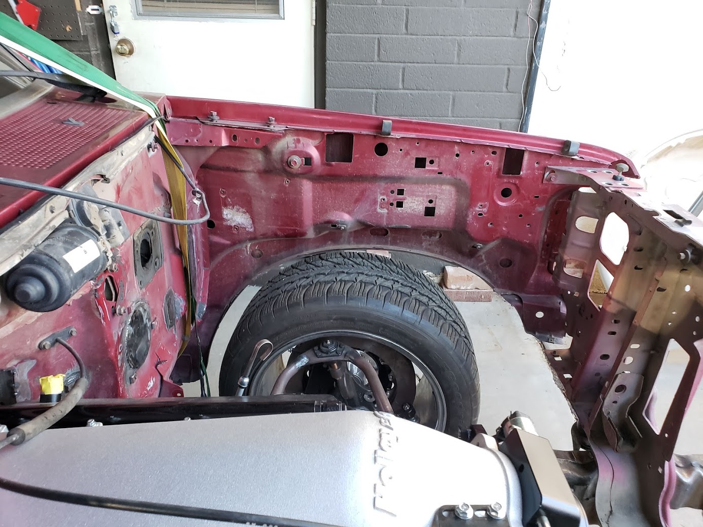

      So to measure my for the cage tubing and the start on that project the cab needed to go back on with the new mounts. The new gantry crane made that a fairly safe and simple task even by myself. The result was a first look at the real stance of the truck. Oh. My. God. I LOVE how this looks all low to the ground.
      So then I was really ready to get an idea of how it looks so I ran over and grabbed the core support and fenders. Forgot how heavy these are. Definitely something I'd like to remedy down the road. Here is the result:
      So now I'm so pumped that I'm calling my buddies and texting everyone pics to show that I'm killing it. My idea is really coming together! Until I walk around the side of the truck and look across...

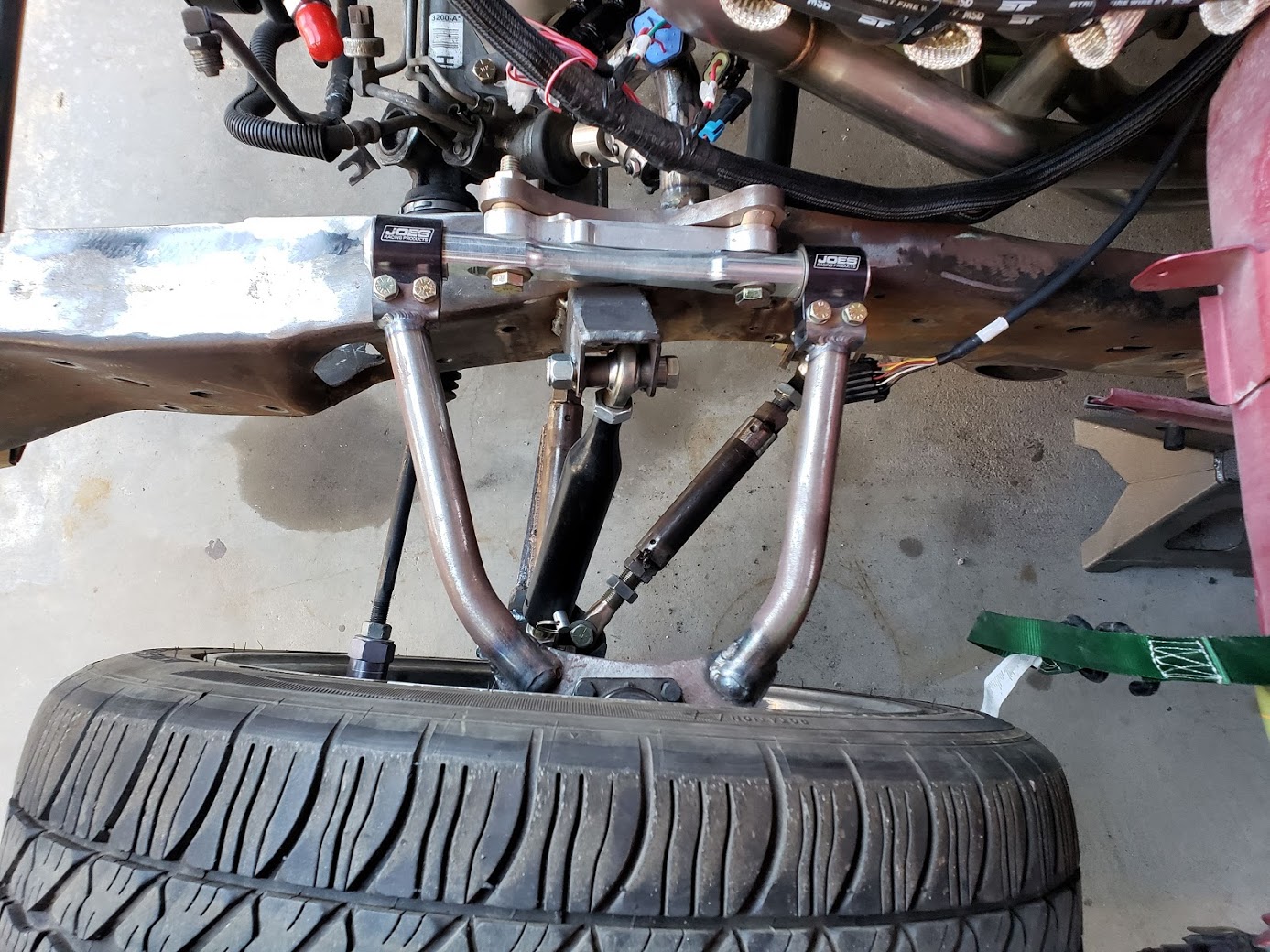

      Yup you see it right away too. Somehow I setup the entire front suspension too far rearward. After measuring, it was a whopping 3 inches too far back front the center of the wheel opening! I had a difficult time finding the original axle center line due to the TTB suspension not being symmetrical, but wow this is bad. So I figure I should see how much adjustment I really have in my lower arms (knowing this is not the right way).
      A little more forward, but not close enough. And then if you look down at the lower arm geometry it gets worse.
      So I walked away for a few hours to think it through and weigh options between cutting and moving everything I have forward or starting over with a new design. I spent this "thinking" time measuring for the cage tubes. Admittedly I am mad at myself for being this far out of spec, but I'm also frustrated because I've already built and rebuilt this suspension. I was so glad to be done with this task.
      Ironically, I have had conversations with some of you where I mentioned that I would do it differently if I was starting over now. Guess what....I'm starting over now. The best solution I can come up with is the leave the body panels in position and scratch build a totally different lower subframe with more traditional style lower A arms that will slide under the frame where it actually goes. I think I will also move to the same steering rack as No Limit, Mustang II, etc. which is out of the 80's Thunderbird. It is slightly narrower, cheaper, and mounts better. This way the entire lower will be built square to itself and I can simply measure and install where it belongs just like I did with my IRS. That worked so perfectly as a system. Upper control arms/mounts and spindles will be unchanged other than moving it all forward to match the new placement correctly.
      My design will be roughly based around the format of the C5/6 Corvette subframe since that's a simple square shape with robust mounts, but of course it will all be built by yours truly. So if you have a suggestion, idea, or tip speak up quick because now is your chance to chime in and help. I've been ordering parts already hoping to not lose much time to this. I'm getting it right this time damnit. Lance even let me coerce him into coming by to talk it over with me. I feel more confident about the basic design now. He also provided some good pointers to help with packaging everything better while making sure each part is adjustable.

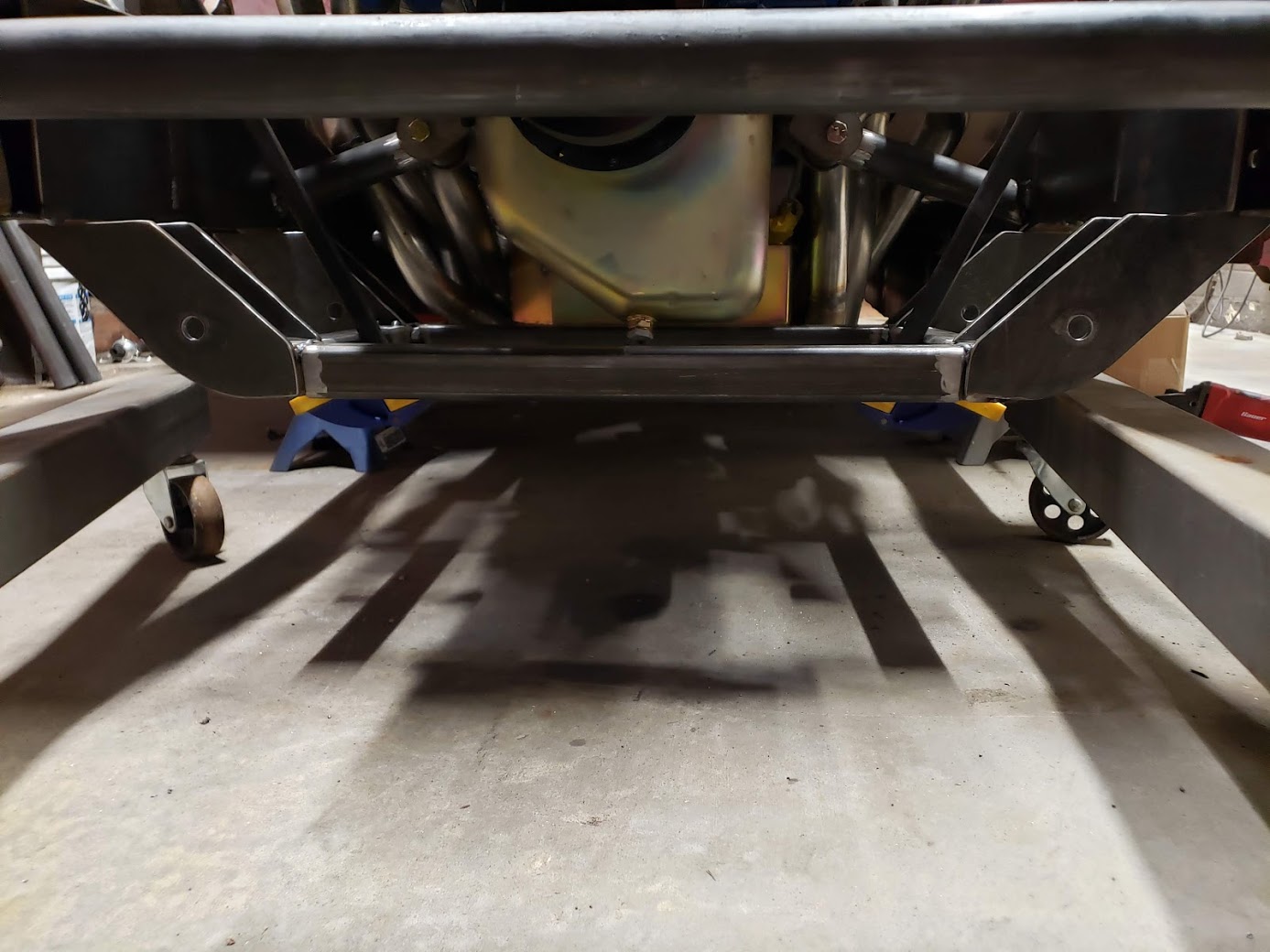

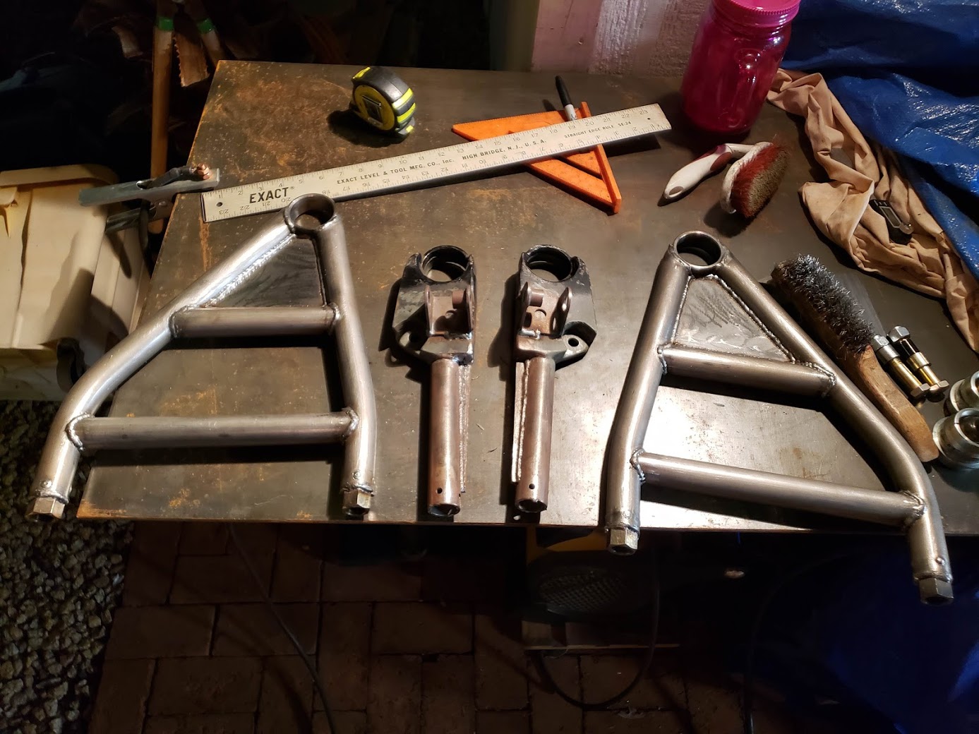

      I've been staying super busy trying to knock out this newest front suspension. As annoyed as I am that I can't move on from this task yet, I am really liking the new design much better.
      It all started with me seeing some of the builds on here that utilize the C4/5/6 front suspension. I like how simple yet effective it can be. Since I want the front and rear to match in width plus I have specific wants in clearances, I of course opted to build the entire system myself. Still not sure if that's the smart choice at this point.

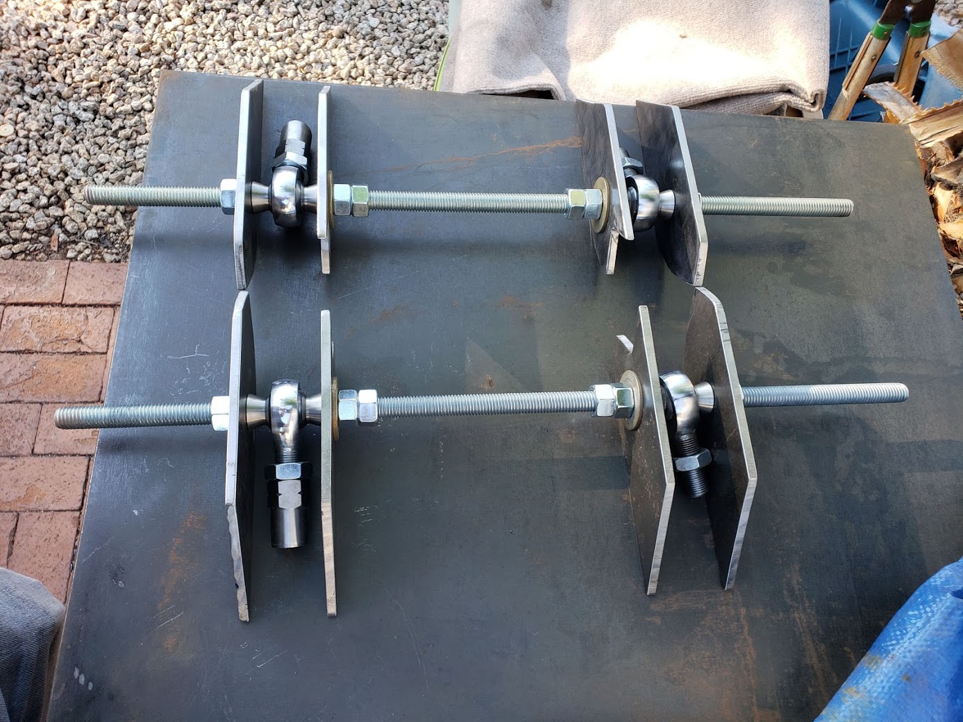

      Never deterred by my prior mistakes I laid out a very rough design on what I would be going for and texted Lance that I wanted someone else's input before I do all this work.
      So that's all he had to go on when he arrived in Digital Barney the next morning. We had a solid discussion about a few ideas and things he felt I should include or at least consider in my design. It was SUPER helpful.
      Then I dug out the plasma cutter that my neighbor still doesn't want back yet and used my CAD pieces (cardboard aided design) to make all 8 uprights.
      And after that couple hours of cutting and grinding we get the desired result

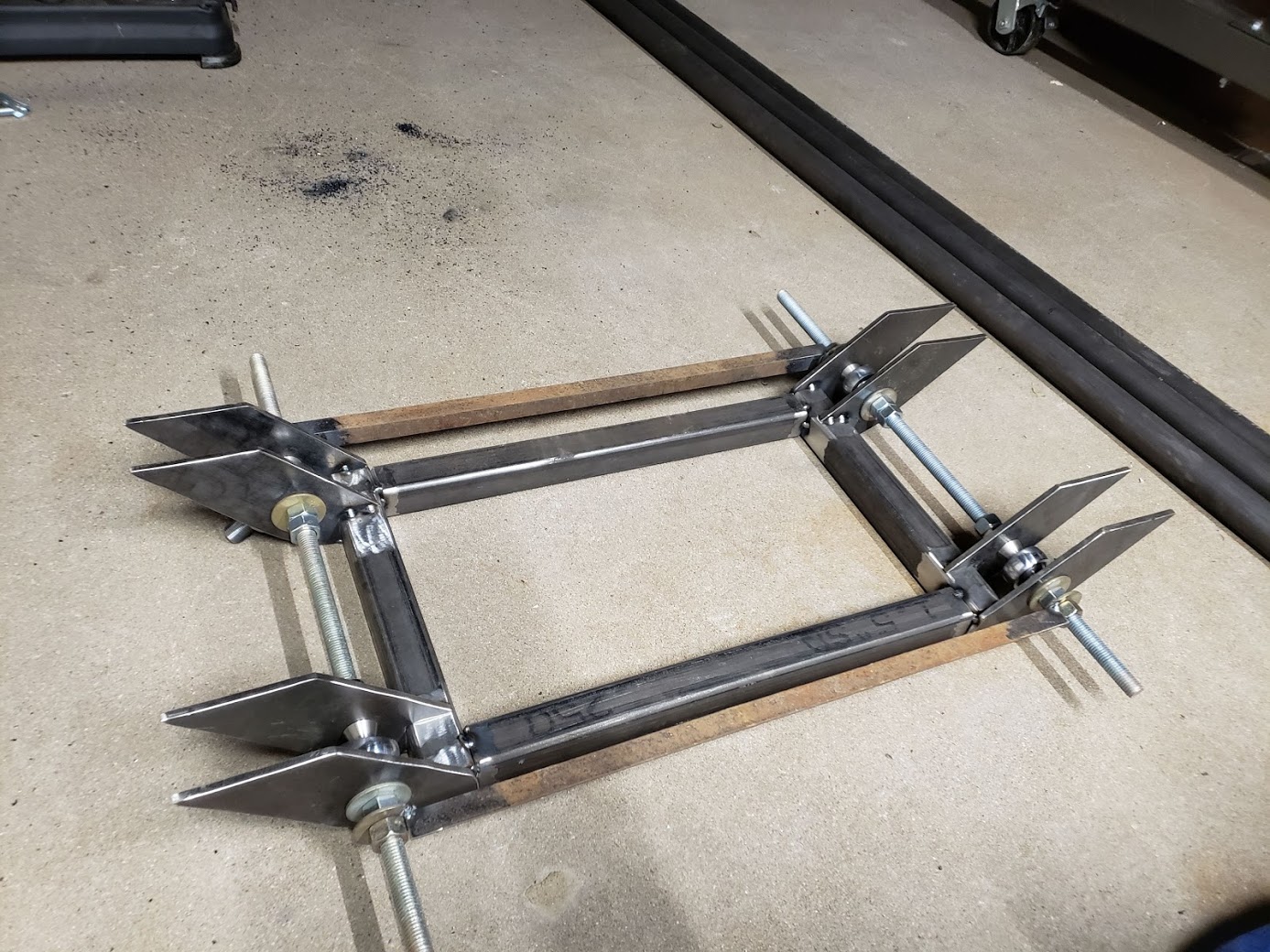

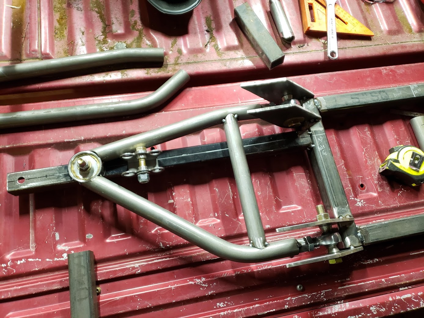

      Then I lined them all up in order with the heims as spacers since I want this to all fit super precisely. The all thread guarantees no binding along the pivot axis and made alignment of the plates a breeze.
      And finally I tacked everything together nice and square. Those rusty rods on the outside are exactly the width that I want my pivot point. They are just temporary to ensure that everything is perfect. We definitely do NOT trust my measurements. Haha
      That measurement was due to the change in steering rack. Which was something I talked about way back with my original design. Seriously worth it. So much cheaper to replace than the S197 rack and readily available. From my research this is apparently the same rack used in the decent Mustang II setups, No Limit Wide Ride, and a few that looked like good designs from other companies. It is 6" narrower than the old rack so now was the time to make the change.

      After that was tacked up and I checked to make sure everything was still accurate I was ready to attack control arms. We want 67.5" for the width between where the wheel sits against the rotor hats. You'll see an additional hole there from when I forgot that the spindle does extend past the ball joint pivot (I was tired that day). I used the new sub-frame as my jig since it already has the arm width set. Worked perfectly.
      Then I added some plate in the middle and 2 supports which should ensure that these arms are rigid. Seriously...they are way beefier and almost identical in weight to my last arm design. You can see how much different this is. I think we can all agree that this was a good setback.
      I did get the shock mounts added too, but must have forgotten to snap a photo. I wanted them to cool overnight so I can paint them tomorrow before they rust. No, I didn't add the sway bar mount yet, but I have no idea where it will end up. So rather than dealing with rust, I'll just grind off the small section of paint when I weld those on and repaint once it's finished.
      One issue I need you guys to help with is my Tie-rod adjusters. I can't find one off the shelf that is long enough with the correct thread on each side. Can one of you whip one up in aluminum or point me to someone/company who can? That's my only stopping point before this new suspension is 100% done.

      Yeah now that I'm seeing the new setup come together I'm excited to see it completed and I'm definitely liking it all better. This was something that probably did need to happen anyway.

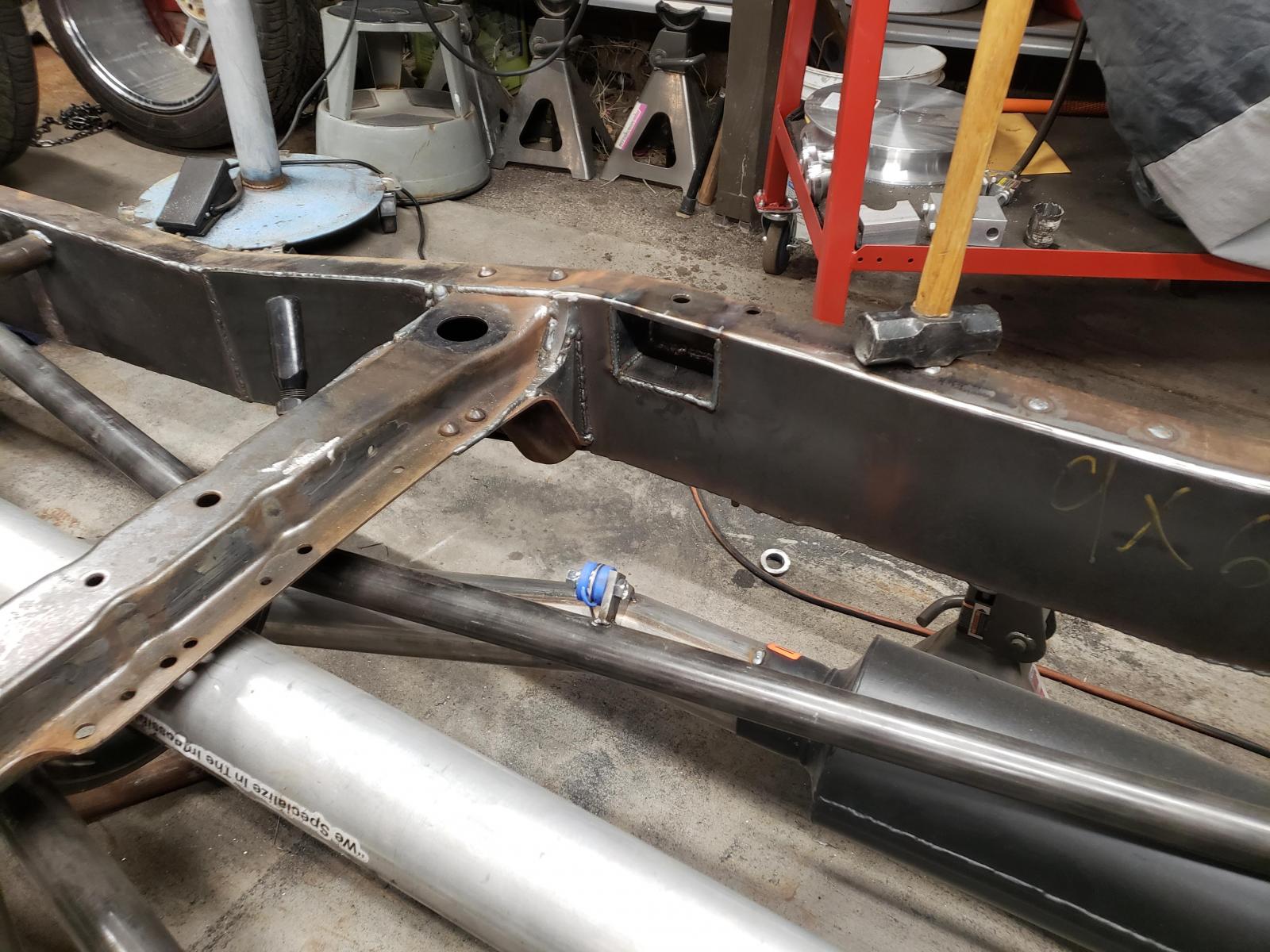

      Speaking of that, yesterday I moved the motor mounts up to the frame which allowed me to cut out my V1 cross member. Poor truck looked so naked without a front suspension. I was able to roughly test fit the new subframe.
      Yes it hangs lower, but is still an inch higher than the lowest point of the frame. The control arm mounting holes are 1/2" higher than before for better roll center at ride height. WAY more clearance around the oil pan now. I did cut the plates so they extend to the inside of the frame. I am going to use that to help with eliminating flexing of the frame rail under load after this is in. There is a plan.
      If I had started with this, I would have mounted the engine about an inch lower, but I'm not changing all that now since I'm happy with how the drive train is placed. It's already almost 2" lower than stock anyway and I'm not about to redo the headers/exhaust again.
      I'll do my prep work on the bottom of the frame this evening and get ready to really mount everything in. The control arms were painted yesterday and will be fully cured Tuesday afternoon. I'm so excited to see them assembled! Still trying to find a solution for my tie-rod adjusters. I might make a super simple version just for install purposes out of nuts and tube.

      How will your steering linkage look? Also what is the width between your lower control arm mounts ? New revision looks great!
      Oct 2018
      Phoenix, AZ
      583
      Quote Originally Posted by Peter Mc Mahon View Post
      Just like any other power steering rack with the standard inner tie rods and the Female adjuster sleeve connecting to a heim at the spindle (same layout as I had before with all new components now). Basically a straight line like any bump steer kit. The sleeve allows really easy toe adjustment.
      Width of the inner pivots is 24.25" on center.
