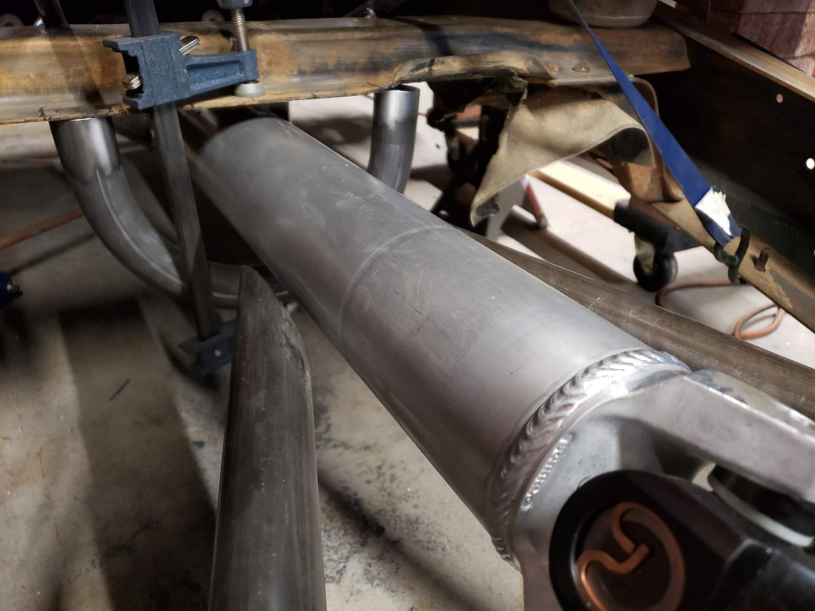

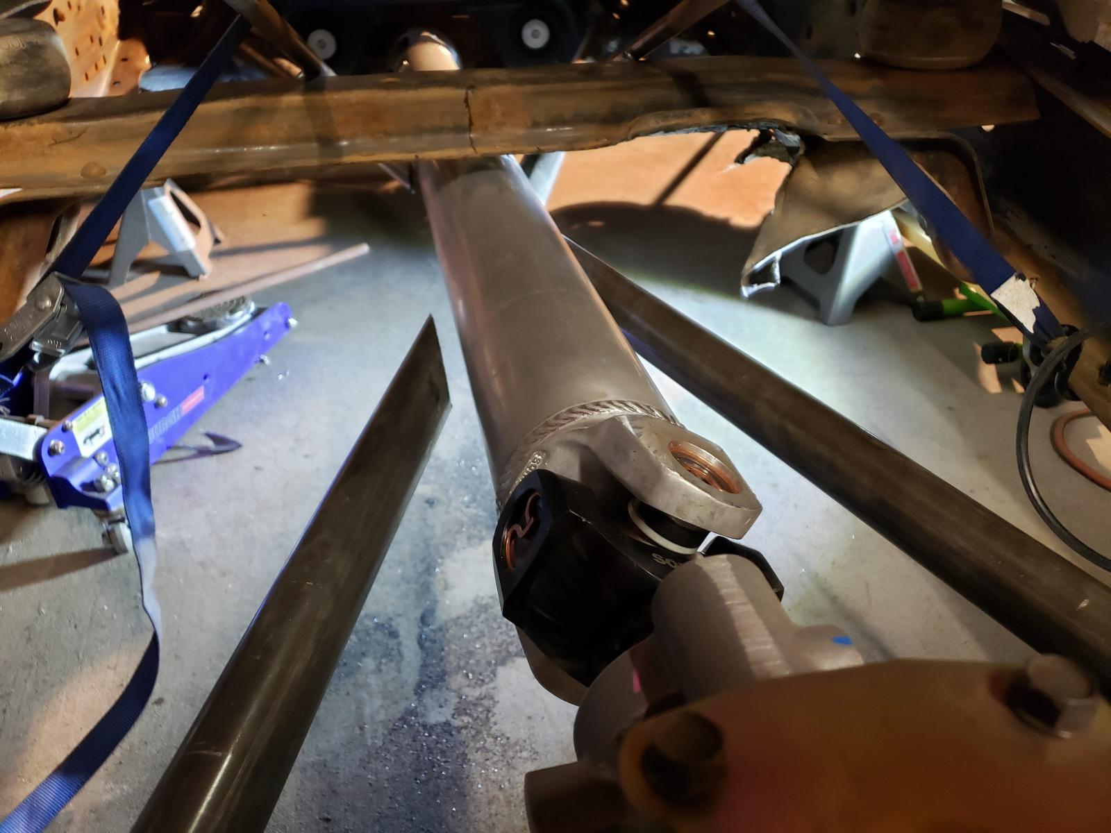

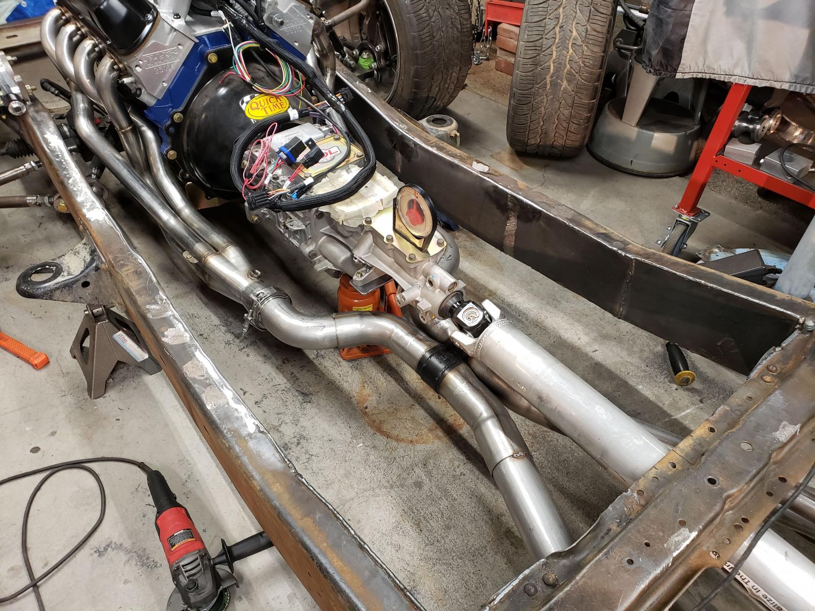

      Not a huge leap forward, but there is a complete drive line in the chassis now. This is definitely the confidence booster I needed. Almost kinda makes me sad to have to go out of town while I'm making good progress.

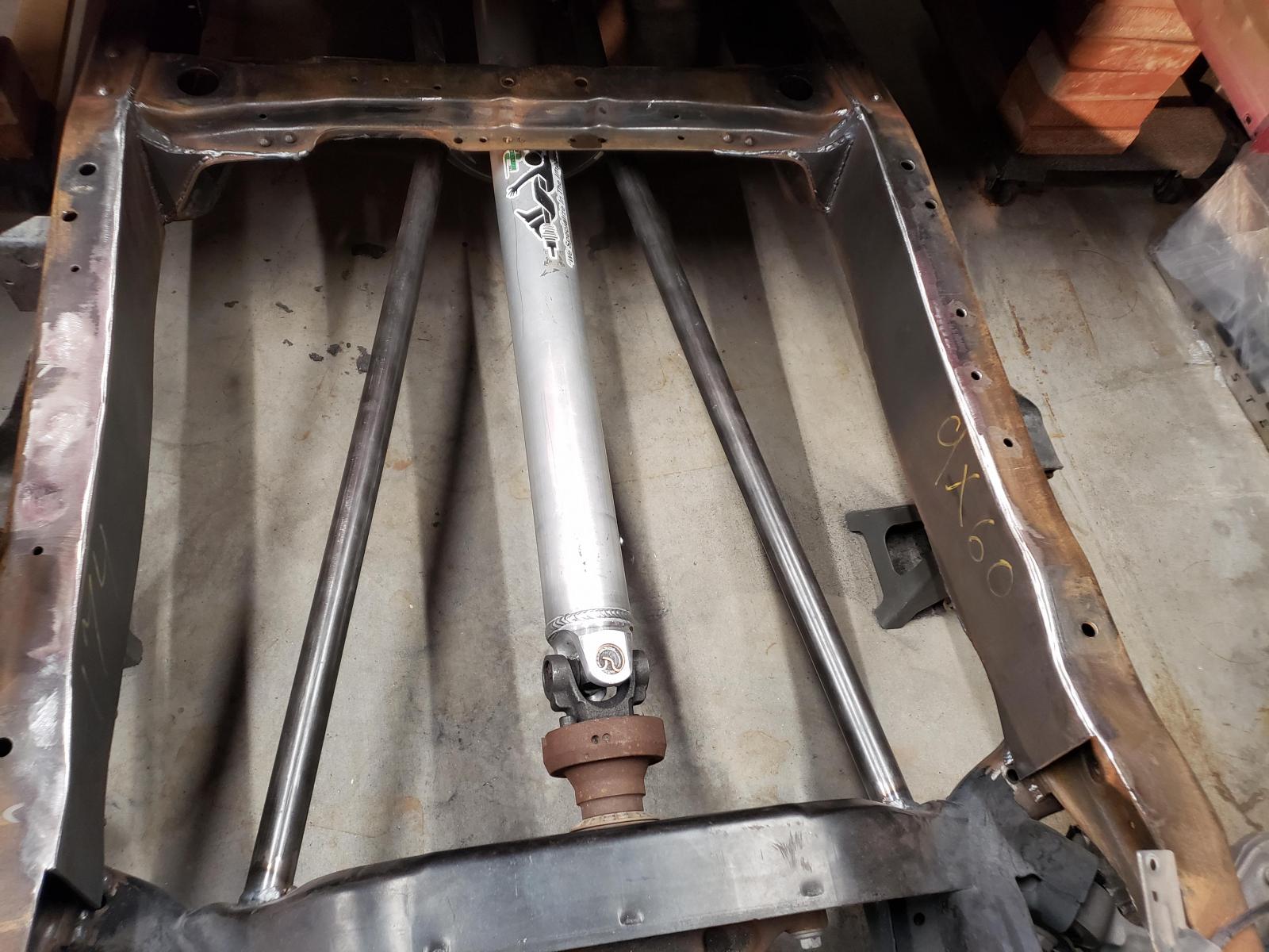

      First I trimmed the X enough for the driveshaft to slide home

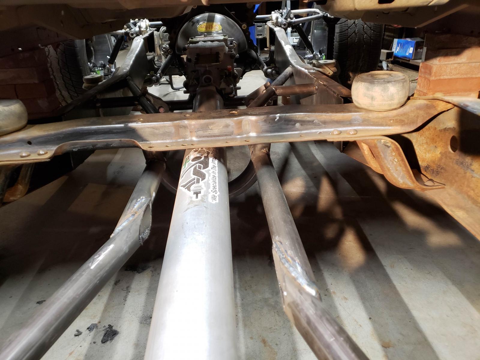

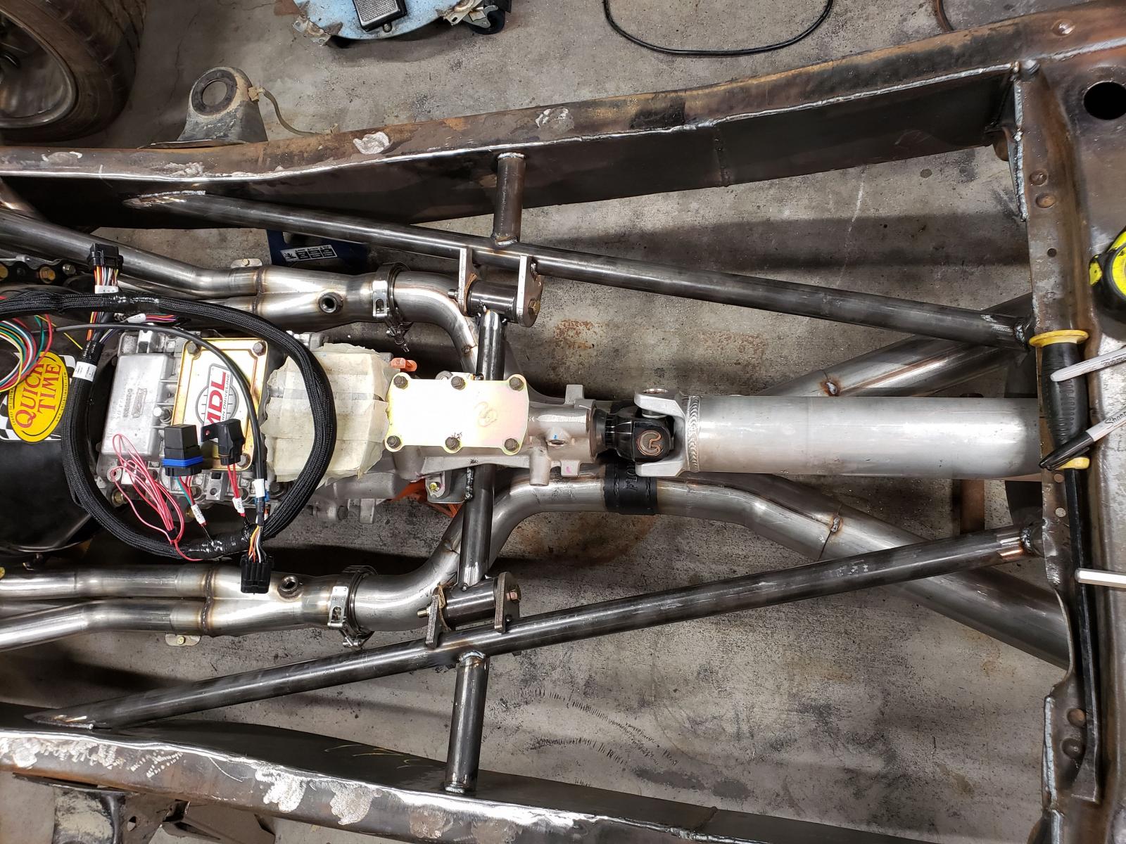

      Then I bent up and fitted my loop to the existing cross member that supports the cab. That Rogue Fabrication M600 bender is so easy to make something like this. I actually bent that flare up on the cross member, but forgot to take a photo. That was for the front factory fuel tank.

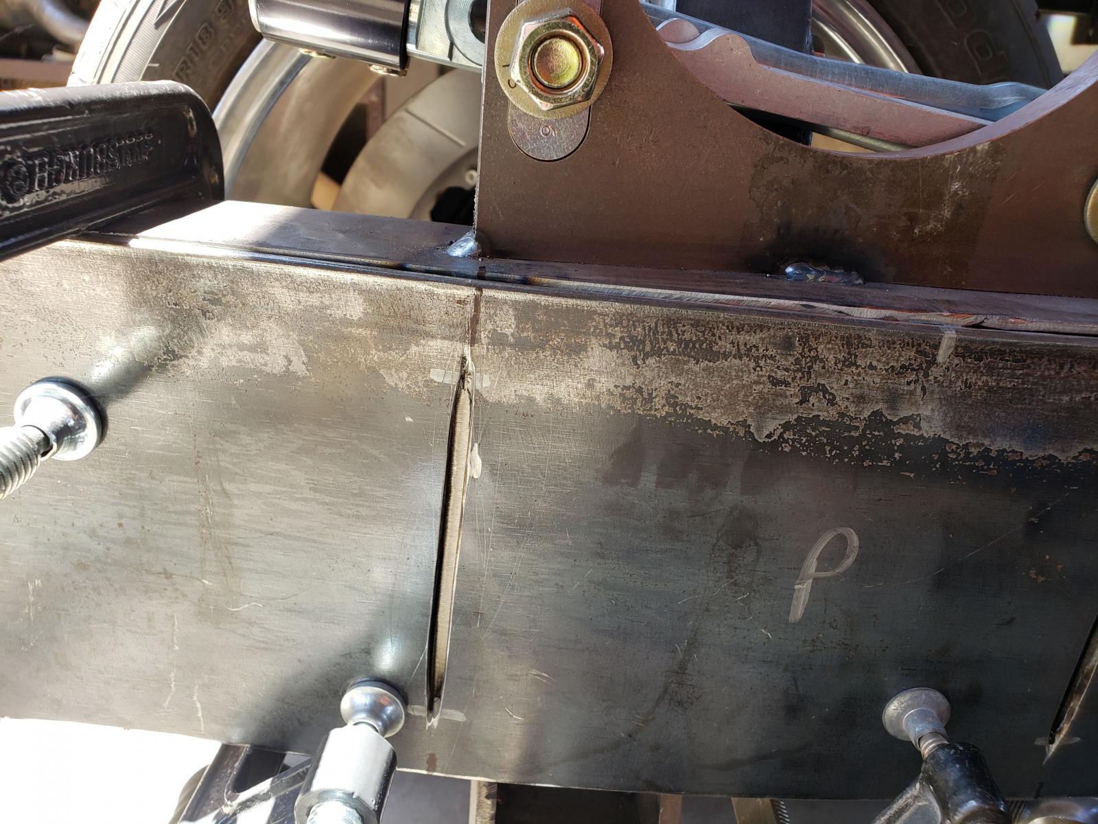

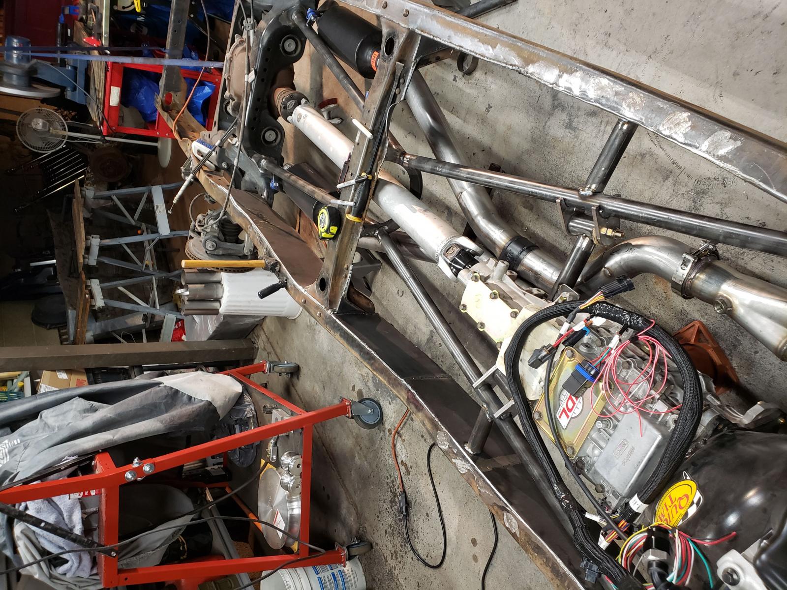

      After that I cut tubes to tie the X back into the loop which made everything super strong again. It's actually stronger than before since there is support in the middle now. I won't go much further than this with bracing due to space limitations, but just putting a jack under one corner of the frame, I can feel a huge increase in stiffness.
      I think it all fits perfectly and looks pretty great too. I most likely wouldn't do it this way if I was doing it over again, but this will work totally great. Yes, I will cap off each tube. It will just be easier to do after I remove everything.

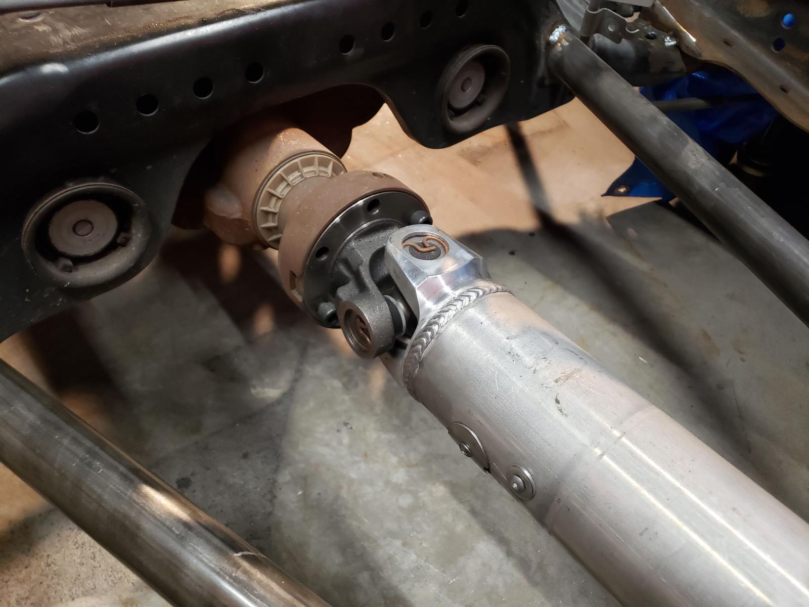

      Also thought I would show the diff side of the driveshaft. I originally wanted the same CV joint that is on the stock mustang drive shaft, but DSS recommended this flange they make since my TKO already has a slip yoke. A CV would let the driveshaft float back and forth. I have to say, it fits flawlessly and they even included bolts. Funny how many parts I have gotten that don't have the hardware. The hardware dept guy at Lowe's knows me now because I'm always looking for grade 8 bolts. Haha

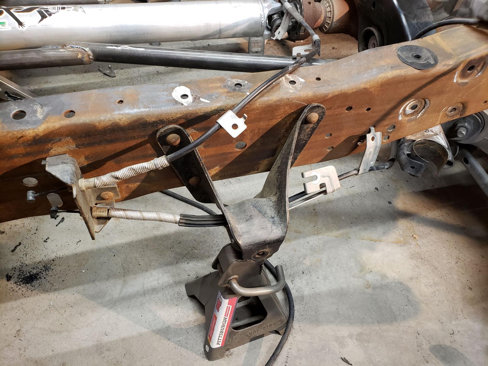

      I also noticed something else while working on the back half last night. The OEM parking brake cables routed through a bracket just under the driver's butt on the frame. The mustang cables actually reach over there easily so I might try to adapt it to the stock E brake setup. It will fit easier once I cut the leaf spring mounts off, but they are doing great as jack stand mounts right now. Funny all the little things you never think of when you start a project like this.

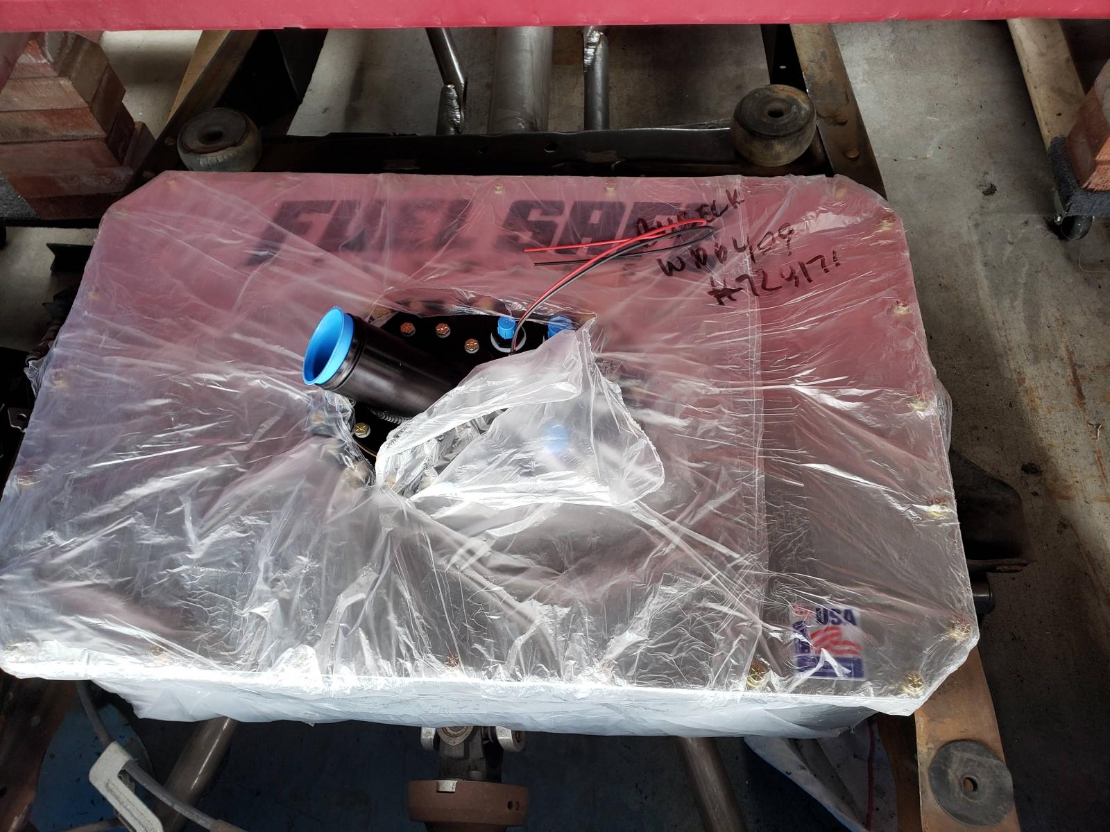

      This was all to prep that section for making a home for my fuel cell. It will live at the front of the bed, 2 inches above the driveshaft. Yes I am making a plate to protect the bottom from any potential exploding shafts.
      I went with the aluminum can, 18 gallon, and internal 350LPH Aeromotive pump. It's supposed to be good for up to 700hp on E85. Only weighs 45lbs with no fuel in it!

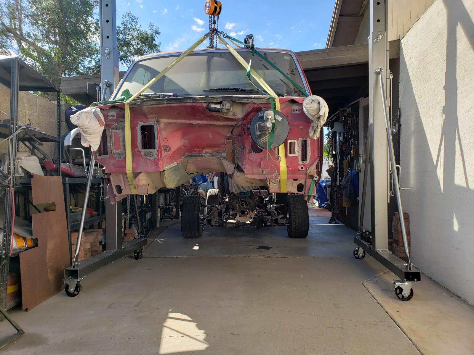

      The biggest thing I did was buy a gantry crane. Some of you may have noticed that The cab has been suspended above the frame held up by bricks on furniture dollies. It's kinda sketchy, but the best I could do working alone at the time. The cab has always been in my way and I didn't have room to try and use my engine crane to lift the cab. I should have bought this crane months ago!

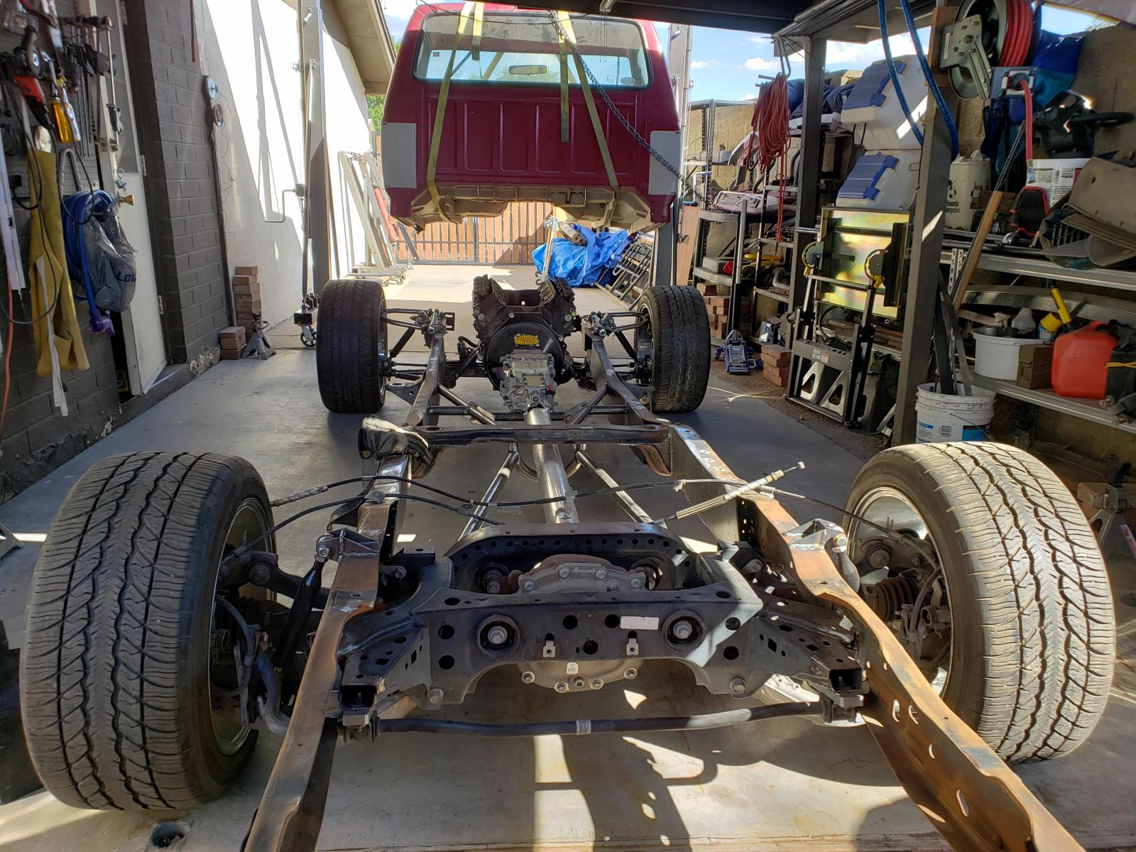

      Oh yeah....I made the frame a roller. That was a cool moment to see it support it's own weight after all these months. One main issue that popped up if the front frame rails need A LOT more support to take the suspension loads. It was flexing just under it's own weight.

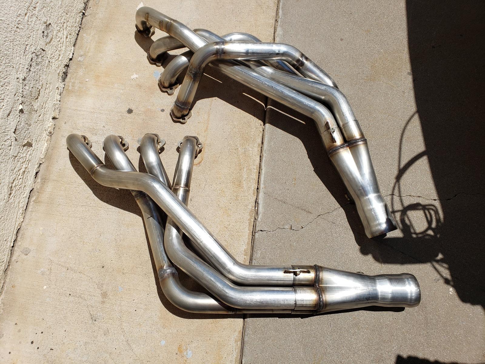

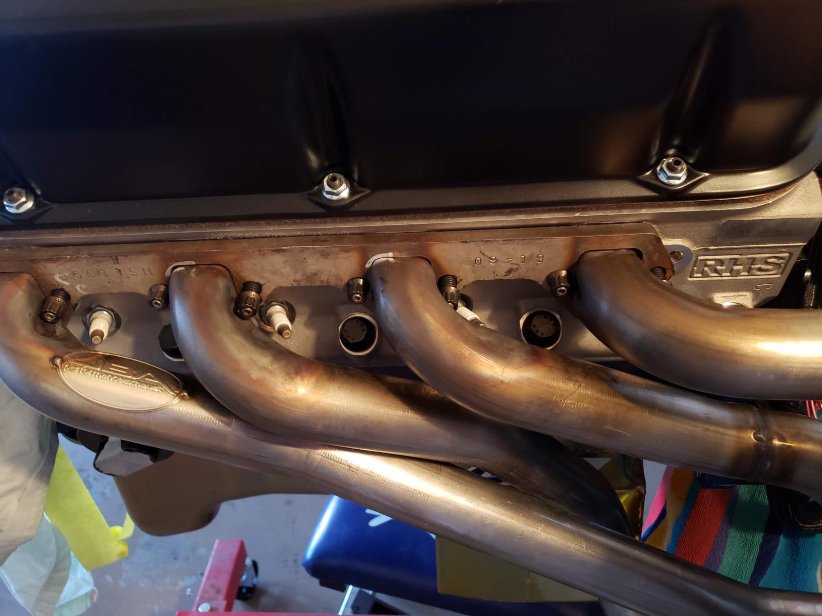

      And the last update for this post is another failed attempt to buy premade headers. This has become a frustrating part of the process. See the issue?
      I have no idea how anyone would ever get a spark plug wire in that area. Everything else about these headers is actually pretty fantastic, but without spark none of it matters. So I suppose these go back and I just have to modify the first set I got since that vendor refuses to respond to anything.

      What is your IG handle? Link in your sig appears to be broken. I've been missing the truck updates lol
      For the SBF some heads here designed with straight plugs, some were designed with angled plugs. Those heads look like they are the "angle" plug type similar to a GT40P head like I have on my Rustang (unless the pic angle is throwing me off), and I'm guessing the headers were designed for "straight" plug heads. Here's a link with a pic showing the difference: https://www.explorerforum.com/forums...estion.417681/
      That might explain the issue with the plug clearance. Certainly worth looking into, but I think you're going to end up modifying/building your own headers due to the application. Both of the cars my family has built ran into header issues. Our 69 Torino with a 351 Cleveland in it took two sets of headers cut apart and rerouted to clear the steering components, and it still is tight. On the other hand, our Chevelle with a 350 SBC we thought we were good, and they managed to screw those up too and we had to modify them.
      The only headers I've never had to touch were the ones I put on my Rustang, and they were designed by Ford so that explains why they actually fit.

      You are right that these heads have angled plugs vs the stock heads having straight. Oddly enough, I feel like straight plugs would fit far worse with these headers. They are nicely built for a great price, but I need spark to run. Haha.
      I talked to the header manufacturer earlier today and the tech was like "oh yeah those never work right with aftermarket heads." UGH!!! It doesn't say that anywhere in the description. So yes, at this point I'm going to be modifying the first headers I bought. Why am I cutting up $1300 headers instead of something cheaper you might ask? Because the vendor (thankfully not a sponsor here) has not responded to any form of communication I've attempted over multiple months. So if I'm stuck with them, I'm gonna just make it work.
      I have both modified and scratch built headers before so you'd think I wouldn't be so resistant, but it's so time consuming and tedious that I just want to bolt some on and keep going. This project has taken much longer than anticipated so I'm anxious to get onto more interesting tasks. I have also been to the dyno and seen first hand how fast craptastic headers can kill 30-50hp. I refuse to choke up this expensive of an engine and I want this thing to sound mean too.

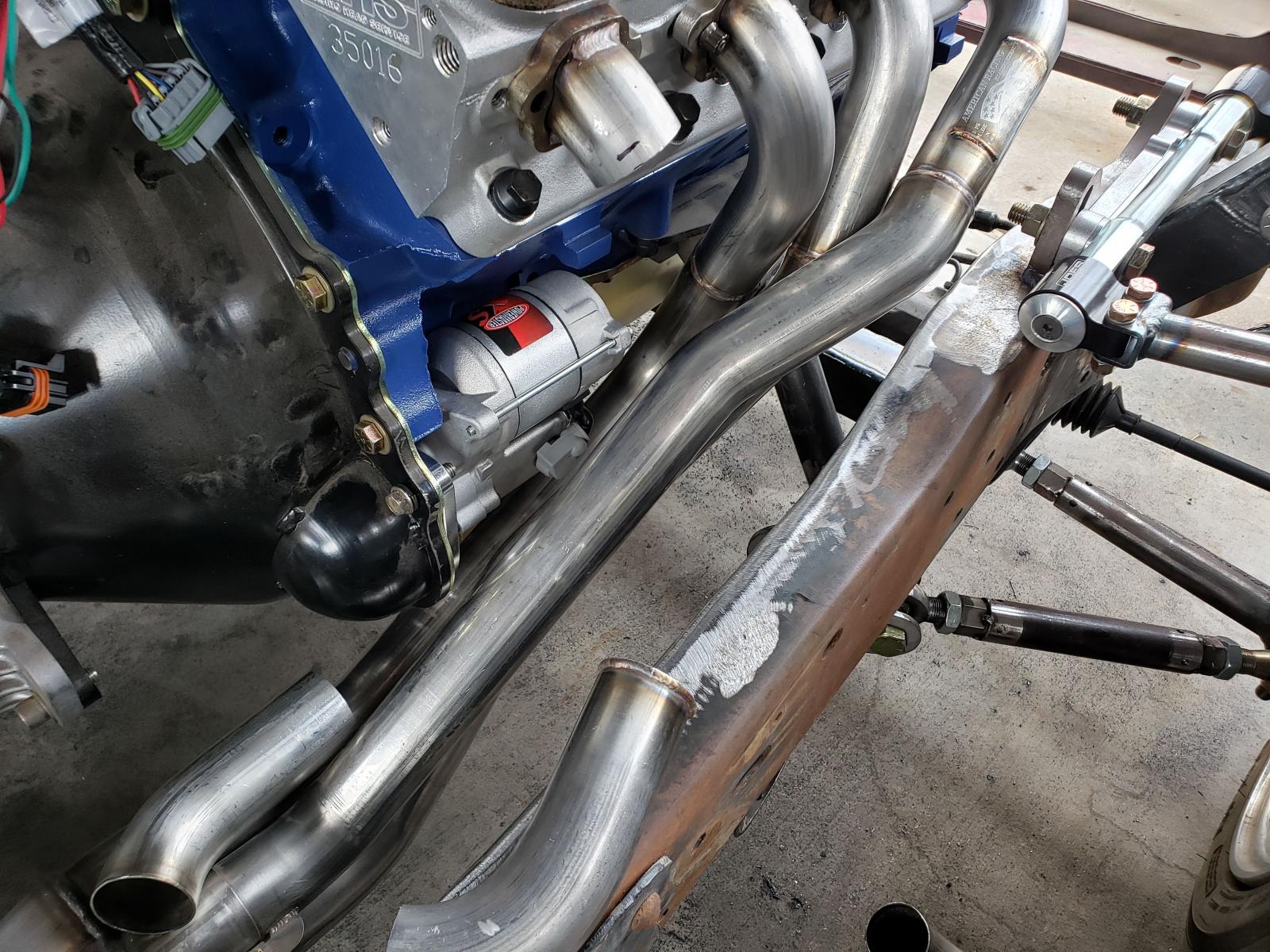

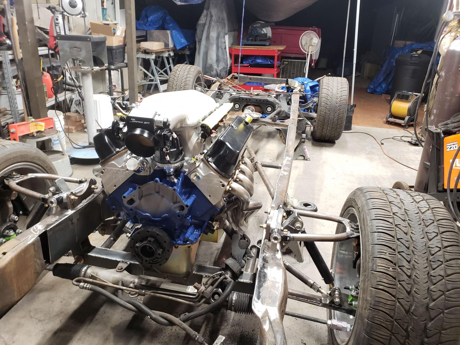

      This weekend was a fun one for this project. I'm feeling more like I can get this running sooner rather than later for sure.
      Got the actual engine in for the first time. So think about it. No more mock up parts...this is all the real deal from engine to drive axles. And it all fit perfectly! Plus it looks like I can kick the bottom of the radiator toward the engine to better encourage airflow, but we will get more into that in a couple weeks or so.
      Looks like it was made for it. Oh yeah...it was. Haha. Before the engine went in I did the last set of boxing plate on either side of the motor mounts. This will help the frame not flex so bad and give me a good sport to add more reinforcements to the engine and shock mounts. You can see in the first photo that I added 1/4" plate reinforcement inside the frame rail before I covered it. I'm hoping this further encourages everything to hold it's shape. In order to connect the new plate to it I made some slots with the grinder and then just welded it up. I'm super happy with the end result.

      Once all that was done and the engine installed I finally cut up those headers. First cut was kinda painful to do, but once I got over it the rest was business as usual. One bright side to cutting up expensive parts is that it's a good quality material to work with so I suppose that is the silver lining. By modifying only 1 tube on each header everything will fit perfectly.
      I have to admit that I'm totally confused how these headers are expected to bolt onto this engine even without my giant oil pan. I even have a more compact starter and it's right where a tube used to be before I cut it to reroute! Fortunately these were done with a slip-on collector so that's making this much easier than normal. I did have to order some additional tube to complete the job so I'll do other stuff this week while I wait. I also ran out of welding gas (again). Hopefully I can pick more up today.
      The list of tasks left before the frame is done has shrunken considerably. I'm down to fuel cell mount, couple of filler plates, finish weld the rear subframe to the main frame, add a few reinforcing tubes, flip to weld the bottom, and paint. Sure that will take some effort and time, but I can see the light at the end of the tunnel.

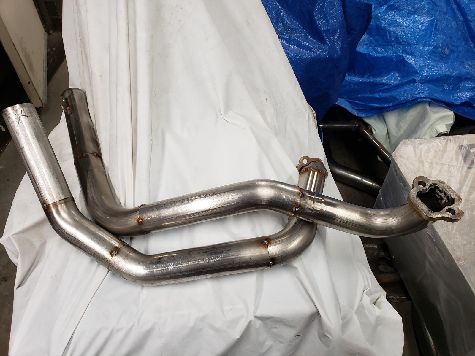

      First up was to TIG my two modified header primaries. Honestly, I've been putting this off. Now that I have finished I'm laughing at myself because it really wasn't that bad. Lucky for me, these came with a slip-fit collector so I could tack everything together and then remove just that tube for welding. Then insert and install right after. Piece of cake (no really, I literally treated myself to cake after this).
      This:
      To this:

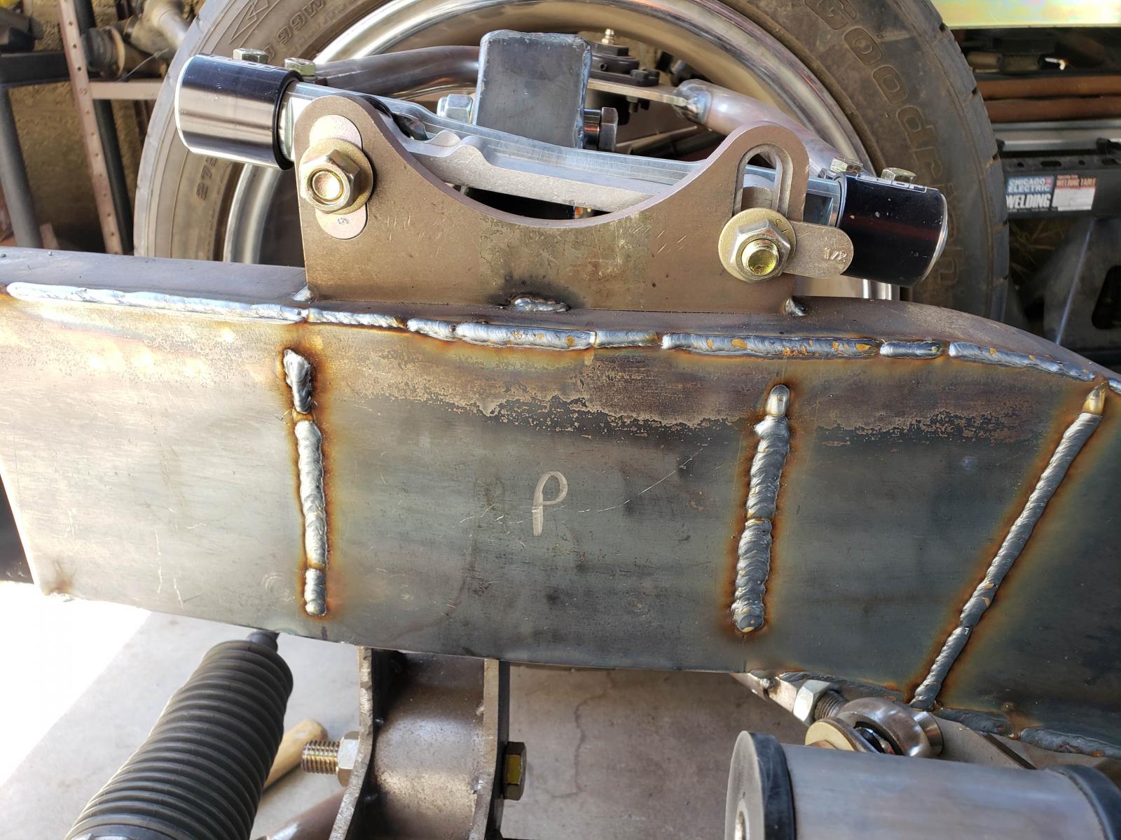

      I am wayyyy out of practice with my TIG welding and that's even more true for this thin stainless. I used to knock out a full custom race system in a day with fairly pretty welds. These were....well it will hold and not leak.

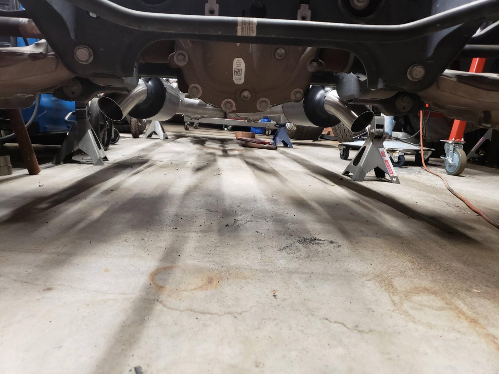

      Once I bolted those on with gaskets (24hr Autozone 2 miles from home is legit), I decided to keep rolling on the exhaust and do the rest. I bought a universal 3" 304 stainless kit from Flowmaster when I got my mufflers. I chose a pair of their Hushpower Pro Shorty series mufflers. I've run the Hushpower series on multiple vehicles with multiple engines and I generally won't run anything else. It's extremely effective, but makes killer sound and power with a small package. I'm using univeral stainless hangers from Summit.
      I orginally wanted to do a side exit just in front of the rear tires. After looking at the frame vs bed side position I scrapped the idea. Just too complicated to make it look right and would end up routing hot exhaust tubes next to my battery and fuel cell. So thanks to the wonder of Amazon Prime same day delivery, I had 2 45's delivered that dump off the mufflers at the front of the rear suspension. Light and simple.
