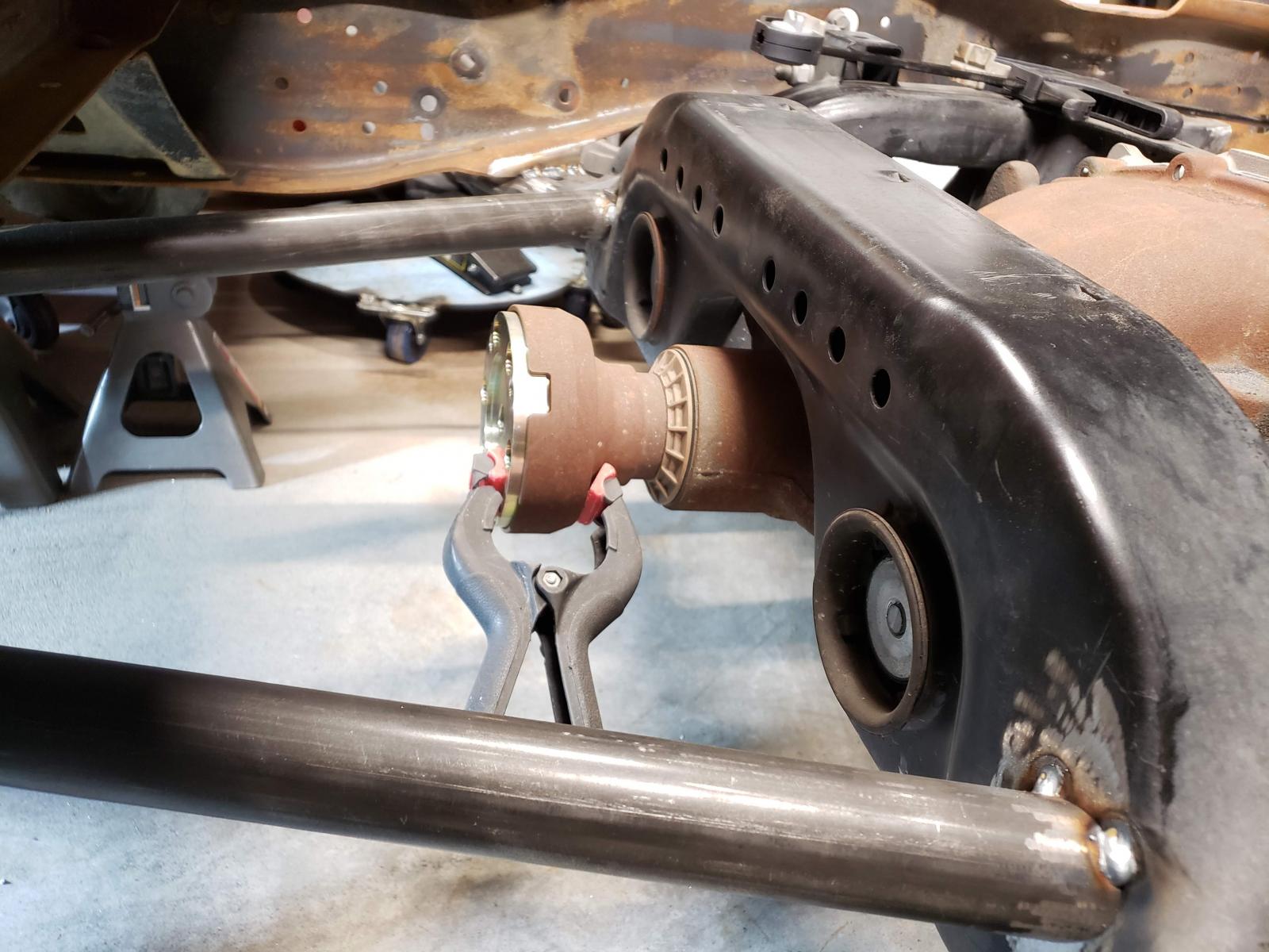

      I owe you all a weekend update as usual.
      Nothing huge, but good progress. I will drive this thing before the summer!

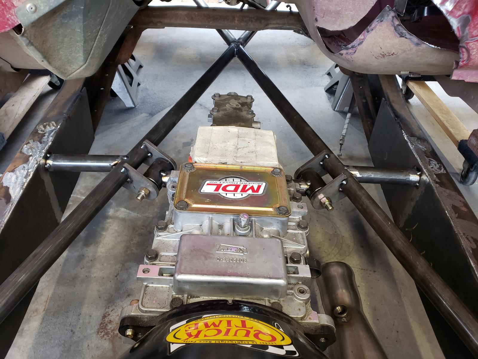

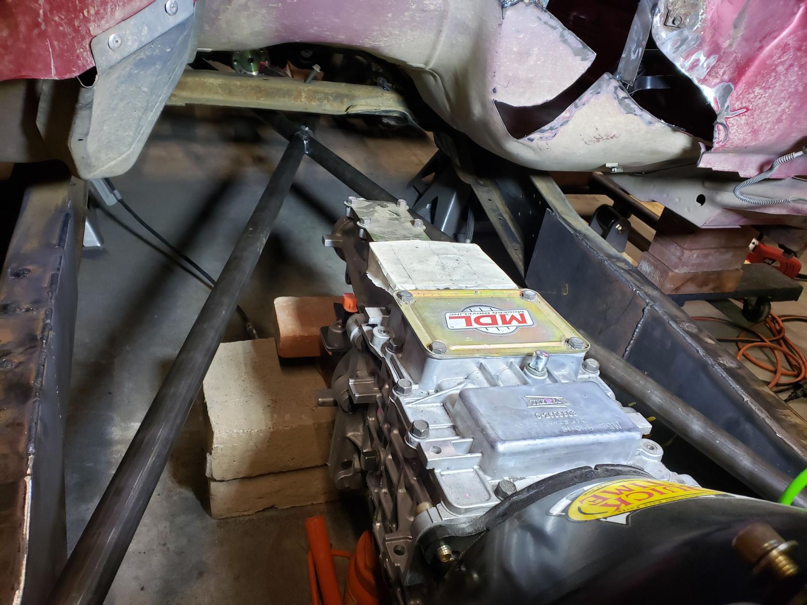

      First up was focusing on making a trans mount so the drive train could all finally support itself. After deciding not to run the tranny cross member to the frame last week I had to get some more boxing plate in and layout my main X brace for the chassis.
      You can see that despite stopping and starting multiple time (super awkward position for me) I am finally getting my neighbor's welder working decent. Still not sold on the inverter tech for heavy stuff, but beggars can't be choosers. Seeing the boxing plate in ended up making the frame just look nicer too. Can't wait to see it all cleaned up and coated!
      Got the X all trimmed and positioned. I'm already getting back to being decent at fitting tubes for this so the cage should go smoothly when we get there fairly soon.

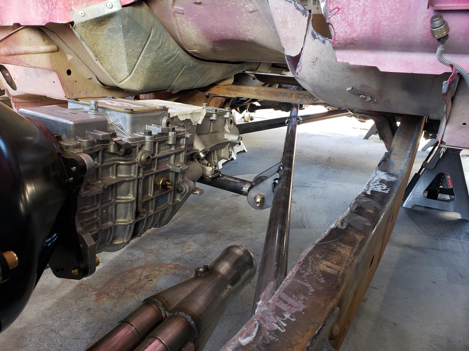

      Bricks still holding the trans in place but that was about the be no more...

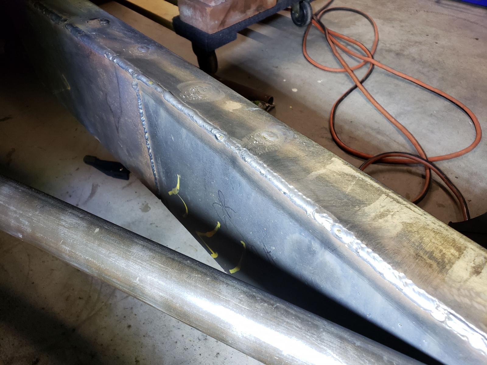

      That's some heavy duty steel holding it all up, but I wanted more side support and to also tie into the frame in more places. Plus we all know that triangles are the strongest shape.
      Then when I stepped back with the wheels removed I realized that this frame looks pretty wild and wide. And I might have been glowing with a slight bit of pride in my work.

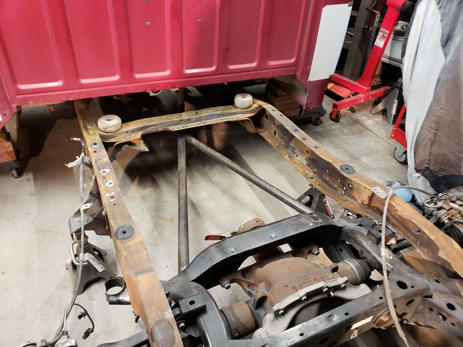

      But out back I needed to remove a riveted factory cross member that just sits under the bed, but doesn't bolt to it. It won't be needed and is really kind of in the way. Have I mentioned how much I hate these ridiculously tough rivets?! They are grinding wheel killers! Look closely and you can just see the tail of the trans in there. Driveshaft will only be about 50" total length. Now I just have to find a local shop that I can trust to build me one. Once that is in I can layout the fuel cell mounts. That's right. The fuel cell is going just behind the cab and as low as I can safely mount it with the drive shaft there.
      Since you guys are so sharp I'm sure a couple of you are already typing up replies to say that my X is in the way of the drive shaft. Yes, you are correct. I am putting a drive shaft loop there, but it was much easier for me to build it this way to line everything up better. It wasn't really any extra work. I'll just build the loop from 1/4" plate bent into a circle and cut the tubes to weld to the outside. It will make more sense when you see it.

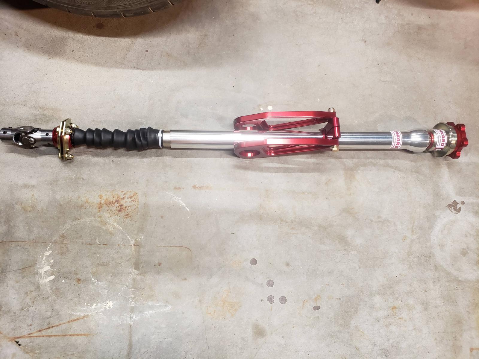

      Thought I should update on what's going on. It's been a bit of a waiting game, but for good reasons. Plus I was distracted by the Good Guys spring nationals happening in my backyard last weekend so of course I was there to steal ideas and get inspired!
      Against my better financial judgement, I picked the Racepak Smartwire Street kit for the chassis wiring. I've mentioned before that I really wanted to run a solid state PDM and this certainly covers that. Definitely not the cheapest option in that realm, but this is guaranteed to work with my Holley Dominator so that's what made me go this route.

      I also want to give Woodward Steering a BIG thank you for dealing with a FedEx failure. I caved about a month ago and ordered a steering column kit from them. Somehow it was delivered, but I never saw a thing. They shipped an entire replacement out within 24 hours of me notifying them and while they had a blizzard. Genuinely nice people and I'd use them again in a heartbeat. They aren't a sponsor, just really happy with my treatment.

      I want to thank NorthFalcon for pointing out an upper control arm solution that I wasn't aware I could get DIY parts for. Thanks to you and my incessant overthinking, I have a batch of parts due for delivery this Friday. I think you guys are gonna like it. That's this weekend's goal: finish that damn front suspension setup!
      Wallace MFG thanks for the tip on the CV type driveshaft. I am in the process of getting a custom one ordered. They are about 4 weeks out.
      Things are heating up boys!

      Tell me more about the driveshaft? Congrats on buying the good stuff. It's well worth it.
      I can't stand electrical issues so when there is a way to eliminate potential issues I am all over it.
      I had to work with Driveshaft Shop for a custom length setup. I was really hoping to find a local company, but they either couldn't/wouldn't source the CV end or more often just didn't have a clue about power levels vs material type. That concerned me greatly. So far my communication with Driveshaft Shop has been flawless and clear. I'm hoping to have my order completed in the next day or two depending on them.

      Feb 2014
      6
      To remove the rivets, center punch and drill through the head with a 1/2" drill. Then, punch the rest through the hole. I used this method on my '93 F-150 while building my crown vic ifs/3-link rear setup.

      Quote Originally Posted by lightningcow View Post
      Interesting idea for making less mess. How many drill bits did you ruin during that project? Also, how did you like the handling after all that work?
    15. #195
      Feb 2014
      6
      The bit was fine as I recall, but I can re-sharpen a good drill. I seem to remember the rivets being soft, so they would eat up a grinding wheel for sure.

      Phoenix, AZ
      583
      Yeah I'm burning up grinding wheels pretty fast even using an air chisel to help. I still have probably 20+ rivets to go.

      Mar 2014
      Mesa, AZ
      637
      Cut an "X" in the head of the rivet with a cut off wheel, then use the air chisel to knock the rest off. Gets the job done pretty well.
