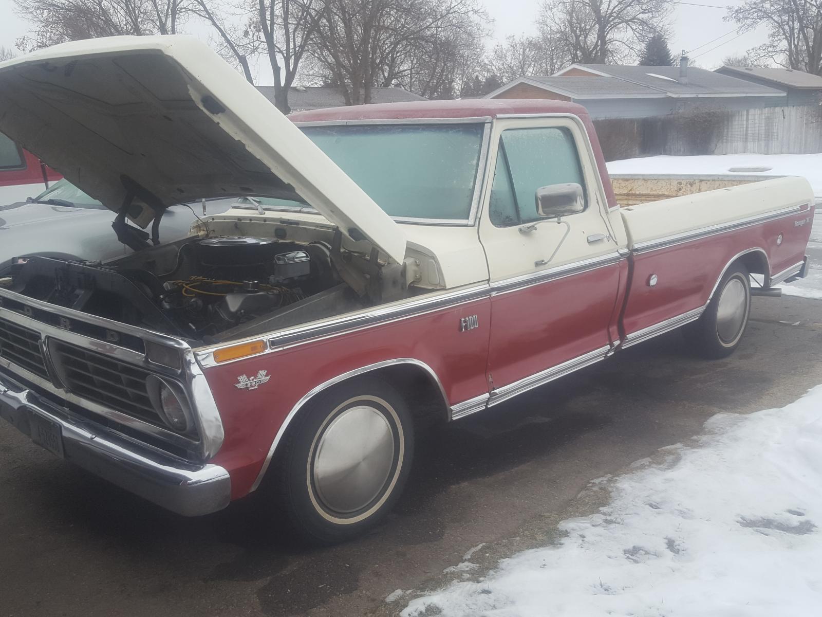

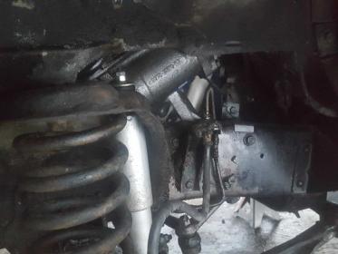

      Yeah, it's not really fun working in the snow, but things have got to get done. Everything went well except the aftermarket return line I bought wasn't even close to right, so had to make a new one of those. Never did get above 25 Saturday so most the day was spent going out and wrenching until I couldn't take the cold anymore, going inside and having a beer, then going back out and working again. Truck now steers like a car, actual lock to lock is about 3 1/4 turns. Pretty happy overall, and it's nice to get something accomplished on the truck even if it is just a steering gear.

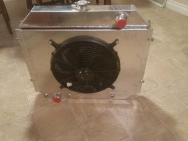

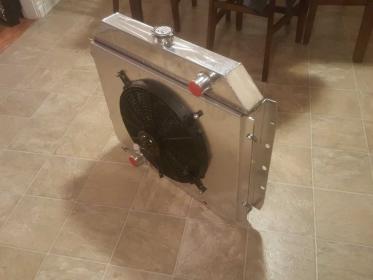

      More baby steps to a better truck......Got the shroud and fan mounted to the radiator last night while watching Barrett Jackson.

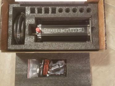

      FINALLY!!!! Crap, been waiting for my Command Center for 3 months now, finally showed up yesterday. If I don't go snowmobiling this weekend hopefully the beater will be carb-less.

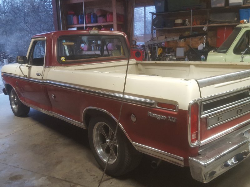

      Well, here's some proof that you can make these trucks work with stock type suspension with some geometry and careful set-up.....Took 1st in CAM-T both days, 5th overall on Saturday's autocross, 9th Sunday with a lot more cars. This is with lap belts, bench seat, the all terrain take-off Firestone Chevy 4x4 tires on back and factory Chevy Equinox all season tires on front. With some tires, everybody figures I would've been in 3rd Saturday and top 5 Sunday. Really need to find some rims for the Pilot Sport Cups I have sitting in my parts room, but I'm happy with it as it is.....Would it do better with an IFS and IRS? Sure. But you don't NEED to do those mods to have fun and be competitive with a '67-'79 Ford 1/2 ton like everybody says you do. Learning the truck and what it wants to do is the biggest thing. Hopefully my pile inspires other guys to try to make these work, because they're very cheap and readily available. You could be racing for under a couple grand if you find the right truck.
