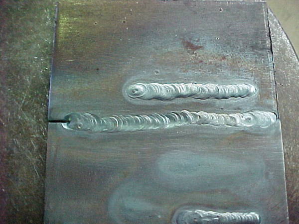

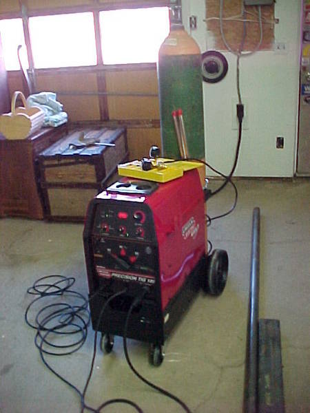

      I've had the Tig for almost two weeks now but didn't get it fired up until last Thursday. I have run a few feet of practice beads now and Saturday I actually made a couple of usable items.
      Here is a pic of the new toy...
      This is a shot of a couple of practice beads.
      Don't beat me up too badly, I am still learning to watch the puddle AND the weld seam AND the filler rod AND keep the foot peddle consistant. There is a lot going on during a weld but I think I am getting the hang of it. A couple more hours of practice and I think I will be comfortable. I need to get some practice on tubing though so I will start cutting up the old cradle this week for practice material.

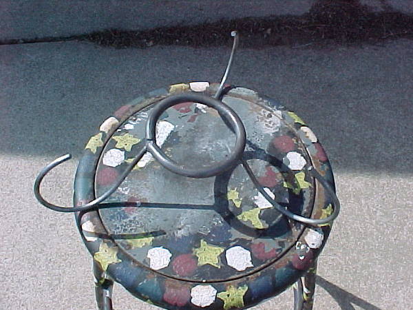

      Here is a hose/cable hanger I made from some scrap rod I had on hand.
      It might be kinda hard to see so I'll get some pics of it in use on the argon bottle tonite. I painted it red so it looks finished.

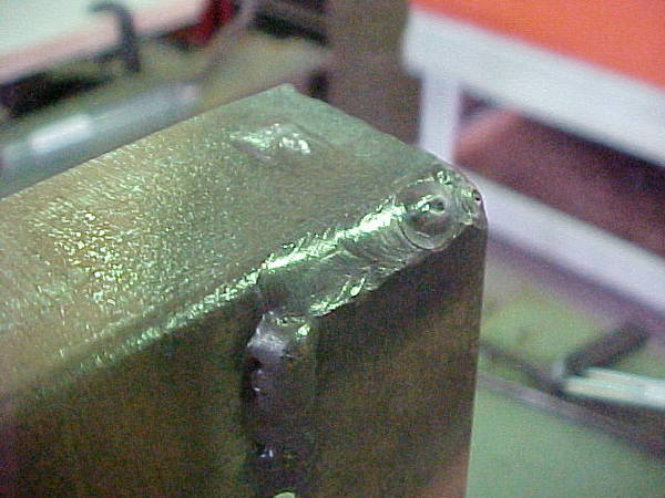

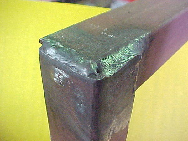

      Here is a couple of pics of welds I did on a chair chassis I built Saturday also. Some trash picked bed frame welded up to fit under my welding chair.
      I have about two hours worth of practice under my belt and I know I have a lot to learn but I don't think the welds look to bad. I have had some guidance and your guys input would be appreciated.

      I don't have much time, but your filler is way too big. Try .045". Your welds should not be dull grey like they are. They need to have some sheen to them. Dull grey = crystalization and way too much grain growth.

      I was using .063 filler rod. That's all I have right now. The practice beads were done on 1/8th inch stock at about 145 amps and the chair frame is .090 and I was running at 125 amps max.
      So I need to go smaller on the filler rod? What do you use for .095 wall tubing? That is what I will be using when I rebuild the cradle. Cfh on the gas is set at around 13-14 and I was using a gas lense with a 1/16th 2% tungsten.

      Mark, looking at the top bead in your first picture, I'm surprised to see you're using 1/16" filler. The wobbliness of the weld is classic of using filler that's too big.
      First, get that mill scale off of your steel! Even for practice pieces, it'll screw you up.
      Second, you're too hot. The "1 amp per .001" thickness" applies to aluminum. For 1/8" steel, try 80-90 amps, and for the .090", try about 60-70 amps.
      You will definetely want .045" filler for your cradle. Flow is good where you have it, and you could try a .040" tungsten on the .090" stuff.
