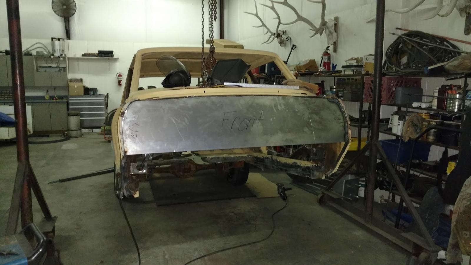

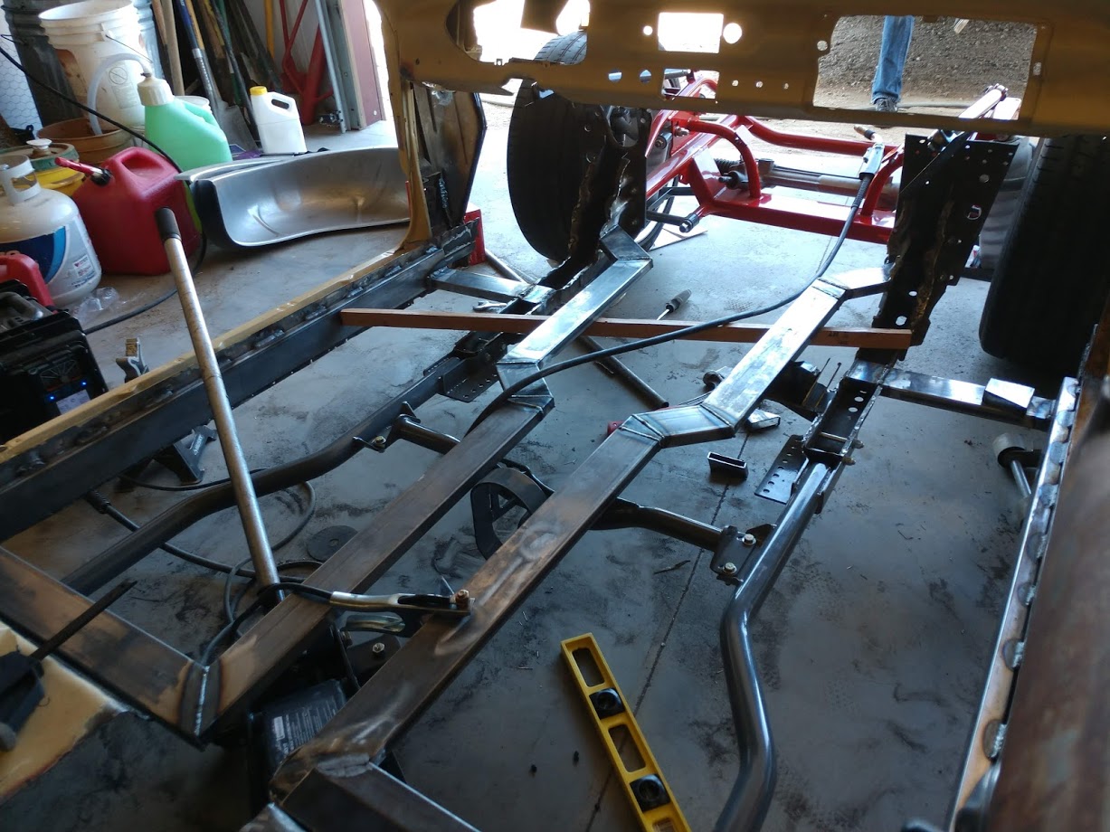

      So when I started the Nova the couple things I wanted to have when it came to a fabricating stand point was having a shaved firewall, as well as a flat floor. So I would be able to mount the engine a little farther back and mounting the seats and pedals would be easier for me. Which led to the entire firewall and the floor all the way to where the rear subframe starts, because I wanted to leave it intact making it easy to install the rear suspension, and not having to mess with modifying anything to make it work. On the firewall we ran a 16 gauge steel to make it a little stronger, and to help avoid firewall flex. Then when it came to the floor we used 18 gauge, and each panel is a little over 8 inches in width and we welded the fins together on the bottom side. Lastly when it came to the trans tunnel I made it a little bit bigger so I would be able to access the transmission if needed.
      Feb 2016
      46

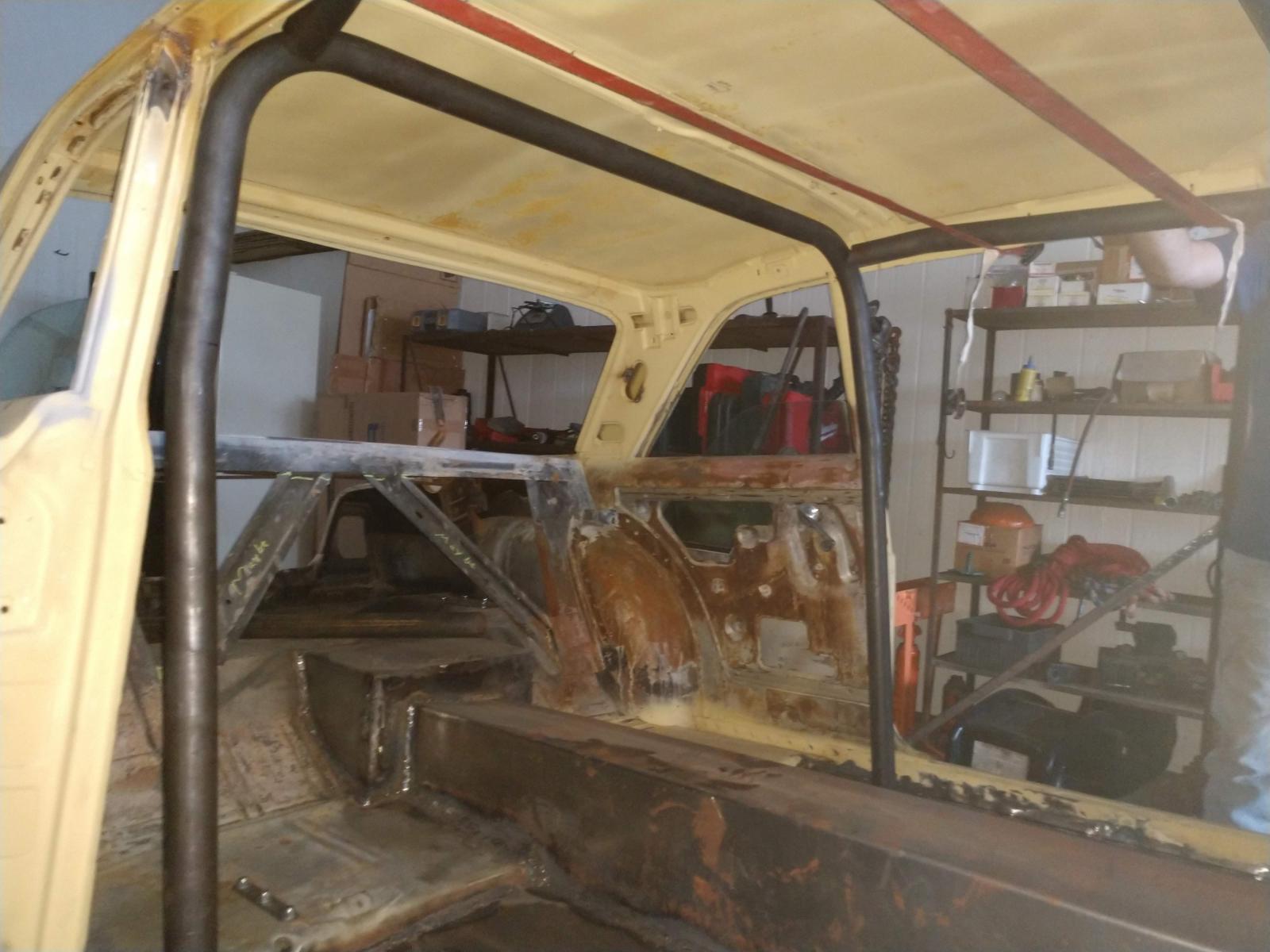

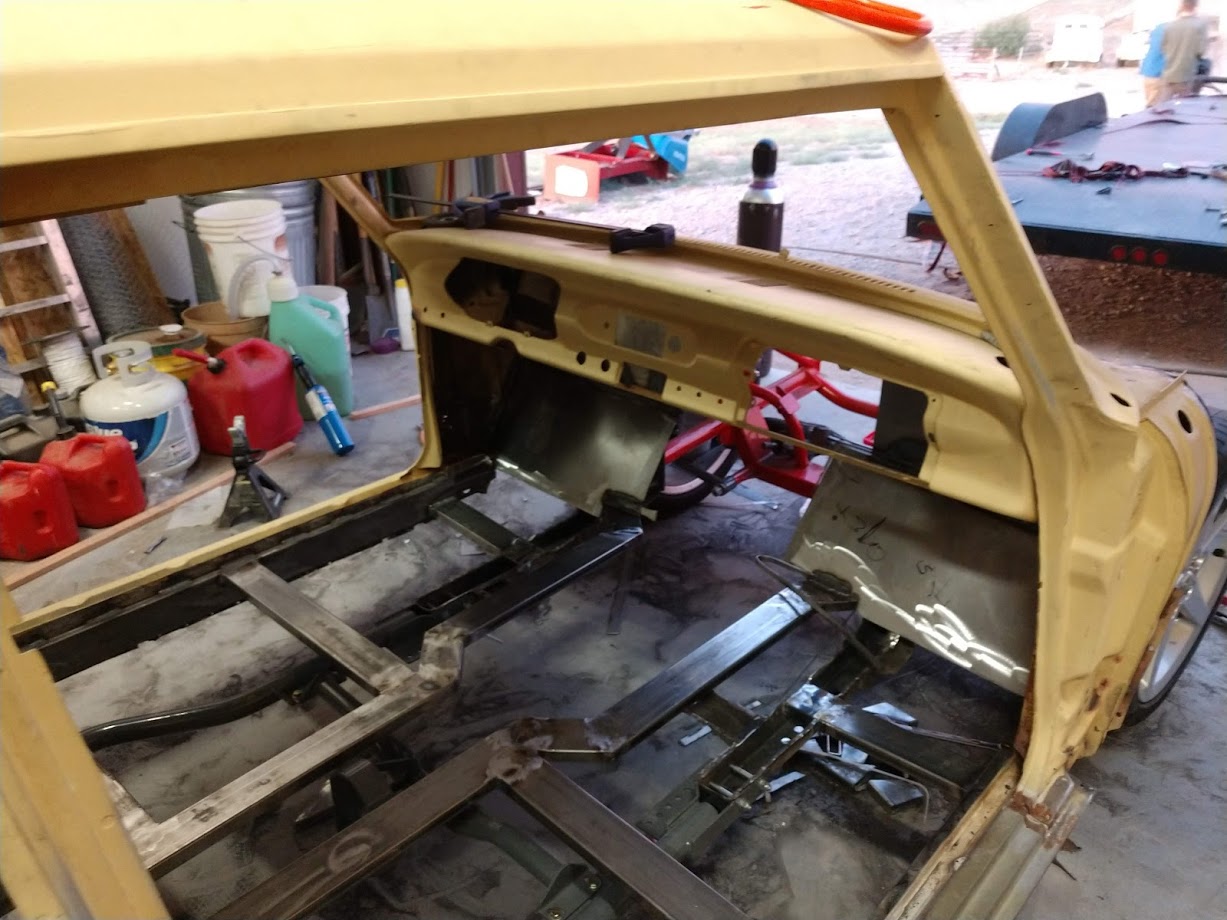

      Once we got the floor installed the dilemma became do we try to fabricate a new mount for the front clip or cut the old floor off of the original mounts and weld those ones up onto the new floor. So after messing with a few ideas we came to the conclusion that the original had the best strength so we welded those ones back on. Yet before we did we mocked up all of the TCI suspension up to it, to have any idea of what it looked like before it was up under the car. So once the factory mounts were back in we mocked up the whole suspension front to rear to make sure there wasn't anything I had to tweak from changing so much on my part, luckily somehow everything fit near perfect in the car. After that we took all of the suspension components off, and I took them to the powder coater up in Flagstaff (Flagstaff Power Coating) I went with a red very similar to TCI's red on the front clip, torque arm tube and the Currie Turn 9 housing, then I went with a dark gray on the remaining parts.

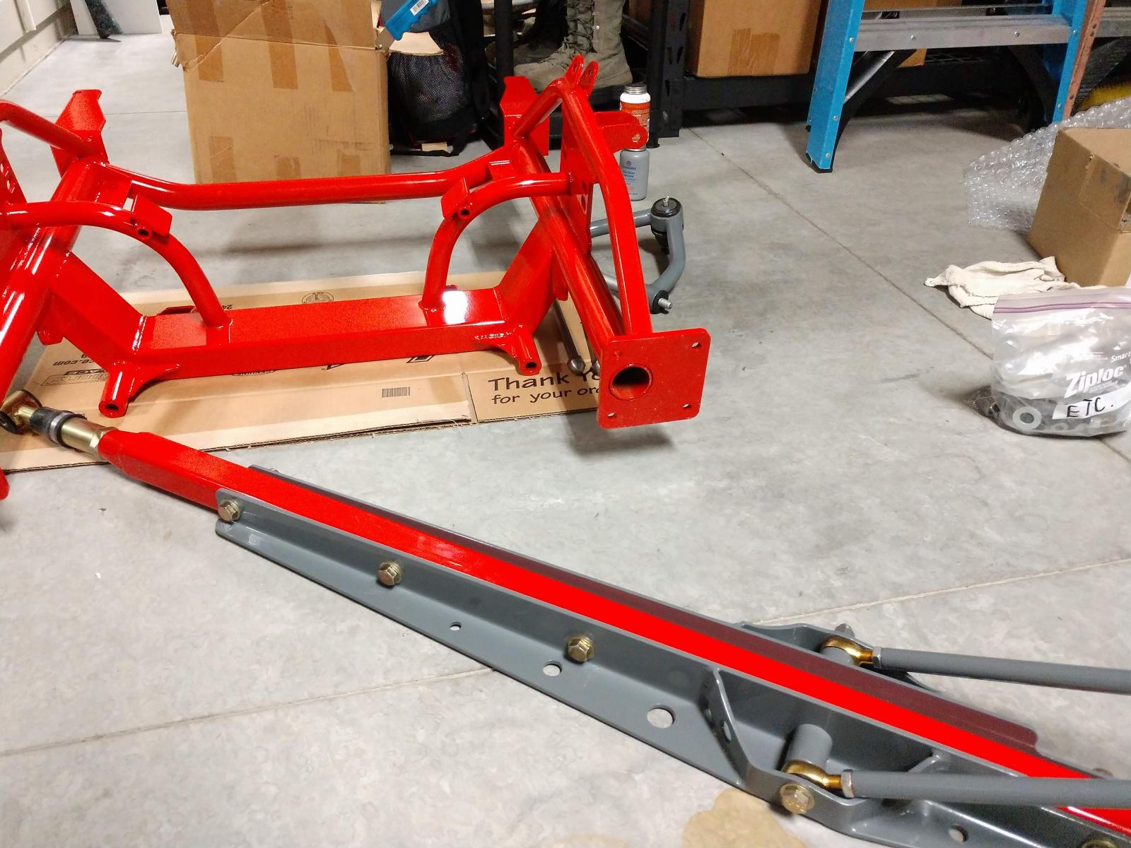

Size:  153.4 KBI know it has been a while since I have been able to post on here since I have been busy with school and work. Yet since the last time I posted on here I got the entire suspension back from the powder coaters, and it all turned out pretty great and the colors look good together. So I have been able to reassemble the suspension so that it's ready to go back on the car as soon as the roll cage is completed. We've also been able to go through the car in the mean time and clean up all of the welds that we still needed to clean. So going forward the plan post SEMA will be to have the car reassembled rolling around, and to be installing the steering, fuel system and radiator.

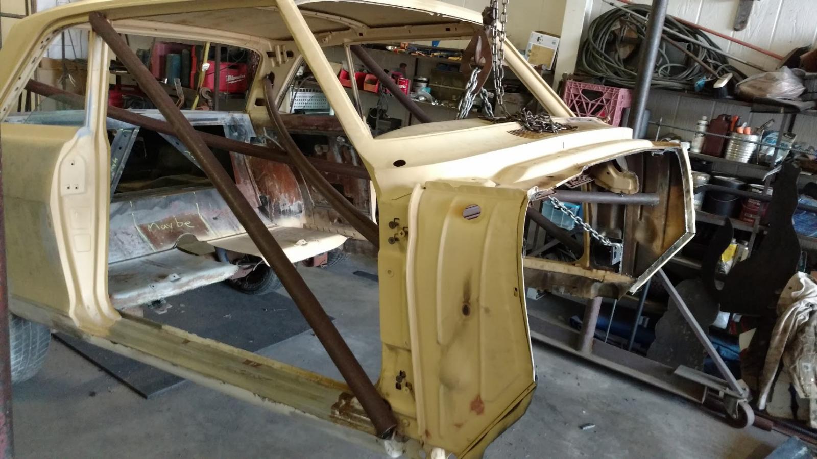

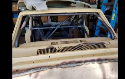

      Since its less than a week until SEMA I figured I'd get one last update in before the show. The first one being most of the roll cage has been installed in the car, and I should be installing the mini tubs post SEMA, along with the steering, suspension and rear end once I get the entire under side media blasted. So I'm hoping to have the car rolling around before Christmas. Then the other thing I'm excited about is a good friend of mine was able to throw together a quick rendering of the car to put my idea of the car into an image, as well as having it for SEMA. I'm also hoping to have the time during SEMA to post any exciting news regarding project Rocket!

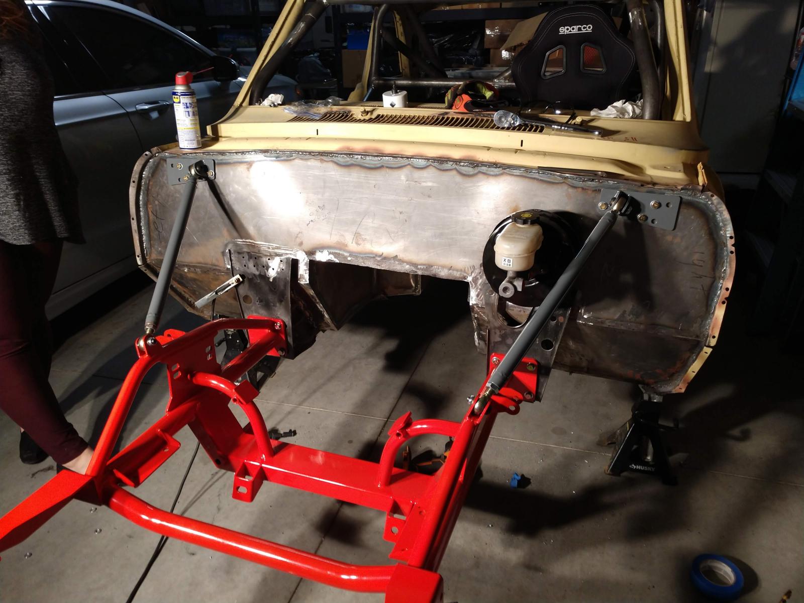

      Well tonight I felt like I made a decent amount of progress on the car, and enjoyed myself while working on it! I was able to get the front down bars installed which allowed me to start to see how the color scheme works together on TCI's suspension. But the part I'm more excited about is I got the C6 Z06 brake booster and pedal box into place. With the booster only being a quarter inch off of the down bar it was a perfect fit which honestly surprised me how well it turned out. As well as the pedal placement on the inside, I just have to modify a section of the trans tunnel once the engine and trans are in to allow better room for the gas pedal. Otherwise the pedals are almost exactly where I want them to be.

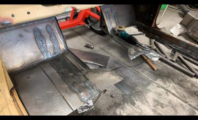

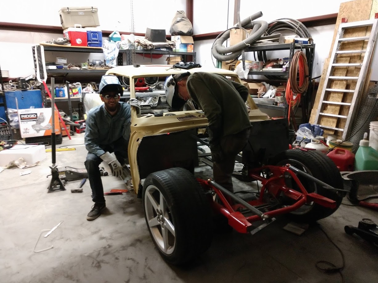

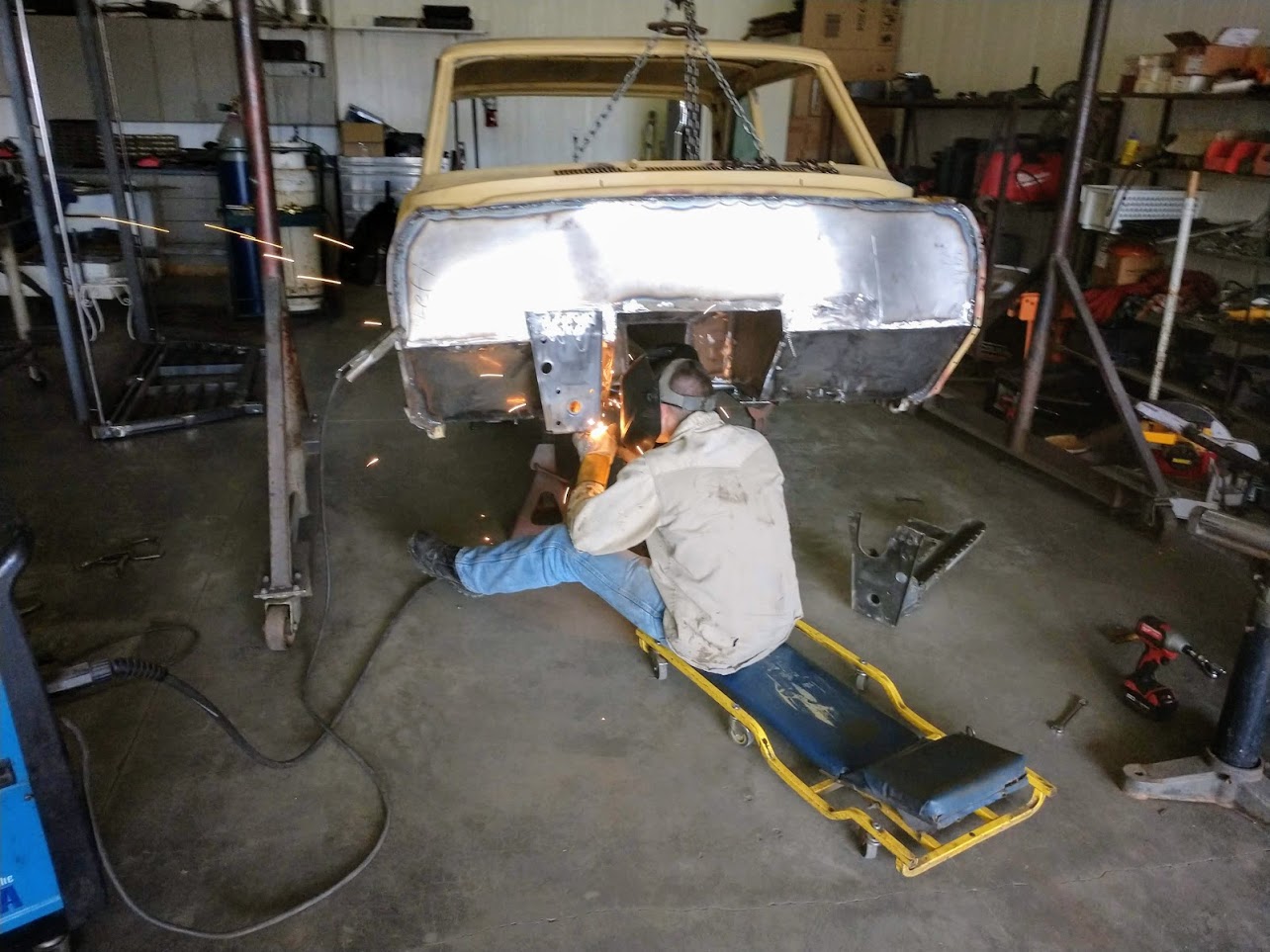

      There has been a several month gap since my most recent post, it hasn’t been for a lack of effort or time put into the Nova but, due to the shop who had been doing the “welding/fab” work on it. When I was told they had finished everything on the car which took much longer than what it was supposed to, and I would’ve been okay with that if it was done properly. When we went out to go pick it up we noticed parts of the cage didn’t look right but it was already dark out and hard to see what it truly looked like. It wasn’t until the next day when we really started to look at it in sunlight and noticed how bad it really was. Working from the firewall back, the firewall was warped from too much heat getting into the metal. Then the floor and trans tunnel welds mixed between almost no penetration, blowing through the metal or just incomplete welds. The roll cage was pretty similar with several incomplete and bad welds, along with the cage not even having the bars in the correct places, along with them using MIG rather than TIG.
      Which left me in a tough spot, and I felt the only correct way to do it was to cut everything back out and restart. Thankfully in that time my brother had become a certified welder, so between him and a couple great friends we have been able to do things correct with proper welds. We also had a much better design this time one that actually strengthens the car (hopefully allowing it to handle better paired with the amazing TCI suspension). The design this time around makes the car much closer to a full framed car rather than a subframe. In the mean time I have also been able to get an engine and transmission for the car (a LS1 from a GTO and a TR-6060 from a ZL1) So sadly due to having to back track so far because of a “fab shop” messing so much up on the car causing me to spend so much more money and time on the car; neither of which I have a lot of being a full time college student. Now after all of that and being forced to back track the updated timeline for the car is to have al of the fab work done on the car by SEMA and going off to paint around the end of the school semester.
