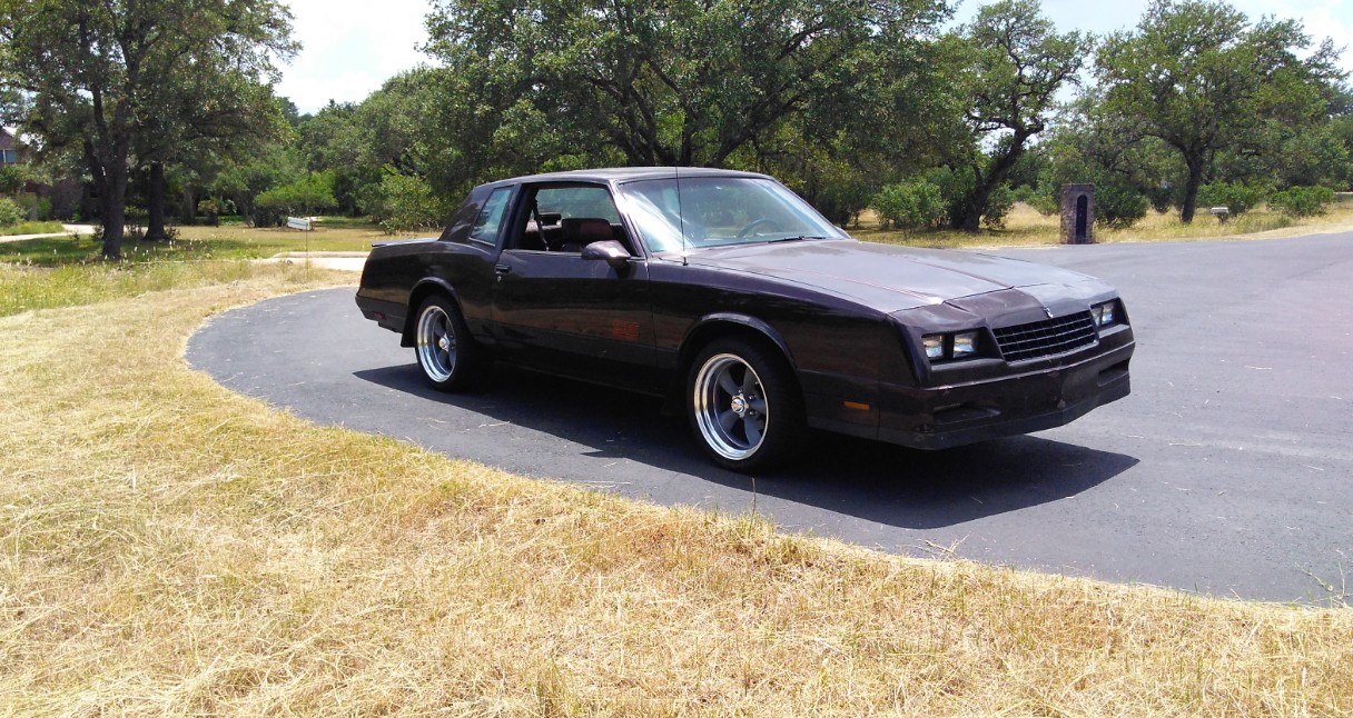

      car, for relevance:

      near term plans:
      18x9 w/ 275s (done)
      5660 front springs
      tall upper/lower b-joints
      upper A-arms
      rear 150lb/in springs (2" drop)
      exhaust rework
      Body bushings
      farther out:
      serpentine setup (in a box)
      T56 (under the work bench)
      C6 Z51 brakes
      box the frame w/ supports
      someday:
      3-link rear
      watts link (8.8 or 10bolt? dont' know how yet)
      oh, and i didn't post this in the body section as this really isn't 'body work' and is more along the lines of chassis mods...
