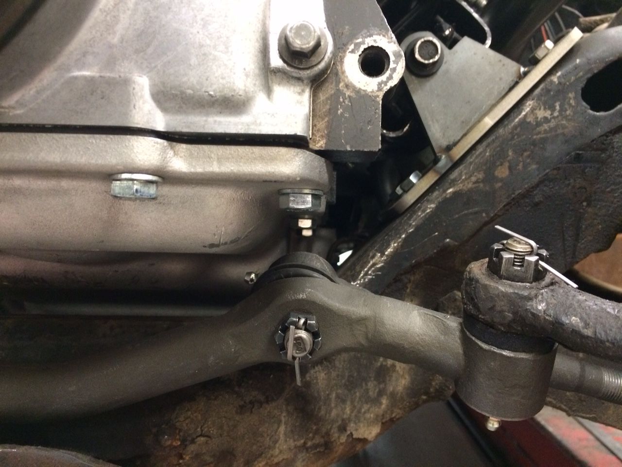

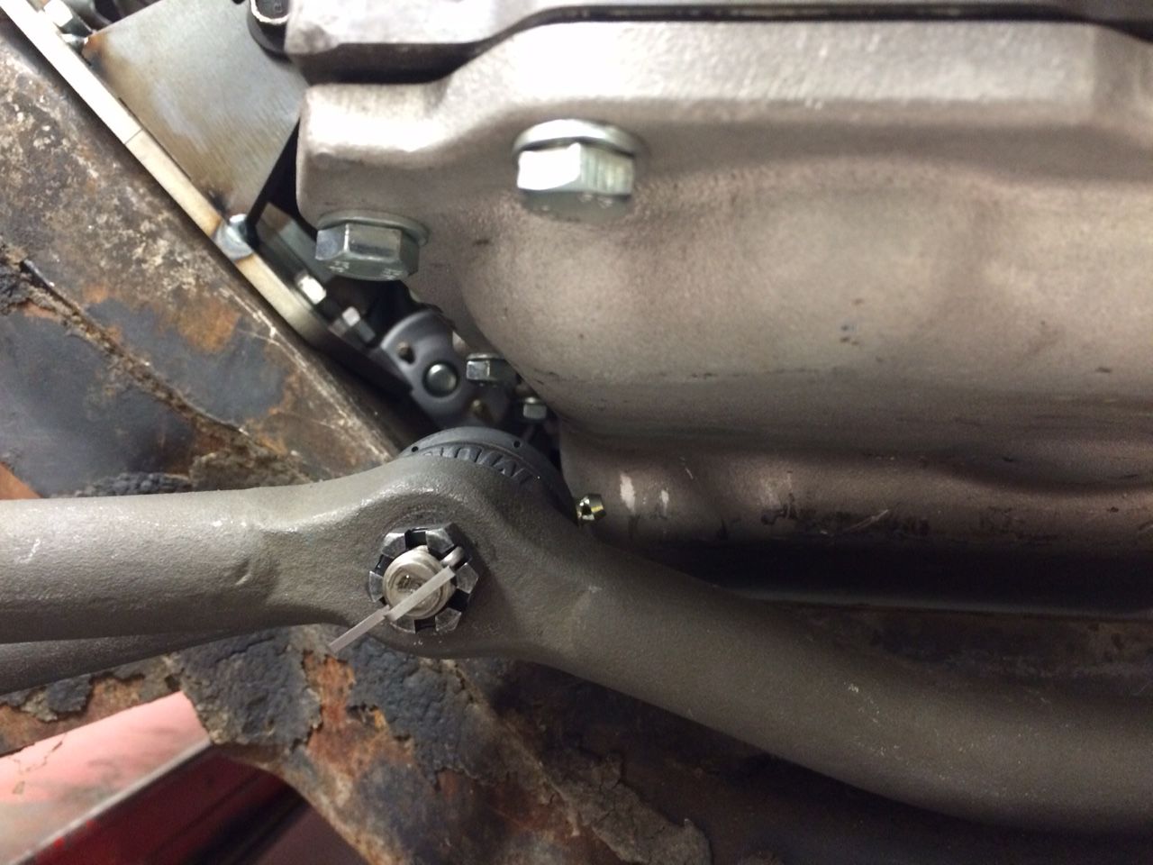

      You're likely to be able to get some good information here, but more information and pictures of where your interference is happening will be needed. From the photos you have posted, here's a few things I can tell you.
      1.) The stock Chevelle Big Block and Small Block engine stands bolt to the frame using the same holes and they both cantilever off the front of the crossmember...those stands shown in the lower more rearward position in your photos are not Chevelle/Chevrolet engine stands and are from another application.
      2.) The Transdapt adapter plates you are using moves the engine/transmission mating plane forward by 1.25" to 1.5" relative to the where it was in the stock SB Chevy installation, depending on the actual engine stands you're using them with. That fore/aft position will make the clearance between the front corners of the sump of the Holley 302-2 oil pan and the chassis very tight. The front corners of the 302-3 oil pan sump are beveled and therefore would provide more clearance in that area.

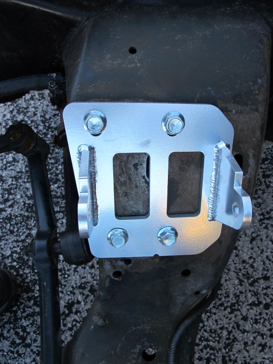

      3.) The Hooker A-body LS swap brackets are unique in that they are not based around the use of the stock BB or SB engine stands, or the stock old-school Chevy engine mounts. They are instead designed to use 4th-gen F-body engine mounts and delete the stock frame stands from the equation entirely, which provides the user with more component compatibility options (like being able to run a low-mount A/C compressor on the passenger side of the car). There is a forward-bias set of Hooker brackets that places the engine very close to the fore-aft position you are at now, and a rear-bias set that places the engine 1.25" further back from there and locates the engine/transmission mating plane in the stock SB Chevy location.

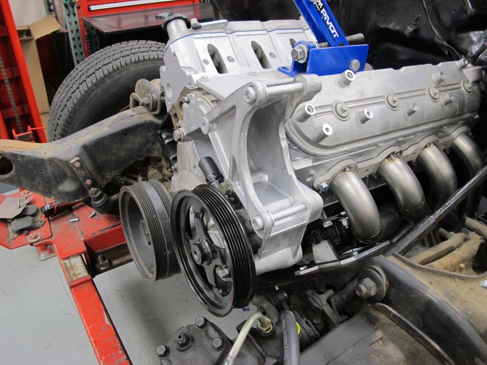

      Here's some images that will give you some comparative perspective. The first three images depict an LS engine in the frame of a 68' A-body mounted with the Hooker forward-bias engine brackets and transmission crossmember...notice the tight clearance between the front corners of the sump of the Holley 302-2 pan and the back side of the engine crossmember and the clearance between the inner tie rod ends and the 302-2 pan. The next two images depict the Hooker engine brackets attached to the frame and the last two images depict an LS mocked-up in a Chevelle using the Hooker rear-bias engine brackets. You can see the use of the 4th-gen F-body engine mounts in these last images. Name:  044.jpg

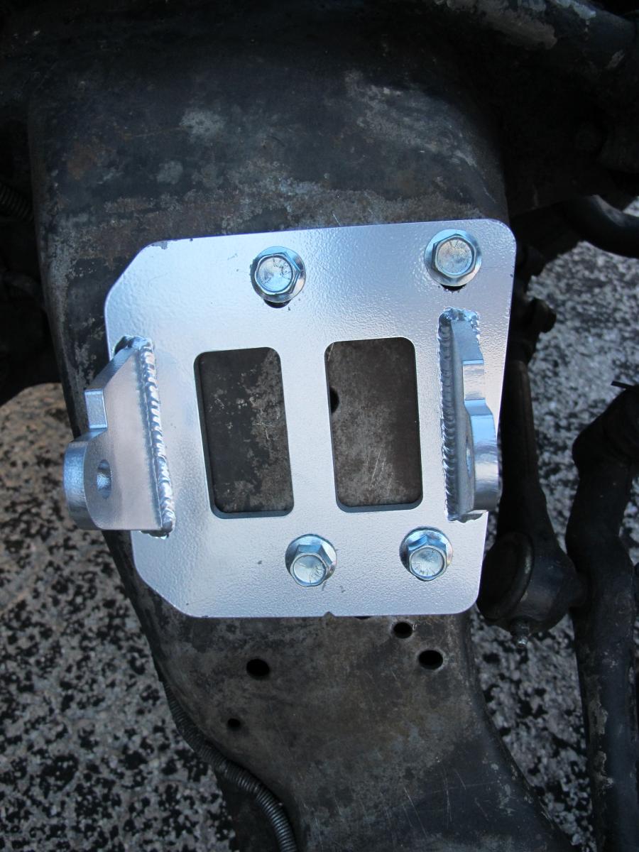

      Mar 2013
      372
      Perry, the fore/aft engine position you'll achieve using the Hooker 68-72 A-body engine brackets depends on which set you use (there is a forward-bias set and a rear-bias set) The rear-bias set locates the engine/transmission mating plane in the stock Chevelle/SB Chevy location and the forward-bias set moves the engine/transmission mating plane forward by 1.25" from that location.
      For some better understanding of the geometry involved, you need to remember that an LS engine block is 1-3/16" shorter than a SB Chevy engine block (and the length is all missing off the back end of the block), so you can move the engine/transmission mating plane forward by up to 1-3/16" from the SB Chevy location before the front face of the LS block, or the LS cylinder heads move farther forward in the car than where these reference points were in the original SB Chevy installation.
      The caveat here is that both the forward-bias and rear-bias Hooker engine brackets have fitment benefits over the other related to transmission and accessory drive fitment, so if you are going to move the engine rearward to provide more clearance for your steering, it may cause you to encounter some sheet metal re-work in the transmission tunnel that you wouldn't need to do if you were using the forward-bias engine brackets, depending on the specific transmission you are using. The old-school Power Glide, TH350, TH400, 2004R etc.. transmissions won't give you any grief with the rear-bias engine brackets, but a 4L60-4L70, 4L80 or T56 will if you are trying to end up with desirable U-joint working angles.
      The engine mounts used with the Hooker engine brackets are GM 4th-gen F-body mounts, which poly inserts can be purchased and used with the stock cages for those mounts. Yes, the Hooker engine bracket set-up is based around using the four forward bolt locations on the LS block as they are the only ones that exist on all LS blocks.

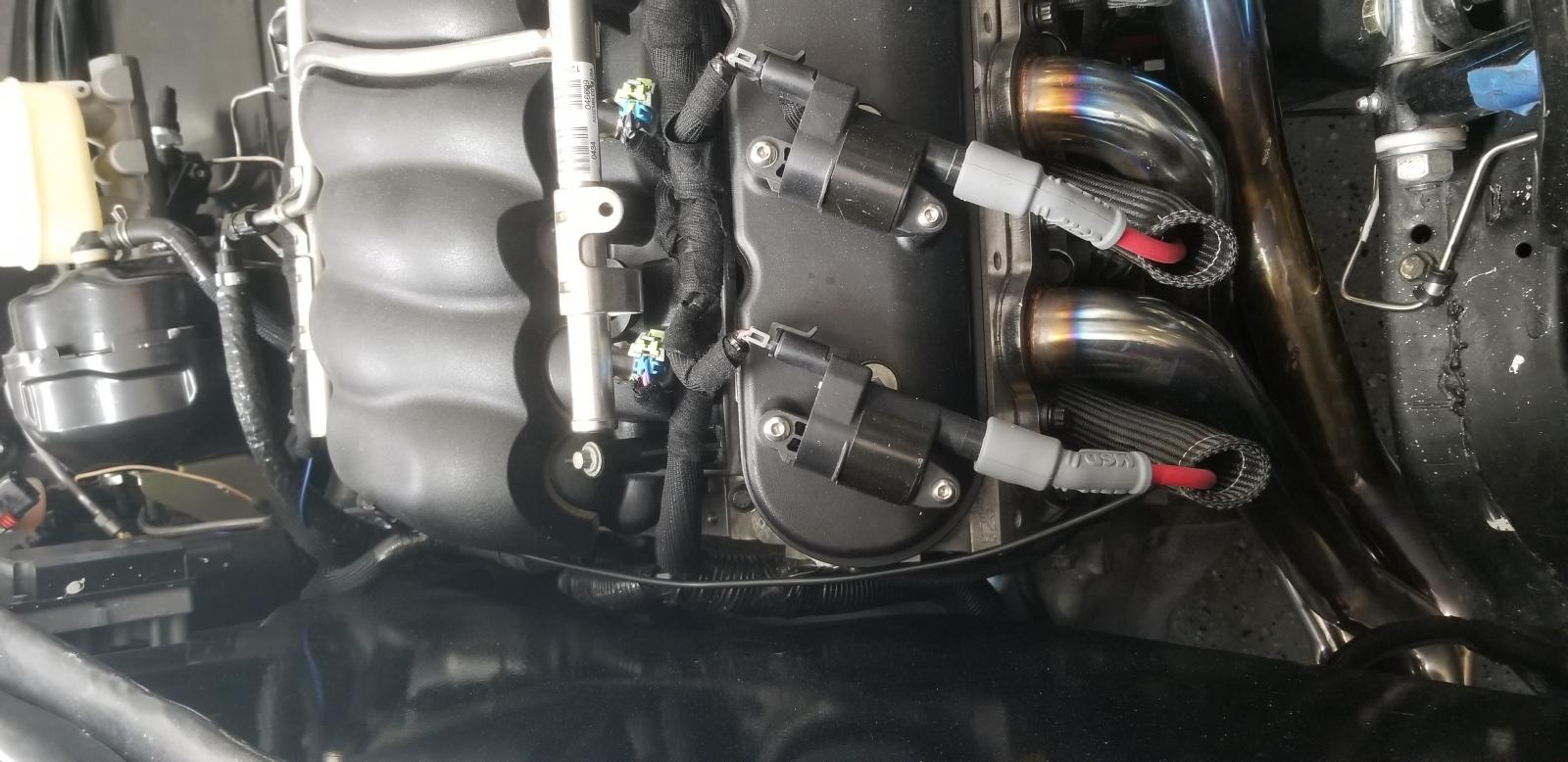

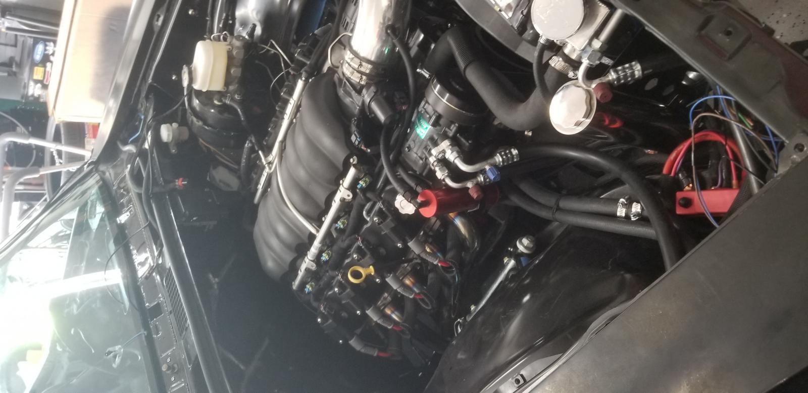

      Let me know if you need some pictures, I'm running an ls3 in the stock location using the rear bias Holley mounts. I also replaced the rubber inserts in the 4th gen engine mounts with poly inserts. This is in my 71 Chevelle which uses the same frame as yours.Name:  20180723_151322.jpg

      Mar 2013
      372
      Perry, I don't know where you got the information of the Hooker engine mounting brackets placing the engine higher off the frame, but it's incorrect wherever it came from. The reason the Hooker engine brackets were developed around the use of 4th-gen F-body engine mounts was because the use of adapter plates with the factory frame stands and old school Chevy engine mounts would not permit the engine to sit down low enough in the chassis to provide minimum clearance between the inner tie rods of the car and the low profile of the Holley 302-2 oil pan. That was a primary goal in the development of the Hooker A-body swap system, since achieving desirable U-joint operating angles had been a long-standing issue with these cars in an LS swap due to the high position of the inner tie rod ends up front relative to the low height of the transmission tunnel sheet metal in the area of the pinch point at the rear of the trans.
      The Holley 302-2 and 302-3 oil pans are the only pans on the market that will allow an LS to be sat as low as it sits in the chassis using the Hooker A-body specific engine mounting brackets.
