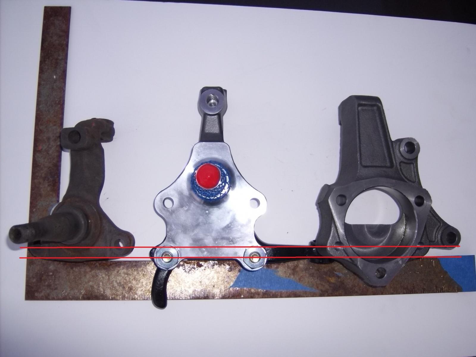

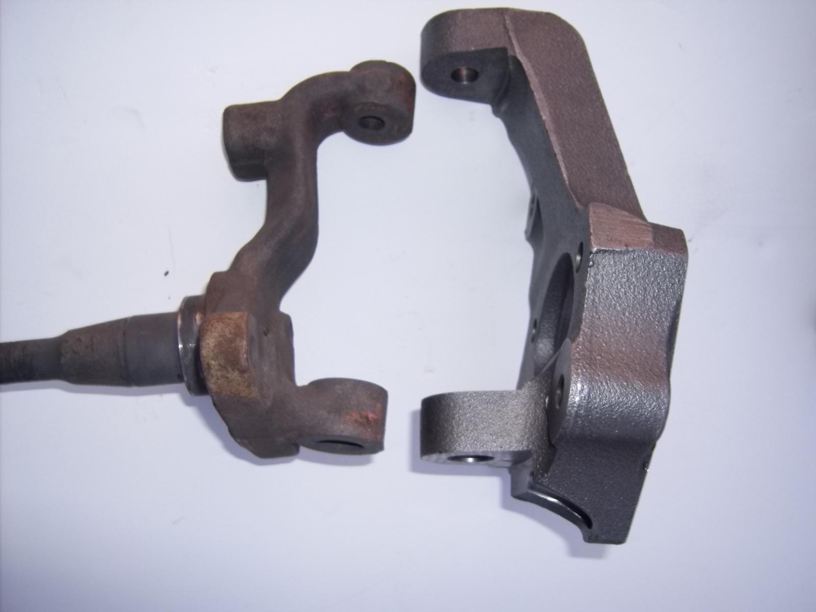

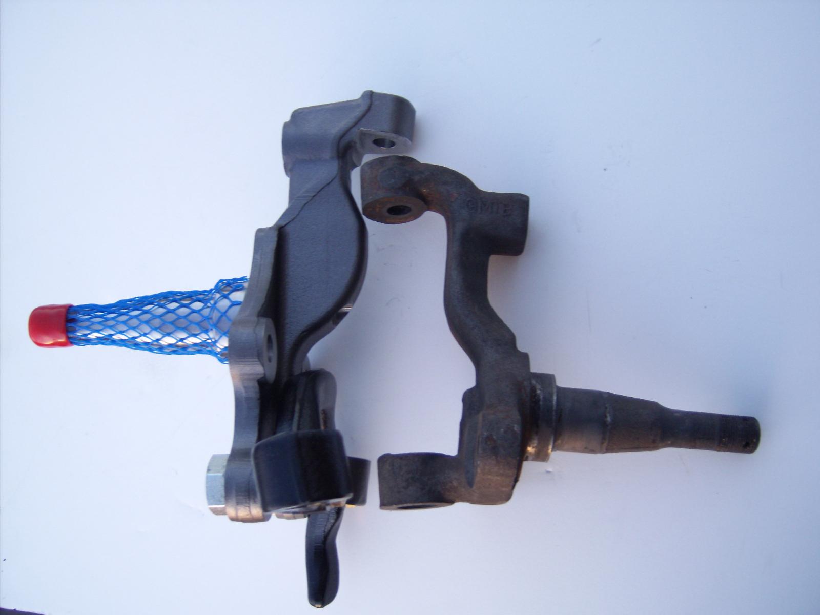

      if you use a tall spindle .. like the Fatman/ridetech spindle is one of the tallest and you don't need the guldstrand or tall balljoint with that one as long as the tire width is 255 and less, a 275 tire width usually on a 9.5rim with 5.5 backspace changes the scrub radius and feathers the outer edges of the tires and at this point you need to allow the car to have dynamic camber gain by adding a solution to the tall spindle
      here are some spindles and the size differences

      ridetech vs stock

      AFX vs stock

      AFX style vs Ridetech
