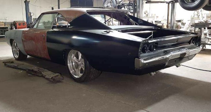

      The car is now sitting on it's wheels for the first time in nearly 2 years.

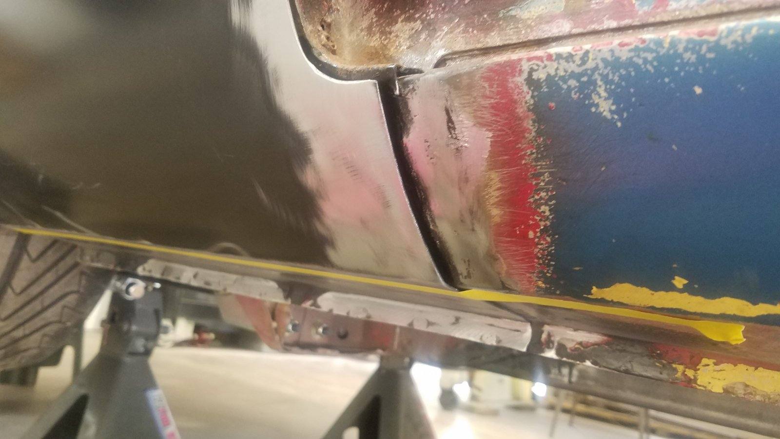

      The left door had some rust in the corners...which has now been repaired. Also, the AMD rocker was a little too short; you can see it as you follow the door's leading edge gap down to the rocker. It's now been fixed.

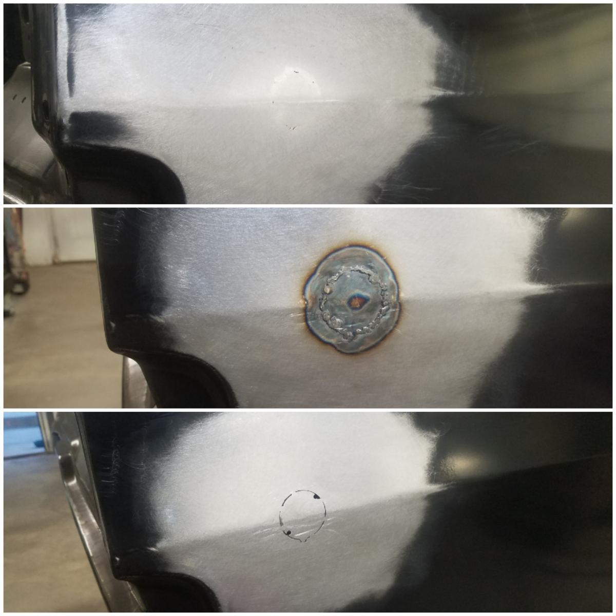

      The decklid lip had some rust bubbles so a patch was made...
