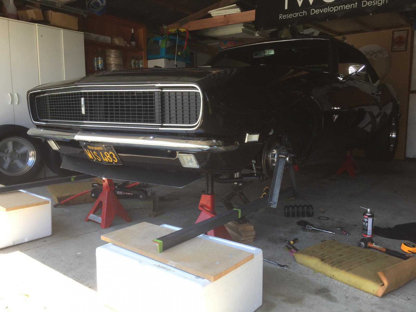

      Bump steer
      Ok, I have tested my suspension for bump steer with everything in except the spring
      Ride height toe +5mm (13/64)
      Full extended toe +16mm (5/8)
      Full compressed toe -13mm (33/64)
      Complete ridetech with truturn.
      Happy to answer any questions to hopefully help sort.

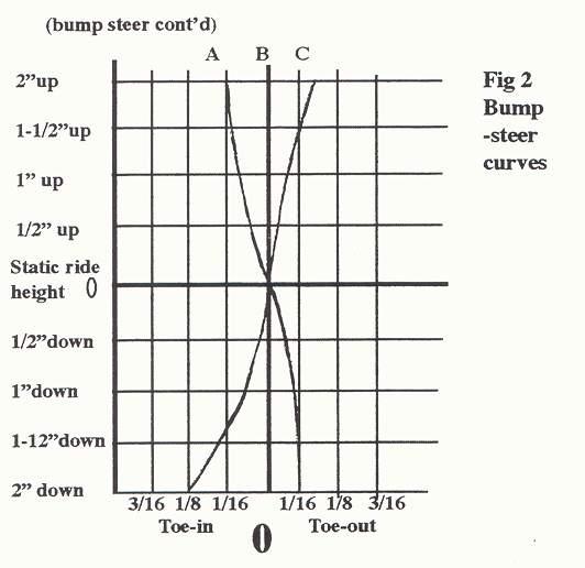

      I think more data points on the bump steer curve are needed. Something like this:
