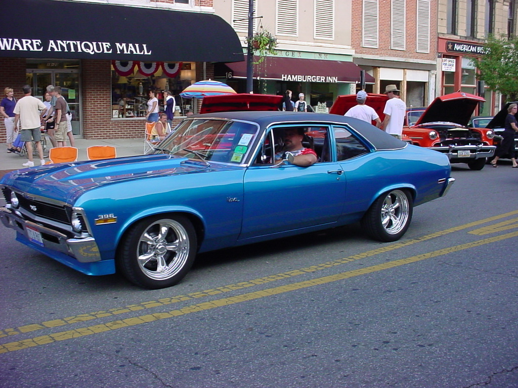

      Here's a pic of my '70 with standard TTIIs. You can see some other's here: http://www.danhardison.com/nova/

      Quote Originally Posted by MarkM66
      Here's my '70.
      Absolutely GORGEOUS Mark! :icon996:

      Quote Originally Posted by dhardison
      Dan
      Thanks! Yours too.
      Thats Beautiful man..... I assume those are 18's? Also did you have to roll your rear wheelwells for clearance.
