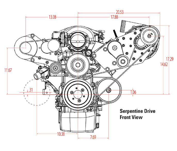

      The difficulty with Pro Chargers is that they pretty much have to occupy the space of one of the engine accessories. Since the alternator is a must on all engines, the AC compressor is the one that's often left out of the Pro Charger bracket setups. On your LS engine, it's relatively easy to separate the compressor from the rest of the accessory drive as that's what the factory did on the cars, mounting the compressor on the lower passenger side of the engine and driving it off its own 4-rib belt. The problem in many early muscle cars is that the frame cross member crashes with the compressor in this location and significant notching and reinforcing is required to clear it. Replacing the factory compressor with a Sanden SD7b10 (7176) will help this issue but will still require frame notching in most applications. Several manufacturers, including Vintage Air, manufacture brackets to mount the 7176 in the factory location. Most stock compressors are variable displacement designs, which are specially tuned for the AC system in their particular production car and aren't compatible with aftermarket AC systems. Depending on which LS engine you're running and the Pro Charger bracket design and belt gauge line, you may be able to use an LSA compressor and bracket from a ZL1 Camaro, which is a fixed displacement compressor. The only problem with running the LSA compressor is it's size, which is quite a bit larger than the 7176.
      In my opinion, your best bet is the low-mount 7176. If you'd like, post some photos of your Pro Charger setup so we can have a better idea of the packaging issue. Also feel free to PM me and I'll do my best to help you integrate the AC system with your blower. Nothing's impossible here, it'll just require some extra effort.
      Ryan Zwicker

      I assume this is the bracket configuration you're using:

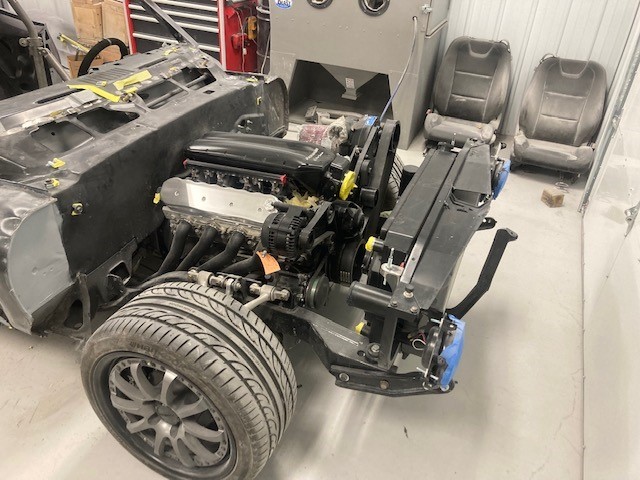

      Hey guys, this thread is a couple months old but I am doing the very same install. LS3 with F1D ProCharger and the Procharegr accessory mount system. 69 Camaro with AME front subframe. Started off with GM LS compressor then found out not compatible with VA system so switched to Sanden compressor and VA low mount. Have not fitted in car but all measuring suggests it will fitName:  Frontal shot blower.jpg

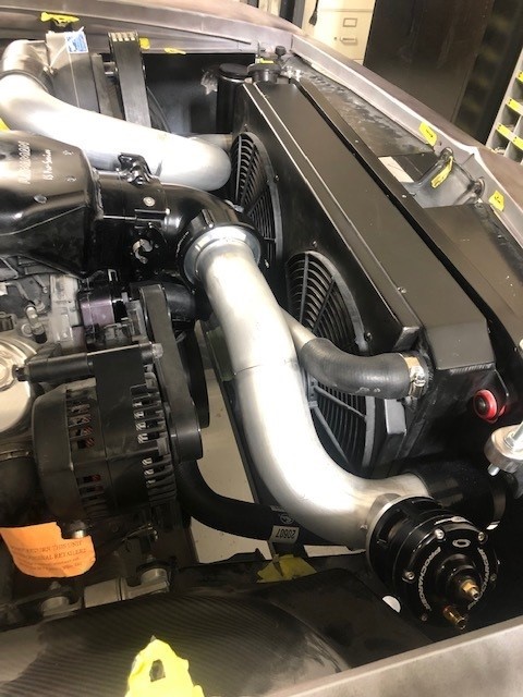

      Procharged LS3 in 69 Camaro
      As pictured previously on stand everything fit in with no issues
