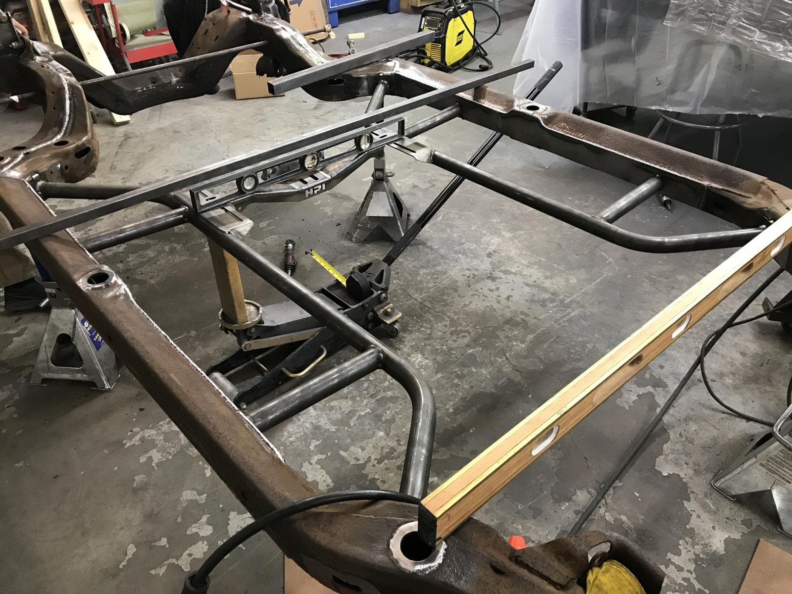

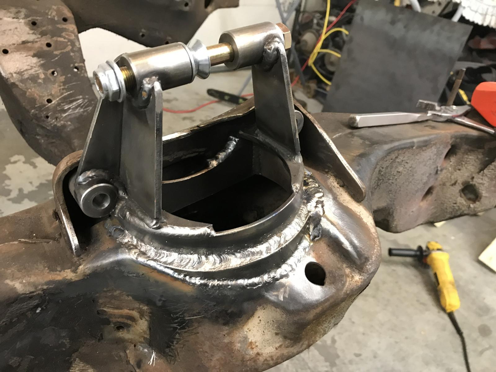

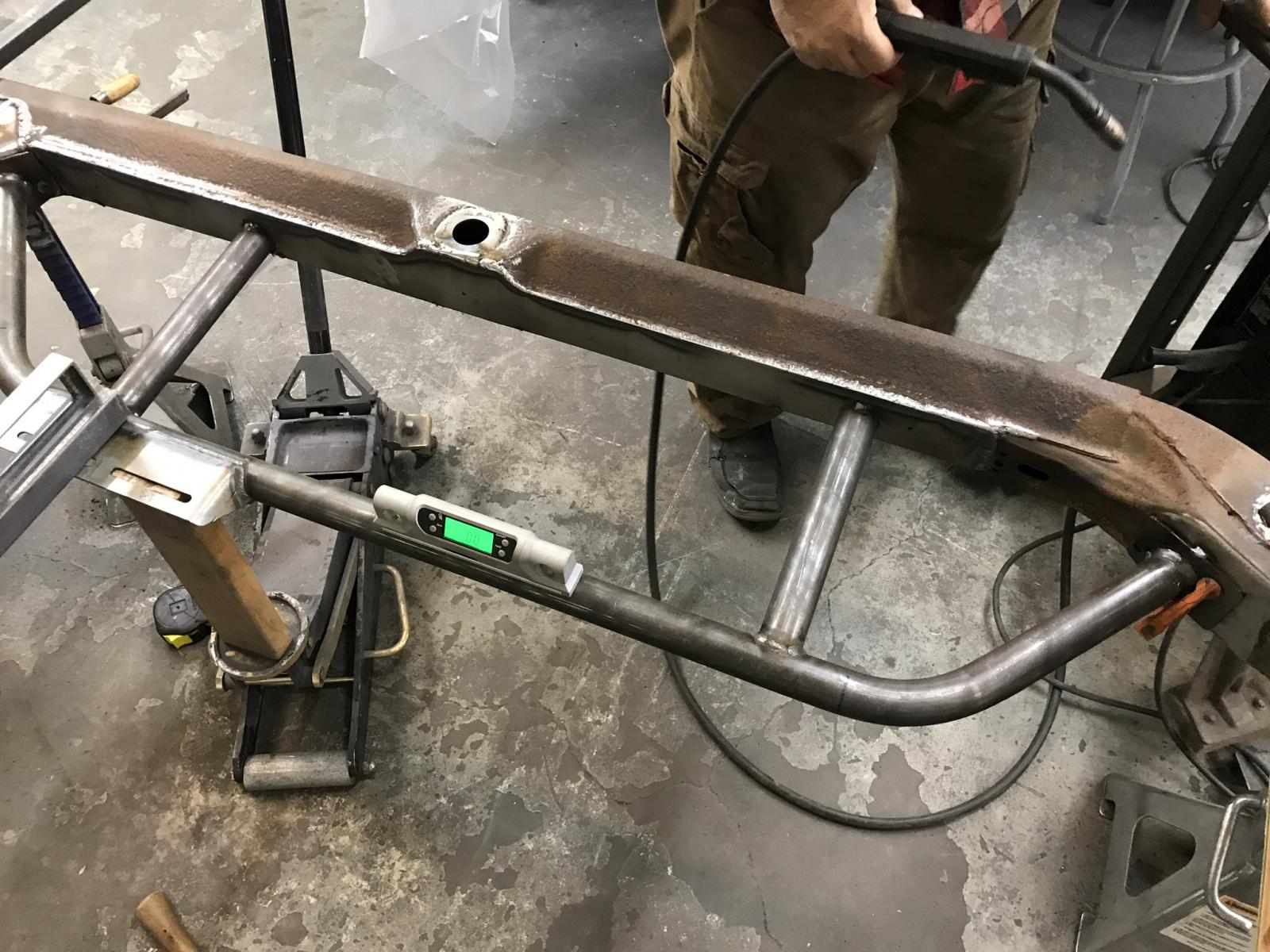

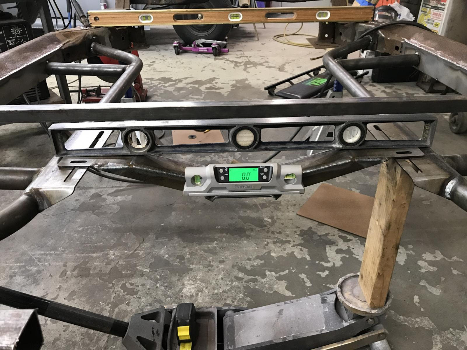

      - I salvaged a donor frame from a local yard to start this project so i didn't have to completely blow apart my running car right away.
      - Boxing and bracing with the HPI kit.
      - Full Global west KT kit in the front and their coilover set up in the rear with Viking double adjustable shocks to start with.
      - Going to use 18" ET Classic V wheels however the tires are TBD (i didn't think it would be as hard as it is to find a decently wide tire in an 18" size)
      As of right now i thing im going to re-purpose my procharged small block to be used in this set up. I thought long and hard about going LS but part of me likes the old school aspect of a SBC. Still up in the air though because i will have to spend some money to get this thing capable of sustained abuse.
      Below are those pics i was talking about along with the frame i just loaded into the garage earlier this week. Thanks for looking and i look forward to posting updates.
