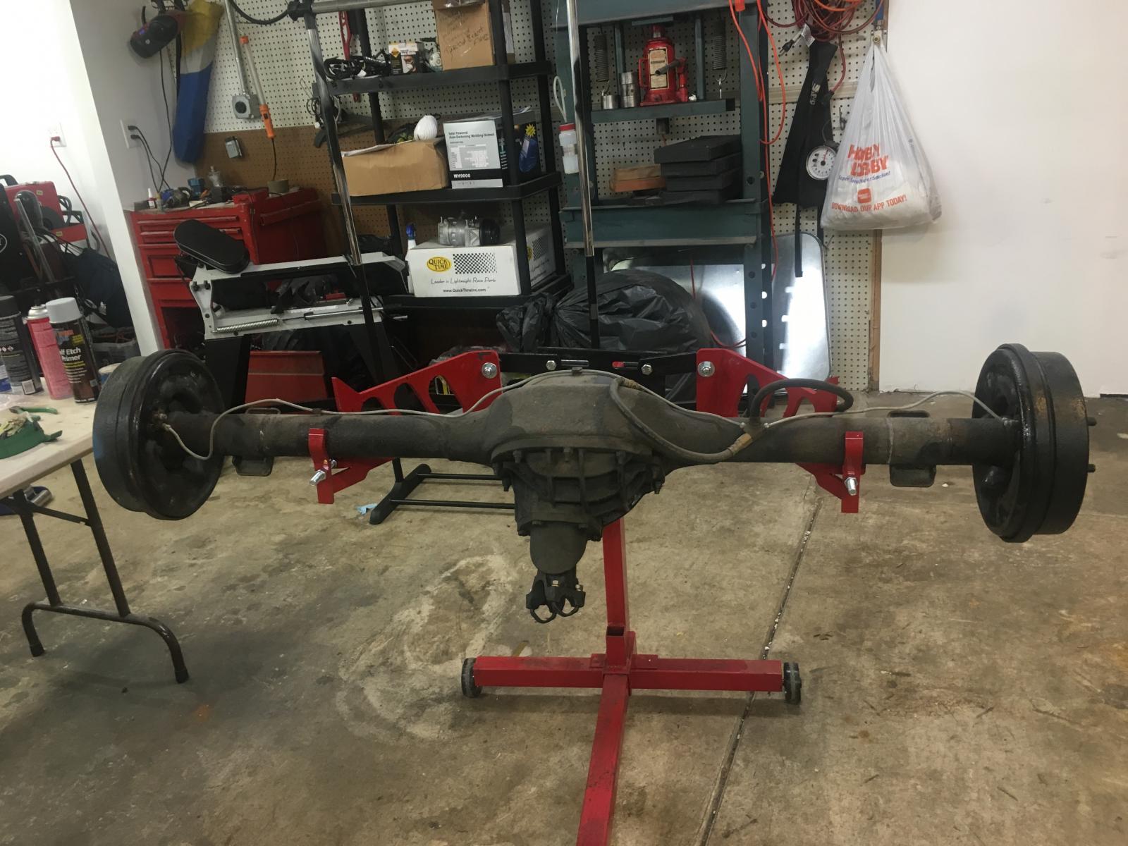

      May 2017
      118
      Been working on other projects and been procrastinating on working/cleaning/painting/welding/disc brake install/brake lines, due to bench and shop space. Well I get a Summit tool catalog in the mail last week and I spot these axle stands that mount to my engine stand, best $50.00 I have spent in a long time.Name:  Axle stand.jpg
Size:  221.3 KB No excuses back to work on my project.

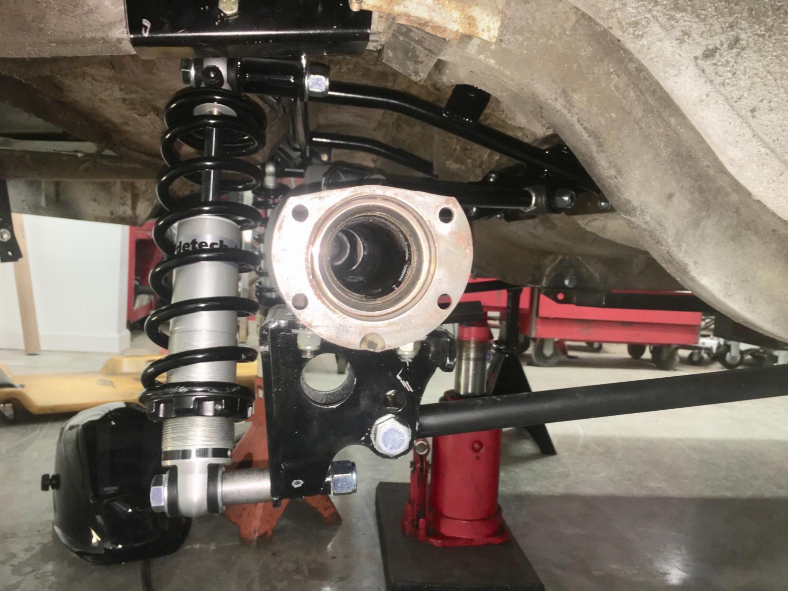

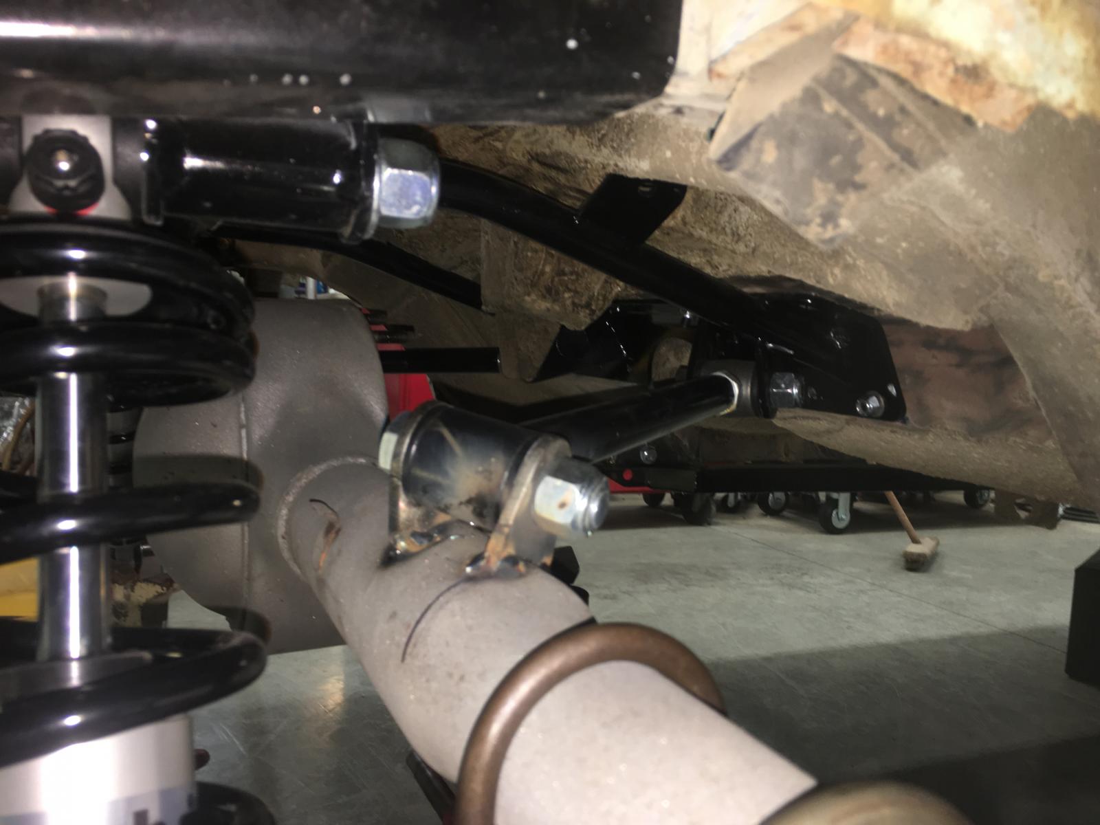

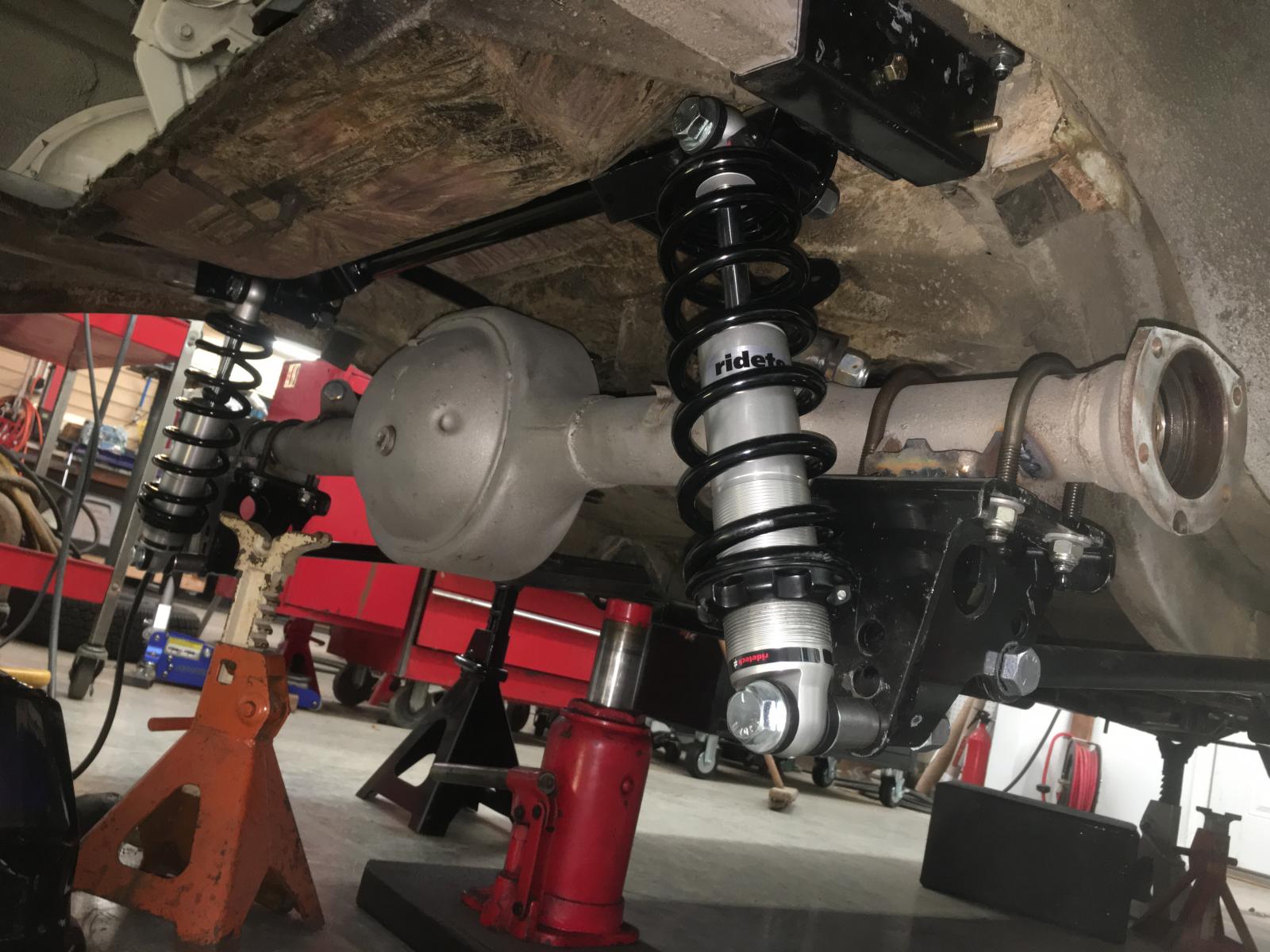

      May 2017
      118
      Fun to see a few more Falcon builds popping up. Making some slow progress on my build, I have gotten the TCI 4 link rear suspension all mocked up and tabs and mounts tacked on. Also need to figure out if I will get much space gain with a mini tub now that I have the suspension installed. Next step is mock up the disc brakes and play with the Wheelright to see what I have to play with and space I have between the lower trailing arm.Name:  IMG-1152 4 link 1.jpg
Size:  198.2 KBName:  IMG-1154 4 link 2.jpg
Size:  209.1 KBName:  IMG-1156 4 link 3.jpg
