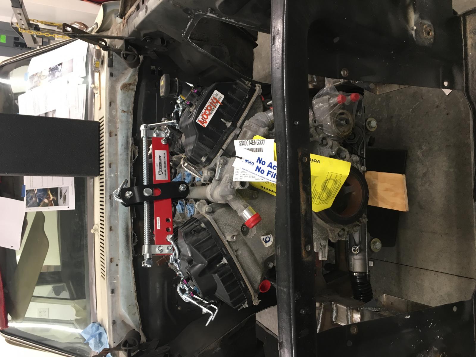

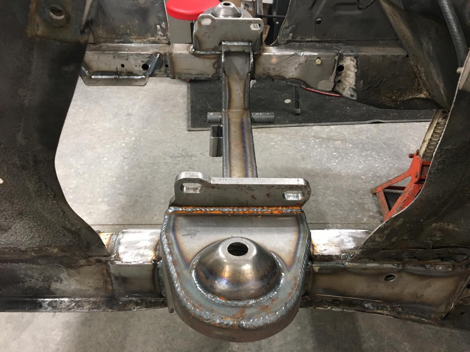

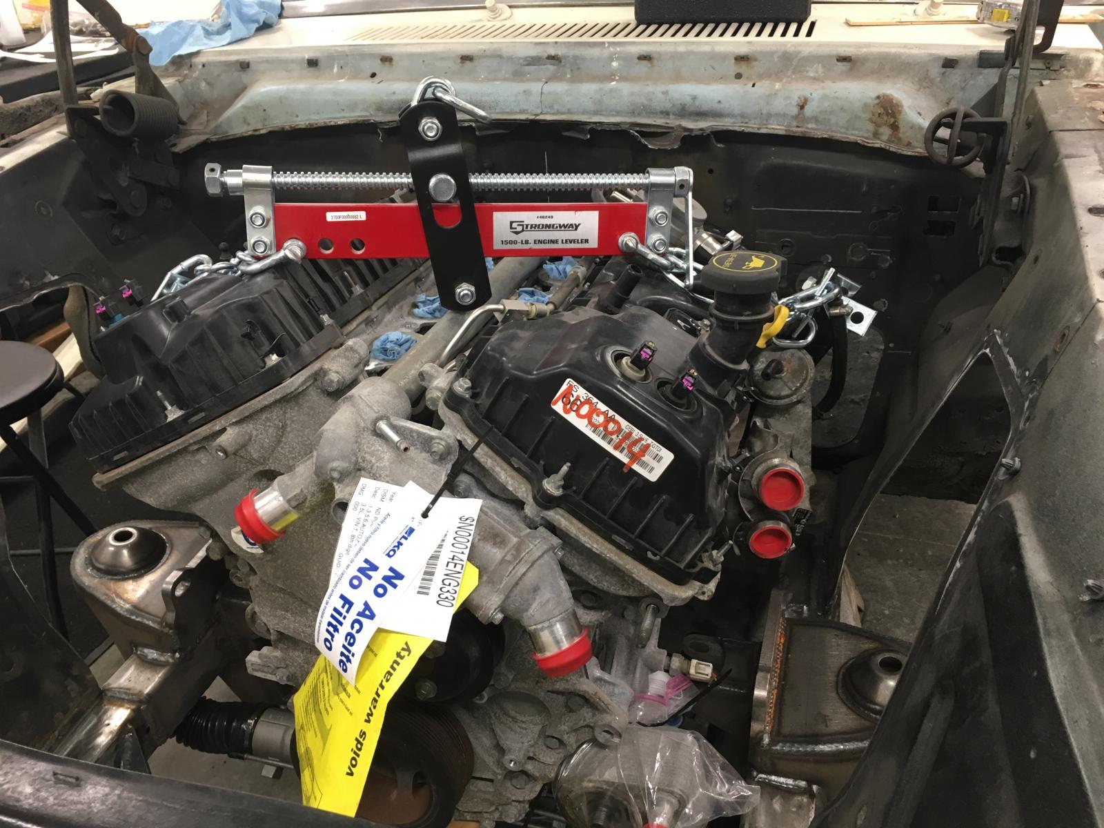

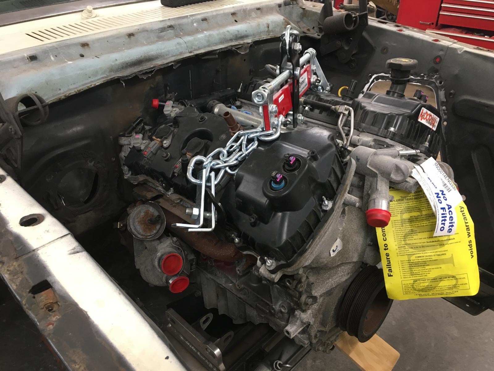

      Feels good to finally be able to post a project update. Spent the last number of months gathering parts and planning my build.
      Over the holiday break the stock front pick up points and mounts were cut off the TCI IFS crossmember installed.
      The engine setting where it needs to be. need to do some more cutting on the tunnel to fit the TKO 600.
      Name:  TCI Crossmember install 2.jpg
Size:  241.0 KBName:  TCI Crossmember install 3.jpg
Size:  224.7 KBName:  Engine set in place 1.jpg
Size:  253.2 KBName:  Engine set in place 2.jpg
Size:  230.7 KBName:  Engine set in place 3.jpg
Size:  212.5 KBName:  Engine install cut firewall.jpg
      Some more firewall mods are needed before I make the Engine and transmission mounts.

      That is cool. Did you have to fabricate the motor mounts or does TCI sell an adapter?
      1986 Saleen, Aluminum block 408W, T56, Full Griggs Racing supension
      May 2017
      118
      I will have to fabricate the engine mounts. With that said it looks like I can use the SBF mounts with some easy mods/a single cut on each one and welding to plates I made I think at this point. I need to get the AC compressor, alternator, steering shaft and starter bolted on. I will build the engine and trans mounts at the same time. I am thinking right now that the mounts are not going to be too tough
      My initial concern was the left side turbo and steering shaft, turned out to be a non issue. I am having to do more work on the firewall than i was thinking when I started but it’s not a big deal.
      Getting the engine back a extra inch is going to help with the intercooler, radiator and AC condenser space.

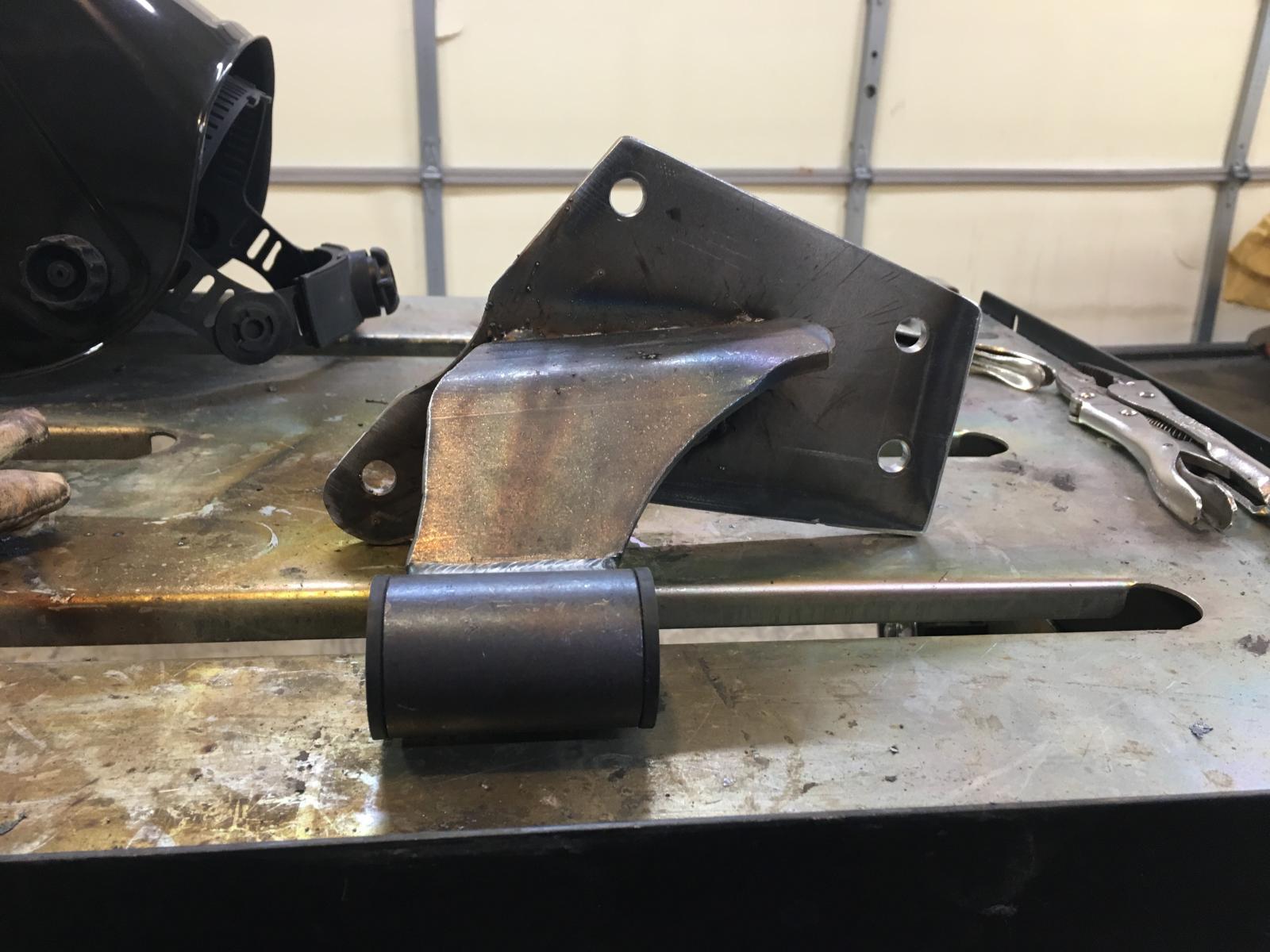

      Haven't touched the Falcon for a 6 weeks was back at it yesterday, got both motor mounts mocked up and finished the left side. Will finish up the right side this week with new found motivation. Was able to use the TCI SBF mounts that came with the front end kit, just took a little trimming.

      Very Cool! I am on my 3rd EcoBoost swap now. They make for a really nice swap. What are plans for power output? 480-500 RWHP pretty easy without changing any internals. My first one just tune was 420/532 one of current no dyno yet but should be 480/550. Subscribed!
      May 2017
      118
      I have been told it doesn't take much to make 450 RWHP, I will be happy with 400-450 for starters. Since you have done a few EB swaps what are your thoughts on the engine mounts? I have been told by some of the more experienced EB guys that I need to care on putting too much leverage on the side of the block?? I was looking at the stock truck engine aluminum engine mounts it seems to me that if anything I have spread the load out more than the stock mount.

      Quote Originally Posted by Boosted Falcon View Post
      I used stock F150 mounts on all 3 of my builds. Huge insulator on them which will absorb a lot. I can get pics if you would like. I figured with all the engineering done why not keep them. Very easy to use.

      Stock mounts not aluminum at least thru 2015.

      Humm, thanks I will have to check out the OEM truck mounts, might have to rethink what I have planned. More research needed, I think I will finish up what I have started so I can finish up the trans mount and tunnel. Then the engine comes back out and if a new plan is needed I will go from there.
      Holley is just down the road from us, they had a stock F150 on there dyno to baseline before making a exhaust system for the truck. Just rolling up on the dyno it made 365 RWHP, seeing that made the decision to plug a 3.5EB into the Falcon. I figure stock power levels will push this 2800-2900 car pretty good.
