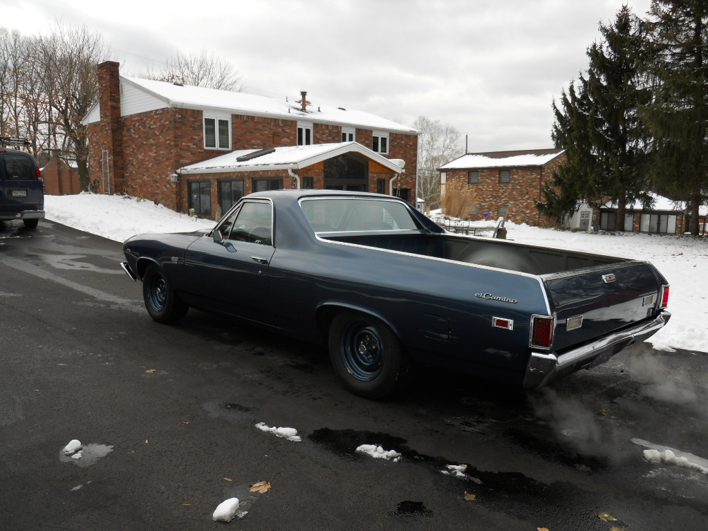

      If I were the OP, I would just get 2" lowering springs all the way around with Bilstine shocks. I used BMR springs from Summit on my 69 el Camino. The 2" lowering spring will put that Buick pretty close to stock height. For some reason stock height has changed over the years into making these cars look like 4x4s. Look at factory photos of your car when new.
      As far as looks go, it depends where the cars parked, ride height is always changing with terrain, at least it does on these hills around here..

      Yeah I've been googling stock height for the Buick to see what drop srpings to get. I think I'll go with the 1inch drop for now. Btw, your el Camino sits pretty nice
