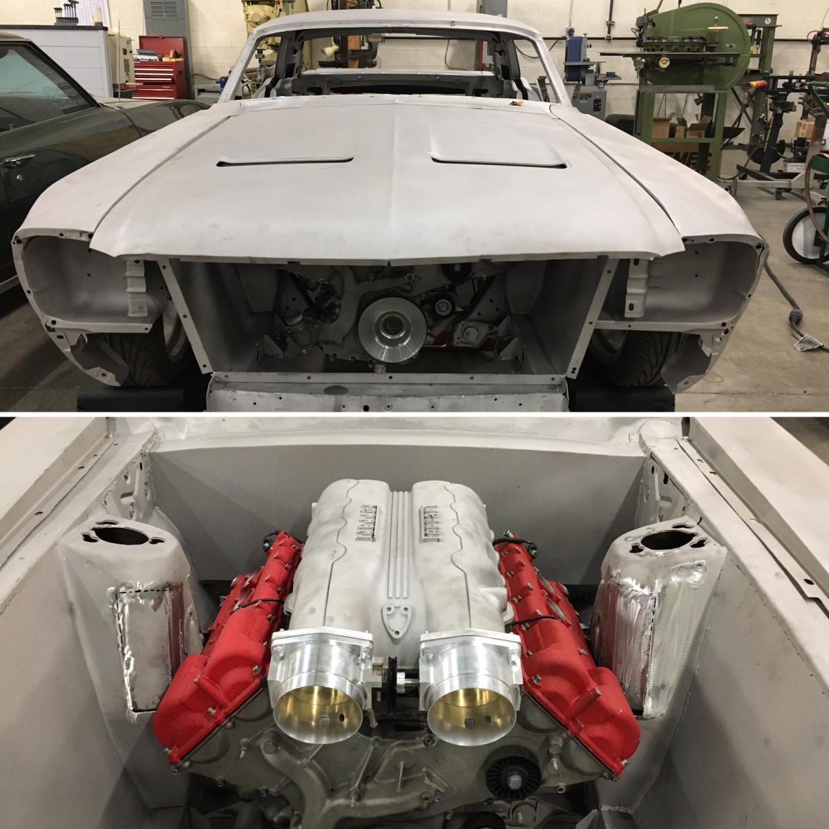

      Oct 2017
      14

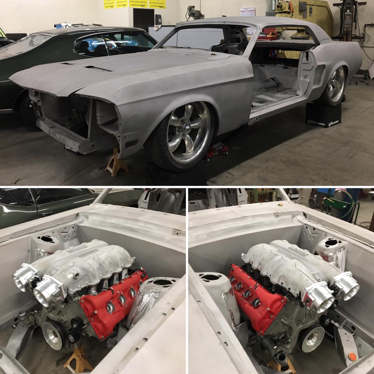

Size:  163.0 KBName:  5D6CA0CF-A2C1-43DE-AD3C-256751DD7090.jpg
Size:  173.3 KBThe engine is in and fits. I am going to keep the shock towers as I have most of the ridetech suspension and don't want to start over. Plus I am pretty sure it will sit a bit lower with the ridetech system as well. Also surprisingly fits under the stock flat hood

      One off combinations and odd rods are fantastic.

      Looks good in there! Headers might be a challenge
      Sep 2009
      3,002
      So cool, I love how you integrated the LS throttle bodies and tied them together. I was also thinking the same about the headers but given the level of fabrication in this thread no doubt you will come up with a solution. Keep the updates coming.

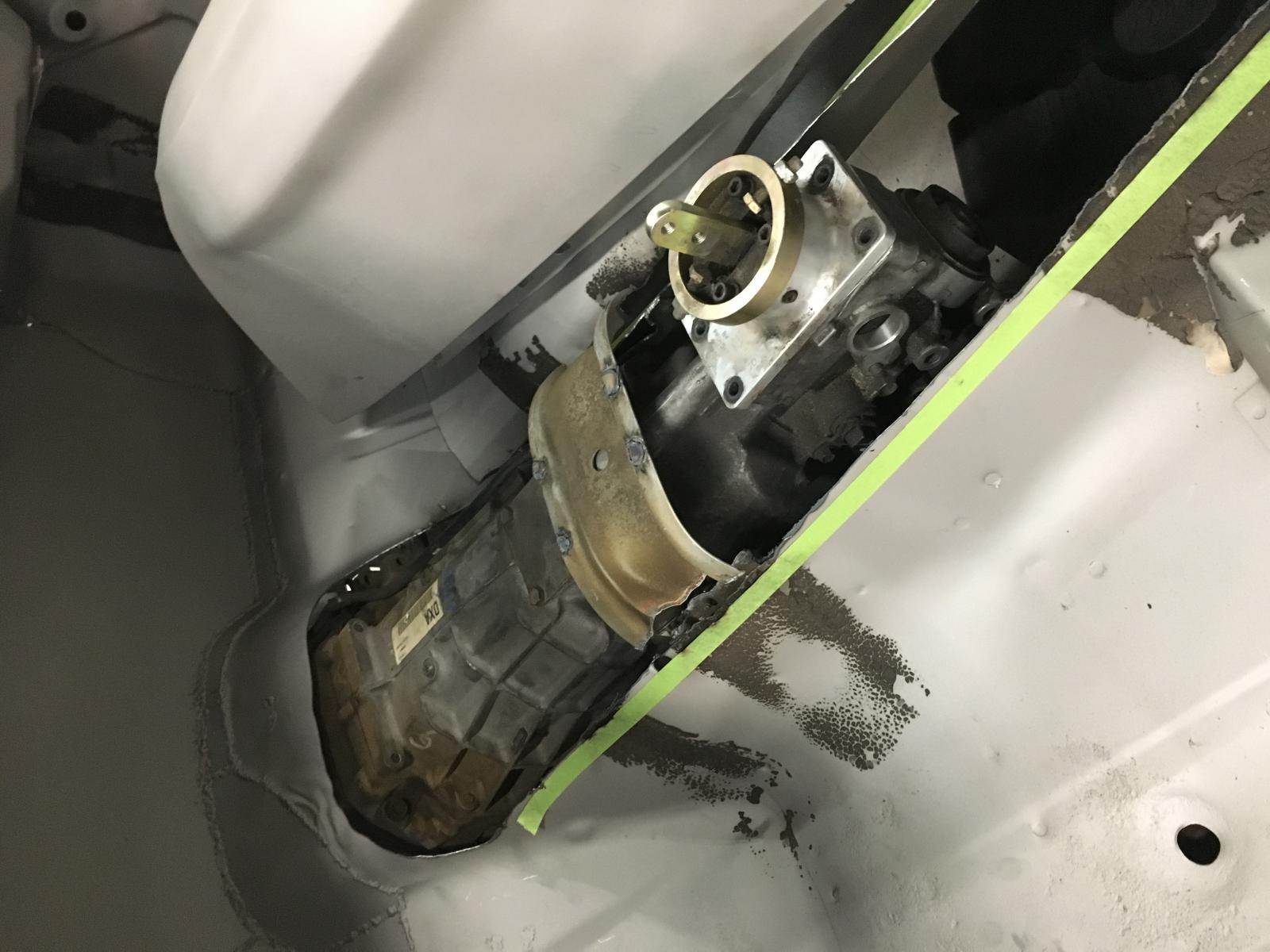

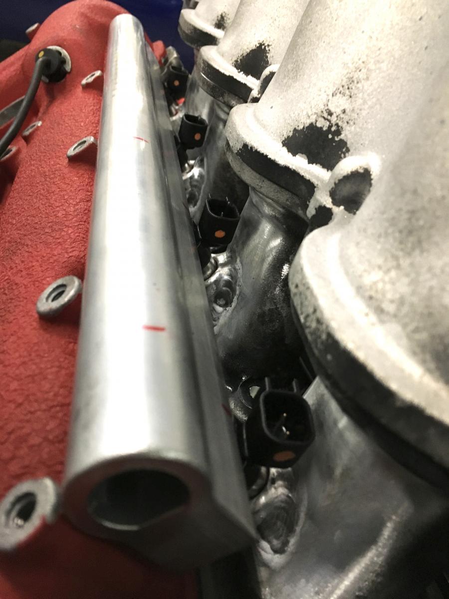

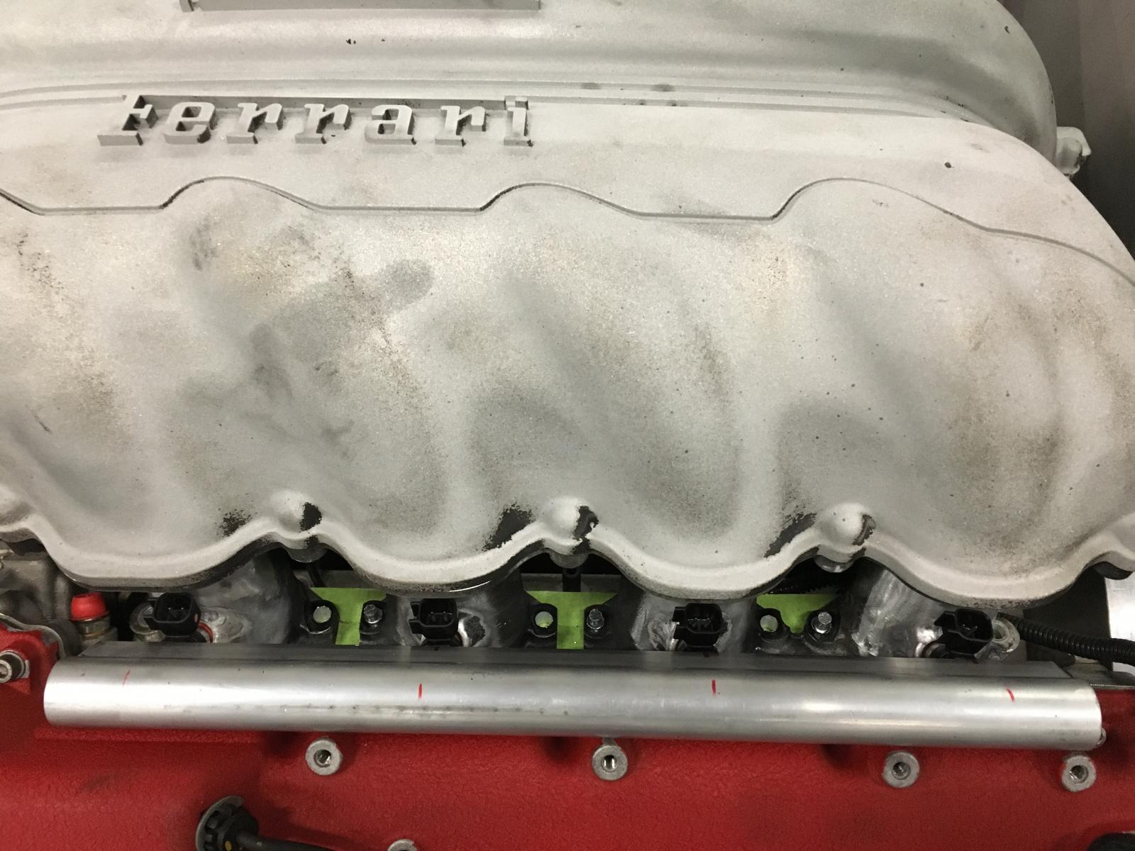

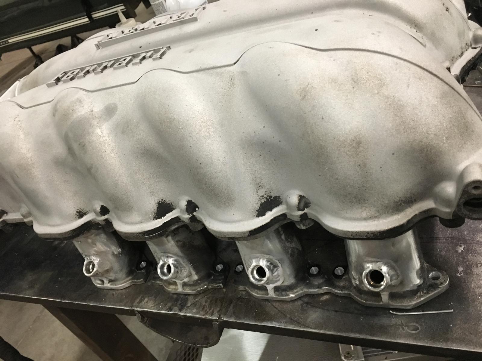

      Oct 2017
      14
      working on making clearance for the t56 and getting the right angle. Also have the driver side of the manifold fitted with injectors and machined the holley fuel rail to work.Name:  IMG_1328.jpg

      Sep 2009
      3,002
      That turned out great! Maybe I missed it but what are you planning for the ECU?

      I love this. What did it take to mate the T56 to the Ferrari block?

      I second the question on the T56 / Ferrari combo.
