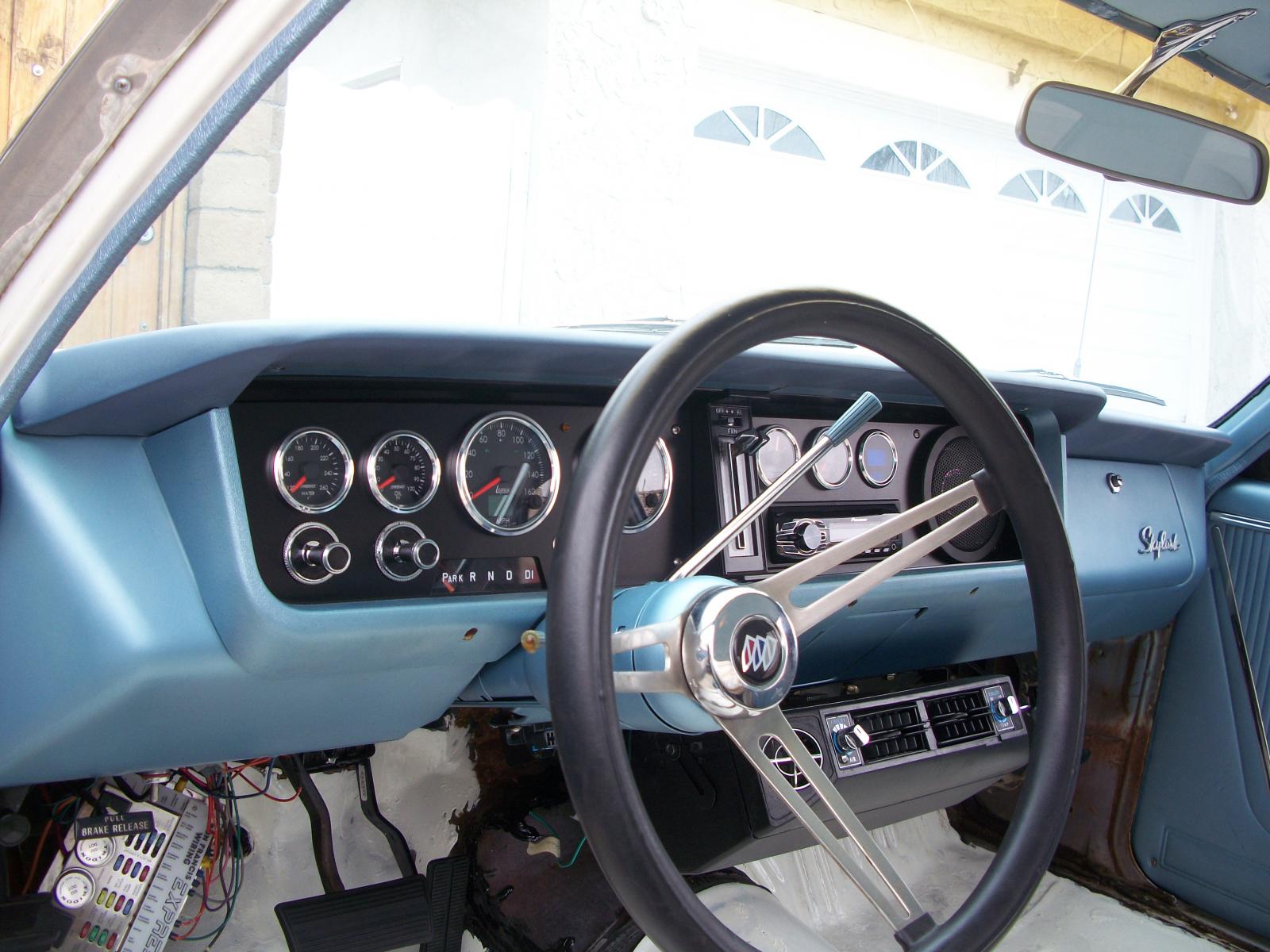

      I am using Lokars shift cable now that you reminded me. I did have to adjust the holes where the bracket mounted to the transmission. Yes I am using a gear indicator. It is the factory unit intragrated with my custom dash panels showing what gear you are in. It is located in the dash right above the steering column. I will see if I can find a better picture of it. Okay, this is the best picture I could find. You can see the orange shift indicator behind the Park label. Also no problem in adding a paddle shifter. I ran the wire from the TCM in the 6L80 transmission into the dash area if I ever decide to install a paddle shifter. D1 is supposed to be the "sport" mode. However I have both D and D1 programmed the same in the transmission.
